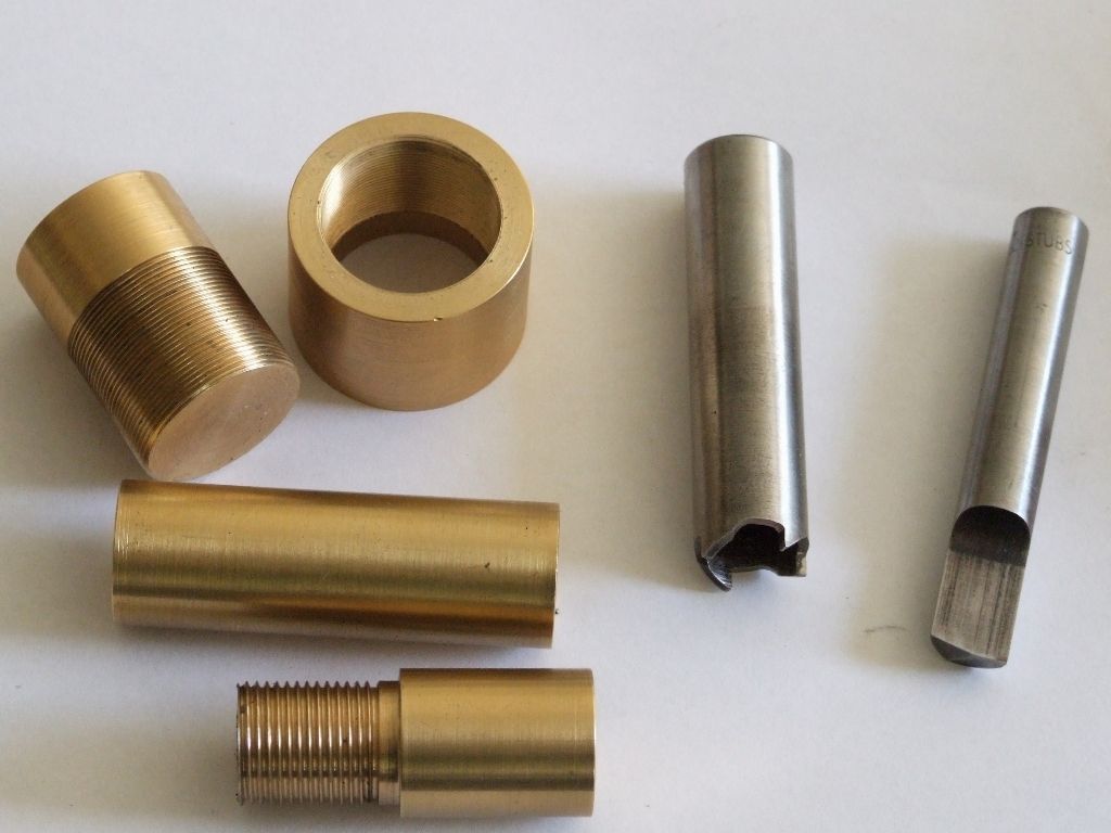

          The pattern linked to doesn't look like any D-bit I've ever known? In this picture, far right, is a home made D-bit:
          The flat section is just that, flat, and a thou or two over half diameter. The end is left at right angles to the shaft. There is a secondary relief on the end to prevent rubbing, and there was a smaller thru hole at the bottom so I didn't need the complete area to be machined anyway. The relief was filed by hand to no particular angle. Granted this D-bit (7/16" diameter) was used on gunmetal, not steel.
          If I'm not too fussed about the bottom being exactly flat I use a slotdrill in the chuck, rather than muck about with D-bits. I made the one above because it wasn't worth buying a new 7/16" slotdrill for a one off, and the bargain Dormer brand one I 'bought' on Ebay never turned up.

            For a D-bit to cut exactly to size the cutting end must be left slightly over half diameter. I usually leave it about 2 to 4 thou over half dia. for small diameters up to about 10 thou over for half inch and over.
            Andrew's photo shows the correct shape.

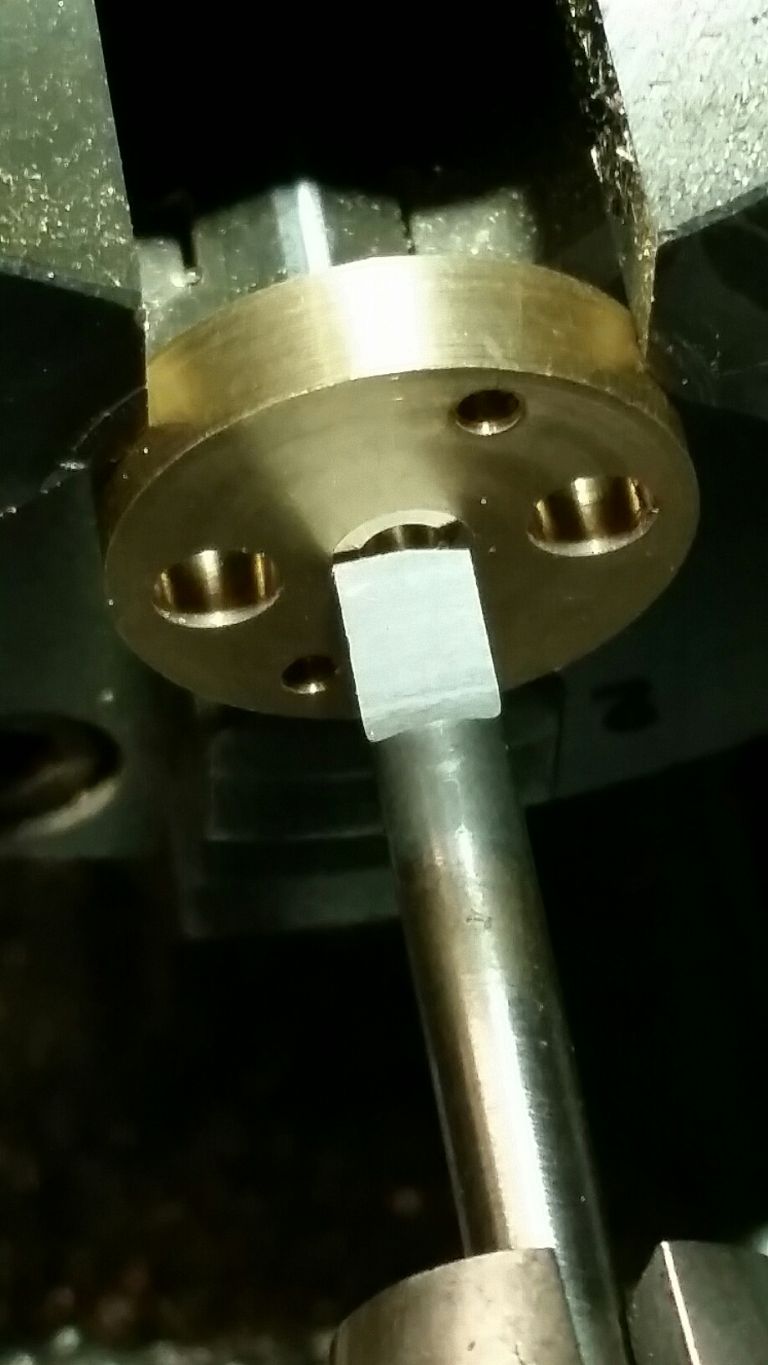

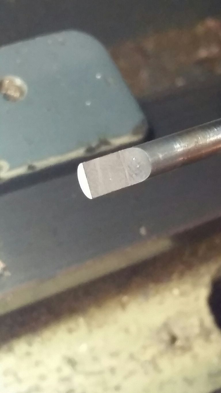

                            Peter Lamb 4
                              @peterlamb4
                              This advice was really helpful thanks. I recently bought a D bit from a well known supplier but it had a flat end so just rubbed on the work piece. I've ground an angle as described here and it worked well. Before and after photos here. The part is the regulator valve for my Box Hill loco.
