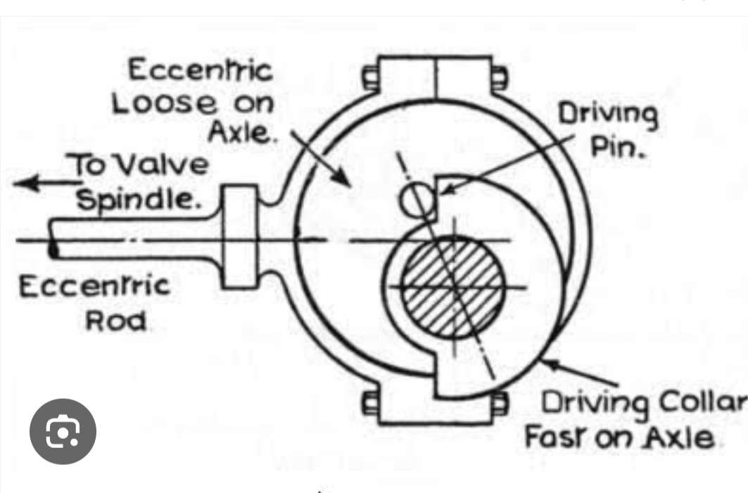

      I have been looking at the way that locomotives use eccentrics to drive the valves and am getting confused.
      Some seem to show a plain eccentric between the wheel and the frames and a “plain” eccentric strap around this. A rod from the strap operates the valve.
      Others seem to show a similar arrangement, but use a driving pin to drive the eccentric strap. There also seems to be some sort of cut-out in the eccentric that allows reversing.
      I cannot work out whether in the first description I have been looking at simplified drawings or whether these are two different designs. I am assuming that in the first description, the direction of rotation, or travel, is fixed whereas in the second, more complicated design, it is reversible.
      Can anyone please clarify for me? I am sure that it is a simple matter that I am confusing.

        Your assumption is correct, to get reverse you need to change the angular relation twixt eccentric and crank

              I’m no expert but, if you only want the engine to run in one direction then a single eccentric is used, if you want both directions then you EITHER must move the eccentric in relationship to the crank ( a slip eccentric ) or have 2 eccentrics and a means of changing from one to the other, the reverser mechanism. That is the simple answer, if you want to know about notching up (expansive working ) then come back and we,ll give you more information. Good Luck, Noel.

                The version with the pin is called ‘slip eccentric’ and is a convenient and cheap way of providing reverse for a model locomotive in smaller gauges like gauge1. To reverse the loco a giant hand comes along and moves the train backwards a few inches so that the eccentric is moved into its alternative position. No good for radio control or boat engines.

                    A slip eccentric has an angular gap between where it contacts the drive pin. One position sets the eccentric  so that the valve is positioned for forward motion. The other extreme position sets the vale for reverse running.
                    Webb used a slip eccentric on his compound 2-2-2 locomotives.
                    This lead to the ludicrous situation of a loco having backed onto a train, and then the  HP cylinder trying to move the train forward while the LP was still trying to reverse it. Hopefully, the HP pressure cylinder managed to move the train, so that the slip eccentric became set for forward, and both sets of driving wheels then revolved in the same direction.
                    A slip eccentric does not allow expansive working. Having separate eccentrics for forward and reverse running does allow expansive working, if the control system is configured for this.

                              In full-size, some of the smaller stationary steam-engines were made sort of halfway house, with a slip eccentric the customer could set for the rotation of what the engine was to drive. Once set, it was locked, generally by the driving-pin being a stout stud carring a large nut. It was simple and convenient, both technically and commercially.
