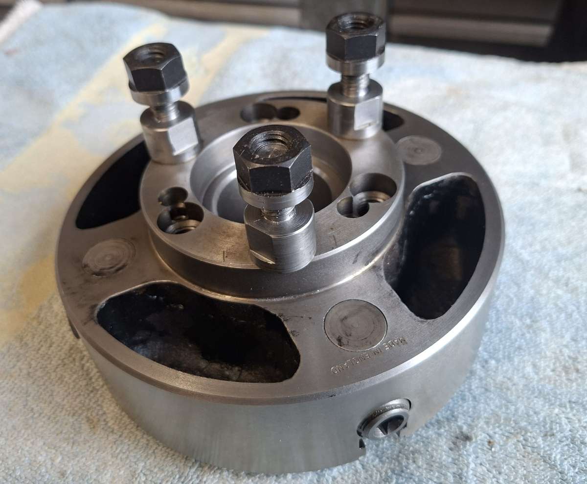

        Yes – use the D1-3 camlock backplate, remove the camlock pins and use studs. I made ‘special studs one end 7/16” unf ( to fit the chuck) and the other M10 to match the other 254 chucks I had.

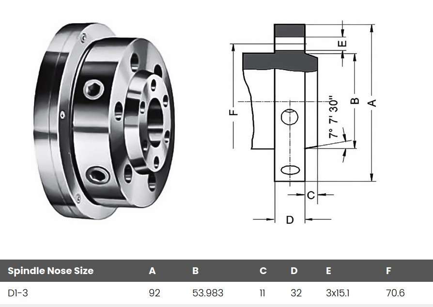

                    Chris Kaminski
                      @chriskaminski64716
                      On Dave Sawdon 1 Said:
                      £69 for a simple back plate seems a little OTT…Unless I’m missing something
                      main difficulty is getting nose dimensions correct:
                      Screenshot_20251003_100649
                      There was an article in MEW (No 102 Nov 2004) about making it, using fitting gauge.
                      There is also an excellent YT video about making short taper dial indicator/gauge to help with making it
                      (if you have original good quality master backplate to compare):
                      I have produced (successfully) backplate of this type for my lathe,
                      which has DIN 55021 spindle (same as D1-3).
                      It can be done, but to be honest… considering what’s involved in getting it right,
                      next time I might spend £70 with Warco

                      Chris Kaminski
                        @chriskaminski64716
                        Pratt Burnerd 4  jaw chuck with integral D1-3 back converted to three bolt fitting
                        20251003_125956
