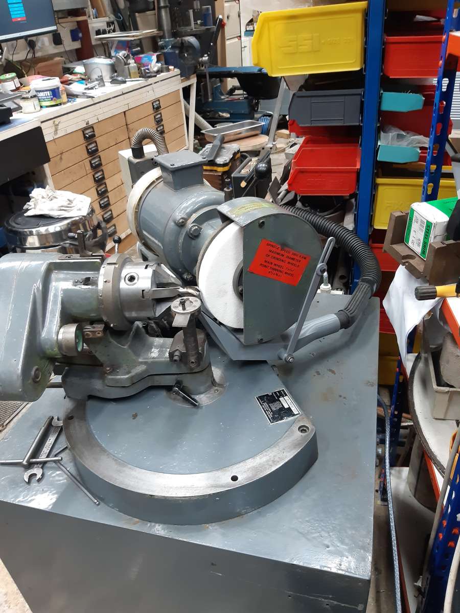

                                        In other news, I’ve replaced the motor and shaft bearings, they were a bit worn due to the grease having migrated away from the balls (some years ago?). I also remade the sleeve that clamps on to the shaft to take the shaft locking pin. Used a bit of EN24T. Pin is now a snug fit rather than a wave and a prayer.
                                        3D printed a dust chute a few days ago, designed in Alibre. I’m happy to say that it works very well:-
