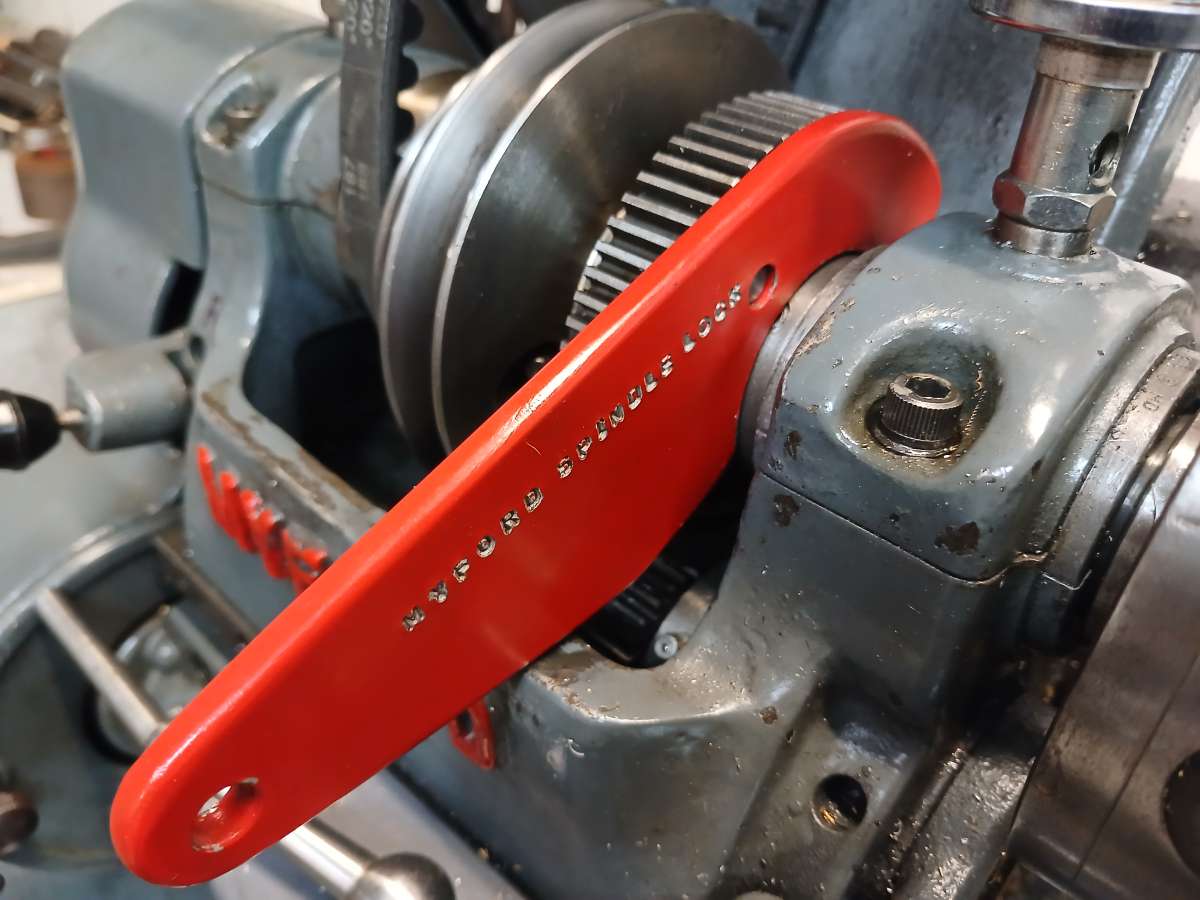

                                      The best way to break teeth is to use the chuck key and a hammer, the shock puts great strain on gears. We use a strap wrench to avoid the shock loading. The 3D printed gear holders are by far the best way to avoid damage to the gear teeth. When the very first 3D printed gear holders came on the market years ago, I decided to make a copy out of 20mm thick nylon on the rotary table, two actually, expressly for the Atlas 12 x 24 which has a zinc gear, even weaker than cast iron. My version has about 14 teeth and can be used for tightening as well as loosening.

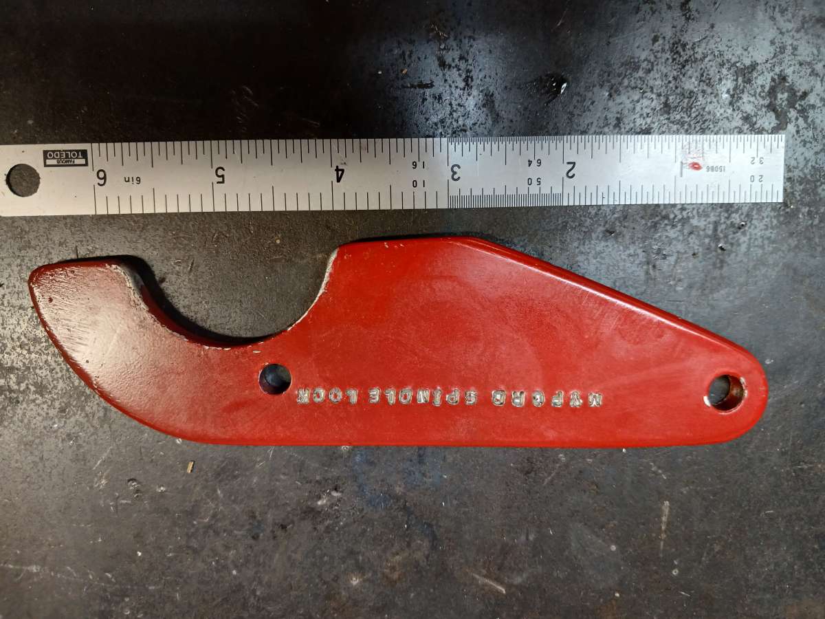

                                          #851357
                                          alecs
                                            @alecs
                                            Made from 6mm aluminium plate, 6061 T6, to a design in MEW some years back. Handy if you don’t have a 3D printer.
