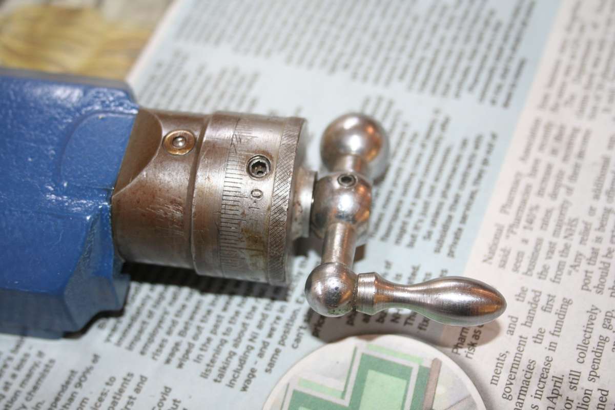

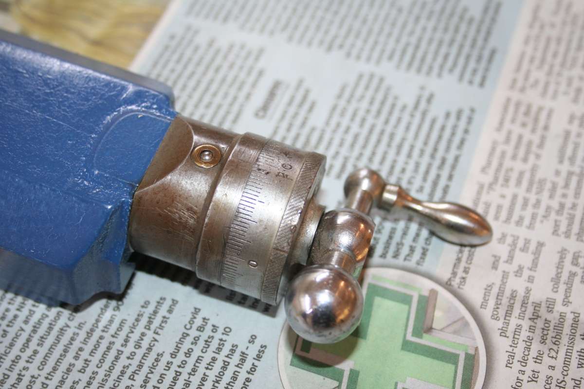

                                  Now double checked the TPI of both cross slide and top slide and both are 10 tpi. However, the graduated dials do not have 100 , but more garduations. See photos. I am wondering if they are metric and there is a mismatch here.
                                  Mike.IMG_8682IMG_8683

                                    It looks like the dial numbers are trying to be mm. If the lathe is ex school workshop they might have put the modified dials on as the kids wouldn’t understand imperial.

                                        In the late 70’s early 80’s I worked for a machine tool supply and maintenance company and it was common practice to just change the dials on school machinery when converting to metric. Certainly in Kent, Surrey and Sussex education authorities were reluctant to spend out for a full conversion if a near enough alternative could be worked in. Technical colleges did get the full conversion but I was told it was deemed unnecessary for the standard of work to be carried out in secondary schools. From memory it was mainly Tom Senior, Marlow (for which we had the dials made out) mills, Boxford and Loughborough  training lathes, I think any Colchester’s got the full conversion, There were boxes of feedscrews, dials etc in dark corners for years after I left, so quite possible your lathe has been messed about with. It wasn’t me I hasten to add, all the school and college work was done by an elderly chap ( who thinking about it was younger than I am now!) called Jim who worked part time, he retired in about 1979 when I think all the conversion work had dried up.

                                              IIRC the Boxford dials are all the same and have 125 graduations. Something like:
                                              0.001″ inch per division in imperial.
                                              Or
                                              0.02mm per division for metric.
                                              I THINK!

                                                125 graduations is for a 1/8″ leadscrew. I think you can initially wrap a piece paper round it with the right number of ticks. To make this if you have a printer you can draw a strip at a few different scales to get one that is a good fit. Lots of ways to draw it old fashioned style too.
                                                Then make a new dial – it is very simple as it is just a bit of bar with a hole – it doesn’t even have to be the same diameter as the current one. Plastic or aluminium would do.

                                                    If you are certain than that the leadscrews are 10 tpi, you are looking for, ideally, 100 graduations for 0.001″ per division.  50 divisions will be 0.002″ per division.
                                                    Being modern, the bores will be metric, so will will need modification; either boring or bushing, to match the Imperial diameter leadscrews.
                                                    But don’t buy new dials that are smaller than the existing ones. larger will give a greater distance between graduations, making it a little easier to interpolate for smaller movements.
