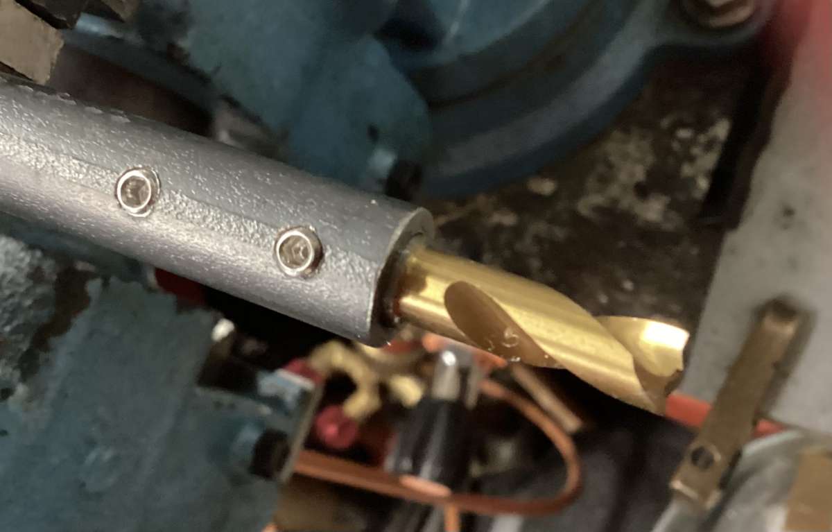

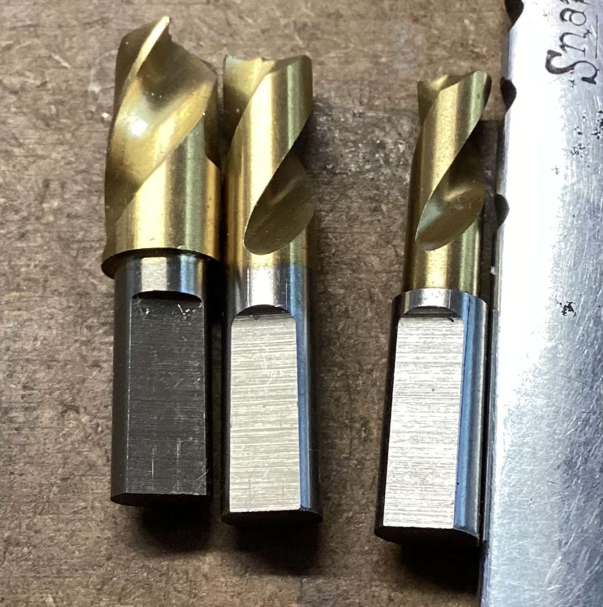

      I recently bought two sets of spot weld drills from two different sellers on Amazon (example pictured).
      I’m baffled by the single long flat on the shanks. A three jaw chuck won’t hold them concentrically if you insert them so that one of the jaws tightens down on to the flat; the only way to get them to run concentrically is if you carefully insert the shank into the chuck so that two of the chuck jaws grip on the rounded part of the shank right on the boundary of where the flat begins.
      So what is the function of the flat? Is there some sort of dedicated hand-held side-lock drill out there specifically designed for these sorts of spot weld drills?
      I should add that in the ad. all of the many images show only a smooth round shank, though a 360 degree view is nowhere shown.
      IMG_2074
      #852930
      DC31k
        @dc31k
        The drill bits themselves are three different diameters.
        The shank (with flat) is a common size.
        That immediately suggests they are not designed to be held in a gripping device with variable diameter capability.
        Recall that in auto body work, air-powered tools are very common.
        Perhaps search for the machine that is designed to turn them and enlightenment will follow.

            #852938
            Clive Foster
              @clivefoster55965
              The “mag drill” commonly used for things like structural steel work to make holes in situ use drill bits with flats held by  setscrew. Common type, rotabroach et al, have two flats at 90° but single flat version like your picture will work in the holder.
              Typically drills up to 50 mm have a 19 mm (3/4″) nominal Weldon flat shank, larger ones use 32 mm.
              Adapters can be found to hold rotabroach bits in standard chuck. £25 ish I think. But making one isn’t rocket science. Bore needs to be accurate size and concentricity between shank to be held in a normal chuck and the weldon holder needs to be very good.
              Clive

                  #852969
                  Bill Phinn
                    @billphinn90025
                    Clive
                    I forgot I made a Forstner bit extension many years ago for 8mm shanks. That will do for now for hand drill work.
                    IMG_2079
