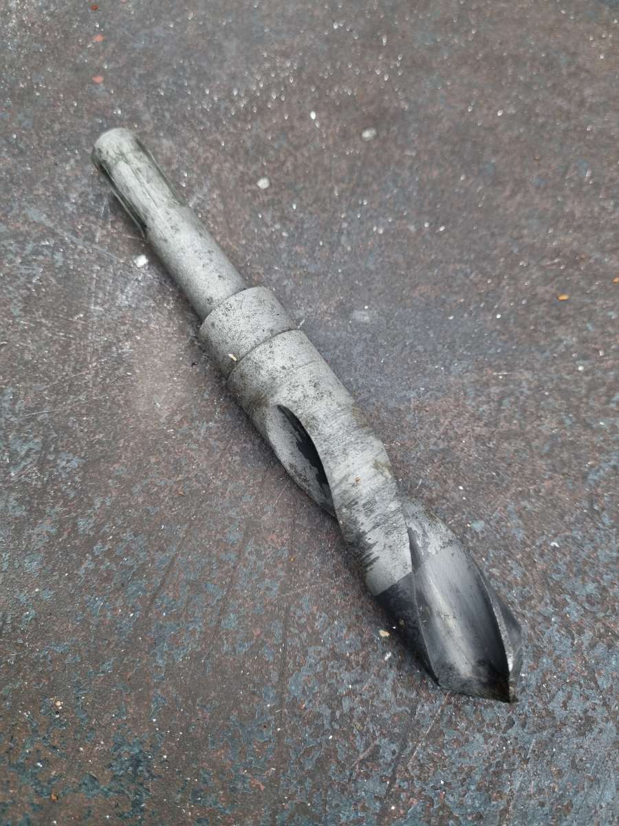

      So I’m working on a project that involves machining down a 48mm drill in both ends. I know, nuts. Well, actually it’s balls. For ball bearings I mean. Long story.
      The rear solid shaft and taper cut without too much problem, it was tough but cut well (sorry no pics). So I figured I could just anneal the tip with the oxy torch, but it just keeps on fighting me no matter what I do. I started with dull red (daylight), then tried again and again until I almost melted the darn thing. And it still eats inserts for breakfast, I just can’t get it anywhere as soft as the shank was.
      I’m sure the interrupted cut is part of the problem, but what can I do about that? Silver solder some inserts into the flutes perhaps? Would be hard to get the fit right though.

                      @Jason: Thankfully I don’t need to reharden it, I just need to have the end machinable without destroying the rest of the drill. I need to fit a ball bearing to the end, so while I could grind off the bulk I do need to hit some fairly tight dimensions.
                      I have managed to soften the steel a fair bit, but it’s still too hard. I even tried cutting it with HSS in case it was the interrupted cut that was the issue, but it didn’t last long.
                      My best idea so far is to put it into a bucket of hot sand to get an even slower cooling rate.

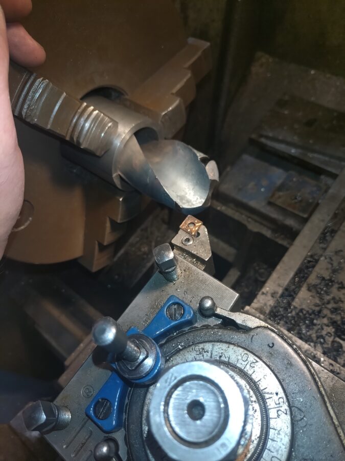

                                    Craig Brown
                                      @craigbrown60096
                                      20251003_190055
                                      Not of much help im afraid, but for your perusal. I recently did some rust removal on this very rusty drill bit. After removal from the solution you can quite clearly see the transition to HSS

                                        Fulmen
                                          @fulmen
                                          1: Because I don’t want to anneal the entire drill.
                                          2: Because it’s the best I can do. I have an oxy/acetylene cutting torch, that’s it.
                                          Now I can live with some loss of hardness, it’s not going to cut steel anymore. But I’d rather not have it as soft as the tang was. And if they managed to get the tang soft without destroying the entire drill why can’t I do the same to the tip? I know, they are experts while I’m an idiot with a blow torch.
                                          As for the slow heating it is mentioned in several articles for full annealing and austenitization, but not for the temper. I don’t know if it’s assumed for all heating or if it’s not really needed. They all mention the need for slow cooling in the 800-1000C range.
                                          One source listed the soft anneal temp to 750C (standard temper is around 550C), which I have reached for sure. But they also recommend 2 or even 3 cycles with significant soak times, so it might be as simple as that.
                                          @Craig: Interesting. Can you notice any significant difference in hardness around this line?
