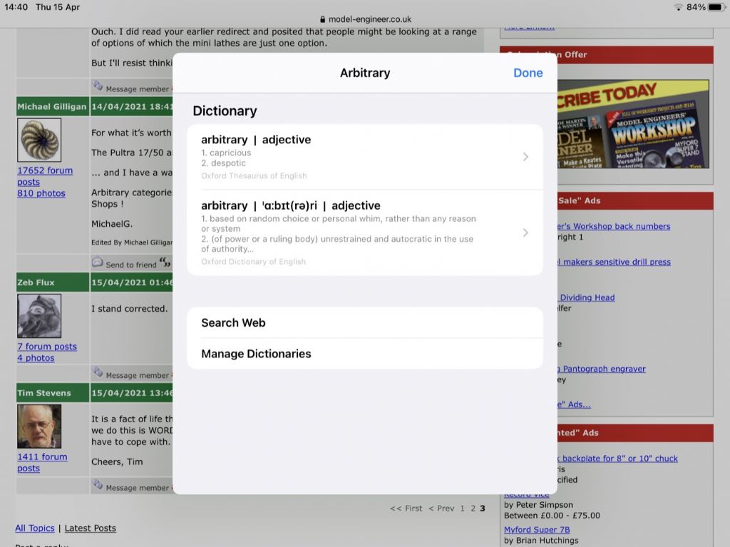

                                                #539873
                                                  Word of the day: Arbitrary
