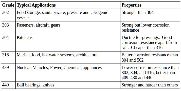

          Very true!  There are many different Stainless Steels, and it pays to choose the right one for the job.   It’s about the specification, not “quality” or where it was made.
          This table summarises some of the common alloys.   Some prioritise corrosion resistance over strength, others strength over corrosion resistance.  In practice designers also go for the cheapest alloythat will do the job, and what that is may not match our expectations!   Don’t assume an unknown stainless will be either strong or corrosion resistant!
          stainless
          I assembled the table from a blurred web image – any mistakes are mine!  “Workshop Materials” by Alex Weiss is recommended (Workshop Practice Series No 30.)   Much more informative than believing in “quality” or assuming that everything made in China is rubbish!
          A wood-screw might be made of:
          • 304 for cheapness and good corrosion resistance, but it’s not strong and no good at sea.
          • 303 for strength, but not in a corrosive environment
          • 316 for marine use because it resists salt
          So, when it matters, buy screws to suit the application, ideally those that say what alloy they’re made of.   Unspecified screws sold cheap in DIY stores and online may not be good enough.
