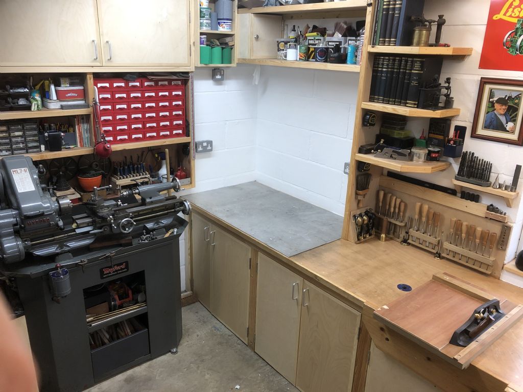

        This ME hobby being highly addictive I’ve decided to treat myself to a new mill and have on back order a WM16B from Warco. Even though it’s a few more weeks yet I’ve decided to spend this weekend preparing an area of bench in my workshop to receive it. It would be really helpful to know the overall depth of the mill less the Y Axis wheel as this can overhang the edge of the bench. The PDF catalogue states 600mm so I guess the question is what is the depth of the wheel to dictate bench depth with a nats whisker back of mill to wall operation. Space is a bit tight and a snug fit would be ideal. Hopefully someone has the same mill.

                      I have my Warco WM16 on a wooden bench 550mm deep. The chip tray is 50mm from the wall and is 480mm deep. This is about as close as you can put it to the wall so that you can turn the column handle without your knuckles hitting the wall. The y axis handle protrudes about 100mm in front of the chip tray. The mill x axis table is 700mm wide and 930mm wide across the x axis handles plus you need extra space each side for the x axis travel. (About 200mm each side).

                          I found one of them the hard way – the chip tray dimensions are the wrong way round, you need 520mm depth to fully support the tray, 500 is fine, mine is even less and the base of the machine is fully supported.
                          The distance of the Z-axis wheel to the wall is OK, I will be putting some slippy plastic on the rough wall nevertheless.

                                  Thanks for that Clive great idea. Just finished stripping out the corner of shelving and fitting electrics so I’m sure there should be plenty of space now. 1.4w x 720 deep and 1m high.

                                    That looks the business. smiley
