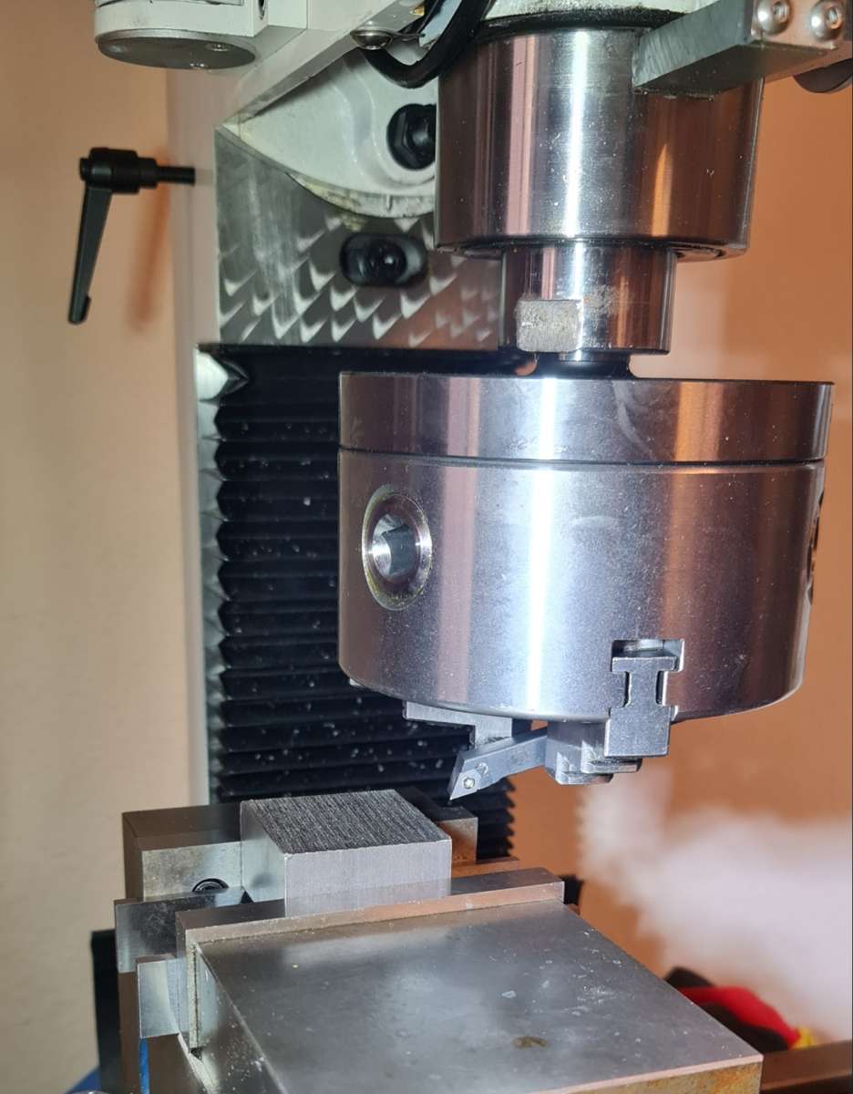

      I’ve wanted to make a fly cutter for a long time but never had the time. Once again, it turns out that laziness leads to optimal solutions. I have a faceplate with a MT3 mount for a 125mm chuck, which I use on my lathe. This morning, it occurred to me to move the chuck to the milling machine and clamp a cutter into it. It works really well!
      ssss

        The flywheel effect of the heavy chuck probably improves finish and keeps the cutter more stable as it inters the cut. Which would seem to be an advantage on smaller machines.
        Not completely convinced about pull out resistance with the cutter clamped canter wise between the three jaws tho’.

          Same as Clive, not totally convinced about clamping tool like that but top marks for the flywheel effect of the chuck.

              I’d be concerned about the cutter being flung out too. A bit of round bar with an angled slot milled in it and two or 3 set  screws would not be hard to make and more secure.

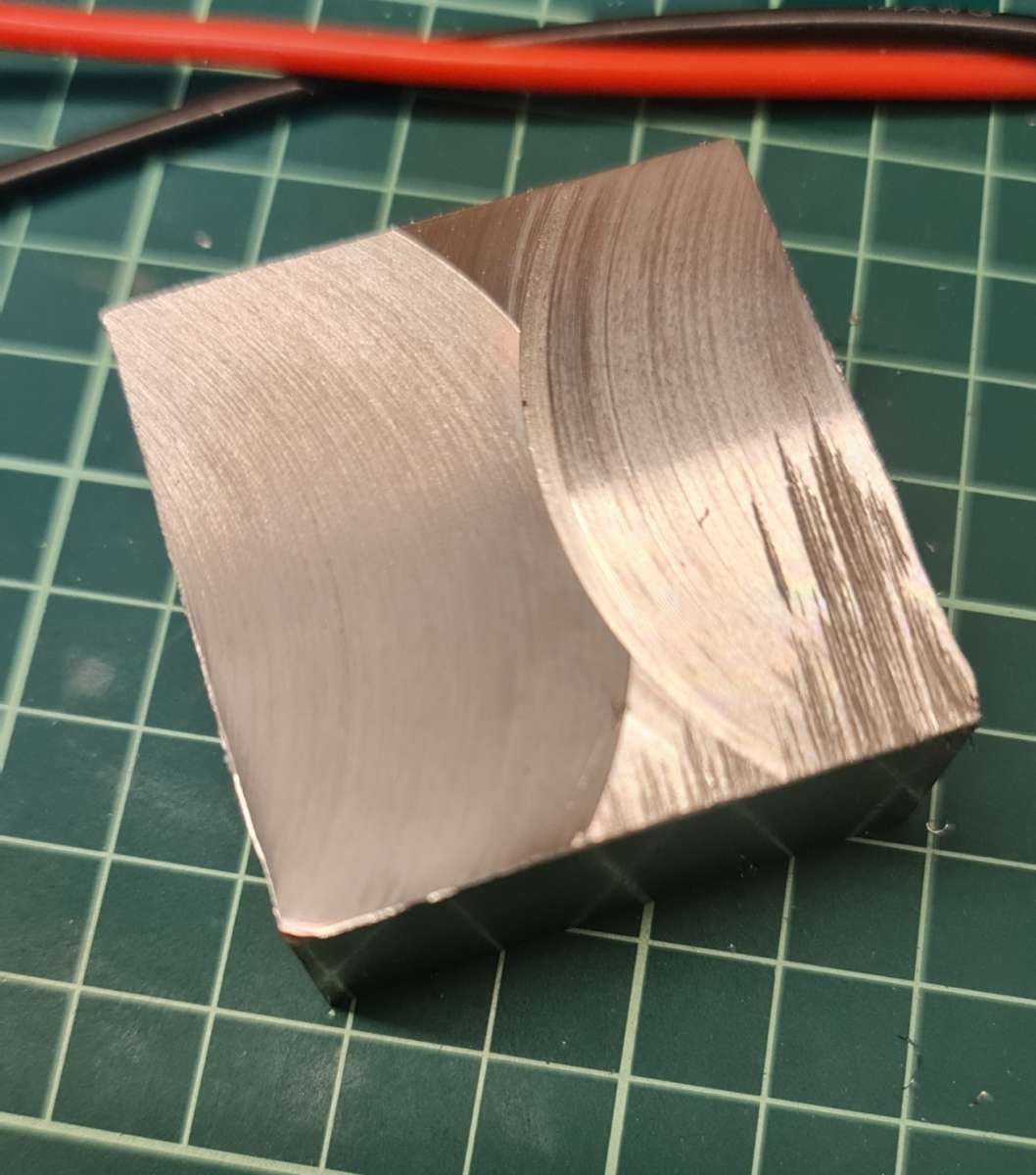

                    The milling machine is HBM BF28, it has a belt, no gears. So no problem there. I was also suspicious at first about whether it was safe. I never went beyond 400rpm. But it looks like the chuck jaws are biting in the tool. See the two lines.
                    ssss2
                    Also the cutting forces are small. It should be safe. This is a C45 steel cube. Thee feed rate was not optimal. But still the left part feels very smooth. The right half was done with wrong turning direction. And resulted also in a brocken tool tip.
                    ssss1

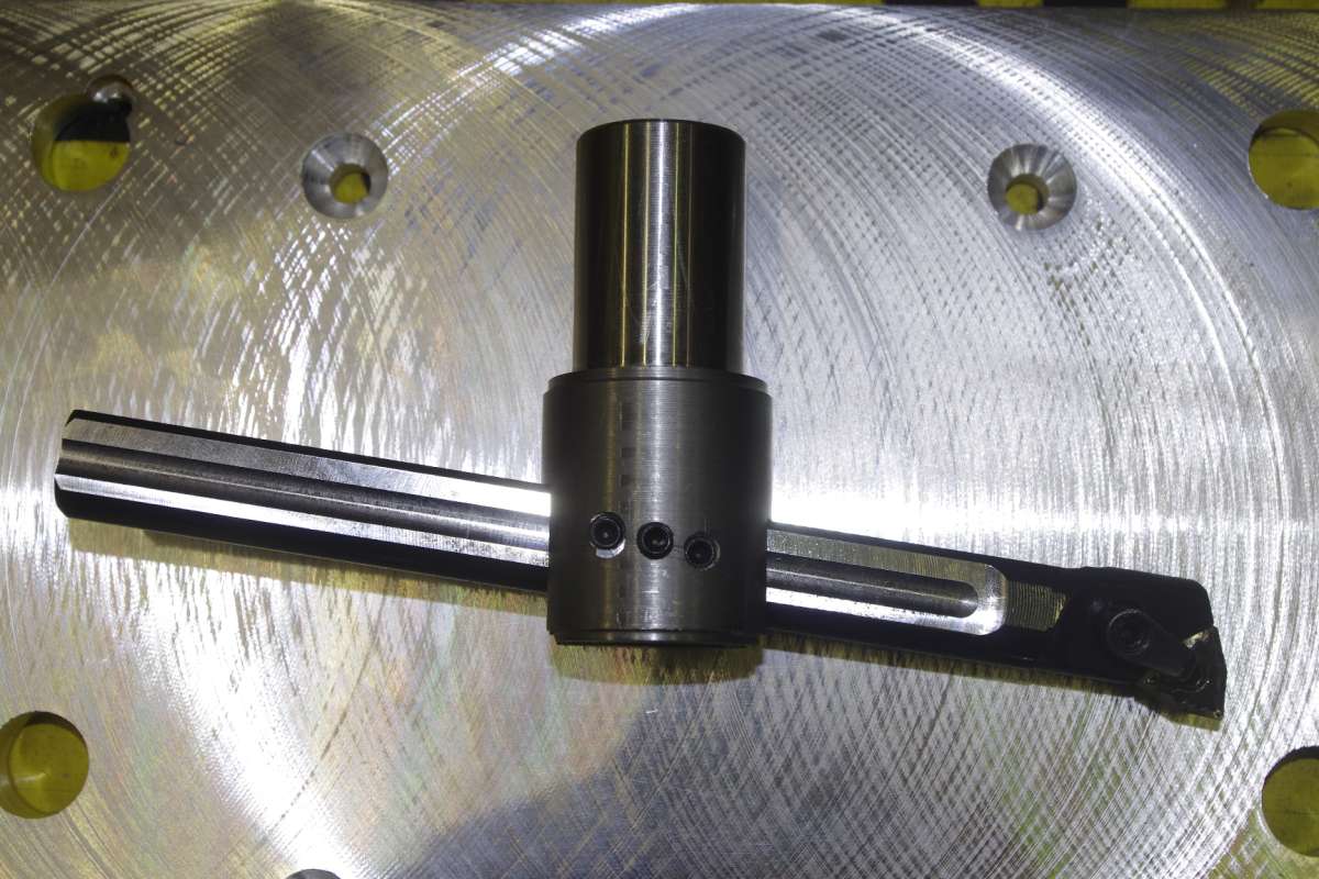

                                  I bought a set of three different sized fly cutter bodies that weren’t very expensive and worked ok, or at least well enough when I properly sharpened the braised carbide cutting tips on a diamond wheel.
                                  I then bought a commercial fly cutter that uses the replaceable RNMG-43 sized round carbide tips. In my opinion it produces a far better surface finish on almost any material I’ve tried, and is extremely cost effective because the tip can be slightly rotated each time it dulls or rarely might chip the edge. Unfortunately the one I bought doesn’t seem to be available anymore or I’d add a link. But if I was making a fly cutter body, tool tip shank and wanted to use carbide, it’s what I’d choose because it would be well worth the time and effort.
                                  If it will help anyone here, mine has dimensions that might be a bit large for a lot of the more bench top sized mills, but could definitely be scaled down or even use the smallest diameter RNMG-32 tips for anyone with a small mill. Fwiw, mine has a .750″ tool shank, the body is rectangular 1.800″ wide X 2.500″ long, the tool slot offset to put the cutting edge on the tool center line, 1/2″ X 1/2″ tool tip holder X 5″ long. With it looks like 2-3 degrees of additional forward rake on the RNMG tool seat to make the cutting even more positive. And the usual 3 set screws to secure the tip holder at whatever radius it’s set to. I suspect that extra forward rake on the tip seat is why it’s design cuts so easily.

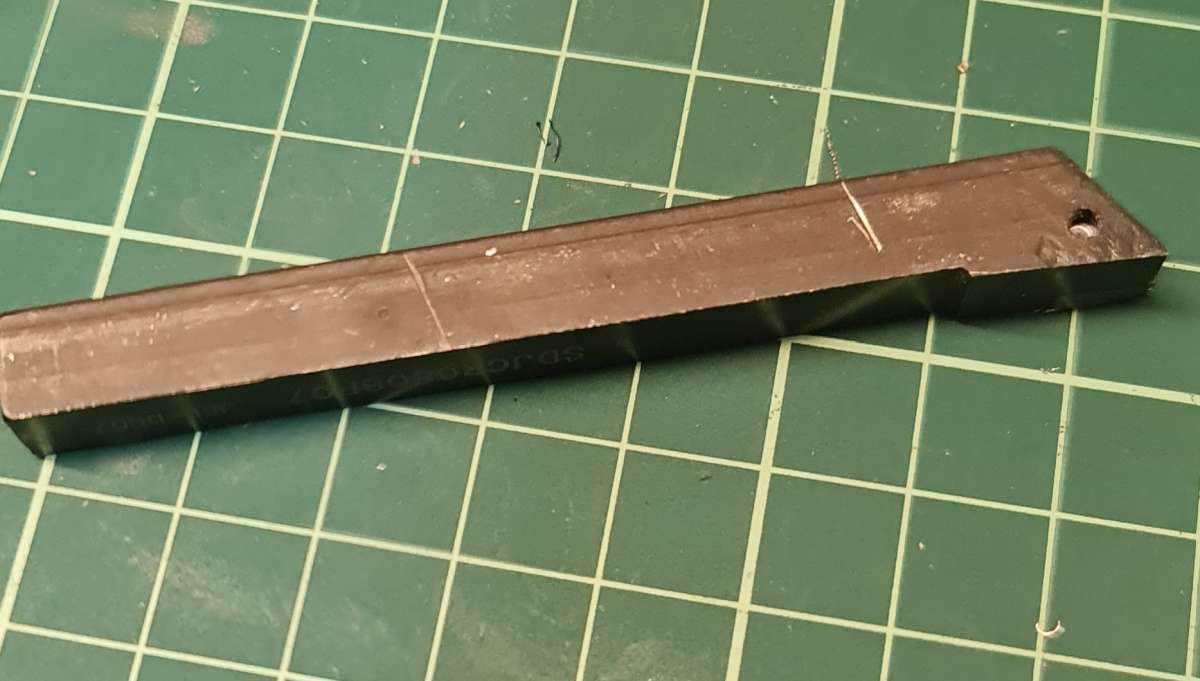

                                    Alternative lazy man’s fly-cutter:
                                    20260728_155506 (1)
                                    I might try using the round carbide tips, the one above is HSS, and by the second piece of stainless steel it was getting a little past its best.
