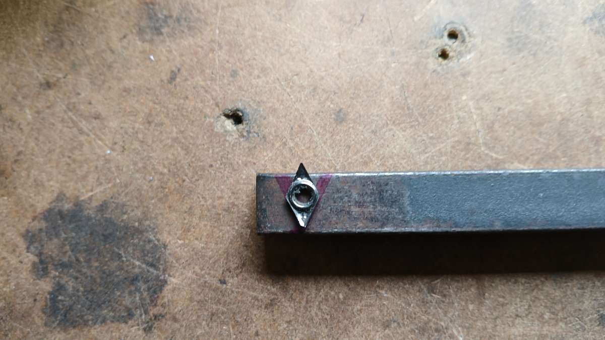

                Not much point in risking a 1mm cutter when a 3mm will do. Just have a runout hole as Bernard suggests or run the cut beyond the internal corner. Infact as you only want a small amount protruding the opposite point may well hang over the edge of your bar so no need to give clearance.
                yes R/T would work for setting the angles as well as just clamping the vice at an angle.
                #799536

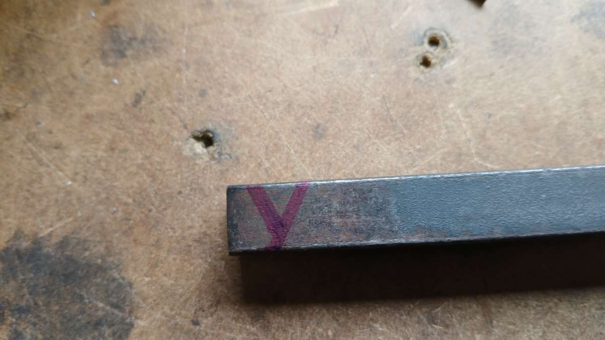

                  Bit of 12mm bar, red lines are the two initial cuts with a 3mm dia cutter having the right one longer gives the tip clearance
                  20250524_133749
                  20250524_133804
                  But grinding your own should not be too hard or need anything too fancy in the way of grinders of rests.

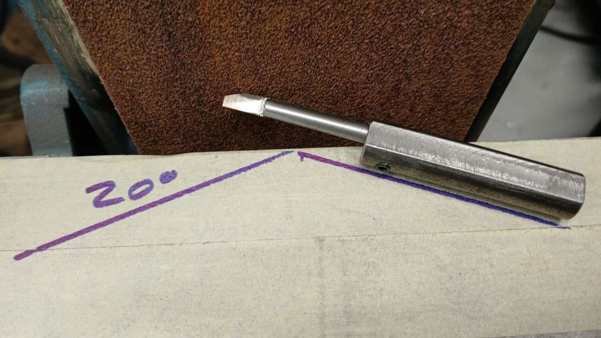

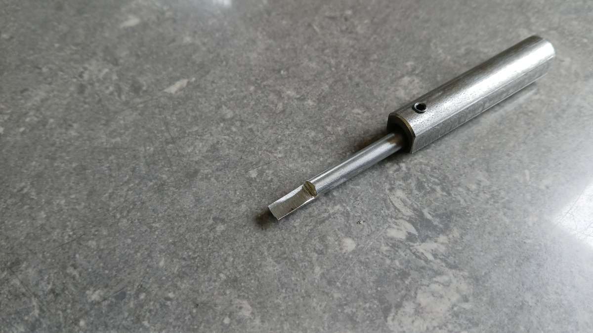

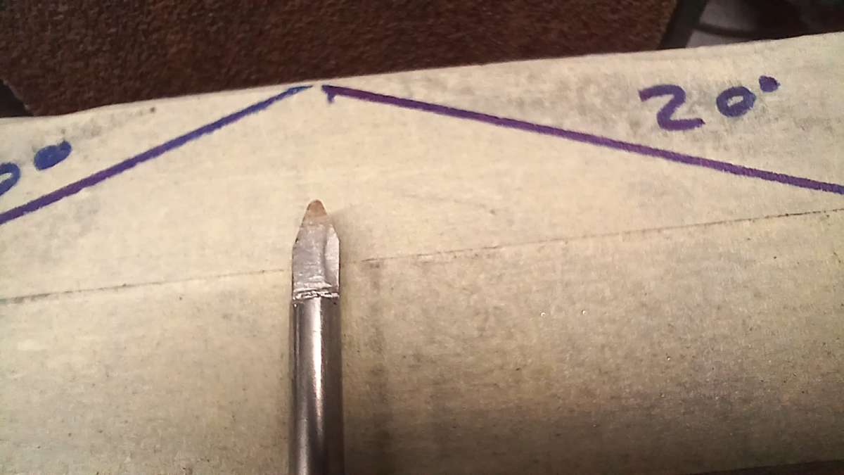

                  Take a bit of HSS either bought in or an old cutter and make a simple holder from some square bar so you keep your gingers away from the grinder, don’y have to hold the HSS as it gets hot and to also hold the cutter at a constant angle. Grind a bit of the top down to approx half thickness this can be done freehand on the grinder with uneven wheel
                  20250524_134706

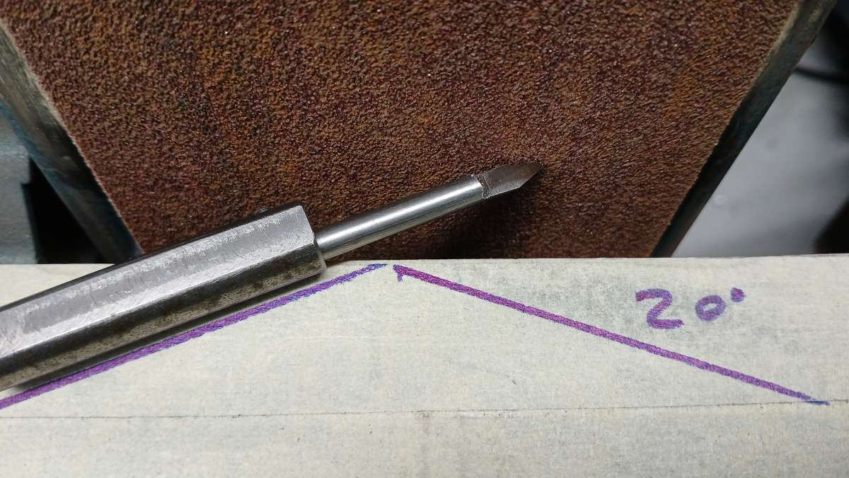

                  Set the belt sanders rest to tilt down about 10 degrees and then mark two lines at 20deg. with your square holder lined up to one mark by eye grind one side to just short of half way
                  20250524_134825
                  Do the same for the other line to form the other sid eof your Vee tool
                  20250524_134908

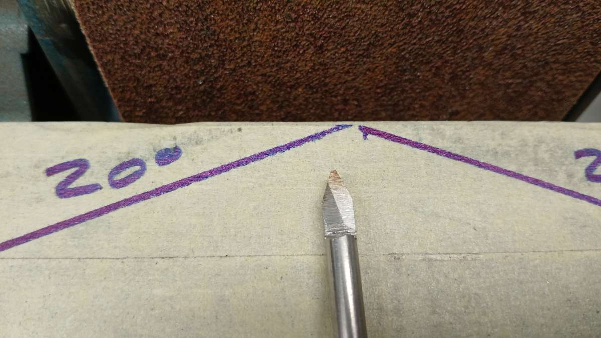

                  Should look something like this, check the angle and adjust at this stage
                  20250524_134915
                  Freehand the nose radius by swinging the tool between the two lines with very light contact on the belt
                  20250524_135048

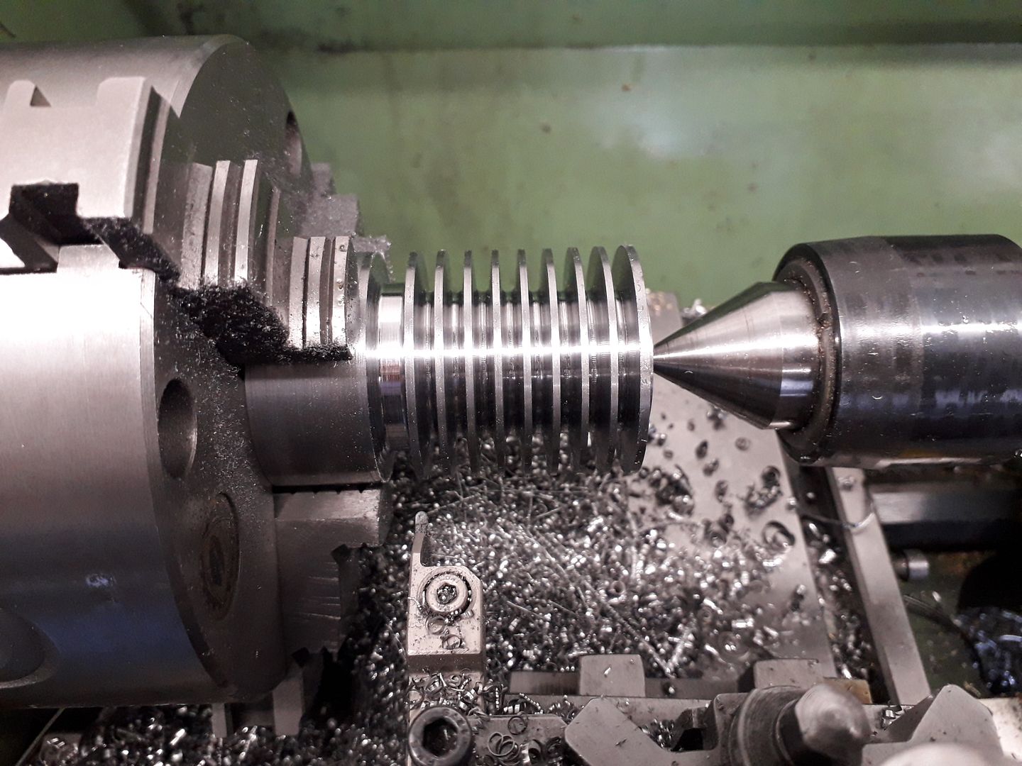

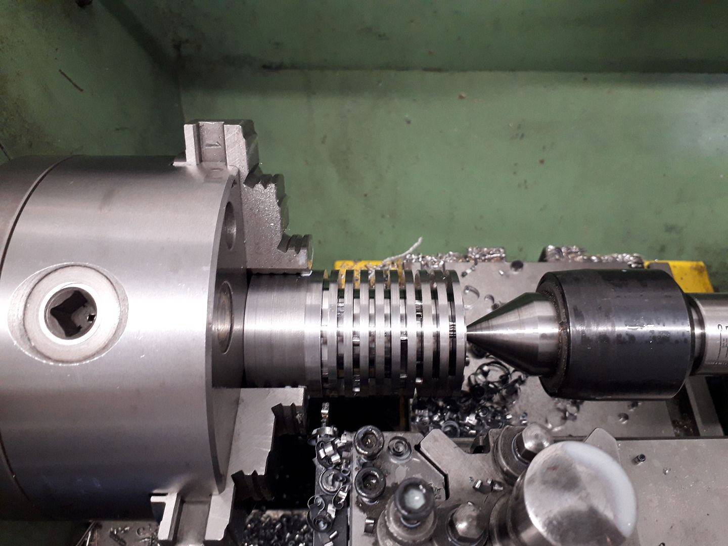

                  Now to see if it works. this was a bit of 60mm cast iron and the cut 3/32″ deep without the parting gut.
                  First half of the video I was one handed so had to feed in until it could hear it starting to resonate then moving teh cross slide back and forth a few thou then in a bit more with the cross  slide. When the camera angle changes I am working both at the same time with a slow infeed and moving the topslide one way and then the other and it goes in quite quickly.

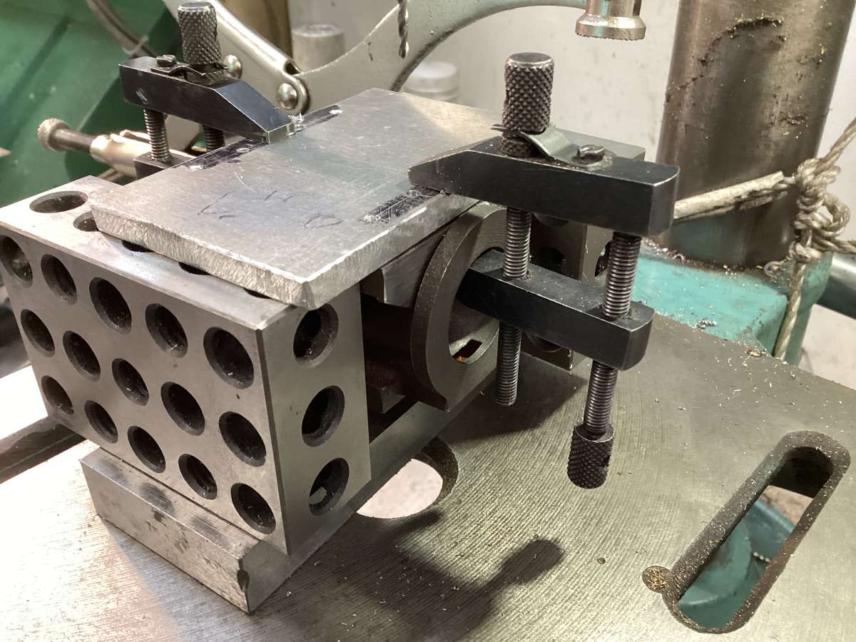

                            Well Princess Royal ( Stuart Victoria twin) build  series by the great TC published  in the Oct 84 ME, I immediately decided I would at some time in the future build it.  My don’t the years pass! So I viewed this thread quite a lot my build hasn’t been going long but I thought people would be interested in some of my methods. I’m working on the cylinders at the moment, and it took a lot of thinking to  work out how to drill  and tap the holes to fit the feet.   Tc glossed over this bit . In the end it was quite simple as shown
                            1 Spot drill the foot mounting holes a small support plate to bit in between the end flanges with a modicum of clearance from the loosely assembled unit
                            2 Drill and tap 6 ba to give alignment movement
                            3 Mark which end each foot fits the cylinder
                            4 Invert,  mark out and drill the 9 ba foot holding screws( I have few 10ba) in the plate
                            5 Fix feet, add cylinder and clamp in place, use a bar on the port face to sight or scribing block to get it level
                            6 Use 123 blocks to support the plate on the drill, set depth stop and drill through the feet into the cylinder
                            7 Tap, open out holes in feet to clearance
                            8 IMG_1530Shorten screws. Job done!
                            I didn’t drill the mounting holes in the base, this I think is a big mistake.   I won’t do this until I can assure the correct alignment of  the cylinder,  bearings crank  etc. assemblies.
