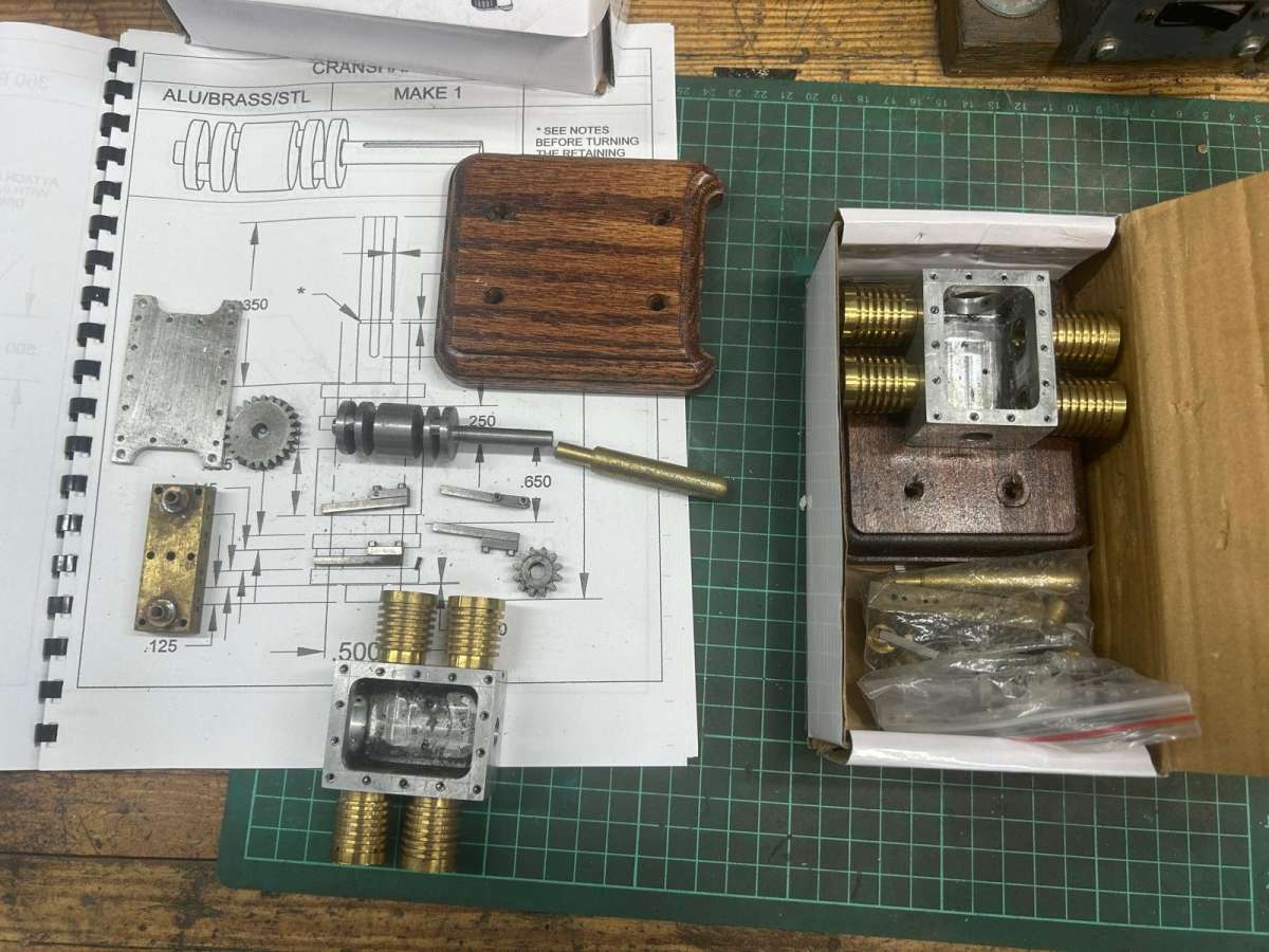

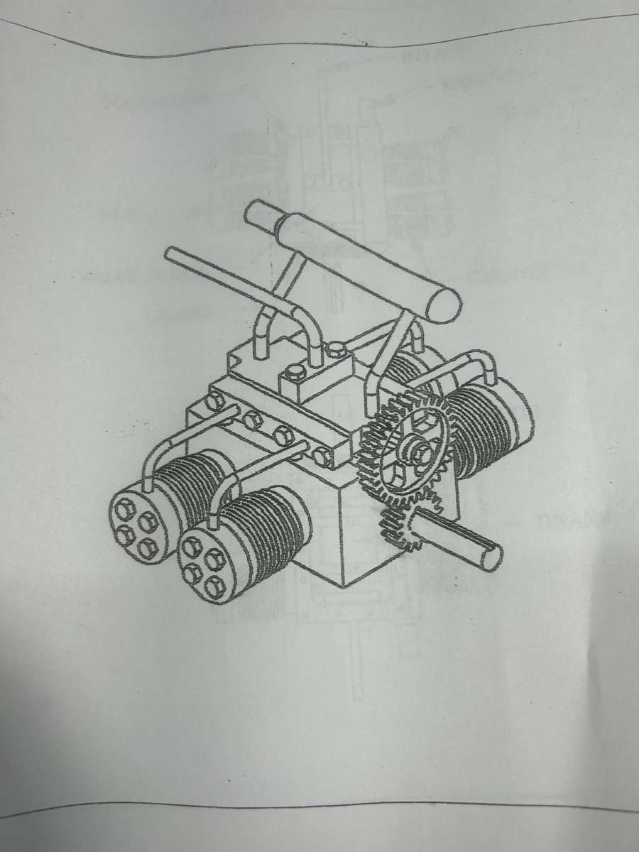

      I got an email a few weeks ago from an internet friend asking if I wanted a part built engine that he had going spare. Now I use the word “Friend” in the broadest terms, as I don’t think a real friend would have dared to give me an engine with so many interesting additional machining features that the original builder had included, but it certainly turned out to be the gift that kept on giving in that respect.😂

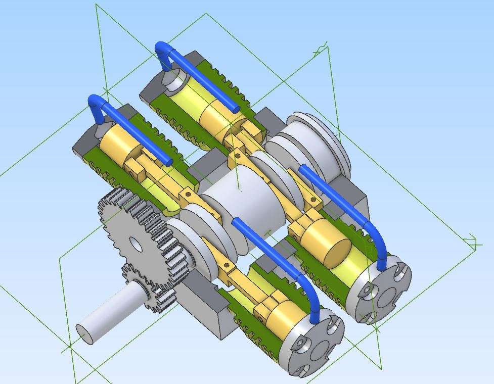

      His email included a couple of images of the drawings which did not have the engine name or who designed it as well as some images of what he had. The story is that a friend of his bought them from a guy in America who had started to build ten engines and as they were cheap he got two for my friend, I subsequently found out why they were so cheap – almost expensive scrap.
      WhatsApp Image 2026-09-08 at 16.22.18
      WhatsApp Image 2026-09-08 at 16.22.19 (2)
      The style of engine reminded me of the Liney “Halo” and after some googling and asking on an American forum it was confirmed that the engine was the Liney RV-2. A flat four boxer air (or steam) engine of 3/8″ bore and 1/2″ stroke. As soon as the drawings arrived, I redrew them in Alibre to see if all was OK, I just made one change to the pipe positions that come out the central manifold so that they were not offset from the cylinder ctr lines. Apart from that it all looked like it should work. Although imperial the drawings were in decimals and not fractions with many sizes being in multiples of 25, 50 and 100 thou which I have seen a couple of times on other American drawings and quite easy to work with.

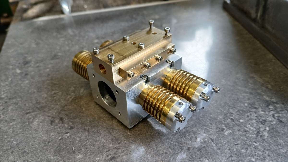

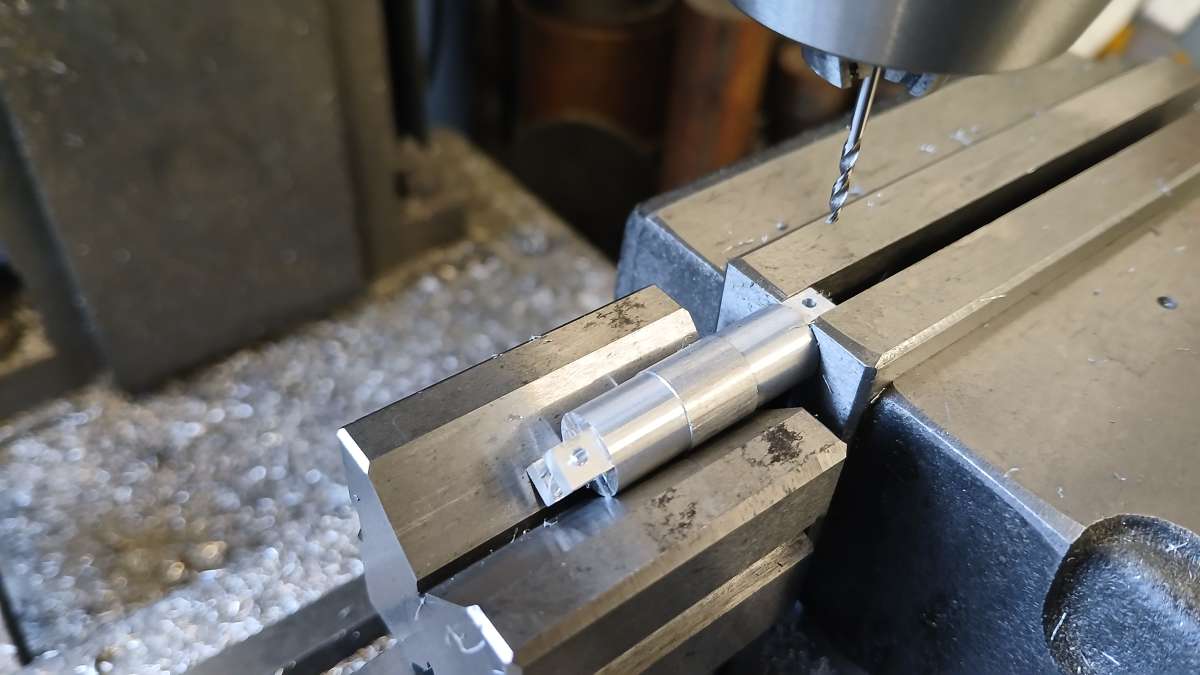

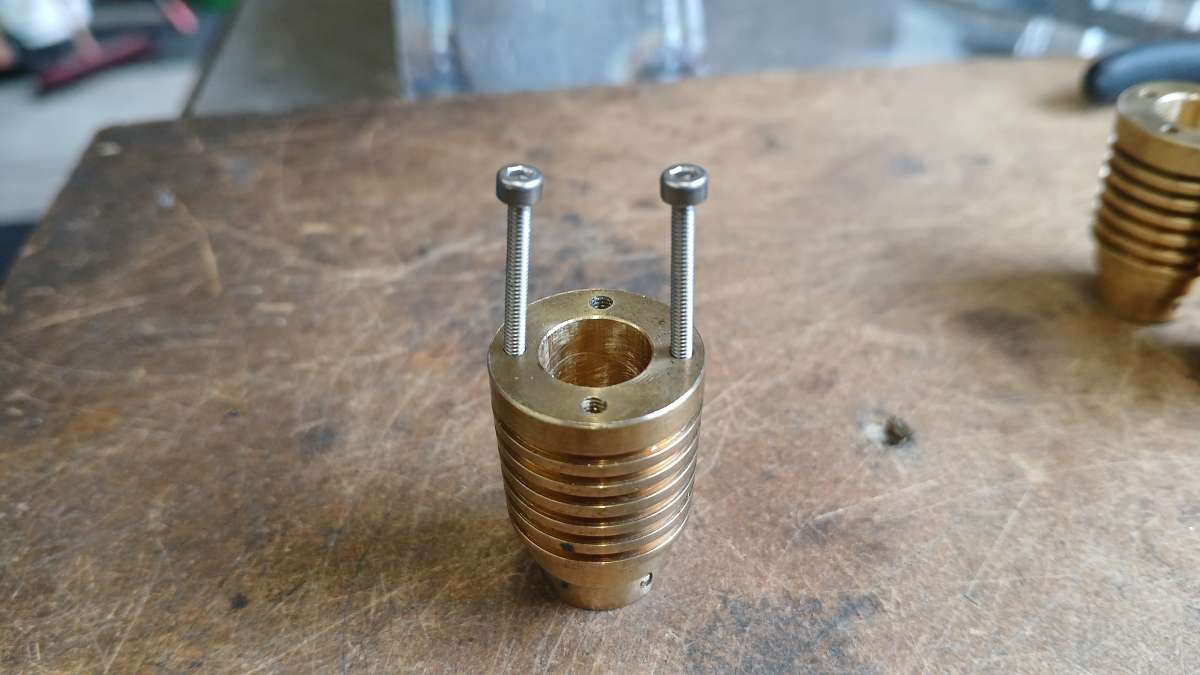

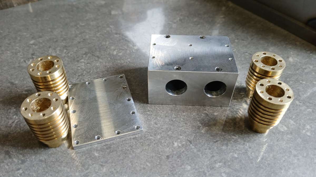

      The voyage of discovery started when I took the engine parts down to the workshop. Starting with the cylinders which looked quite nicely machined on the outside it soon turned out that their spigots to locate them in teh crankcase were a bit small and varied bt I can take care of that on final assembly. A bigger problem was the bores which again varied by a thou or two but worse was that they were all tapered and a piece of 3/8″ silever steel would only enter so far into each but by different amounts. Luckily I had an expanding reamer to suit that range of sizes so worked my way through all 4 cylinders, slowly increasing the bore until all four were cutting full length. The bore ended up approx 9.75mm.
      20260915_141554
      The drawings spec UNC threads throughout the engine mostly #2-56 and #0-80 but I prefer metrix so thought I would be able to rethread the holes for the cylinder head screws M2.5, it was only when I tried a screw in teh existing threads that I discovered many were crooked.
      20260915_141644
      To cure that I decided to drill and tap new holes placed between the old ones and take the opportunity to go down a size to M2
      20260915_143850

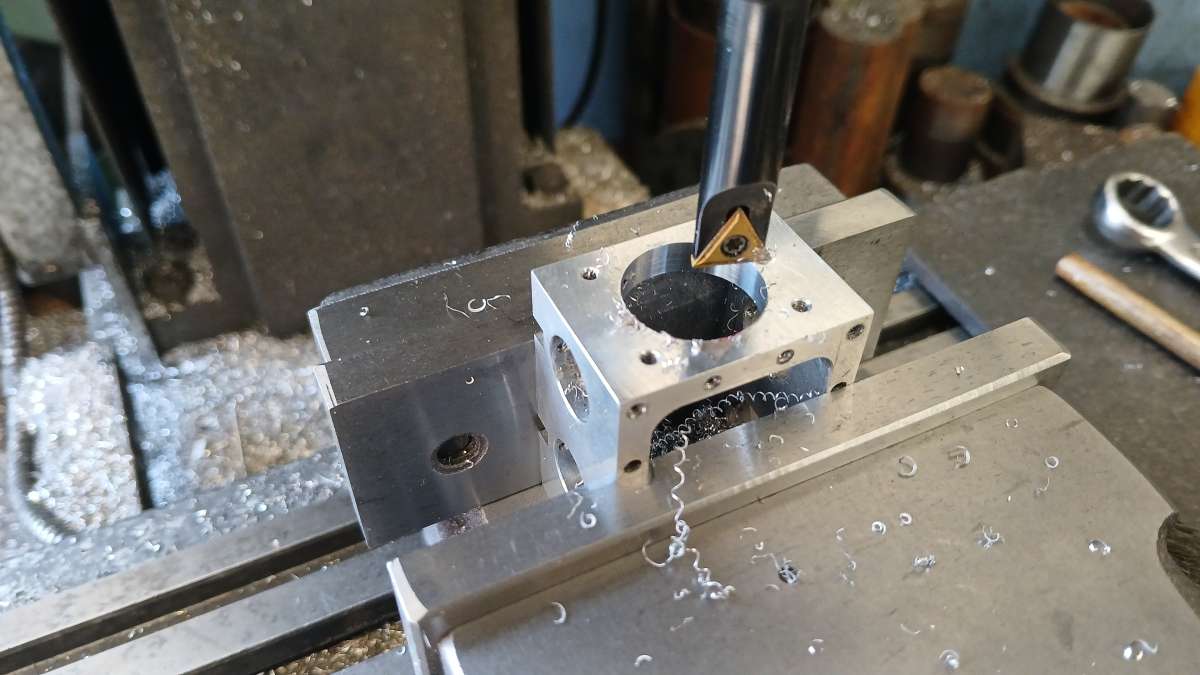

      Offering up the sump plate to the crankcase I first thought that the sump was too narrow but after  a qick going over with the digi callipers it turned out that the crankcase was 2 1/16″ wide not the 2″ called for on the drawings. So after re-tapping all the sump screw holes to metric, it was screwed to the crankcase and the case taken down to width, just skimming the sump at the same time. I then did all the other external faces as the previous builder had polished it up with a buffing wheel, judging by the muck still in the case and it was all a bit rounded over for my liking as well as being too shiny.
      20260916_141542
      I also got rid of the foot mounting lugs on the sump as I wanted to use the optional rear mount shown in the drawings
      20260916_144759
      I thought I was done with the crankcase but there were some more surprises to come!

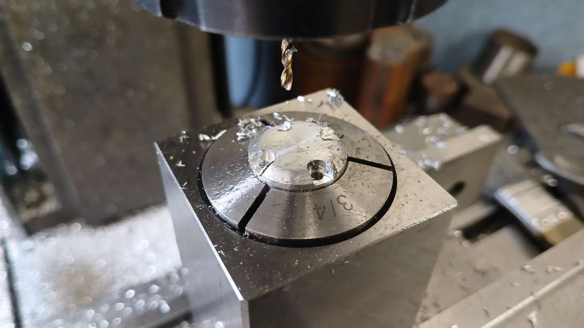

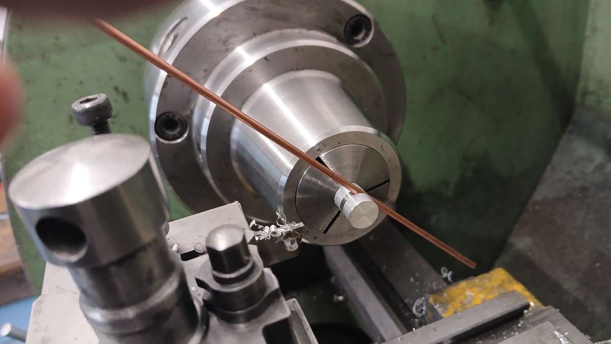

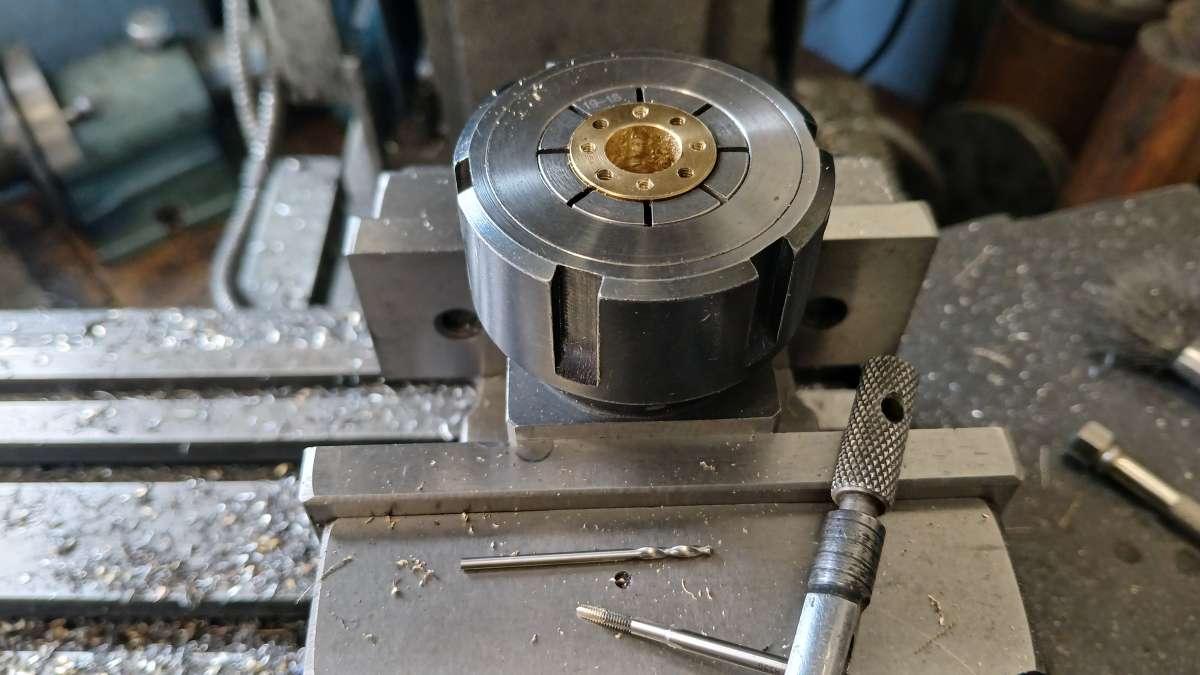

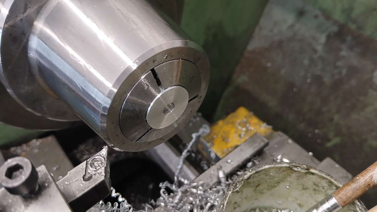

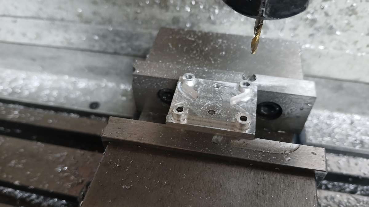

        There were no cylinder heads in the box of parts so I made some new ones, opting for aluminium instead of the specified brass. The backstop in a 5C collet made getting them all to the same thickness easy. I reduced the recess in the top of the head down from 3/8″ to 5mm a sI could see no reason for it to be full diameter which just increases dead space. I also rounded over the top corner.
        20260918_144753
        Over to the mill with the 5C collet in a block slots were milled in from the edge to act as counterbores for the cap head screws and clearance holes drilled.
        20260919_085447

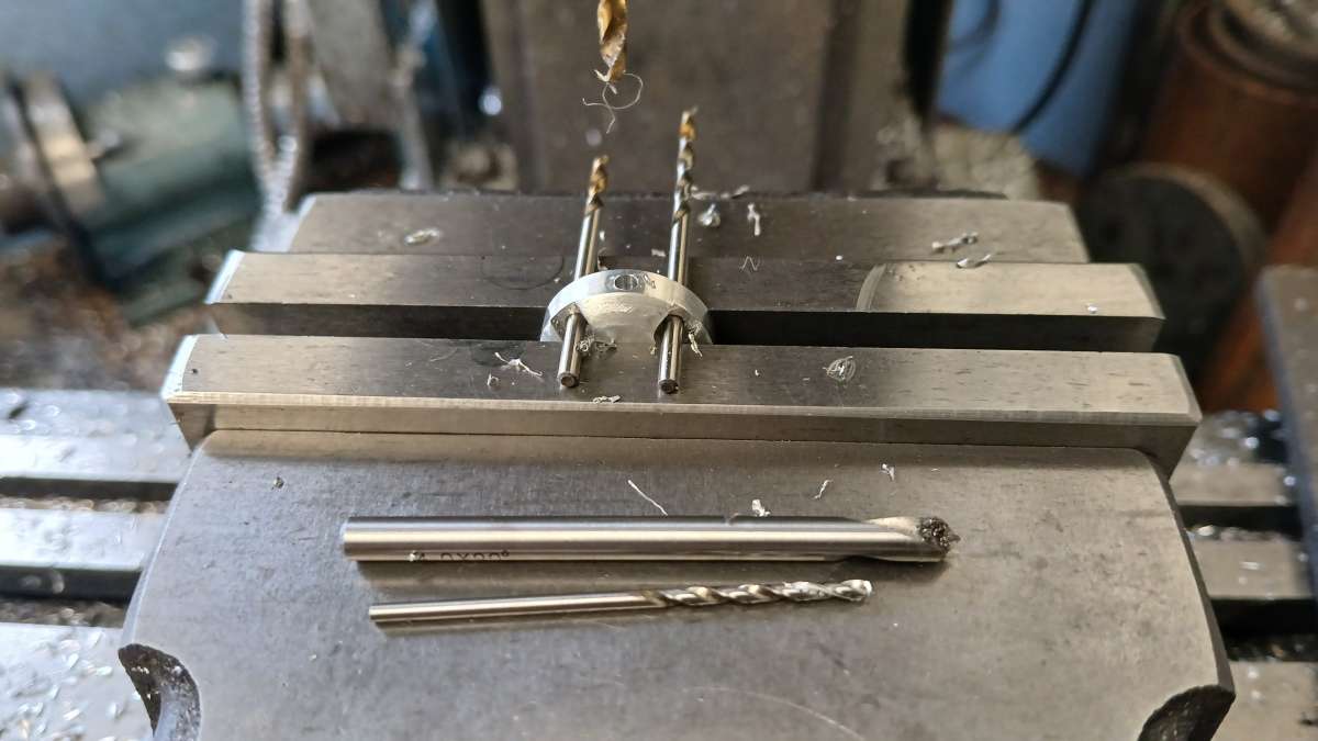

        Using a couple of drill bit shanks to align the heads the air passages were drilled and counterbored for the pipes
        20260919_094218

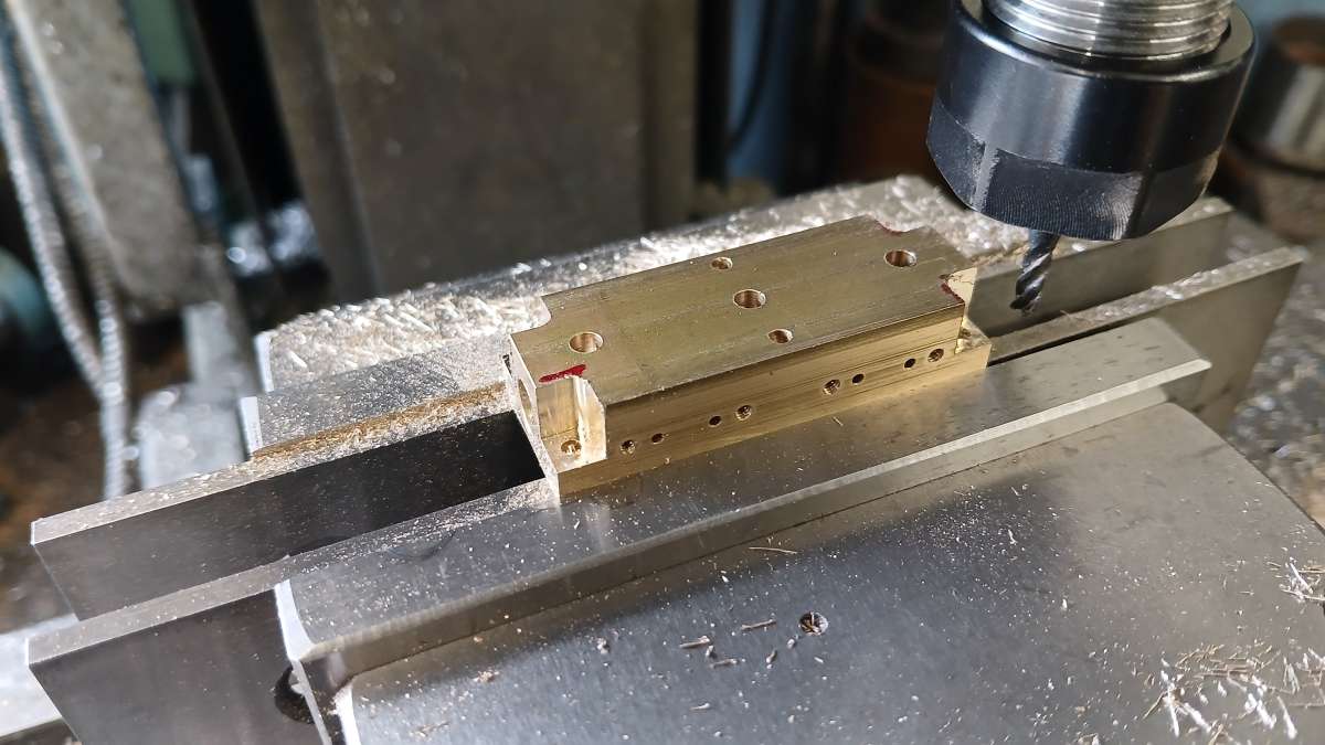

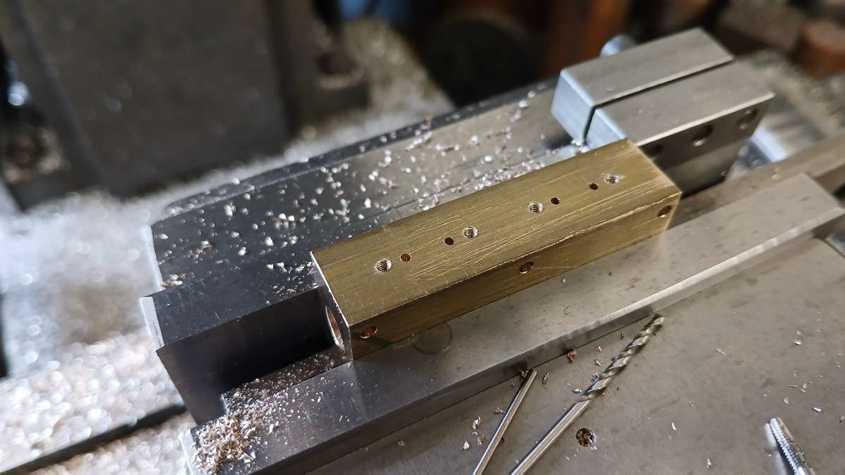

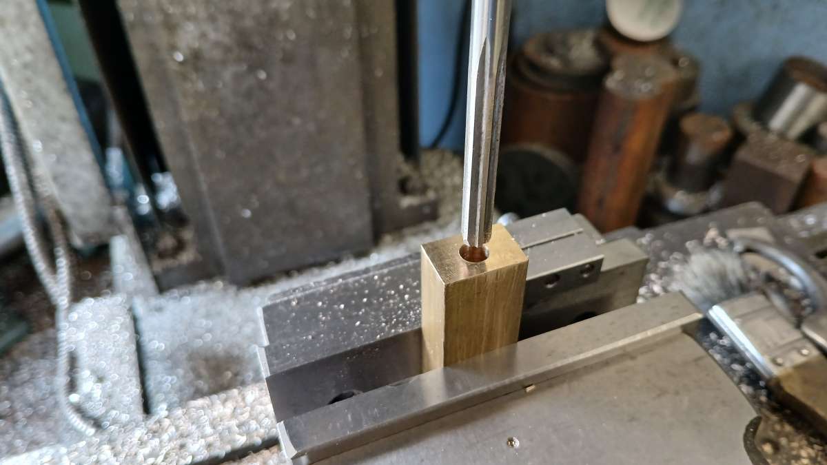

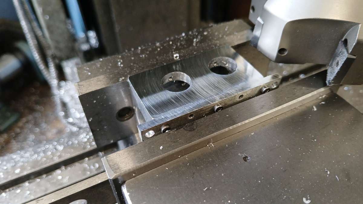

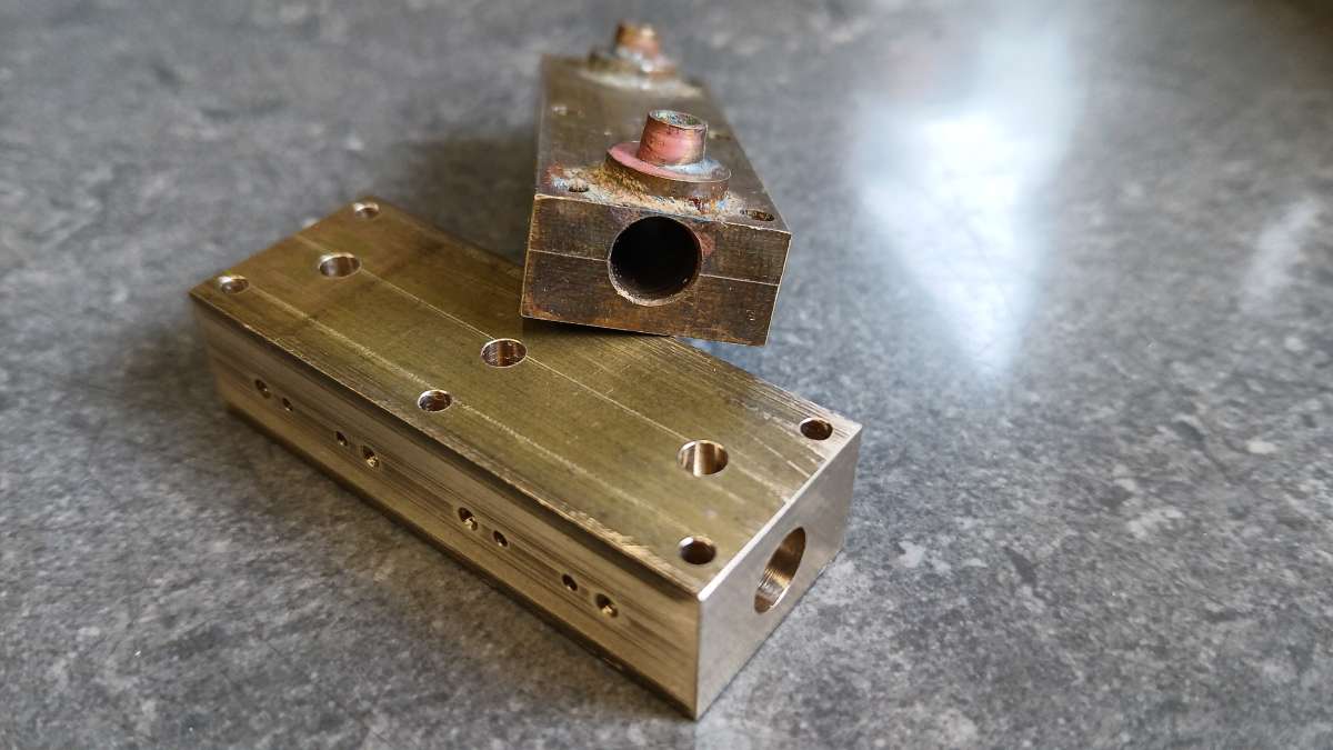

        There is a lengthways block of brass that fixes to the top of the crankcase and houses the rotary valve, the hole for which had wandered badly out of position so a new one had to be made. I used 1/2″ thick material rather than the suggested 3/8″ and left it over thickness so that I could mesh the gears correctly when I got to that stage.
        I drilled 6.1mm to approx mid way from each end and then ran a 1/4″ machine reamer right through the full 2″ length
        20260919_122708
        Then added the various holes foar air, exhaust and mountings
        20260919_135801
        20260919_142110
        Here you can see how the hole had wandered on the original which would have thrown the gear mesh out ( more of that later) and had also required those ugly bushes to be soldered to thetop as there was not enough thickness above the hole to take the exhaust pipes.

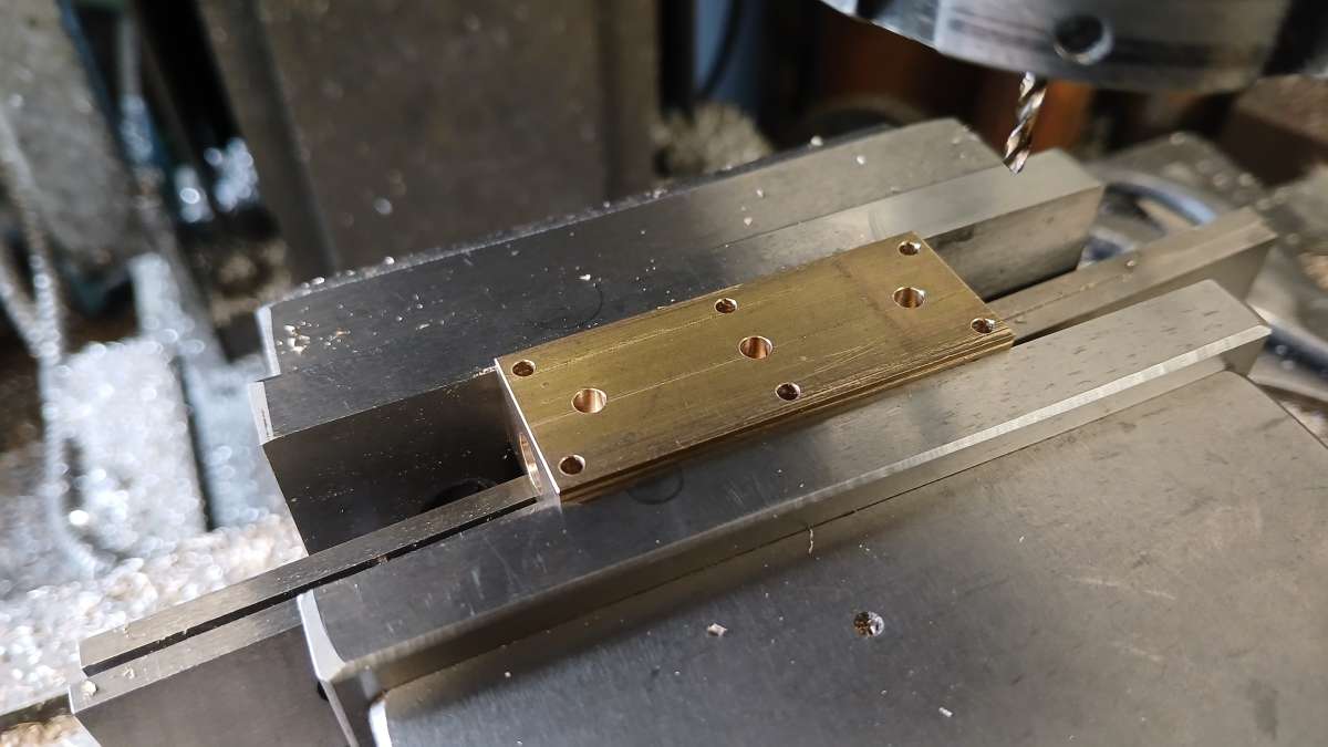

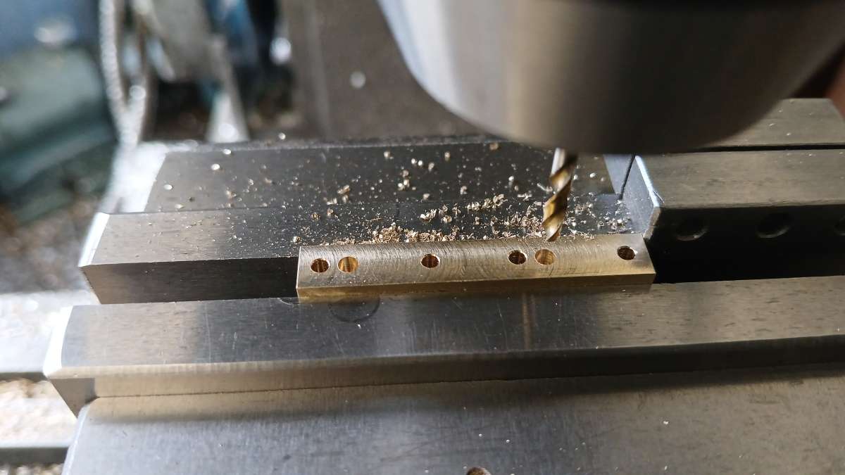

        The manifolds which run down each side of the valve block were fairly straight forward, I moved the positions of the air pipes so that they lined up with the ctr of each cylinder rather than being off to one side as per the original hole layout.
        20260920_090940
        Starting to look a bit like an engine now.
        20260920_102729

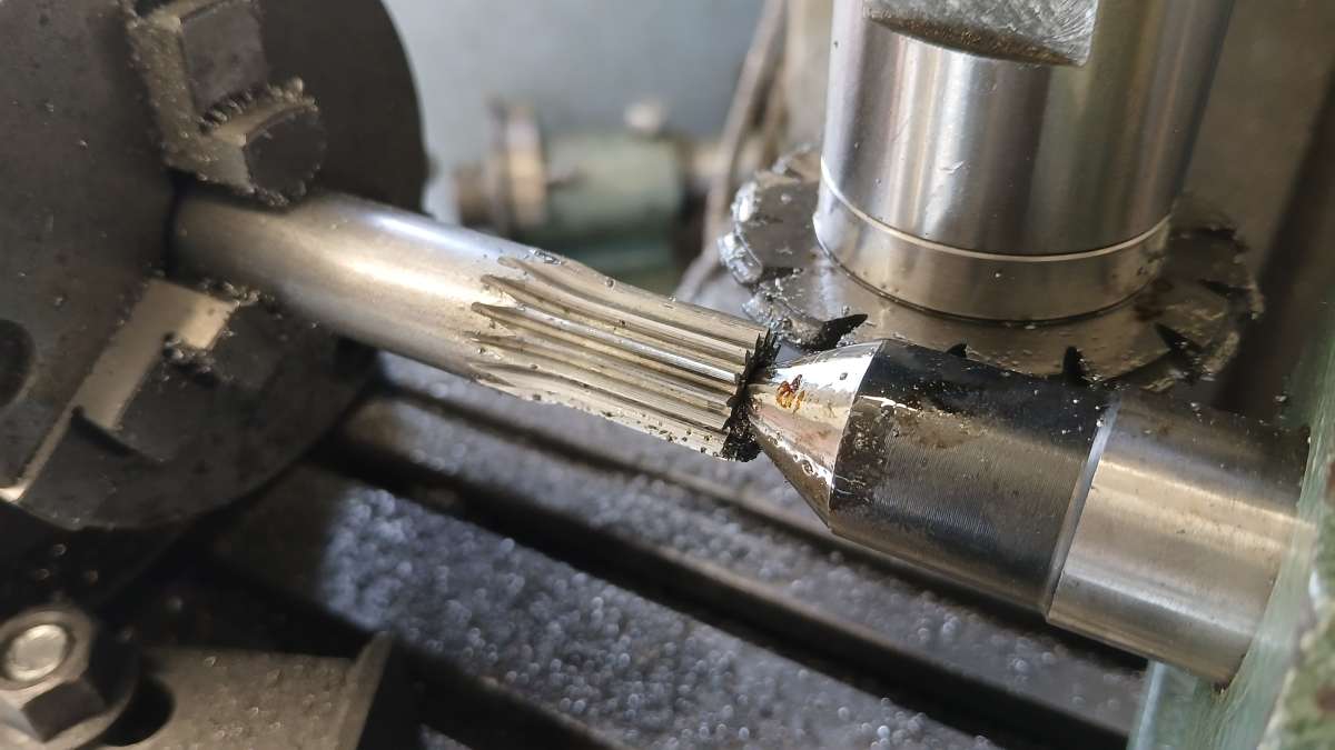

            The same could not be said of the crankshaft. All the running surfaces were incredibly rough and would soon have eaten their way through anything running against them. Three of the four crankpins were oversize and one just about onsize depending where you took the measurements as all were tapered. It also looked like the parting tool had wandered sideways as the cut got deeper. But I took on the challenge.
            I cleaned up the long shaft and stub shaft so that the flanged ball races would fit and thought I would offer up the shaft into the crankcase to check the various lengths, guess what the hole in the crankcase was too small.
            You can see some of the poor machining in this pic where it should drop into the hole
            crank fit
            That was soon sorted with the boring head, luckily I had not made the aluminium plug/bearing housing that goes in the hole yet.

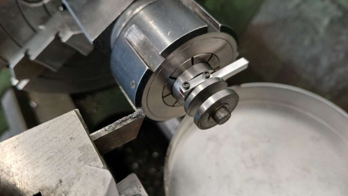

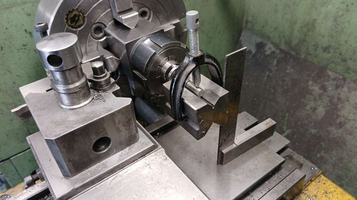

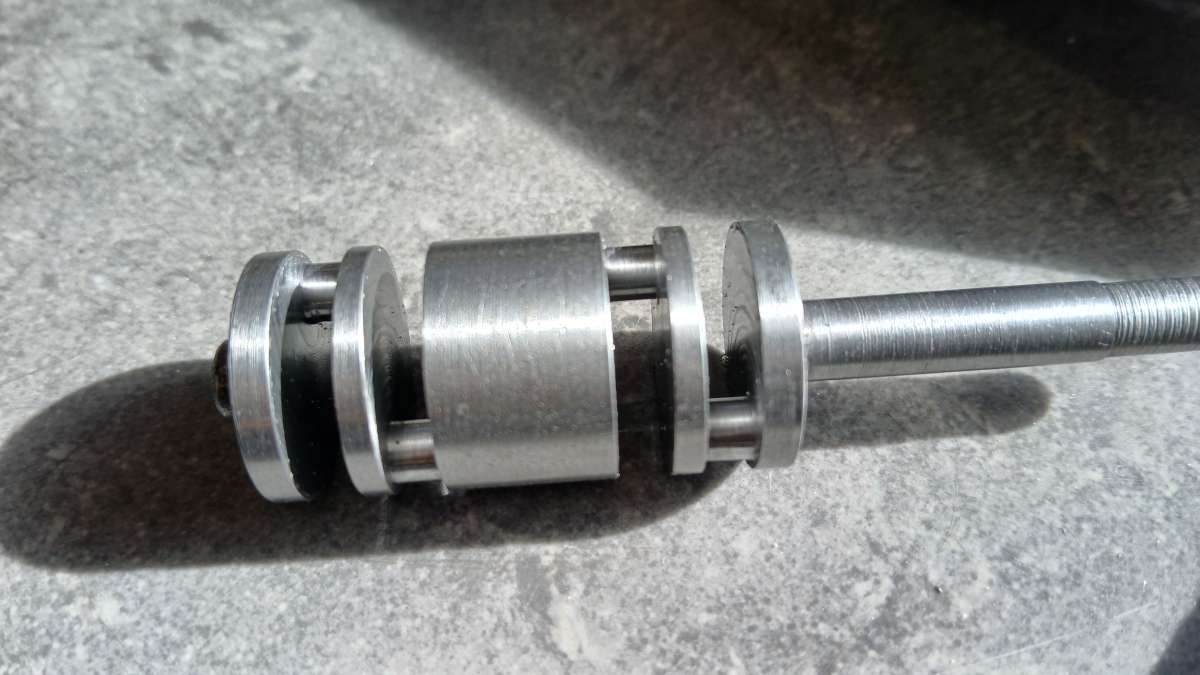

            As the gap between webs was only supposed to be 0.140″ it was not easy to clock the crank pins into position so I made the job a bit easier by holding a square ER collet block in the 4 jaw and set that with the correct offset. It was then just a case of rotating the crankshaft to position each pin. I used an HSS parting tool as I needed its full flat end width, a GTN-2 insert with it’s radiused corners would not have worked. The pin on the left has been finished the other is as it came to me.
            20260925_145702

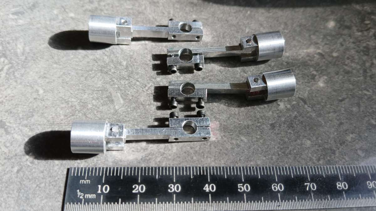

            As I could only get in to measure the diameter with the digi callipers I left the crankshaft in the lathe and went over to the mill to make the conrods so the pins could be checked against their reamed holes. The was a set of part built rods in with all the parts but as they had been made from steel (possible 1/8″ sq key steel) is did not fancy running steel on steel. Some offcuts of 2014 aluminium were found and machined to 1/8″ square section and then milled to length before drilling and tapping for M1.6 fixings.
            20260926_101237
            Once assembled, three were drilled and reamed 3/16 and use dto check the pins. The undersize pin cleaned up to a running fit on a 4.4mm drilled hole. They were machined so the assembled rod would rotate with light finger pressure but not drop with it’s own weight. Then a quick “shoeshine” with a thin strip of well worn 240g Emery cloth against the rotating pin just polished the surface and allowed the rod to drop. The metal dish below it to save loosing anything in teh swarf tray as the big end caps are only 1/2″ long.

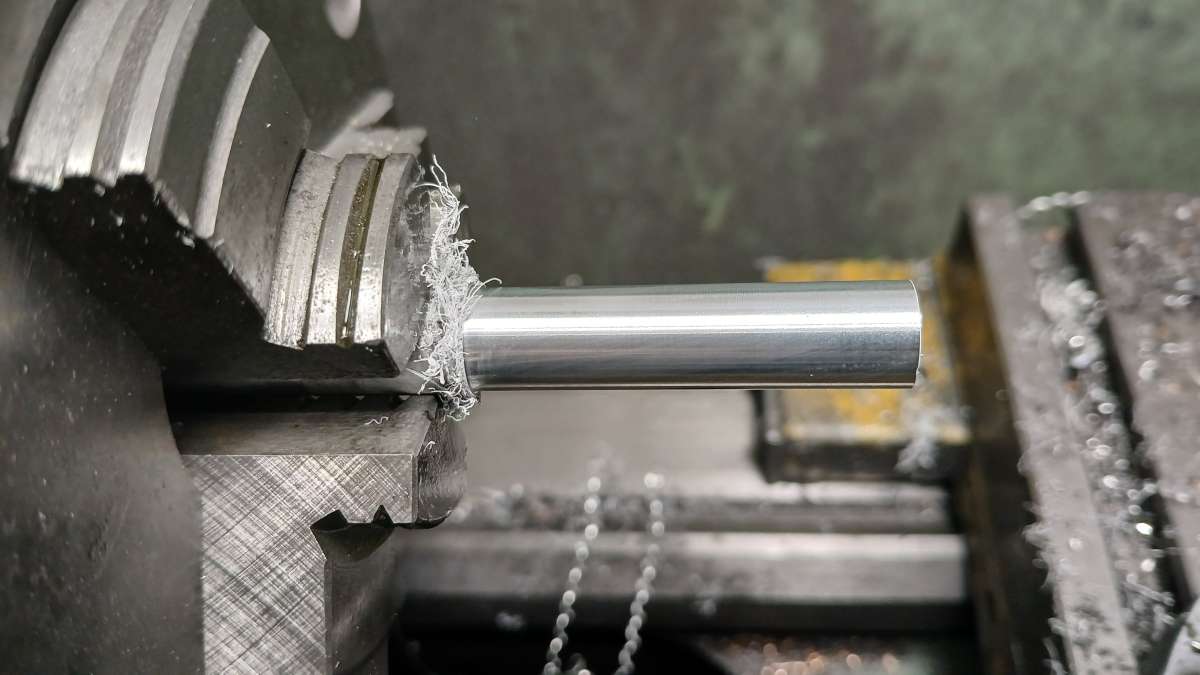

              Next I decided to make the rotary valve, this is specified as silver steel but I though stainless would be better and it was actually a slightly closer fit in the reamed hole. First job was to reduce the end to fit the gear, I had already spotted that the hole in the gear was larger than the specified 3/16″ and by the looks of it the previous builder got as far as drilling about 15/64 and realised his mistake and did not go as far as reaming 1/4 which would just have slid along the 1/4″ shaft.

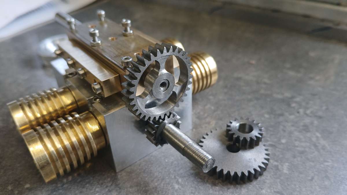

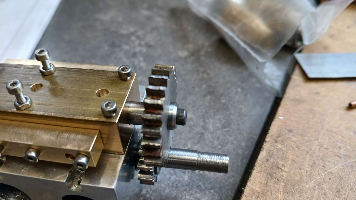

              With the gear on it’s slightly reduced spigot and retained by the “washer” detailed in the drawngs I offered it up to the part assembled engine. Now as I had left some metal on the bottom of the valve block things should have gone together with a lot of backlash in the gears but as you can see they would not mesh as the ctr distance was too small.
              20260927_142003
              It was at this stage I realise dthe crankshaft hole had been placed far too near the top of the crankcase and that would also have explained why I felt the conrods were getting too close to the inside top surface. My options were to either make a new crankcase or something else. In the end I opted for something else in the way of some new gears, this was partly decided by the poor finish on the larger gear, if you look at the crests of the teeth in the photo above you can see how uneven they are along their length so may not have run well even with the correct PCD

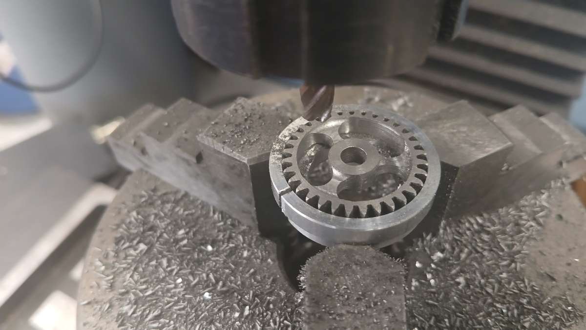

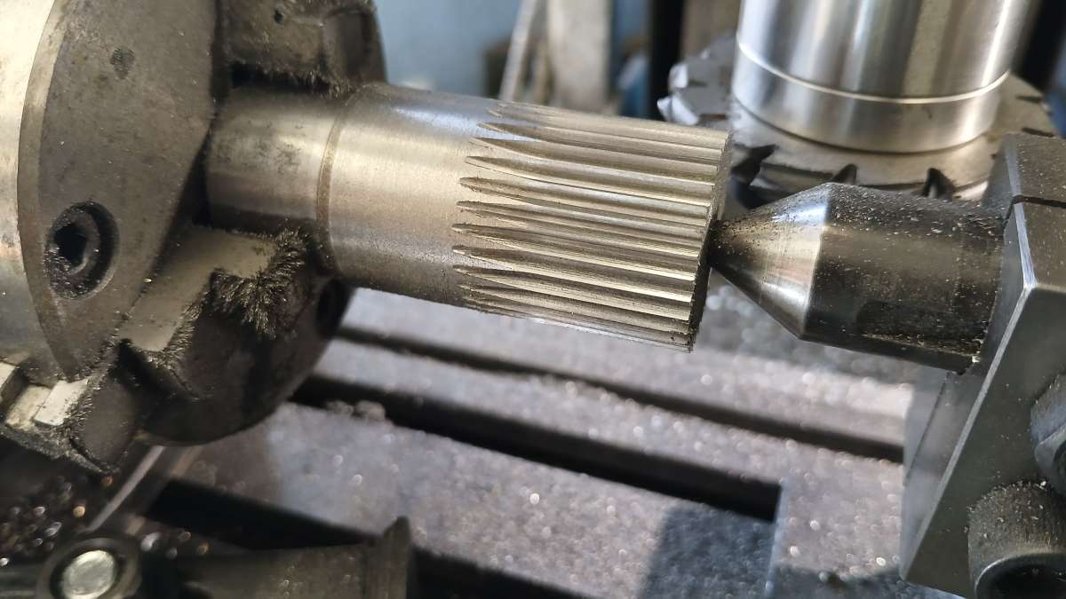

              By reducing the gears from the original 30DP down to 32DP I could get them in with just a little to come off the bottom of the valve block as originally intended. The large one was cut from cast iron bar and I cut the stick long enough for two.
              20261001_142505
              The same for the smaller one which was cut from steel
              20261001_150042
              A few minutes on the rotary table had the large gear looking a bit more interesting. The central hole was the correct 3/16″ this time.
              20261002_145038
              And they went together, still the material to come of the valve block which is why the gap is large

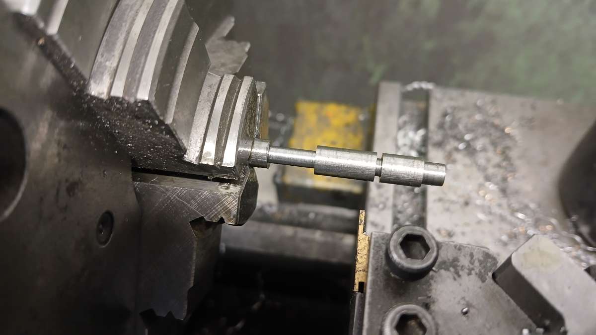

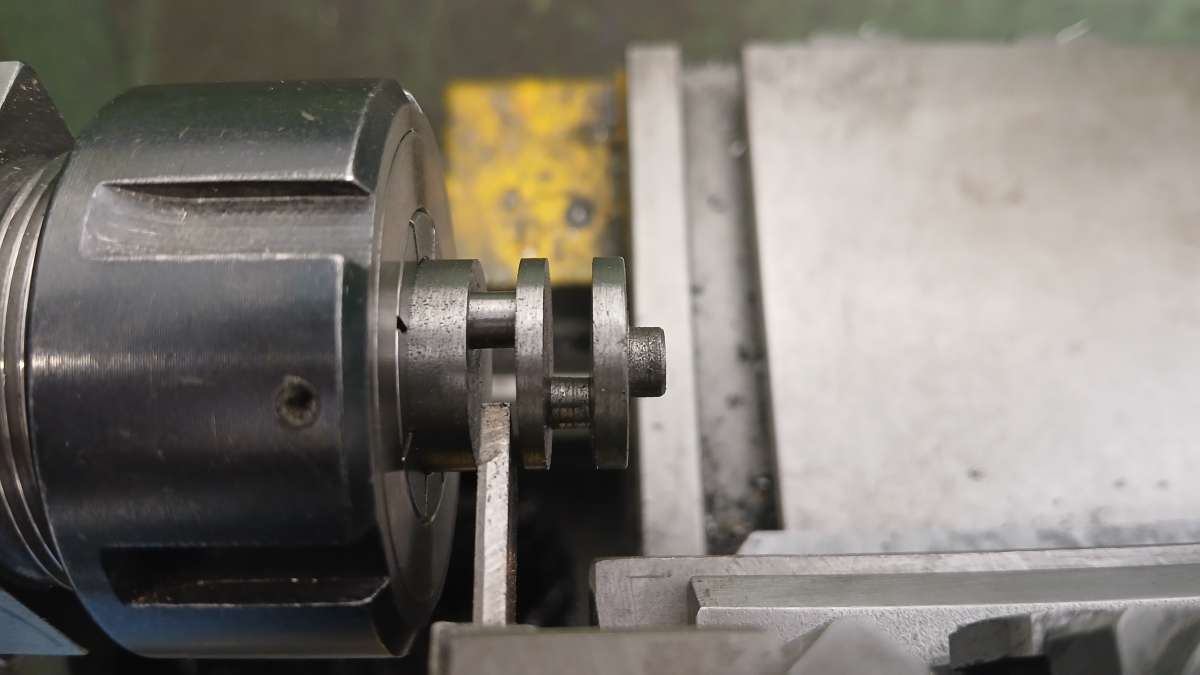

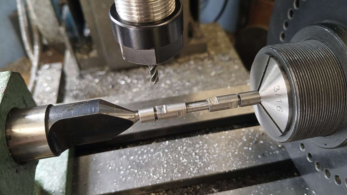

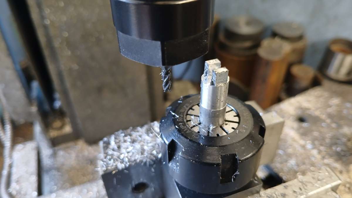

              I could now get on with the valve, just a case of cutting the groove nearest the end, moving the bar out of the chuck a bit more and doing the next groove.
              20261003_092903
              I used the 5C spin indexer to position the cuts at 90deg as I can get in closer than a chuck on the rotary table allows. The flats are what open the various drillings and passages to allow the air in or out.
              20261003_134849
              With the valve block milled to final height the pockets could be milled in each corner to clear the screw heads.

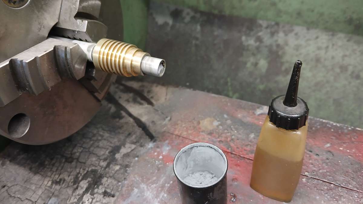

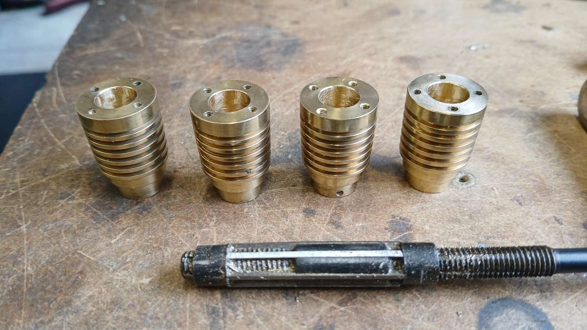

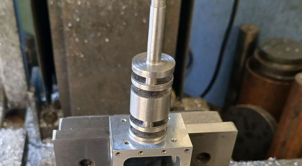

                Before making the pistons, I thought it best to lap the cylinders so an odd bit of 10mm dia aluminium tube was turned down to a close fit inside the now all the same size cylinders. That is the paint layer at the chuck end not swarf.
                20261004_081723
                Some 1000grit silicon carbide powder mixed with a little oil made a suitable paste to give each cylinder a quick lap.
                20261004_083002
                It was then just a case of turning some 10mm aluminium down to size for the pistons using the cylinder as a gauge to get the correct fit. These little pistons have a forked end machined at the bottom to take the conrod.

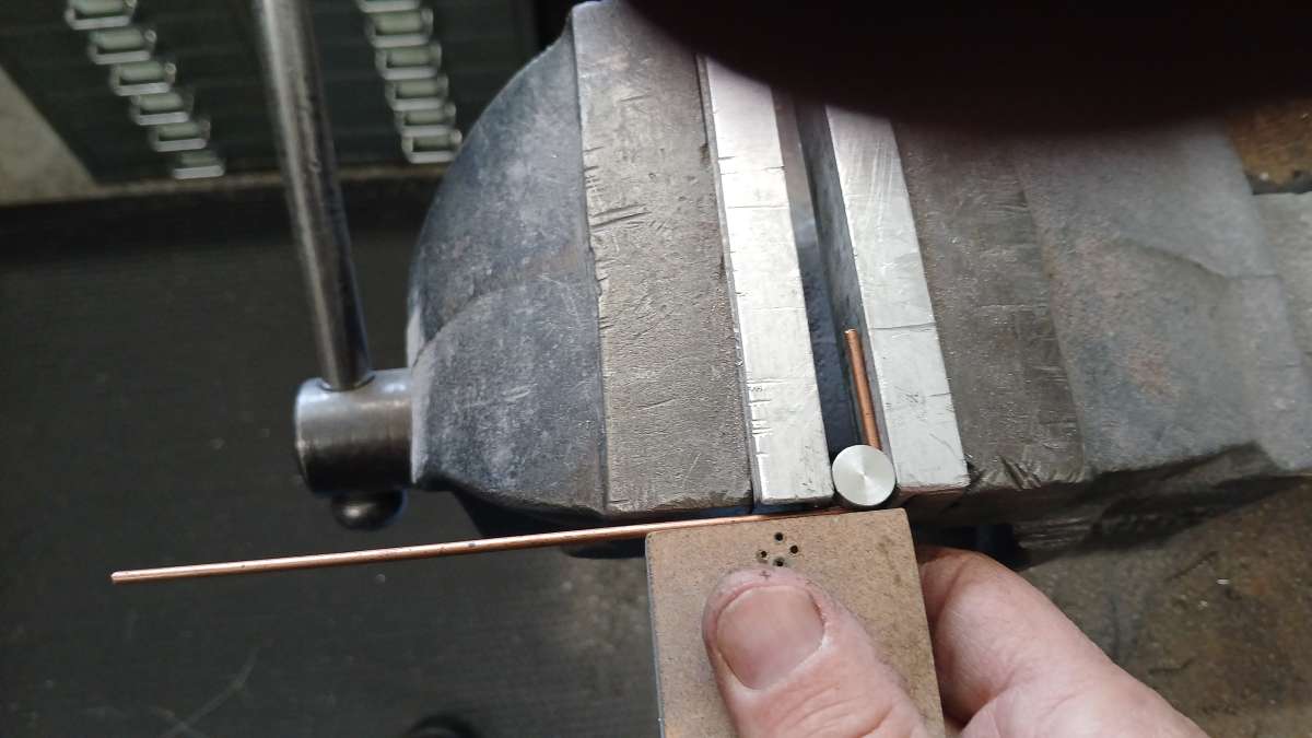

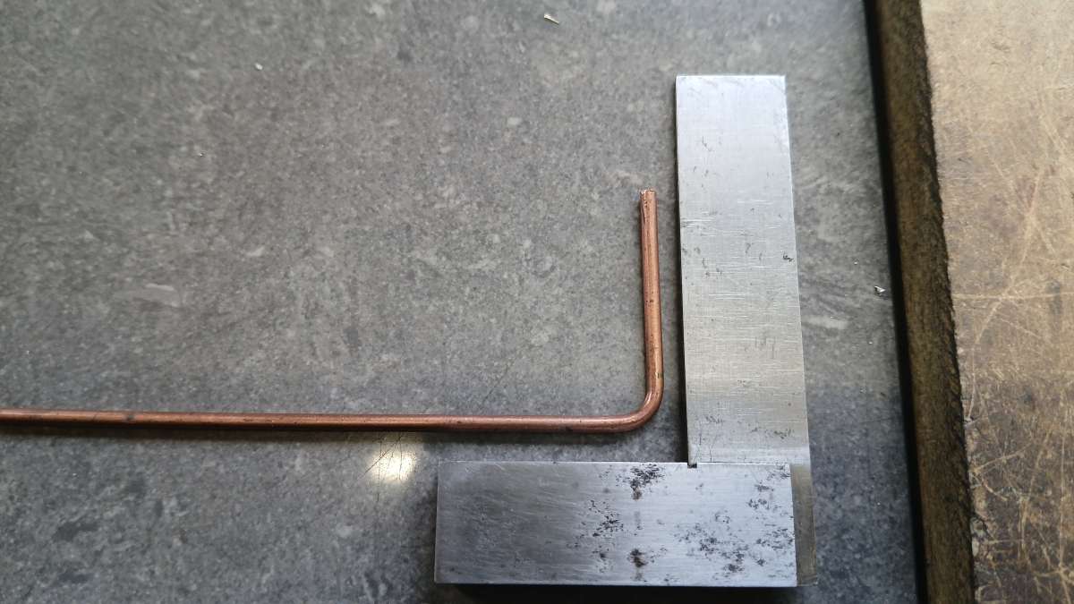

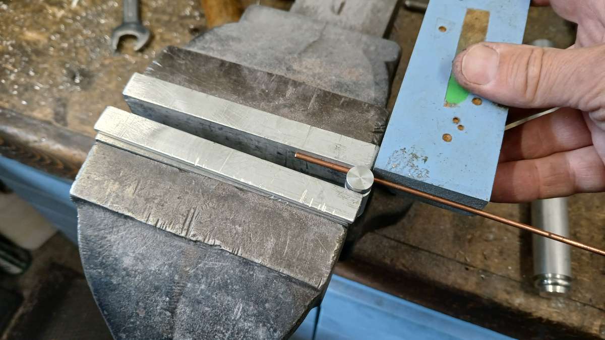

                As you know I’m not one for tool making so no fancy pipe benders for me. Just a groove cut in the end of a bit of bar the width and depth of the tube to be bent.
                20260927_085128
                Then hold the two in a vice towards one end and push the pipe round with a bit of something flat, MDF in this case
                20260927_085450
                20260927_085757_001
                Rinse and repeat for the other pipes needed
                20260927_085840

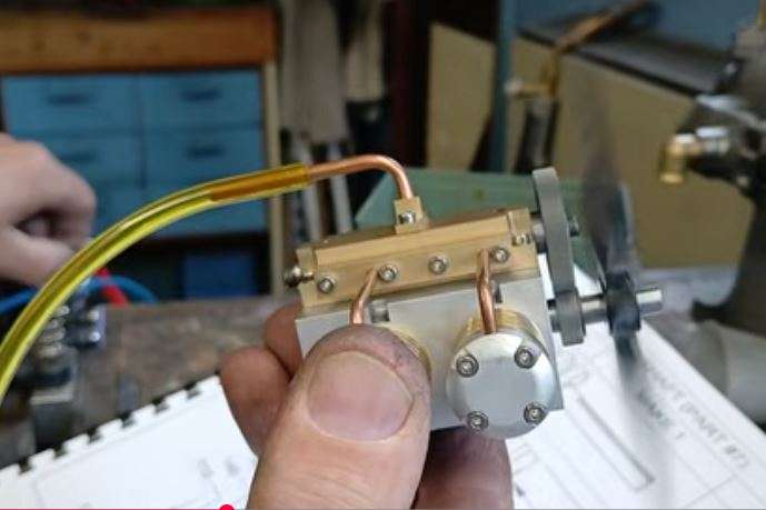

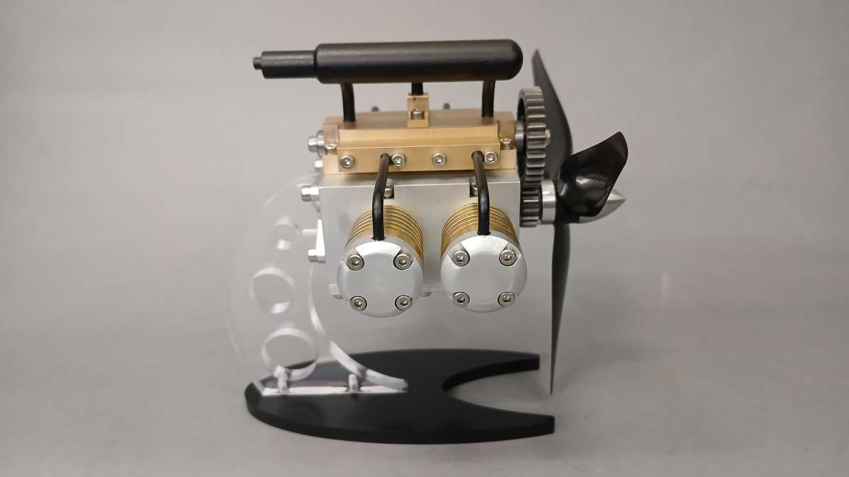

                That gave me enough parts to see if the thing ran or whether there were any more hidden features that I had not spotted. I did not run it too fast as the prop os only pushed on for now.
                #868989

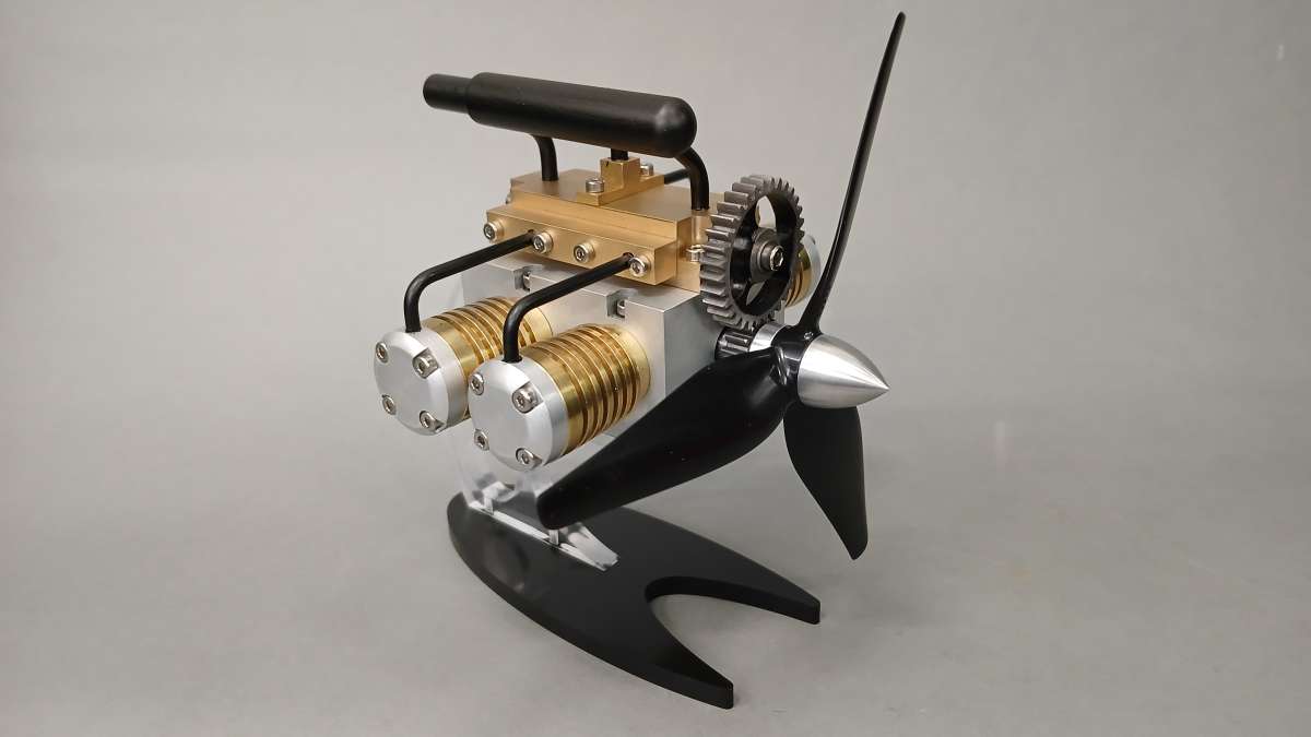

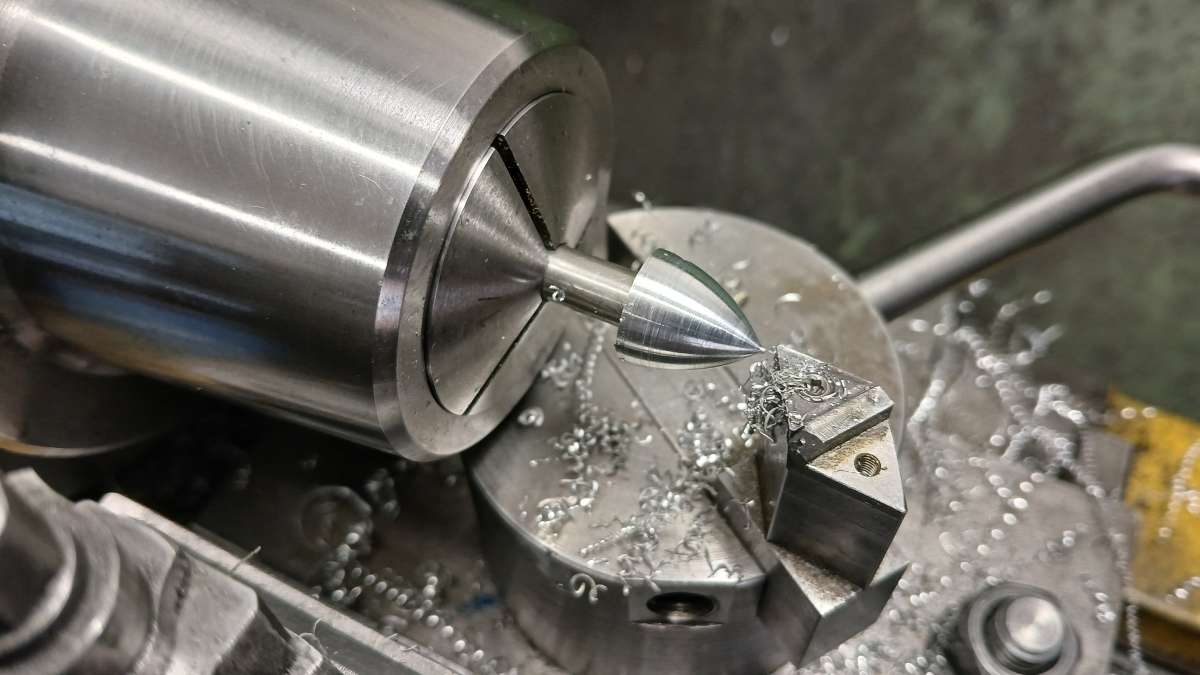

                  With a running engine the last few bits could now be done to make it look nice. First was a prop spinner that was shaped using my ball turner. I also had to add a small spacer between the prop and crank gear to ensure that the blades cleared the head of the screw that retains the larger valve gear.
                  20261006_122012
                  You can also see in this still from the video that I have added spacers to keep the gears clear of the cranckcase and valve block, there was nothing in the original design to stop the gears rubbing on things.
                  modifications

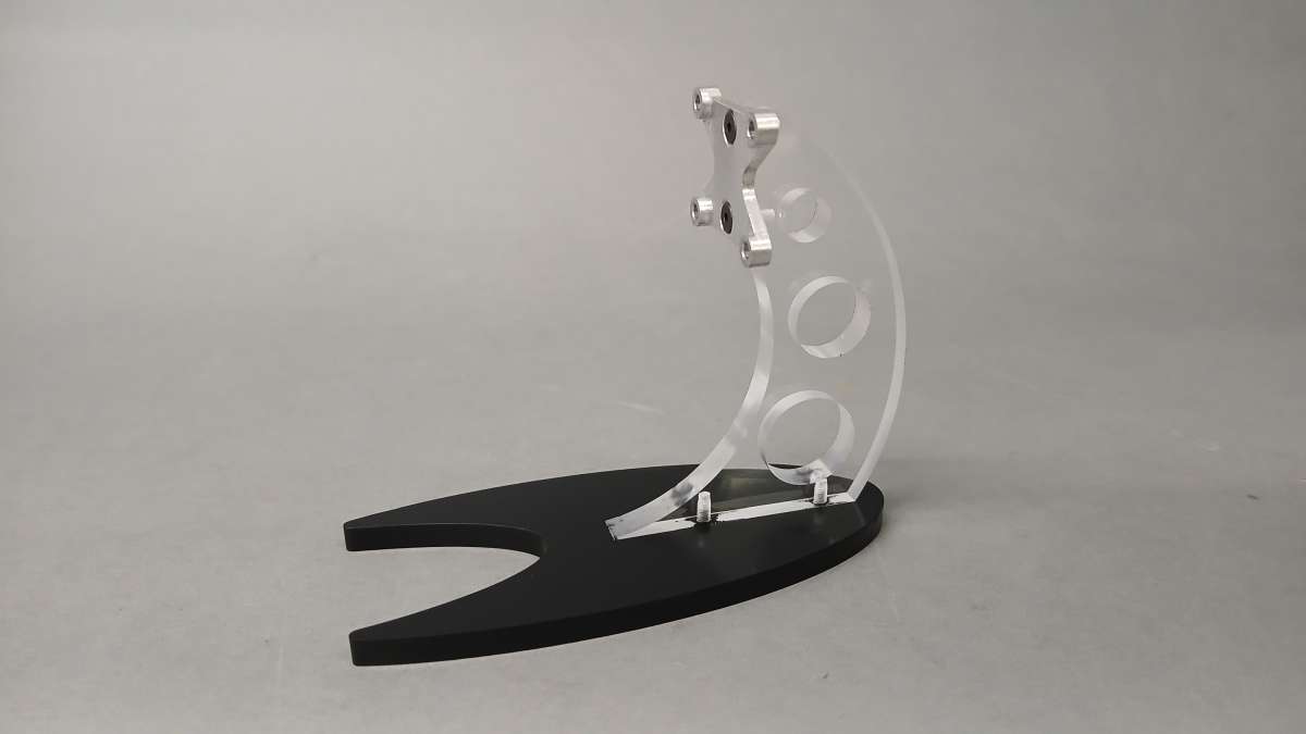

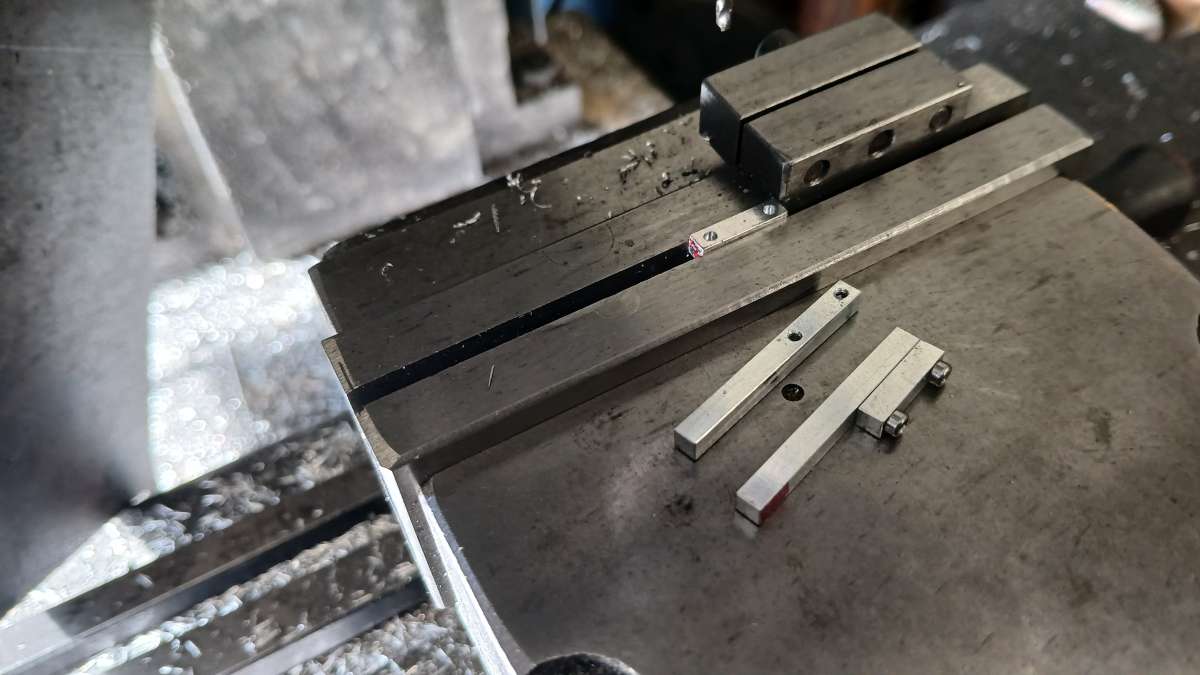

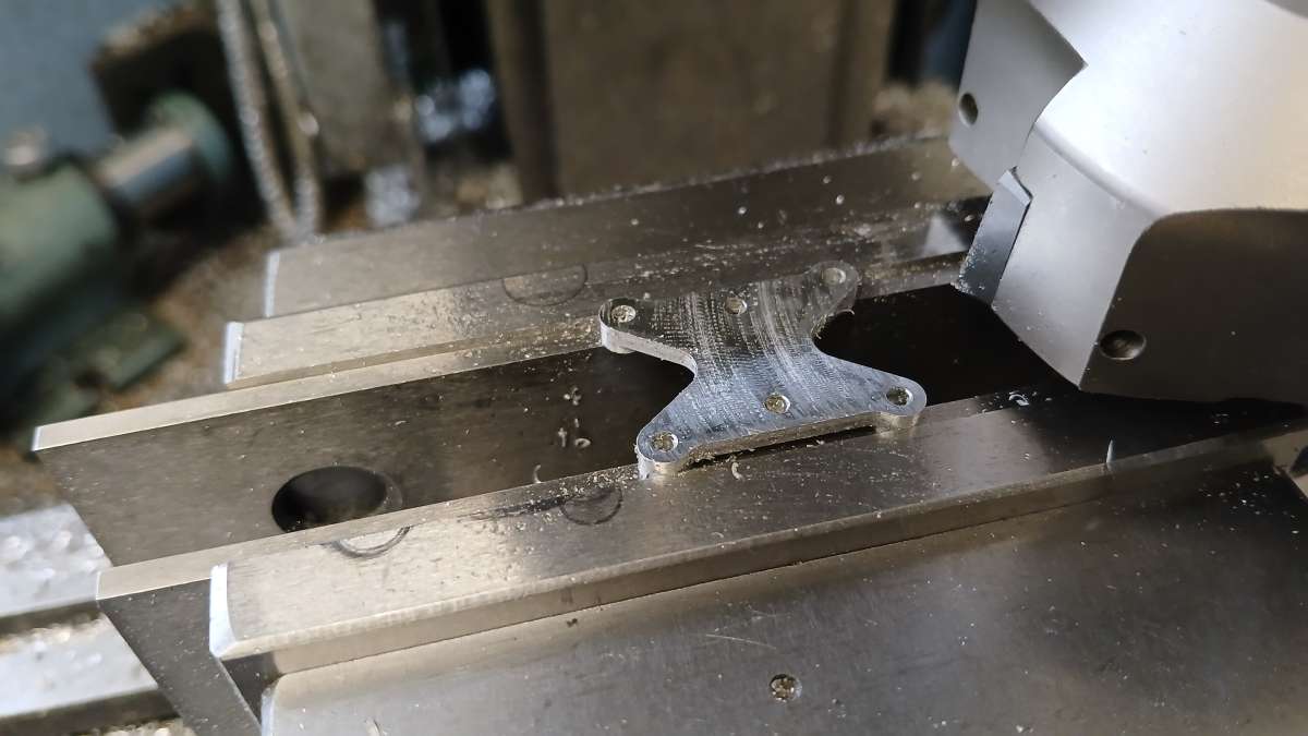

                  The drawings show hole positions in the crankcase for rear mounting of the engine but no details of a stand, so I made one up. The rear bearing carrier has a press fit specified but I did not want to do that as getting it out would mean pressing on the end of the crankshaft which could bend it. So I went with a push fit (actually held in the video above) and designed the stand bracket to ensure that the bearing carrier could not come out. It was shaped on the CNC
                  20261007_114032
                  And then the excess material use dto hold it by decked off on the manual mill
                  20261007_115922

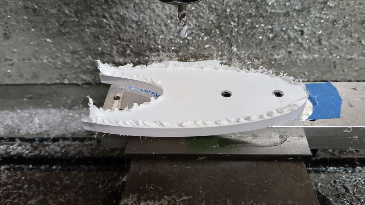

                  The remaining parts were CNC cut from scraps of acrylic sheet
                  20261010_140150
                  20261011_091254

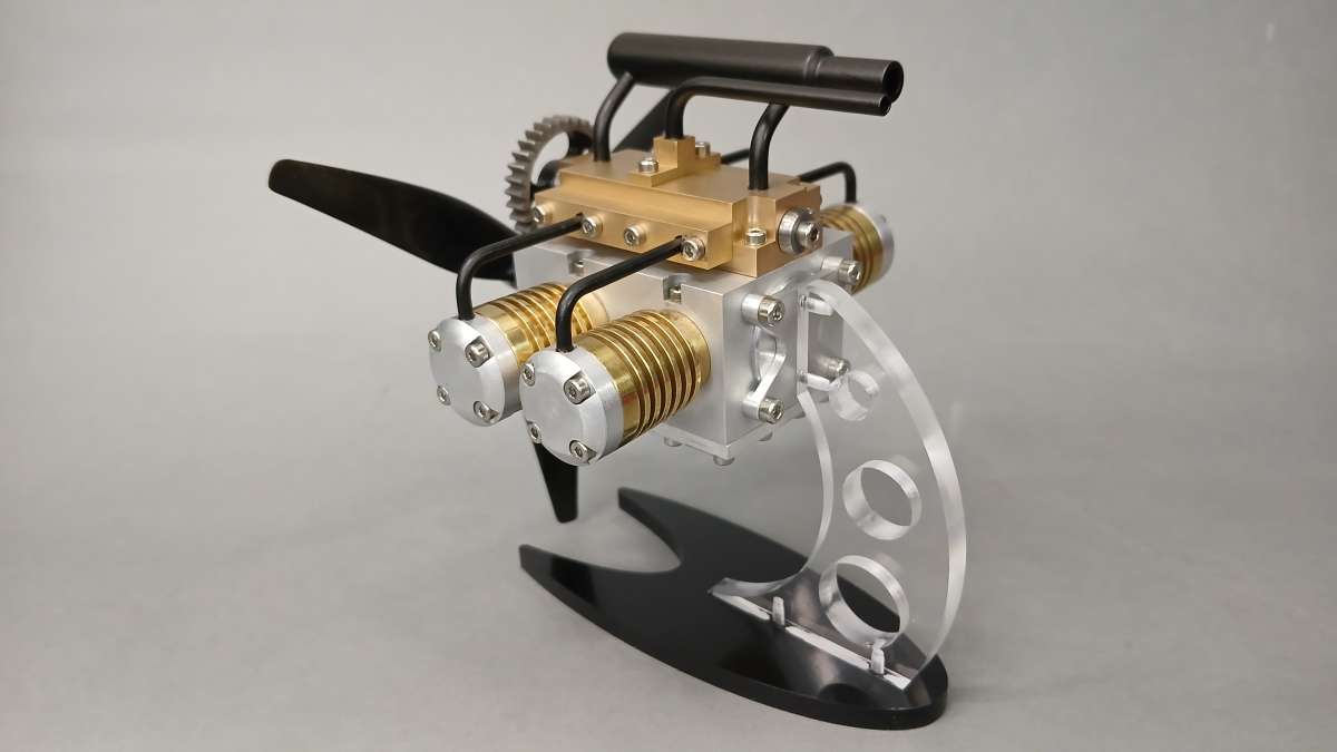

                  The exhaust “silencer” was the only part that did not have any errors, I added the missing pair of pipes and that was it. I think it actually sounds better with the silencer fitted.
                  20261011_091532
                  20261011_091559
                  20261011_091615
