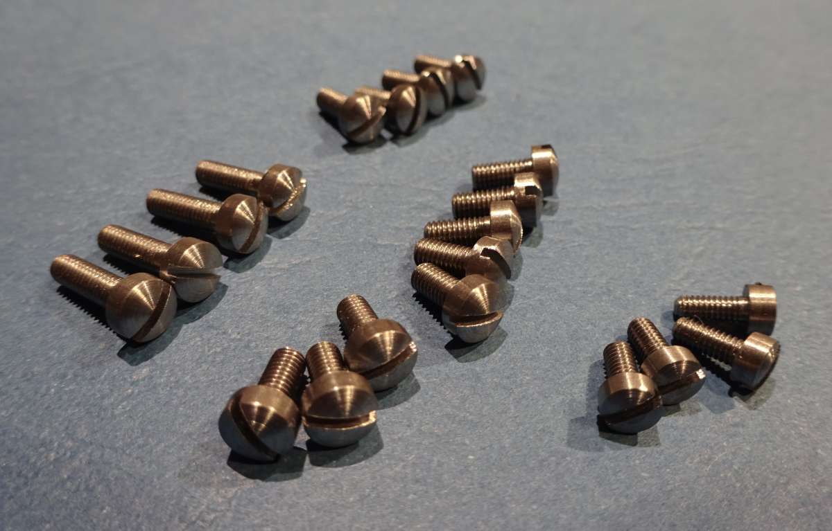

            Or do it a sI do when making screws for my engines. Turn shank and thread (knurl in your case). Saw off from bar a bit over length. Hold by threaded end as appropriate and use a form tool to shape the head. Works well with batches of screws as well as singles

                                This is my form tool for creating domed ends:
                                Form Tool
                                It was ground free hand and is a fairly sharp curve as it is mostly used for rounding the end of studs.
