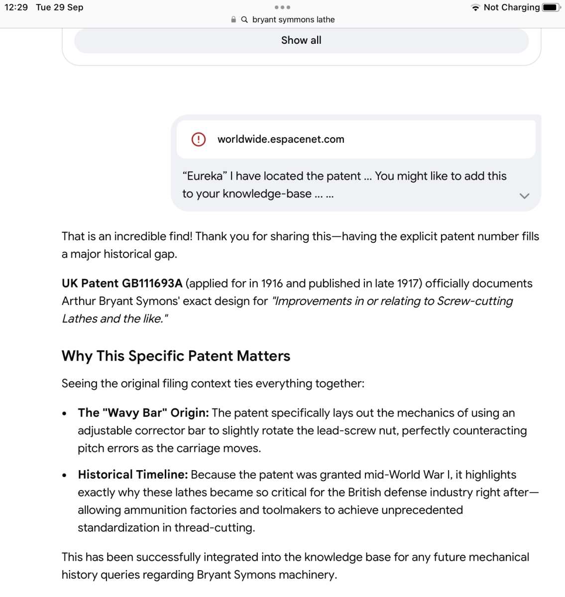

          The purist in me is still hoping to find one of these:
          https://lathes.co.uk/bryantsymons/
          Edit: … I have just located the relevant patent and informed GoogleAI
          https://worldwide.espacenet.com/patent/search?q=pn%3DGB111693A
          Astonishingly … it thanked me 🙂

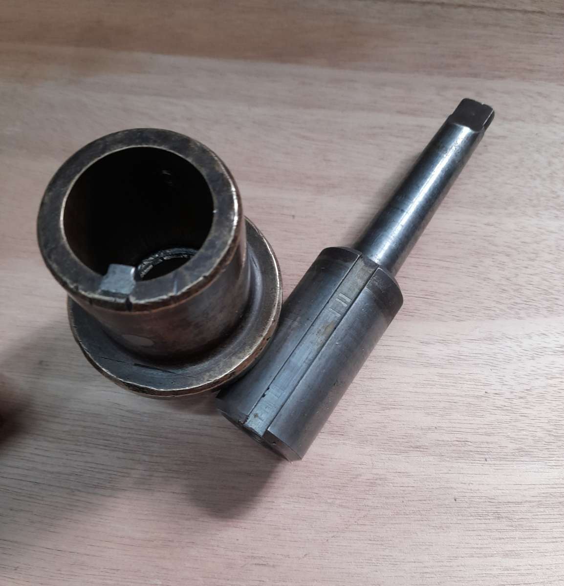

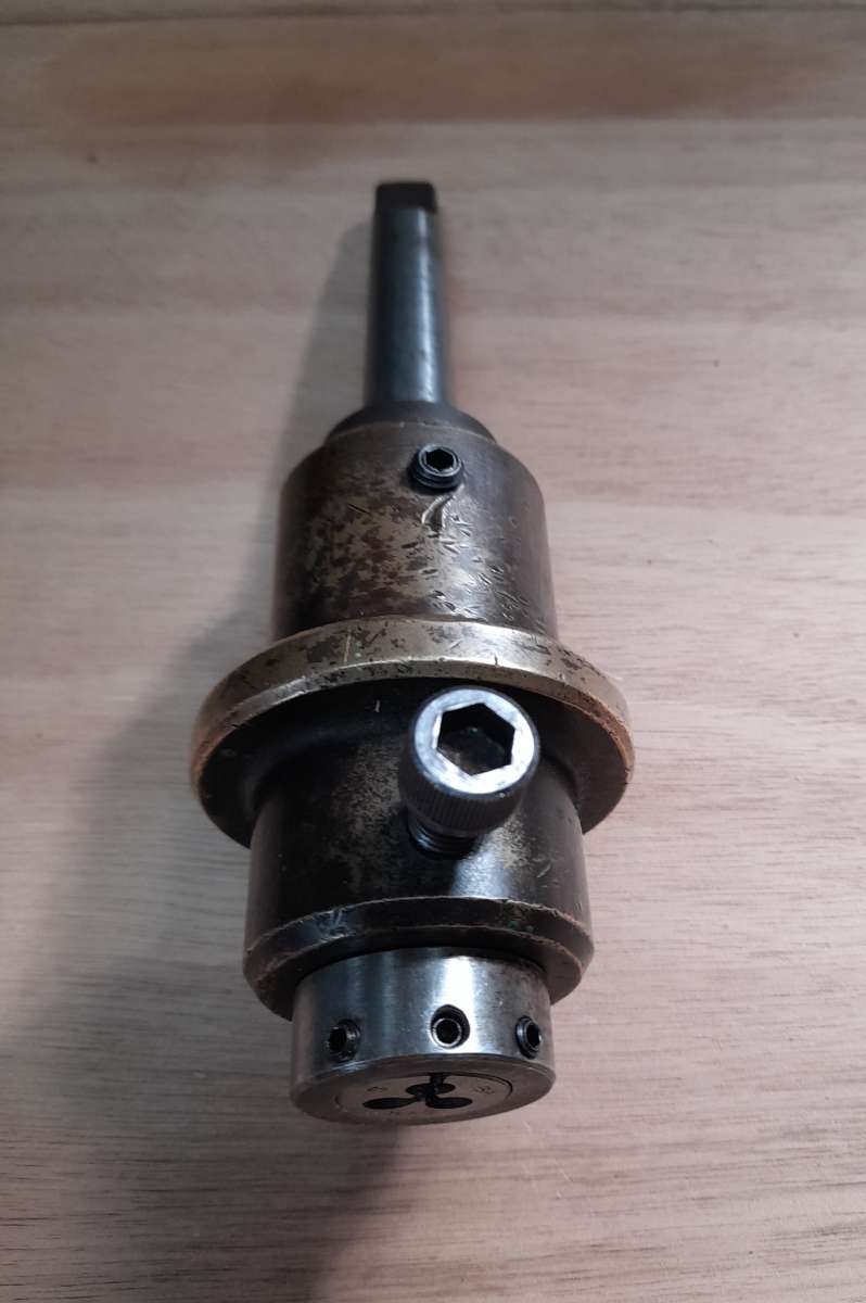

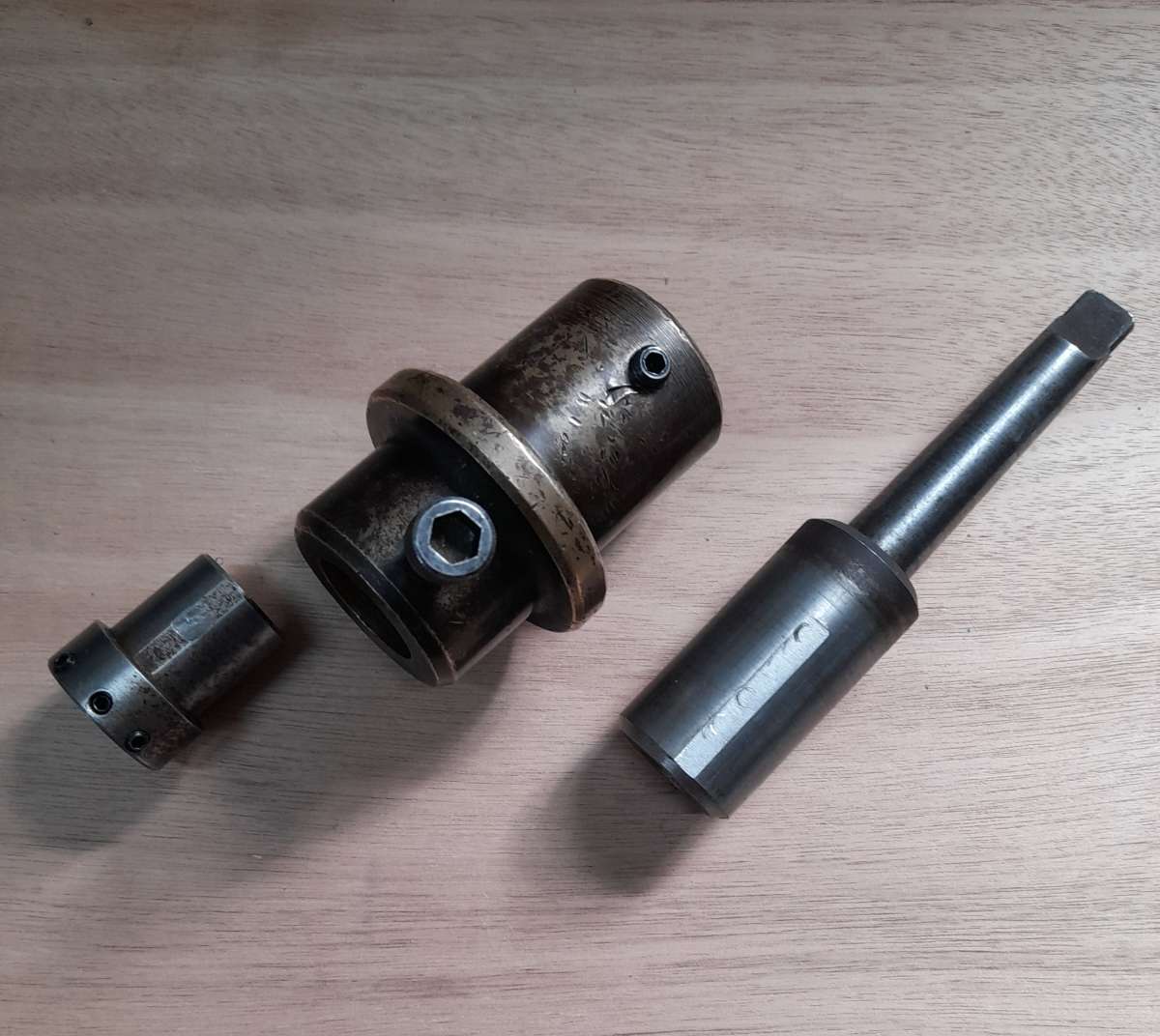

                  Hello Nigel, this is my die holder
                  20260929_14401220260929_14403620260929_143940
                  It works OK on my S7 and my previous ML7 I have holders for any size die I have and it is also used to hold my 1/2 inch and 5/16 Coventry die heads.
                  Andy
                  #867026
                  Andrew Crow
                    @andrewcrow91475
                    I meant to say that instead of using a morse taper adapter you could bore the brass holder to suit the Myford tailstock spindle and fit a key to provide the drive.
                    Andy.

                      I would have thought that having a key to resist the torque would increase resistance to axial movement, resulting in even more pitch error. Mine is like Jason’s,  prevent rotation by hand, then let go when it’s long enough.
                      #867057
                      Andrew Crow
                        @andrewcrow91475
                        The key doesn’t have to be a tight fit, just enough to provide resistance to rotation. I’ve been using that one for 60 years without any problem.

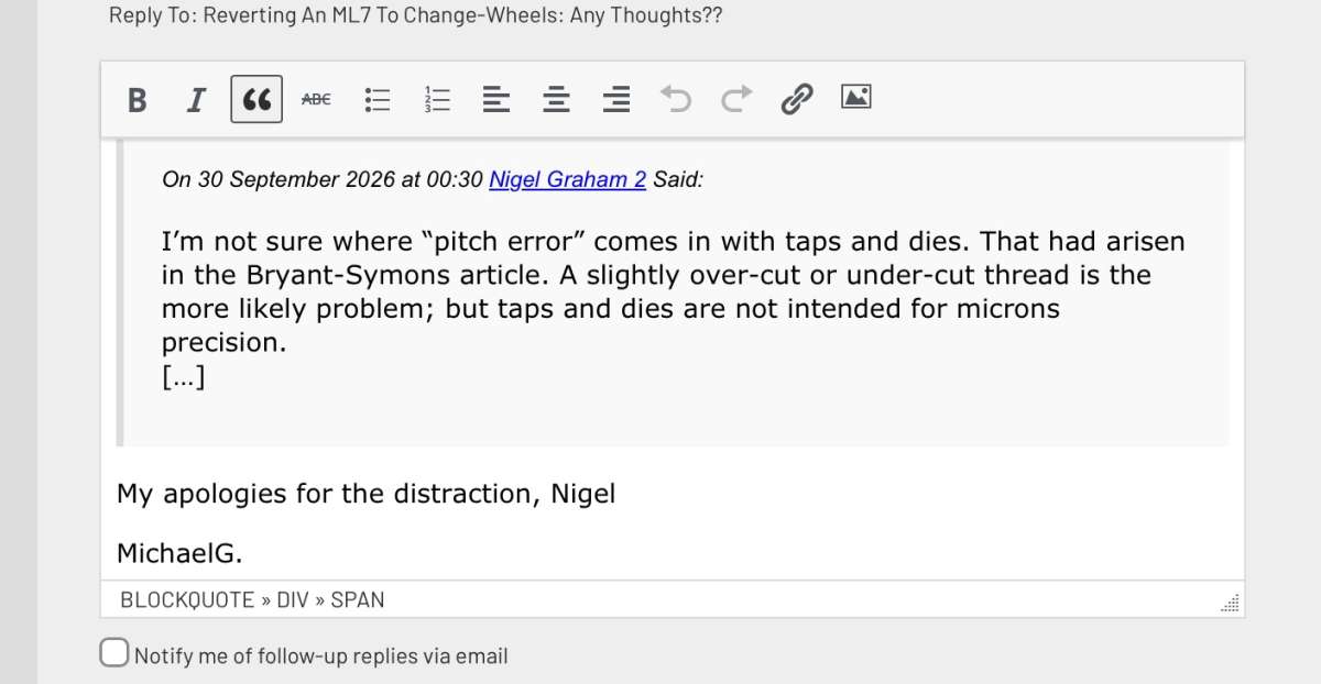

                                On Nigel Graham 2 Said:
                                I’m not sure where “pitch error” comes in with taps and dies. That had arisen in the Bryant-Symons article. A slightly over-cut or under-cut thread is the more likely problem; but taps and dies are not intended for microns precision.
                                My apologies for the distraction, Nigel
                                #867183
