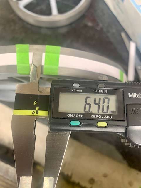

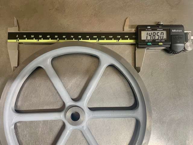

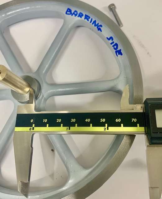

        OK, so I’ve used three measuring methods – just out of interest to see the relative accuracies:
        1) A strip of card wrapped around the smaller wheel, and its length (circumference) measured with a tape measure, then wrapped around the larger wheel and the difference measured with verniers:
        IMG_3620
        2) Measuring the chord length and its offest from the circumference using verniers:
        IMG_3622

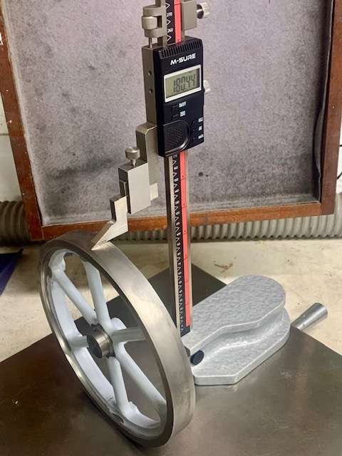

        3) Height gauge:
        IMG_3626
        Assuming the height gauge is the datum (as the most accurate method) Anyone fancy a bank holiday guess at the maximum and minimum deviation from this – on radius, in terms of thou – between the chord and tape methods?
        I’m going to use Jason’s spigot method as a double-check on the height gauge readings, and hopefully get it done this afternoon.
        Thanks all.

          I thought you wanted to do the measuring with the second one still in the lathe, if so height gauge method may be tricky.
          If off the lathe then stand the two side by side and measure the height difference with depth gauge or the back of your callipers.
          But as you have a height gauge then just clamp a flat plate to the bottom and you effectively have a vernier calliper.

            I did want to keep it on the lathe, but as mentioned I then thought that I really want to bore the hub and face the mating parts of the rim/hub in one setup, to reduce the chance of them being out of true. I’d machined the outer face first (as per the article method I think), which I suppose was a mistake.
            So with both wheels off the lathe, I’ve now just measured them directly with the height gauge, and will take off the measured difference once the second wheel has been re-set.
            I tried the other two methods out of interest to see how accurate (or inaccurate) they would have been.

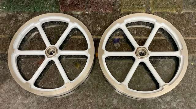

              Mounted the second wheel and machined it to the o/d of the first:
              IMG_3627
              Counterbored the hub – I hope this doesn’t interfere with the broching process too much:
              IMG_3631
              Here are the two wheels:
              IMG_3630
              One middle boss is wider than the other, but I suppose this will not be visible once joined and filled. There is still metal-on in terms of overall outer circumference face width, and overall hub length, which I will re-size on the faceplate after joining.
              And fitted to the spigot:
              IMG_3632
              I managed to get both small bores to zero difference according to my gauge and verniers, but unfortunately, despite the spigot being a decent fit in both, I can still wobble the wheels against each other very slightly. I could re-make another shaft to be a tight fit, but am slightly concerned it might lock iteslf in place after clamping the wheels together. I suppose I could make it in brass and that might be easier to drift out?
              Next job is to drill the peripheral holes for the clamping screws, and then do a bit more clean-up of the cast areas before finally bringing them together. Didn’t quite get them joined this holiday, but still some progress.
              By the way, the difference in radius between the card tape, vernier-measured chord, and height gauge (datum) was +/- 0.001″. Maybe it was luck, but I found that pretty incredible especially with the card tape.

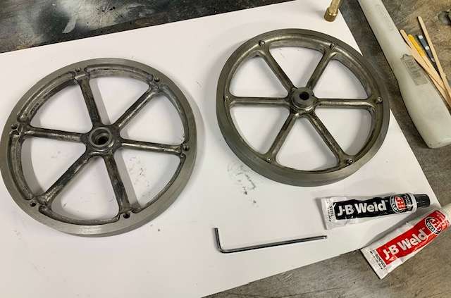

                    Yes, I forgot about the most important thing – the bore, which needs opening from about 11mm to 14mm.
                    Re. Bonding the halves, I think JB weld for the hub, and Araldite for the rim – I’m concerned that JB weld on the rim might leave a black line, which, I think in theory would end up on top of the middle peak of the rope grooves. So it would presumably be quite visible. I guess I could JB Weld where the inner spoke blocks are, but from memory it’s quite grainy and might hold the rim apart slightly. Could relieve them a bit, but is it worth the effort?
                    #796541
                      Unless you ar eonly using one of the two tubes your JBW should be grey and quite close to the colour of cast iron. Applied very thinly it should not show anymore than the amber of Araldite.
                      I’d much rather machine across the JBW than Araldite which is always a bit soft even after setting and I’m sure that if Tubal Cain had it available 40yrs ago then he would have used it.

                        OK, JB Weld it is.

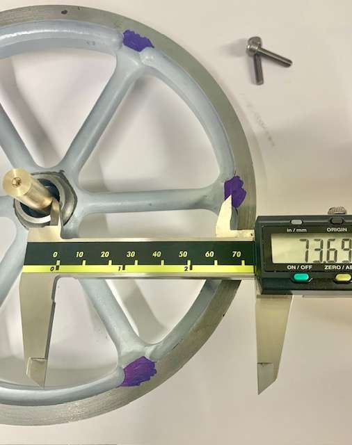

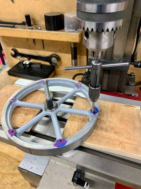

                        Bit more progress last night – I measured from the shaft o/d to the inside of the machined rim, and subtracted half the head diameter of an M4 caphead (M3 didn’t look robust enough to me):
                        IMG_3635

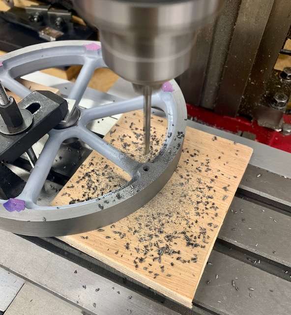

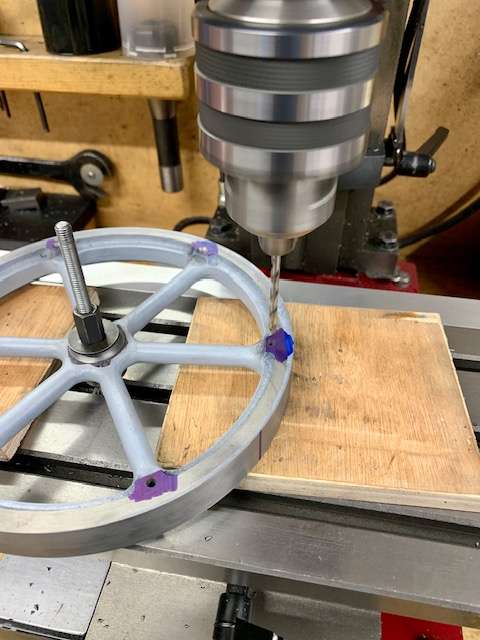

                        Then turned over and marked each square pad to make sure I could drill and tap it. It was very close, but it’s just about do-able.
                        IMG_3634
                        Then centre marked them:
                        IMG_3637

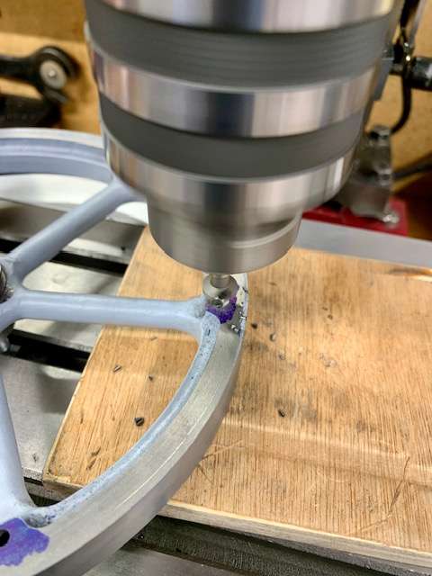

                        Drilled to 4mm, and countersunk the mating face holes:
                        IMG_3639
                        Then turned over, and counterbored with a 6mm end mill. I turned down the M4 caphead head diameters from 7mm to just under 6mm, because even at 6mm, somehow the end mill grazed the machined rim (doesn’t matter too much I guess because that part will be machined away for the barring ring insert):
                        IMG_3643
                        IMG_3641
                        Plenty of thread protruding – next job is to align the wheels on the spigot, then drill and tap the other side. I’ll make blind holes to save filling – that side will be untouched apart from clean-up and a slight recess machined under the rim.
                        IMG_3642
                        So after drilling and tapping I’ll do a final clean-up of the cast surfaces – the pads will need matching becasue some have a prominent step.
                        I may also grind a small chamfer along all mating edges (apart from the outer edges to be machined) as a sort of JB Weld-prep. May help with disguising the joint line.

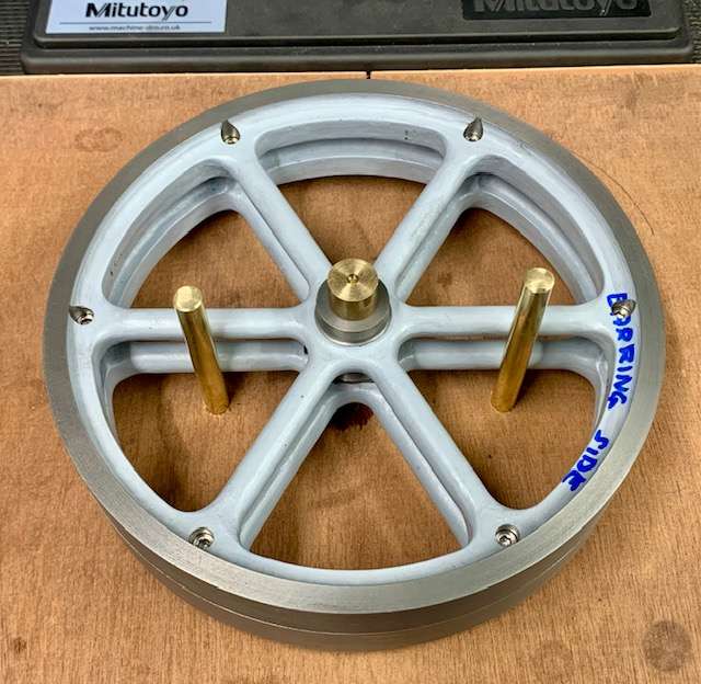

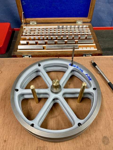

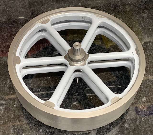

                          Made a jig to align the spokes, and then, with the spigot fitted and a slip gauge under the rim, marked through the counterbored holes onto the second flywheel with a drill:
                          IMG_3686
                          Then centre-punched & drilled:
                          IMG_3689
                          Countersunk slightly:
                          IMG_3690
                          and tapped M4:
                          IMG_3688

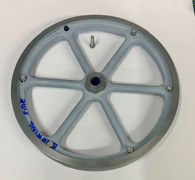

                          All fitted together nicely (dry):
                          IMG_3691

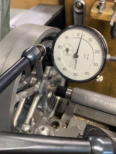

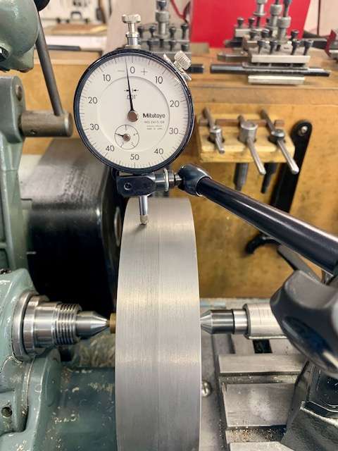

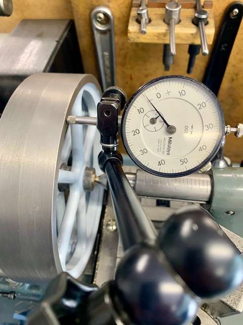

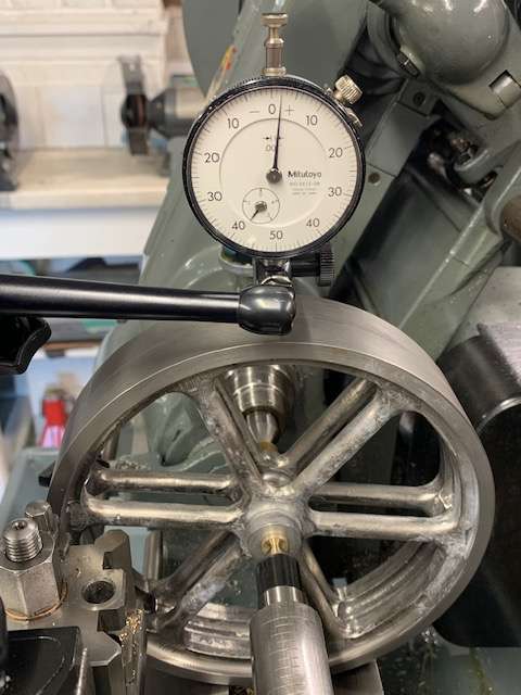

                          I then put the assembly in the lathe between centres, and checked runout.
                          Radial runout on both wheels was a couple of thou, but axial runout was 0.018″, and gave a visible wobble.
                          From this I assume the two wheels are not co-axial – this seemed to be confirmed when I could feel a slight step at the join line on one side, but smooth on the opposite side.
                          This may not be surprising since despite re-machining the spigot to give a better fit, I can still very slightly rock the two wheels against each other. I don’t think I can get the spigot a tight fit on both wheels due to the bores being very slightly different. I tried a dodgy method of centre-punching around th espigot to get a tigher fit, but obviously that didn’t work too well.
                          I suppose I can try to correct this by feel on the step of the rim to get them more co-axial, but it’s a bit hit-and-miss- especially when I finally assemble with JB Weld.
                          Anyway, it is what it is (which isn’t a disaster by any means), I will just have to get it as good as I can I guess.
                          #797098
                          Dr_GMJN
                            @dr_gmjn

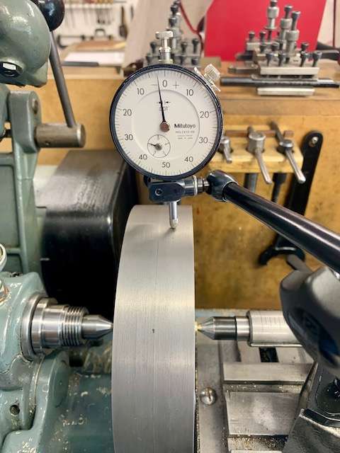

                            I think I might have found the issue – three of the bolt heads were tight in their counterbores. When I removed them and got the rims concentric by feel, the spigot dropped in (which suggested they were better aligned. Re-checking on the lathe gave about 0.0025″ max. runout for both rims:
                            IMG_3708
                            IMG_3709
                            and aout 0.0045″ axial:
                            IMG_3707
                            So I think that will be fine – they look much better when spun. I’ll have to re-check after JB Welding that they are true before final tightening and leaving to set.

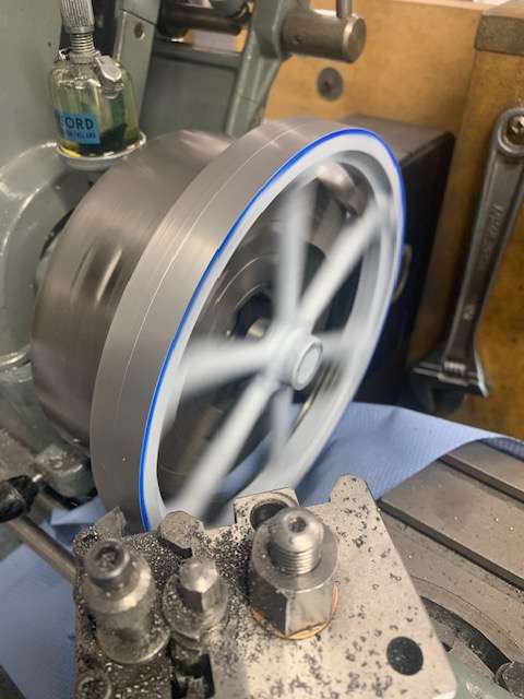

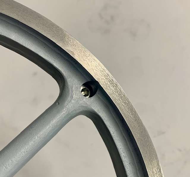

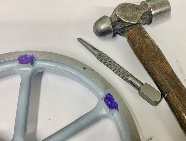

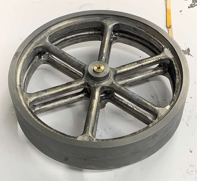

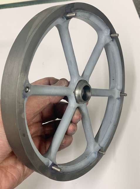

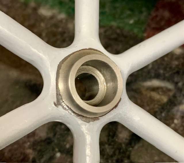

                              So after leaving the castings a week or so after rough machining (I think as per the instructions), I did a bit more fettling of the mating parts, and cleaned off the primer so I’ll have a cleaner base to start finishing from once joined and filled. Then applied the JB Weld:
                              IMG_3827
                              and put back in the lathe to check that they were true:
                              IMG_3828
                              IMG_3830
                              After a bit of tapping with the hammer, they reverted to being a few thou out, but nothing serious.
                              So now they are left to set:
                              IMG_3832

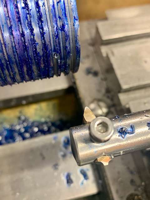

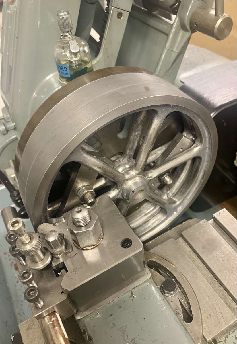

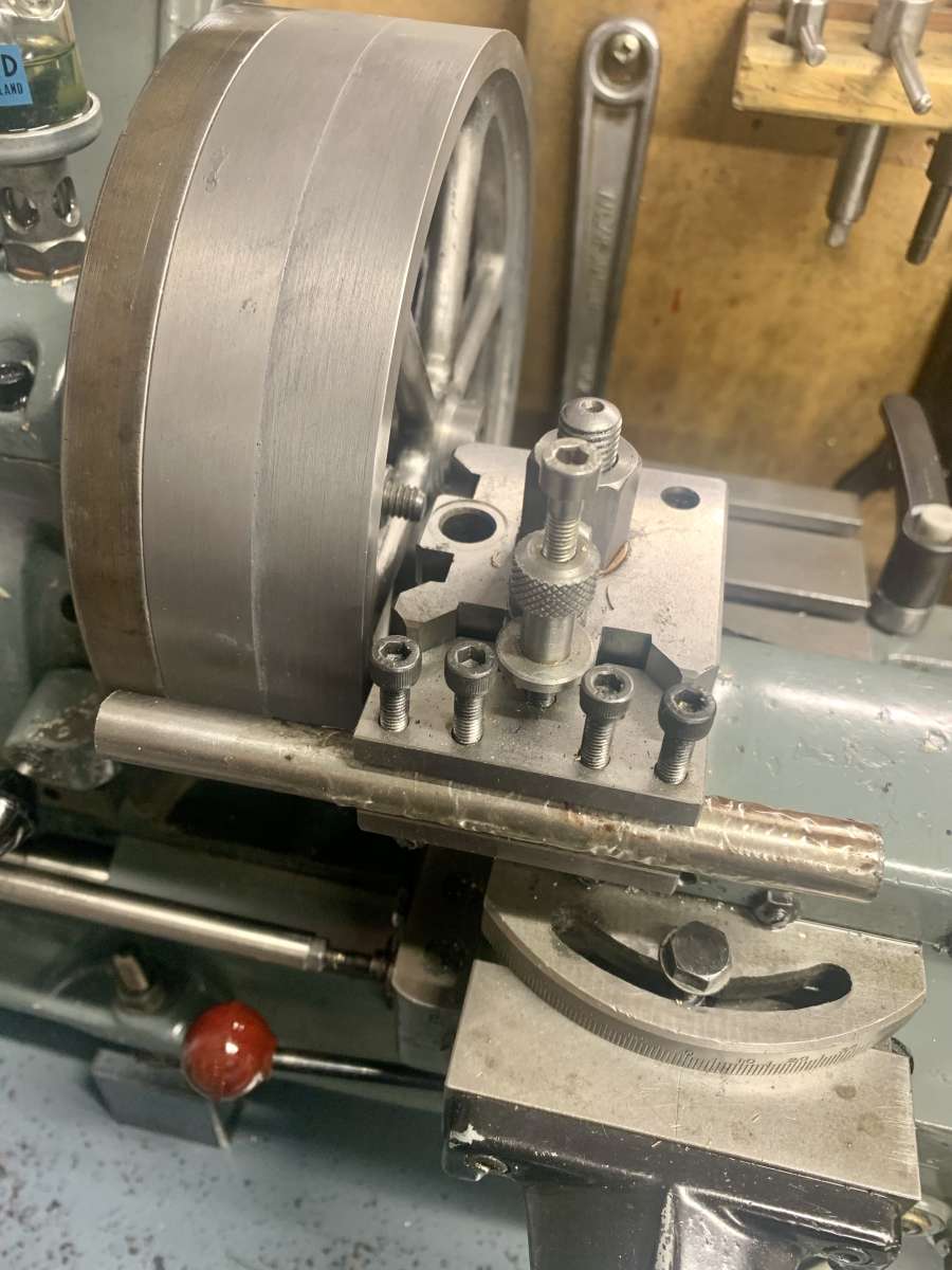

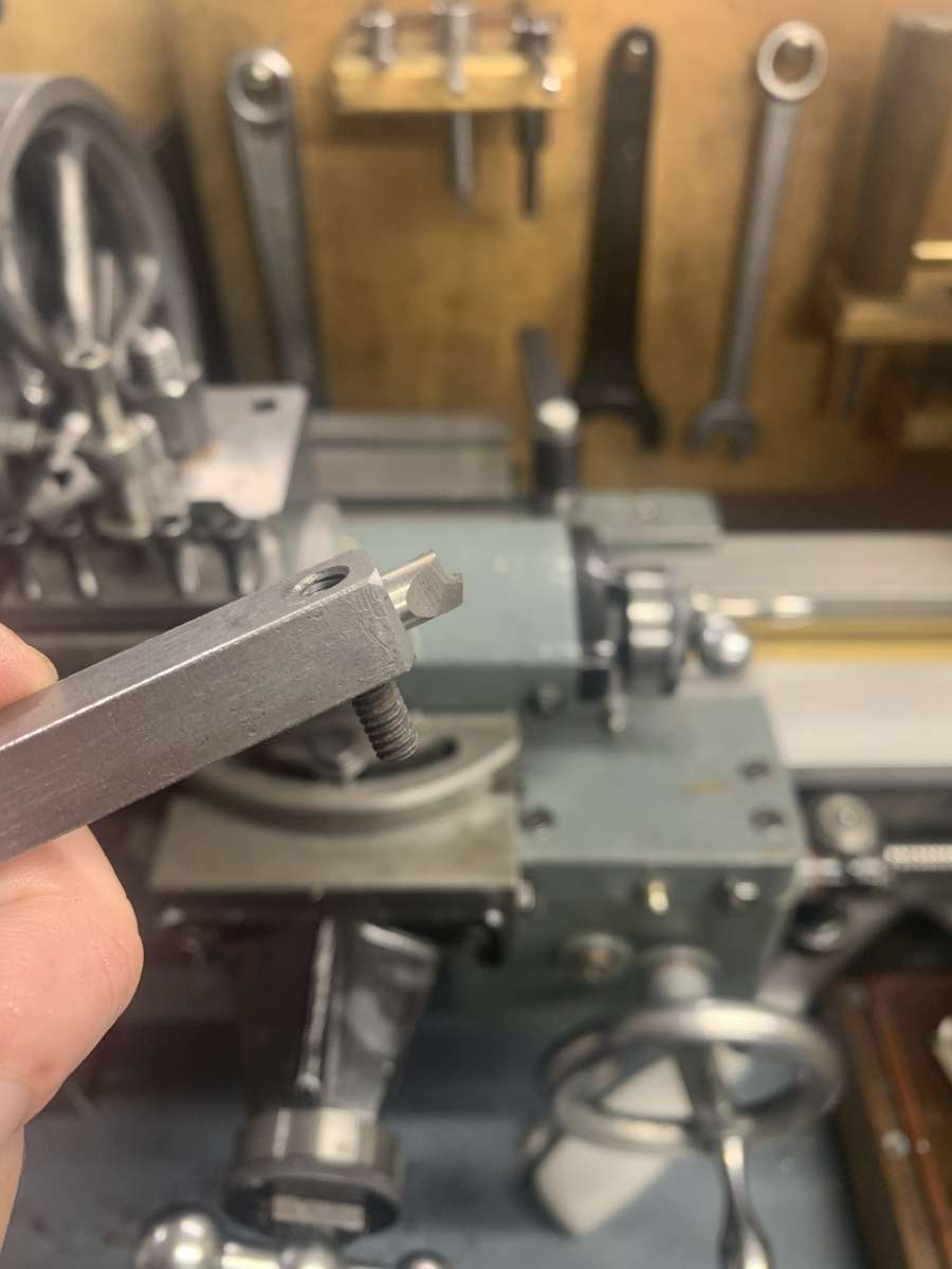

                              I remember some conversation about the rope grooves previously on this thread – I wonder if I could use a standard dimond shaped tool for these? Getting a precise profile doesn’t seem that important at this scale?
                              Also, how is the tool held so far out from the toolpost (on the ML7)? I think there is an image in the magazine article showing how it’s done, but it hasn’t reproduced well enough for me to see how it’s done. I expect there may be a lot of overhang unless perhaps a specific toolholder is made from bar stock.
                              Thanks.
                              #798392

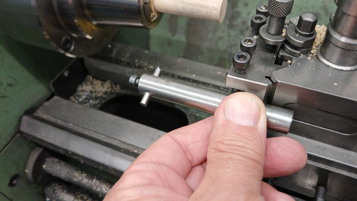

                                Might be able to do it with a VCGT insert held in a custom holder otherwise it’s grind up a bit of HSS and make a simple holder like this mounted in the near side of the toolpost

                                        I might have a go at making a tool holder later on. Any advice on tool geometry? I still have some of the cylindrical bits that Ramon sent me – that I made the cylinder boring tools from.
                                        Also, what’s the best way of shimming the wheel assembly out from the faceplate? The two o/ds are almost exactly the same, with no overhang of the flywheel. I assume some bits of aluminium plate might do, but I am a bit concerned about slippage.
                                        Thanks.
                                        #799093
                                          Nothing special, base it on one of your DCGT inserts, the 7deg side clearance will do.

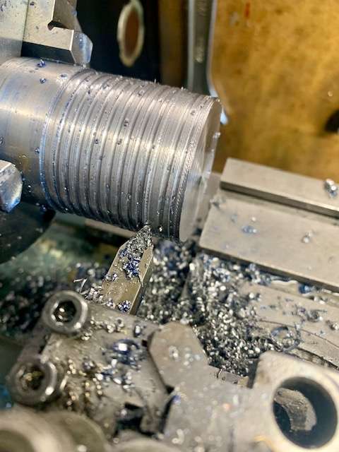

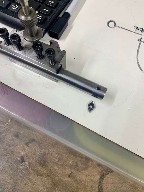

                                            I made a test piece for the grooves – much smaller diameter obviously, but the correct width. I wanted to get used to the spacing method, and to try the tools I made.
                                            It wasn’t much of a success – I find grinding tools is hopeless, and the results were – as expected – poor. I think that if it’s not symmetrical, the end grooves to the edge of the wheels would be wrong even if the central groove spacing was correct.
                                            At least I sorted the spacing method using the leadscrew handwheel though.
                                            IMG_3921
                                            I reverted to an insert type tool, and things improved a bit, although nowhere near perfect, mainly becasue the workpiece kept moving.
                                            IMG_3923
                                            So, what’s the best way of making a VCGT 90 degree holder? Is it a simple case of milling a piece of square bar to get the right height, then drilling for the Torx screw, and perhaps retaining the back end of the tip in a JBWeld “V”? I could coat the tip in grease so that the insert didn’t stick, then I could replace it.
                                            I think that the torx screws in inserts are slightly pre-loaded towards the holder, but I wouldn’t be able to do that  I guess.
                                            Not sure If I’d need the 1mm wide parting type tool to start the grooves if I was using inserts? If I did need it, I’ve no idea how I’d make anything other than a mess again – I don’t really have any of the correct equipment for grinding – the wheel I’ve got is worn, and the adjustable jig I made for the boring tools never really worked properly. I’m keen to get on with it, and don’t want to spend hours of trial and error again on trying to make tools that don’t really work.
                                            IMG_3924
                                            #799314
                                              One of your main problems is the amount a tool contact, as that goes up the chances of chatter increase. This is why the parting tool first is suggested as you are only cutting with a 1mm wide contact on the cutting edge.
                                              Once you change to the Vee tool then if the cross slide is set parallel to the lathe axis you can move it back and forth slightly so you take alternate cuts with the left and right side of the cutter which again reduces contact. I don’t think the topslide will swing round enough to do it like the angled thread cutting method that some people use where only one side would be cutting.
                                              The bigger the bar you use the more rigid the setup so if you can go up in size with that. May mean ditching the QCTP and reverting to the original Myford method of clamping the tool to the top of the cross slide.
                                              As for making a tool to take inserts then you really need to machine a pocket. Not too hard, set the mill vice to half the 55deg and mill a slot. Leave the work in the vice and reposition it at the opposite angle so tool height stays the same and mill a slot that just crosses the first then mill out what is left where you want th etool to sit. The cross ensures there is clearance for the tip which won’t fit against a radius left by a cutter.
                                              To drill the hole place an insert in the pocket and hold a drill that is a good fit in it’s hole upside down in the mill chuck and find the hole position when insert tight in the pocket and zero dials or DRO. move a few thou closer to the edge of the pocket and drill your hole which will draw the insert into the pocket.

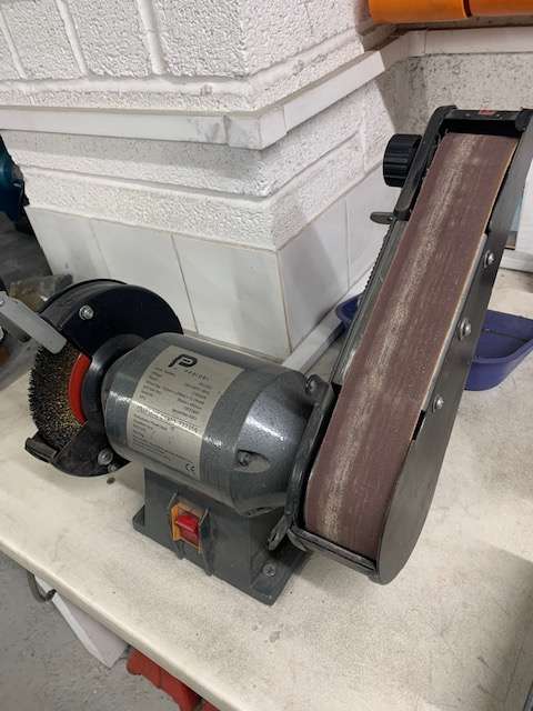

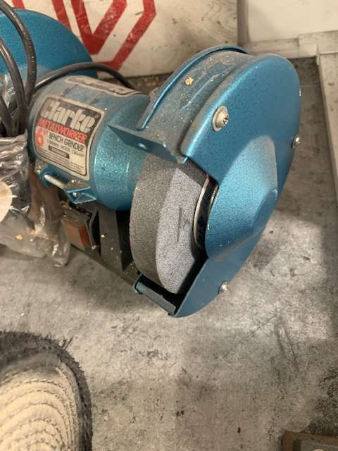

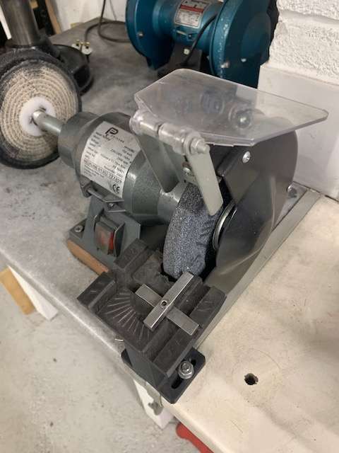

                                              Post a photo of what you have in the way of a grinder and also a belt or disc sander if you have one of those then might be able to suggest a way to grind the tools
                                                  IMG_3936
                                                  IMG_3937
                                                  IMG_3938
                                                  The last one isn’t fitted to the bench. Ironically it’s got the best wheel. Never used it, and I don’t have the rest for it.
