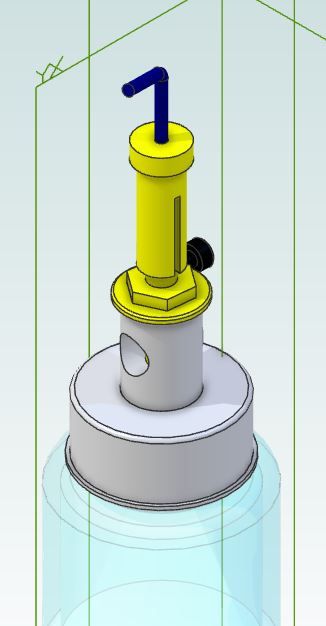

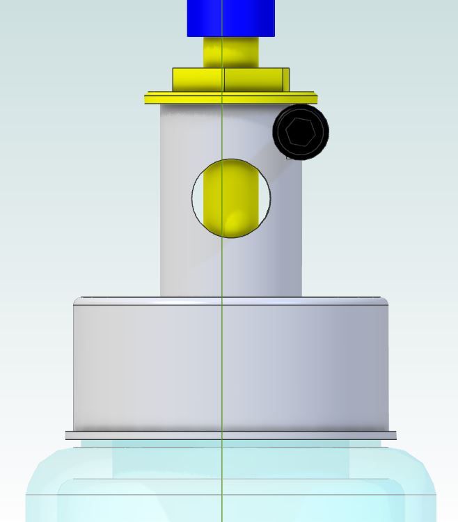

                          Jason, I am intrigued by the throttle adjustment which I think you said was operated by revolving the fuel jar, can you explain how that works.
                          #433976
                            Ron, it's a fairly basic barrel carb and by having the jar lid as part of the barrel/spray bar assembly the lid and therefor the jar act just like a lever would on a RC model carb, I could also add a thin lever between lid and barrel if I wanted.
                            Couple of pics with the actual body removed so you can see the assembled parts that all rotate as one.

                            #433994
                            Ron Laden
                              @ronladen17547
                              Thanks Jason for the explanation and drawings.
