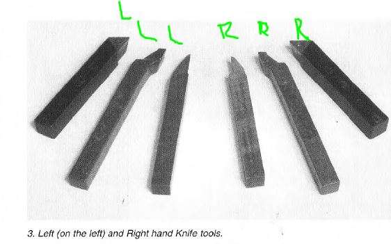

      Once upon a time a “left hand knife” turning tool cut towards the lathe head stock (ref: Myford Series 7 Manual by Ian Bradley). Now Myford supply insert holder for cutting towards the head stock as “right hand”. Why the change or is it just to confuse old people like me?
      JA
      #868784
        I have always termed a L/H tool as one that cuts from left to right, so insert holders are no different. mybe Mr Bradley is to blame
        Harrold Hall has it as I learnt at school
