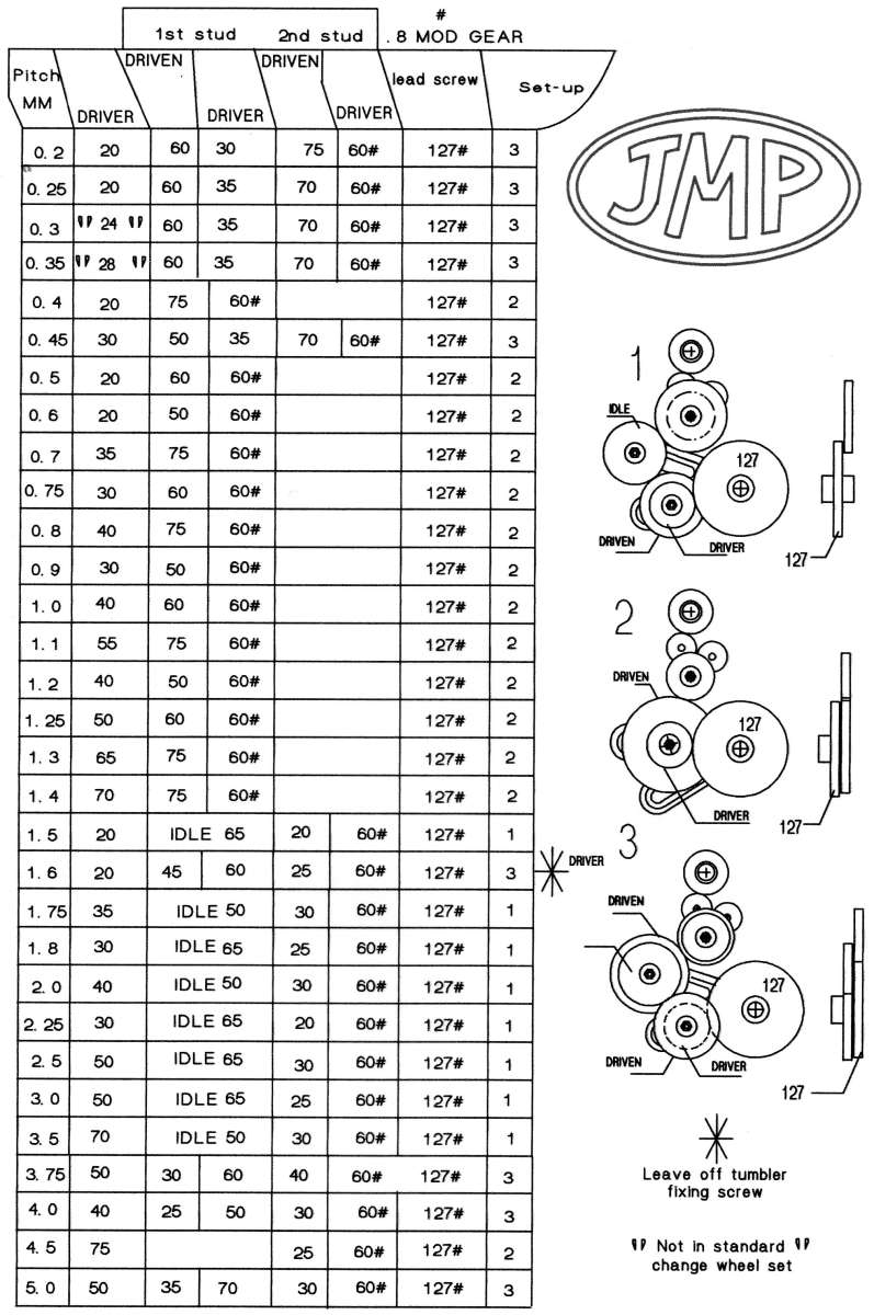

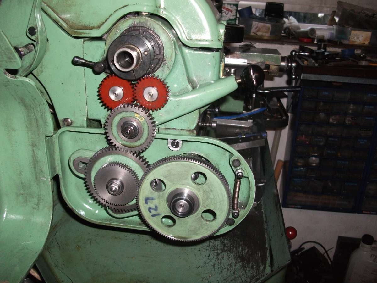

                      I have changewheel S7 ,having a gear box machine is a limitation on
                      things that you may wish to do ,years ago i made some quide hobs
                      for a Quorn grinder which needed a piggy back extra quadrant and
                      more change gears in the train for some of these.
                      Even with the pair of 21T metric conversion set some of the setups
                      were inconvenient to change from one pitch to another.
                      On another recent thread on a worm gear the OP was looking for
                      a way to produce a worm using a box machine and was asking for
                      advice ,that thread has still not reached a conclusion.
                      For some while now i use a 127/60 tooth .8 module pair in the train,
                      they fit within the gear cover and make setting up much easier.
                      The photo here shows the setup for 1 mm pitch also a complete
                      chart for metric pitches.
                      127 Myford change wheel chart vert1mm pitch
