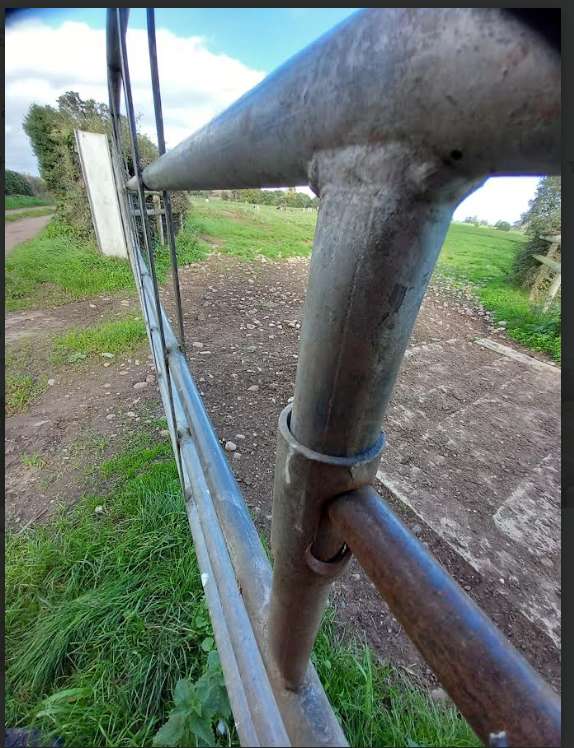

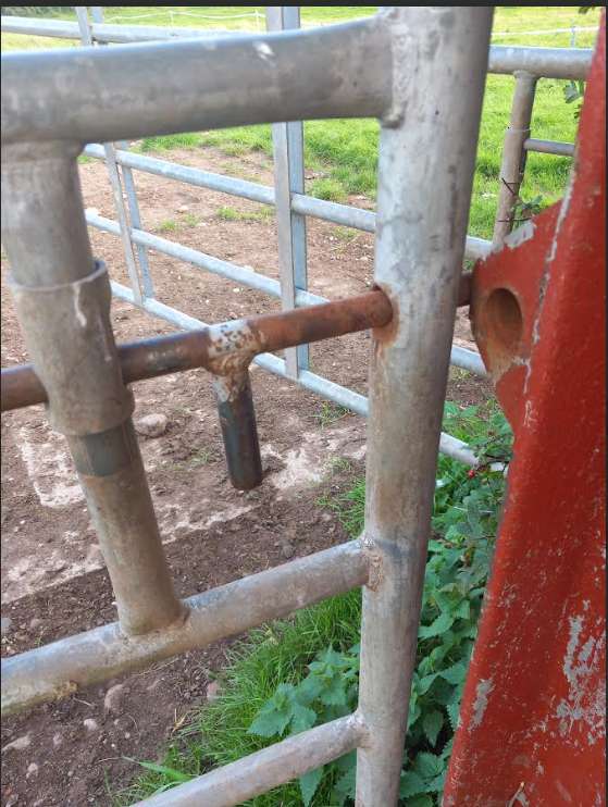

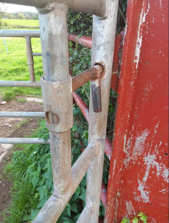

        I thought that was a nice piece of engineering.

          That is a neat design!
          A lot of farm gates use a bolt held in the locked position by a strong spring, making manipulating even harder when as seems inevitable the hinge-side gate-post sags and lowers the bolt below the hole in its post.

            Typical of a device designed by someone who never actually uses one  A million gates including mine with the same trivial mistake of a small hole as the target. A few moments thought would make the hole a vertical slot to allow for the long term sag or seasonal movement. I’ve been meaning to modify mine for decades.

              Question. How did they galvanise the sliding tube without it sticking to the rest of the gate ?
              #869031
              John Haine
                @johnhaine32865
                Before assembly.

                  There is something to be said for having a hole as the keep rather than a vertical slot.
                  If you have a hole then that will offer support to the unhinged end of the gate when someone climbs over the gate who does not have the common sense to do it near the hinge. If the lock were unsupported their weight would put more load on the hinge post side and cause the gate to drop.

                          I think that is a good latch secure against vibration letting the bolt work loose.  However, it does nothing to stop unauthorised human entry so not a lock in my view.

                              As for galvanizing, the lock/catch wasn’t galvanized after assembly, it was constructed
                              from galvanized tubing, with added rust.

                                <p style=”text-align: left;”>Just to be awkward, gates always sag, and so you have to use 2 hands, one to lift the gate so that the bolt will move,  the other to move the bolt. With this design you appear to need 3 hands, one to lift the gate, one to lift the sliding catch thing, one to slide the bolt</p>

                                  When the vertical tube is in its lock position, a small hole through the inner gate tube would allow use of a long shackle padlock to really lock the gate.
                                  With the design (as opposed to the spring one), as observation above, I think two hands are needed to operate the mechanism. That might be a disbenefit if the gate is installed in a place where people with reduced physical ability want to pass through it.

                                    @Duncan,
                                    Did you see the size of the RSJ’s?
                                    The hinges are adjustable too.
                                    The anchor hole  attached to the RSJ could be improved with a vertical slot.
