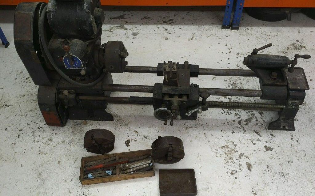

                            Not quite today but on Sunday I managed to secure my second Barker lathe from ebay which I hope to collect this weekend. #2 will enable me to fix the broken bits on #1 to end up with a 100% perfect Barker I hope!
                            2nd Barker lathe
                              You must write this one up for MEW!
                              Is it as flimsy as it looks? The picture on lathes.co.uk suggests the bars are heavier than your picture makes them appear bit beefier.
                              I can't believe it would be built like that and have an MT4 spindle!

                                Well the bars are 1 1/2" OD and 38" between headstock and tailstock on my #1 Barker and I have the cabinet as well. There are three bars – one is hidden behind the one above the leadscrew.
                                Will write it up for "One blerk and his lathe" for you Neil

                                  Great! Looking at your pictures the bars seem much smaller than that, but I can believe it of the ones on Lathes.co.uk

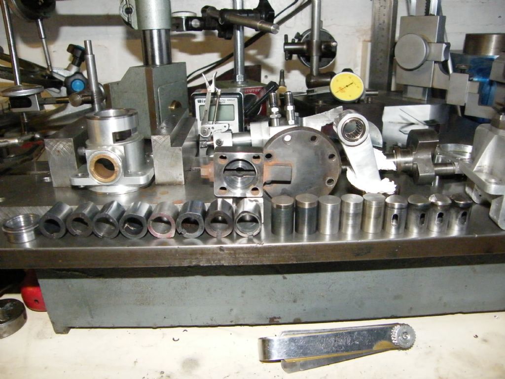

                                          Sorting my collection of spare cams and followers some to finish machining to replace the damaged follower from last of my 2016 runs.
                                          The cam has cleaned up OK it's very difficult to ruin it and very hard wearing considering the high loads on it.
                                          I have a question to ask if I make another cylinder head out of mild steel (the 129.33mph head was with inserted valve seat but seat works loose) then weld a built up valve seat with hard surfacing stellite.
                                          With the seat and head reaching high temperatures and sometimes cooled rapidly could the built up valve seat crack or will it expand and contract with the mild steel?

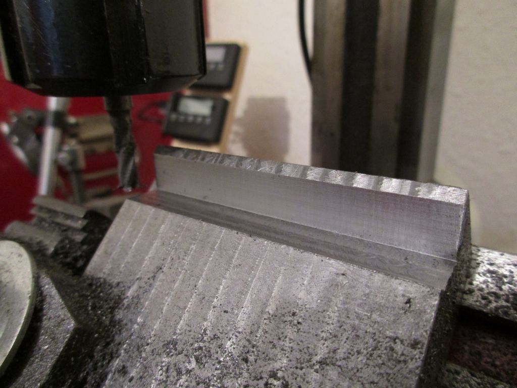

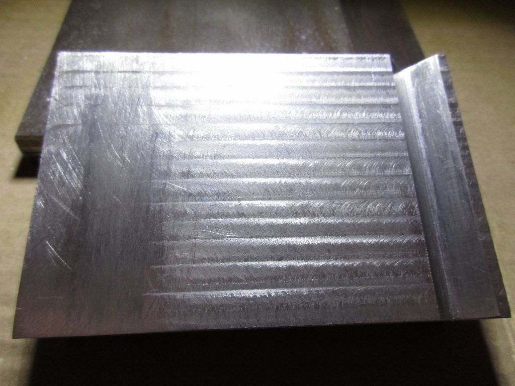

                                              Hi, this evening I finished cutting a 90 degree V in a block of steel on my mini milling machine. The block which is 68mm wide, was set at 45 degrees on my tilting table, I actually started this about six weeks ago, but it hasn't taken six weeks to cut, it just got delayed. The block is for the base of a large fixed steady, that I'm making for my Boxford lathe.

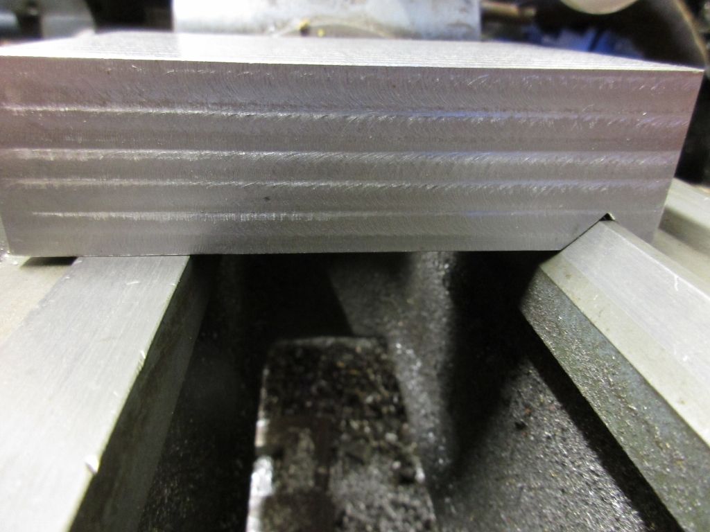

                                              The size of the V was measured from my standard Boxford lathe steady, which was a bit of a task to do, because it isn't quite cut true from one side to the other. After I decided that I was satisfied that it was cut to the right depth, it was taken off the mill and tried on the lathe and to my delight the fit looked good and had no more shake than my standard steady.

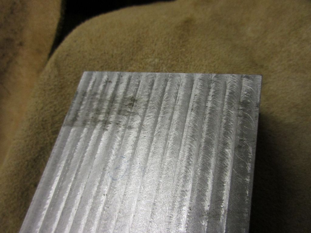

                                              The next photo shows the first contact marks that I got and this showed that the two opposite corners which had a very slight rock were not making much contact at all.
                                              After a little light filing and remarking a few times, the rocking became zero and some contact across the whole width of the block was achieved. I'm sure with a little more fettling I can improve the amount of contact, but it's already better than my standard steady.
