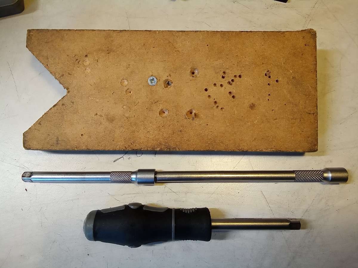

                  Andy Stopford
                    @andystopford50521
                    I’ve always favoured the slightly-tilted-greater-leverage explanation.
                    But could the handle diameter make the difference? I’ve just tried a not very scientifically rigorous experiment using the screwdriver handle and extension bars from my 1/4″ drive socket and screwdriver bits set.
                    I drove a couple of screws into a piece of MDF, one with just the handle, one with the extensions, as tight as I could turn:
                    20260831_100413
                    The screw on the left was driven with just the handle, the one on the right with the extensions. The right hand one has sunk deep into the MDF whilst the other has barely sunk to the depth of the countersink; no pilot holes were drilled.
                    I think that gives a reasonable demonstration that the handle is not the deciding factor (though it certainly makes a difference).
                    Ideally, to investigate further one would use some more accurate torque measuring device – one of those moving pointer torque wrenches would be good.

                      Andy   You’ve introduced another factor here,  cross headed screws. Try it again with slotted
                      Also you are tightening them not undoing. As an aside my dad always called screwdrivers turnscrews and spanners were nut keys.

                        Can’t do that I’m afraid Roy. I got rid of all my slotted screws when I retired (in fact I had to poke around to find screws with ordinary threads – I mostly have the fancy fluted ones which drive too easily to make good “test instruments”).
                        An undoing test would certainly need a torque wrench-type of measurement methinks.

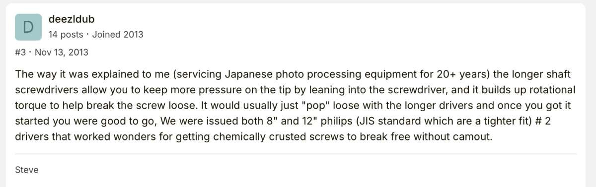

                                                  Vic
                                                    @vic
                                                    On Grindstone Cowboy Said:
                                                    I do remember reading this fact in an old motorcycle book (1930s), but it didn’t explain the reason(s).
                                                    Rob
                                                    I was taught this when training as a mechanic, I can’t remember the explanation either!
                                                    Edit: An explanation from the net.
                                                    IMG_3274
                                                    The position of your arm and hand (relative to the screw) allows more pressure to be applied with more stability compared to a short screwdriver.
