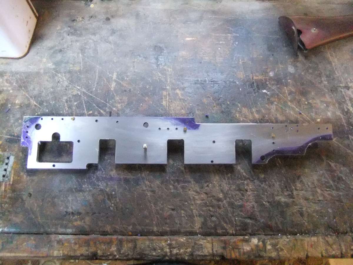

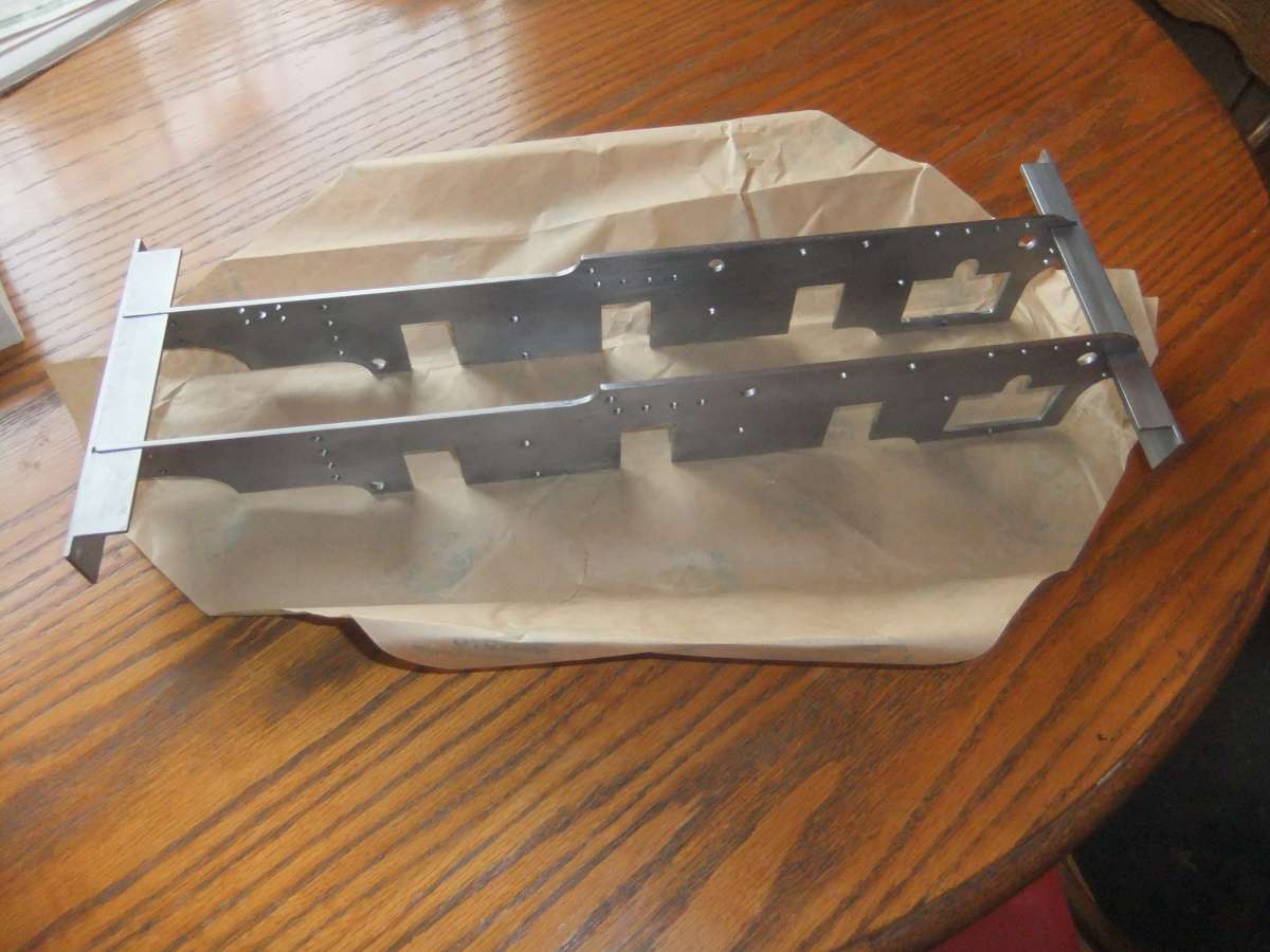

  • #828753
    Dalboy
      @dalboy

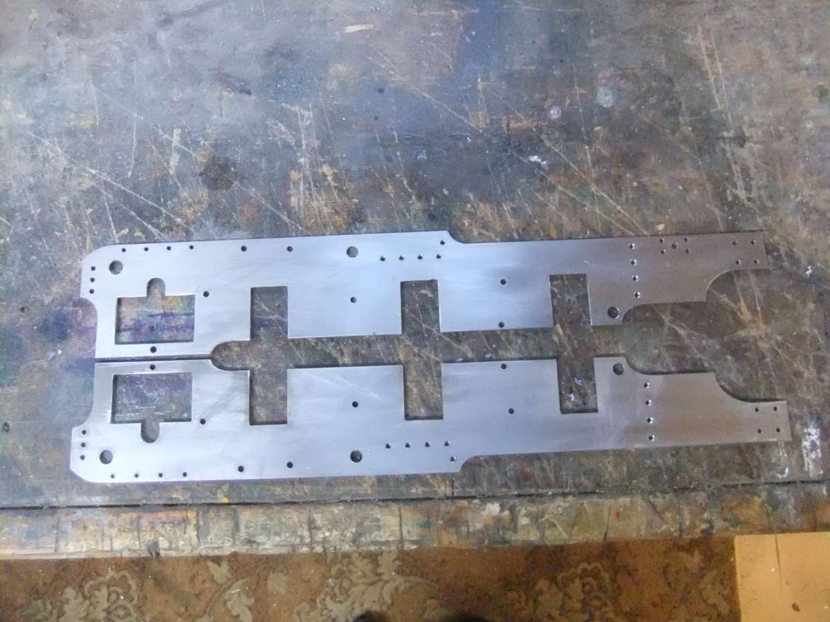

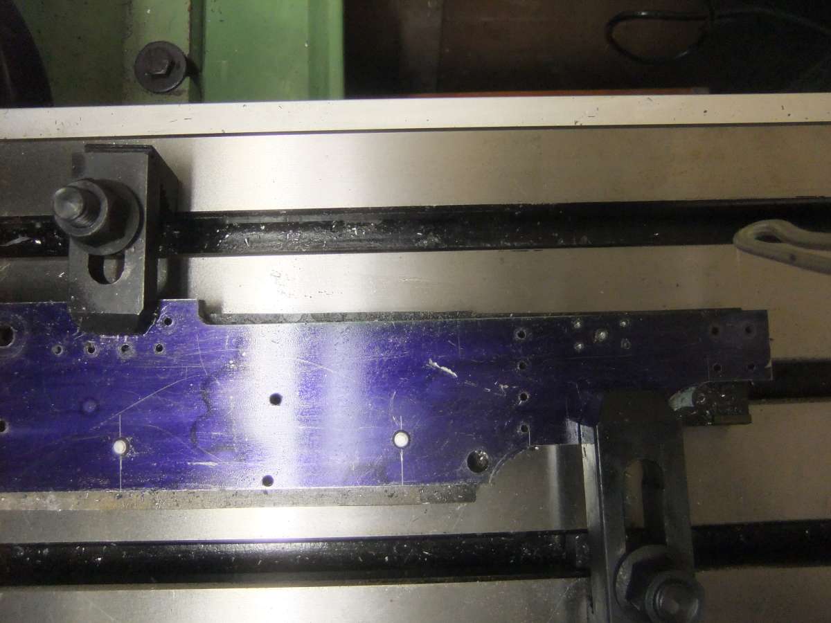

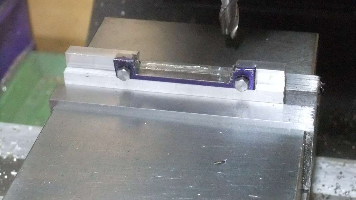

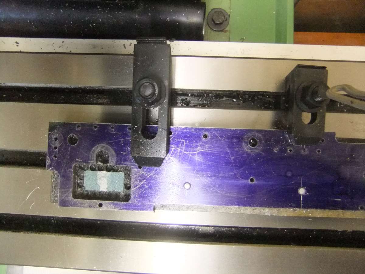

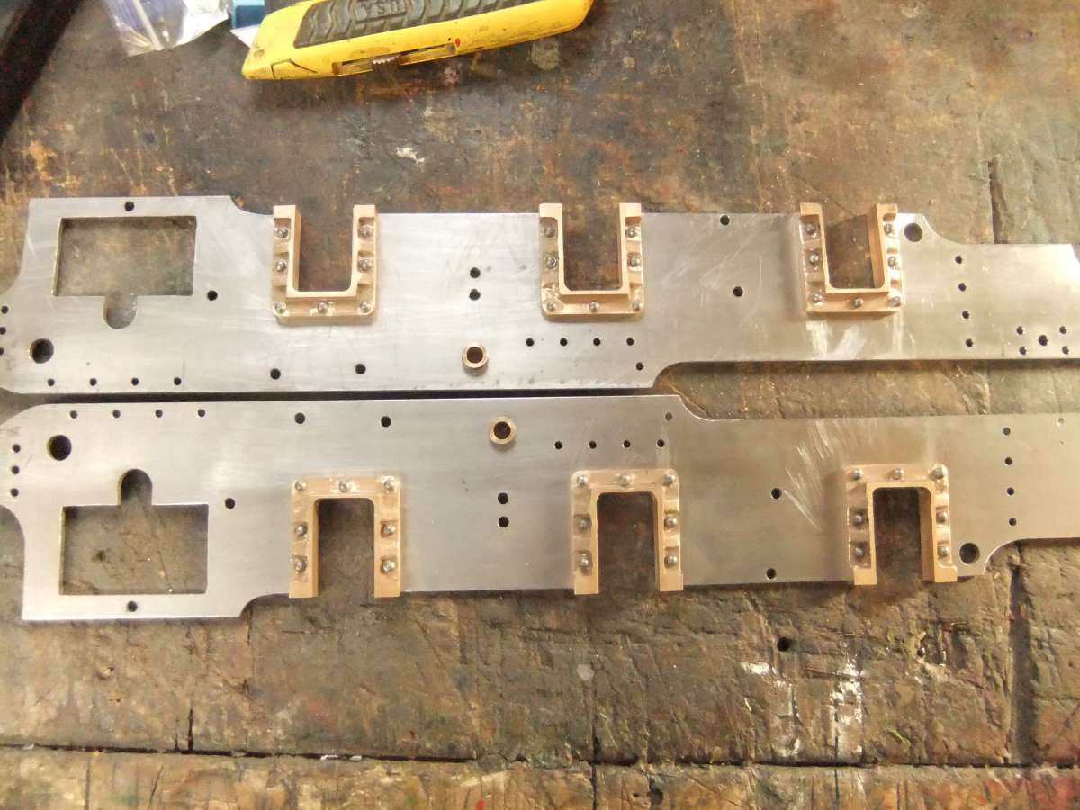

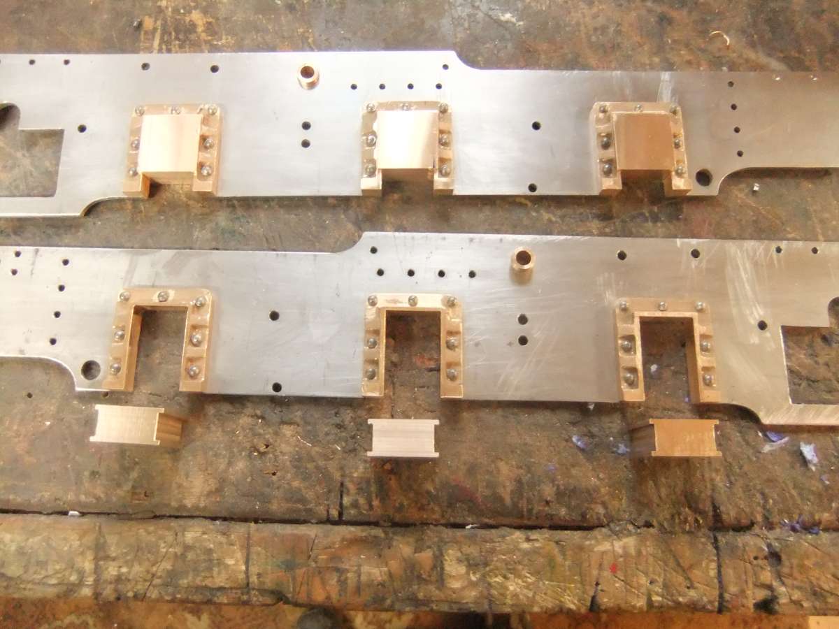

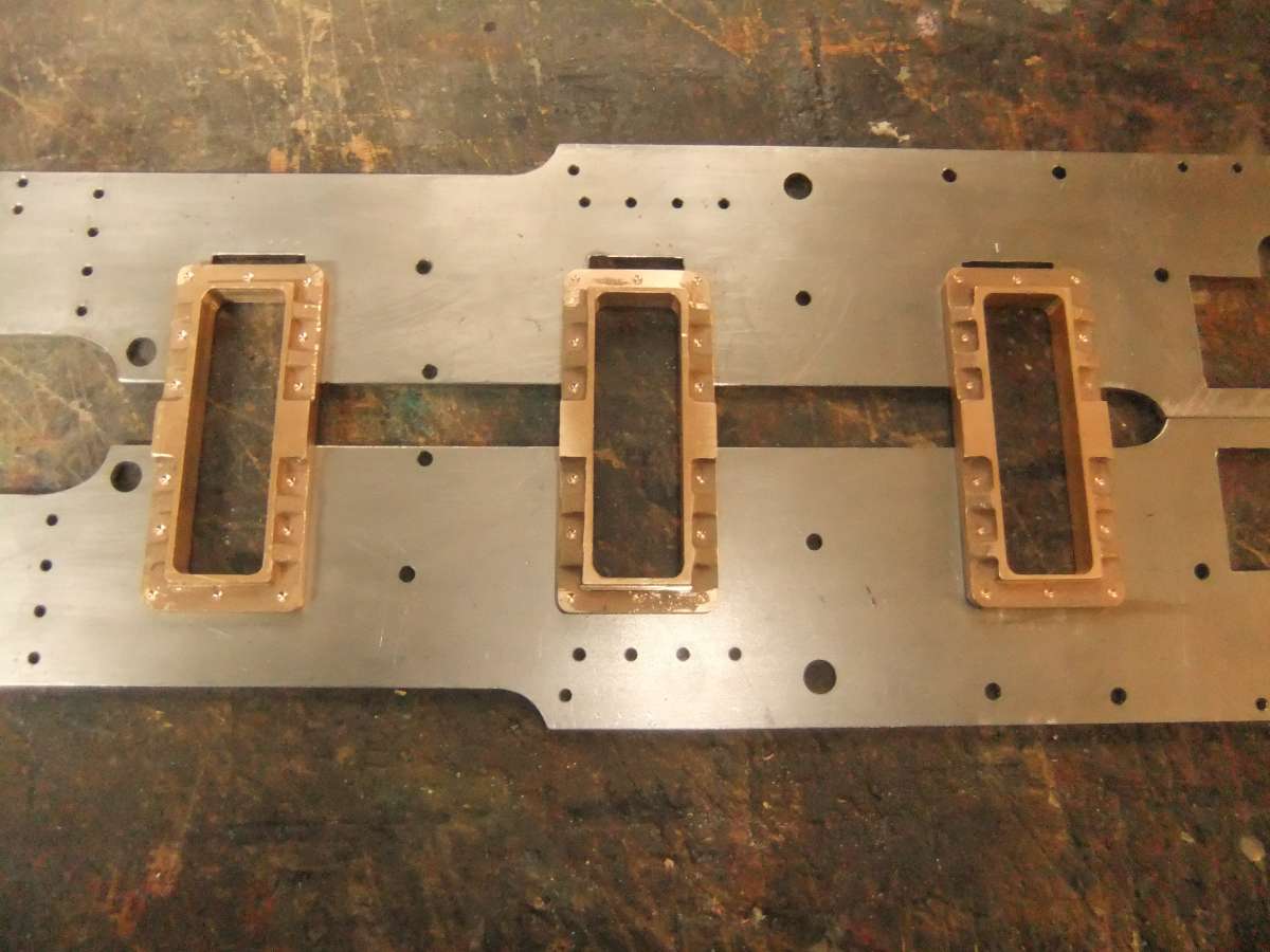

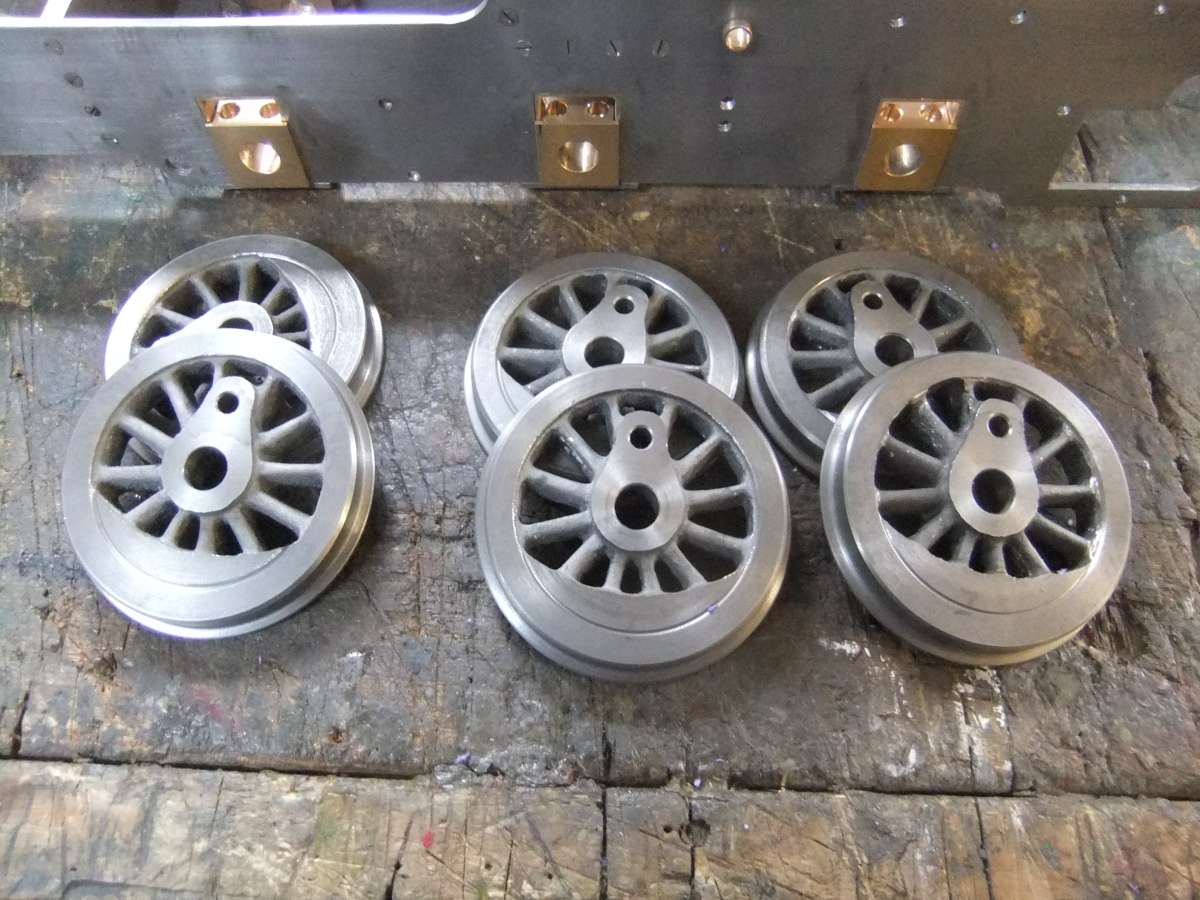

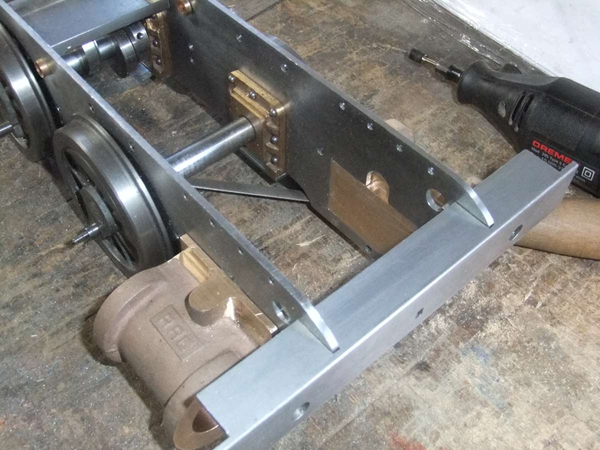

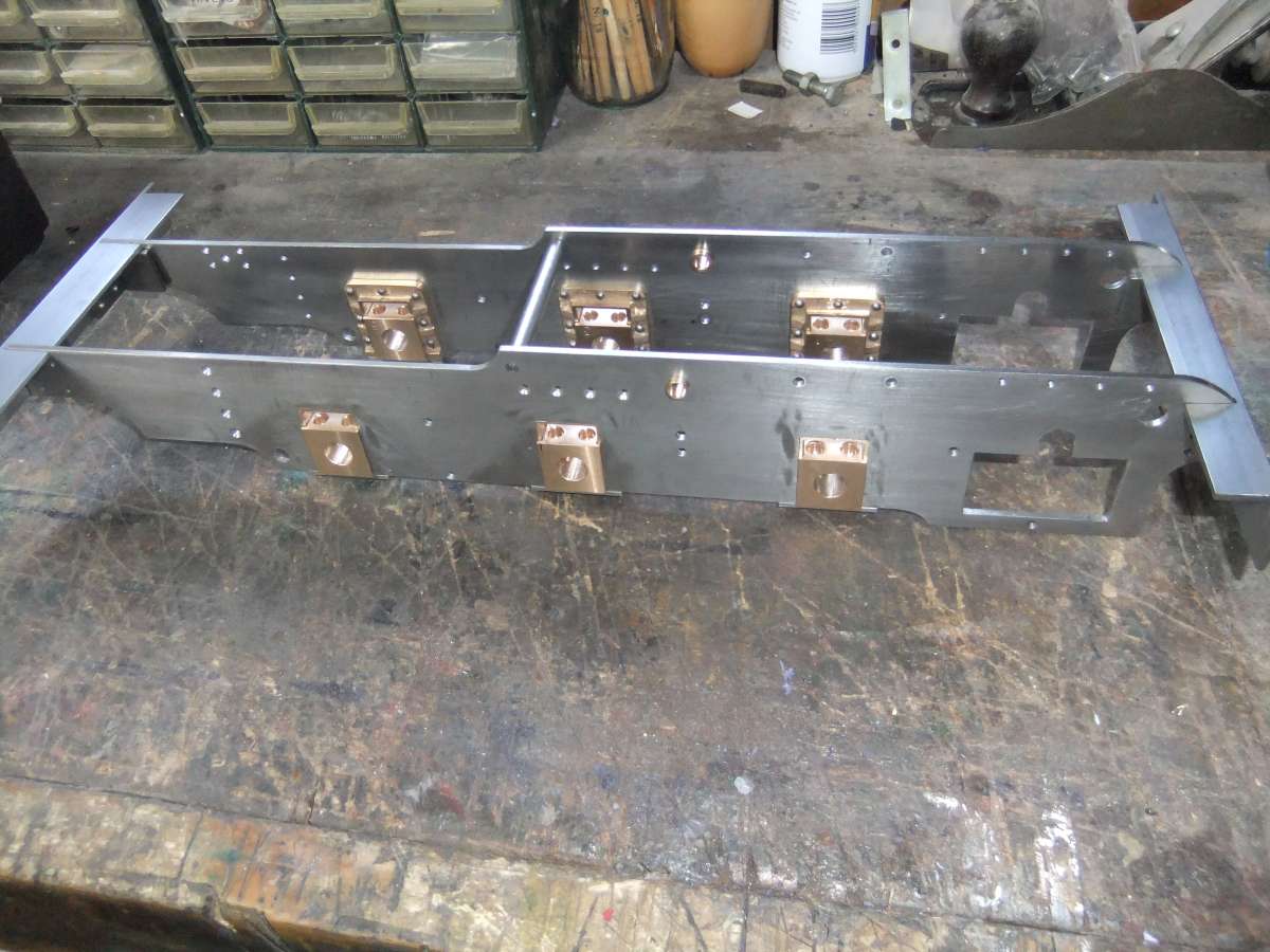

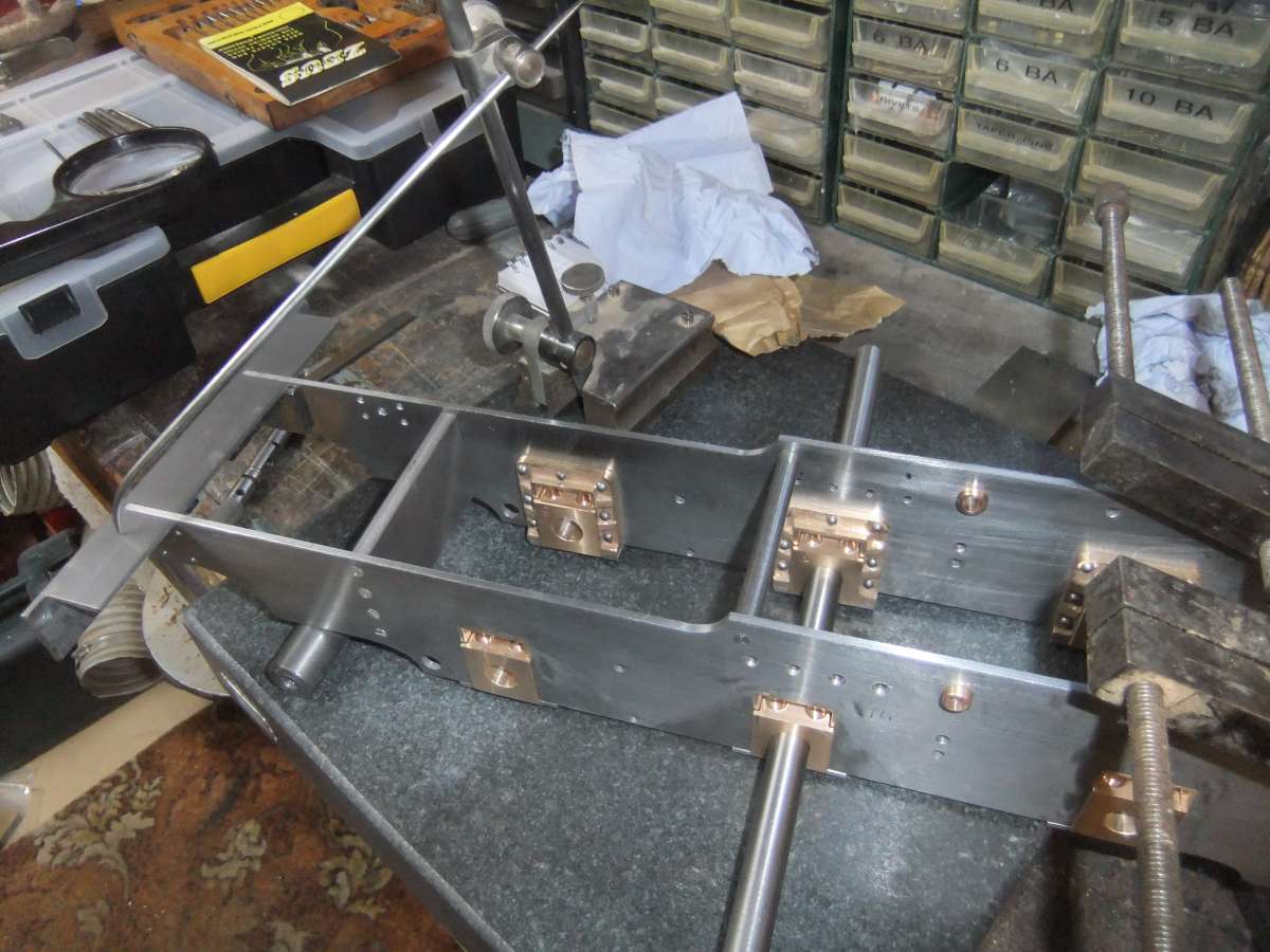

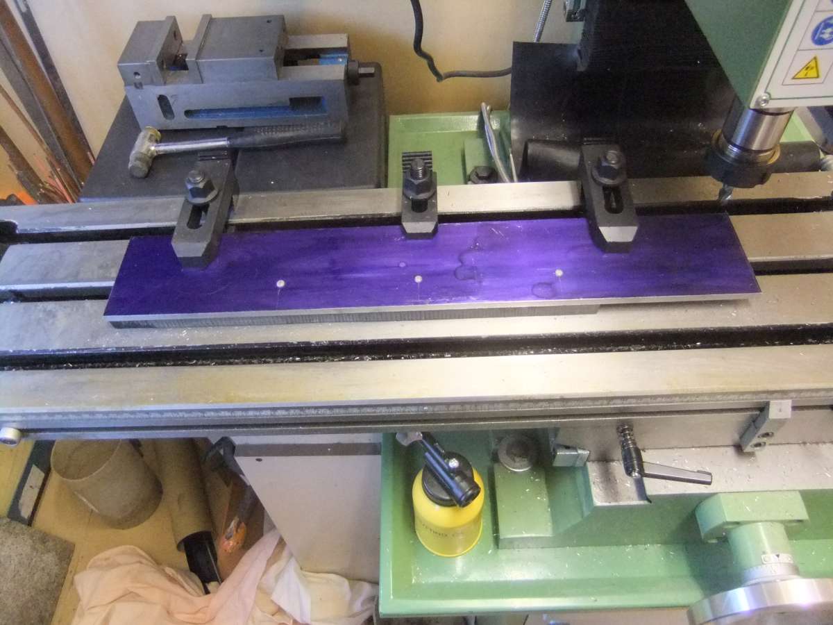

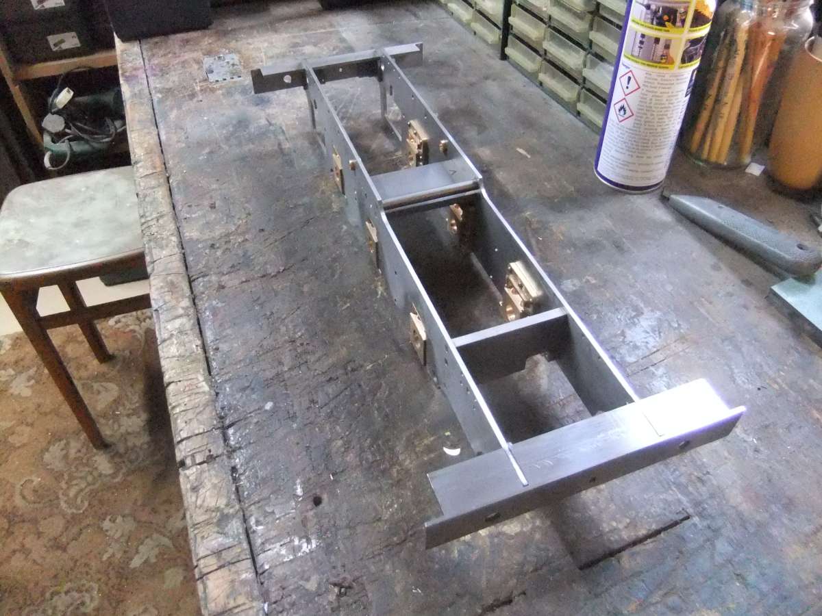

      I will start this off with some photos of what I have done so far just to give an idea what is involved so far.
      Luckily, I chose a milling machine that had plenty of X axis to play with, so that the frames could be machined without too much moving of clamps
      DSCF2129DSCF2139DSCF2151DSCF2152DSCF2155DSCF2159

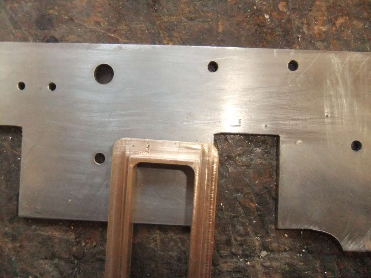

      #828756
      Dalboy

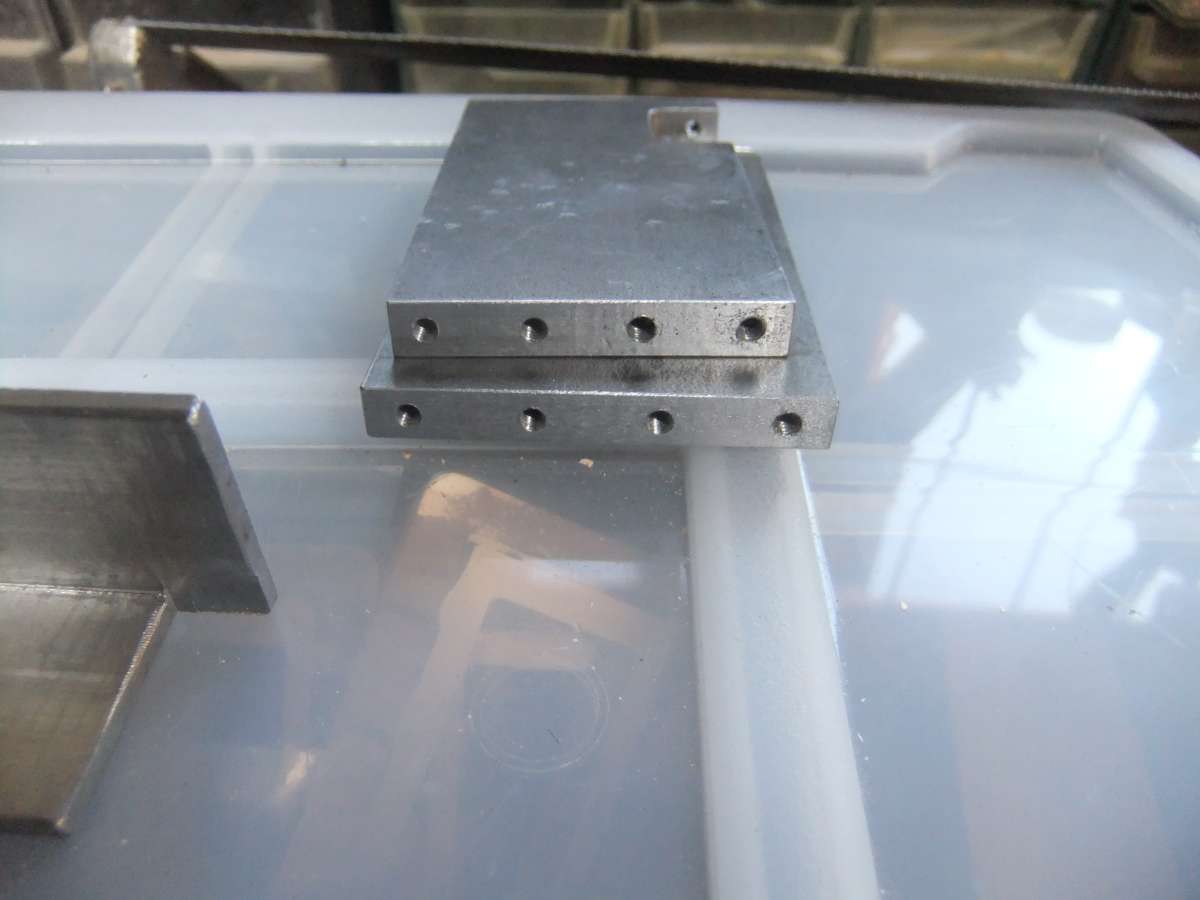

        @dalboy

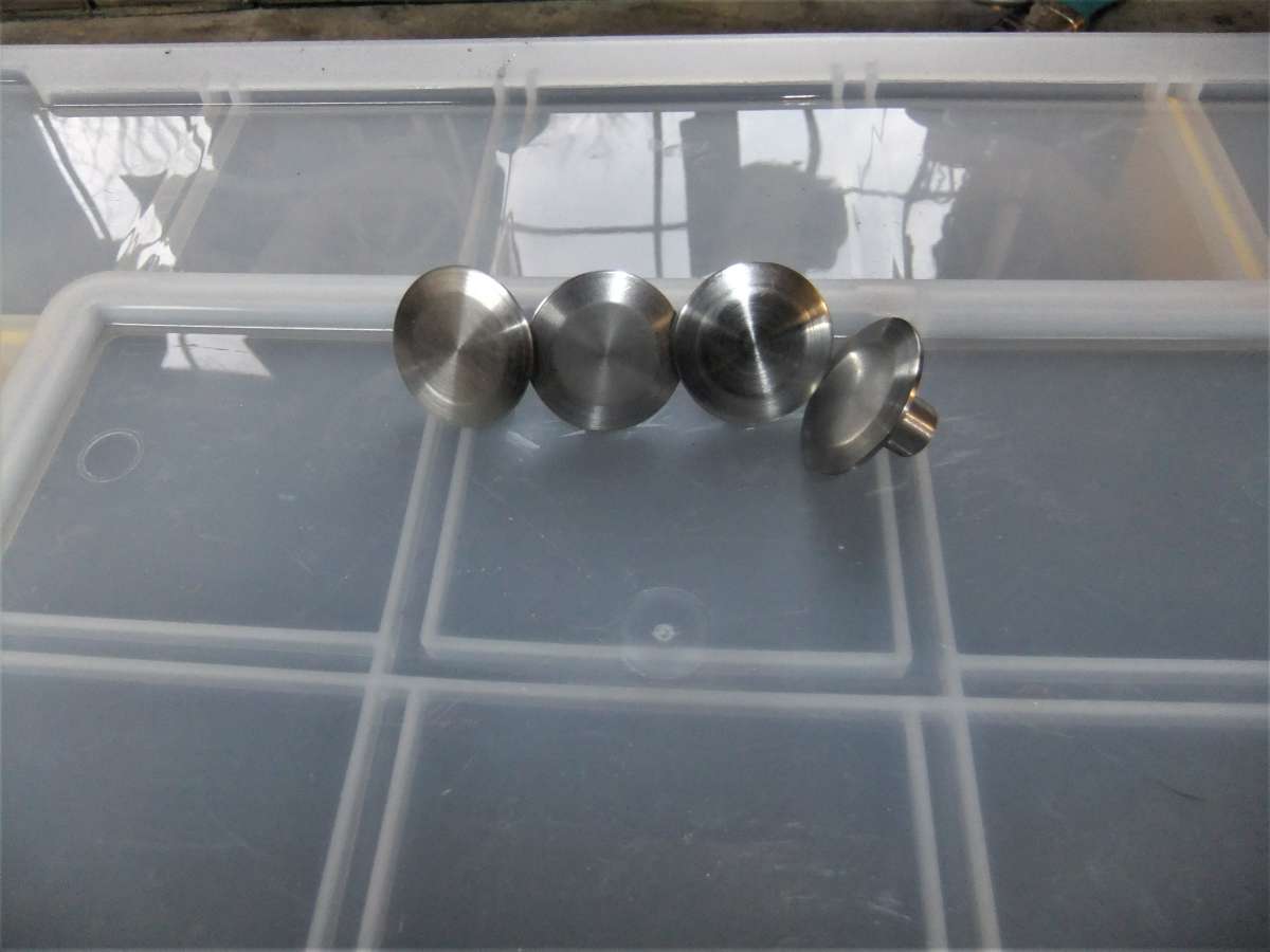

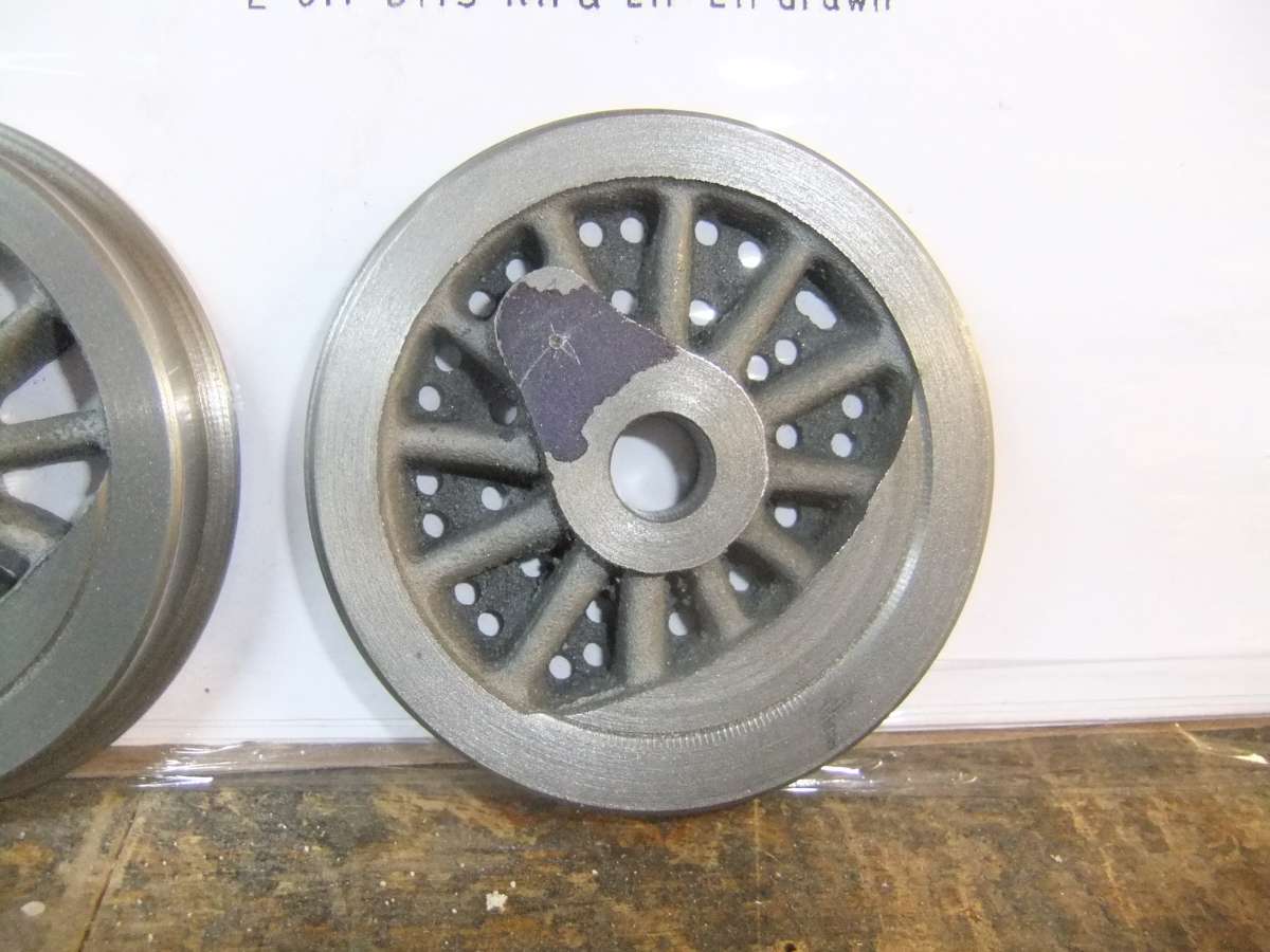

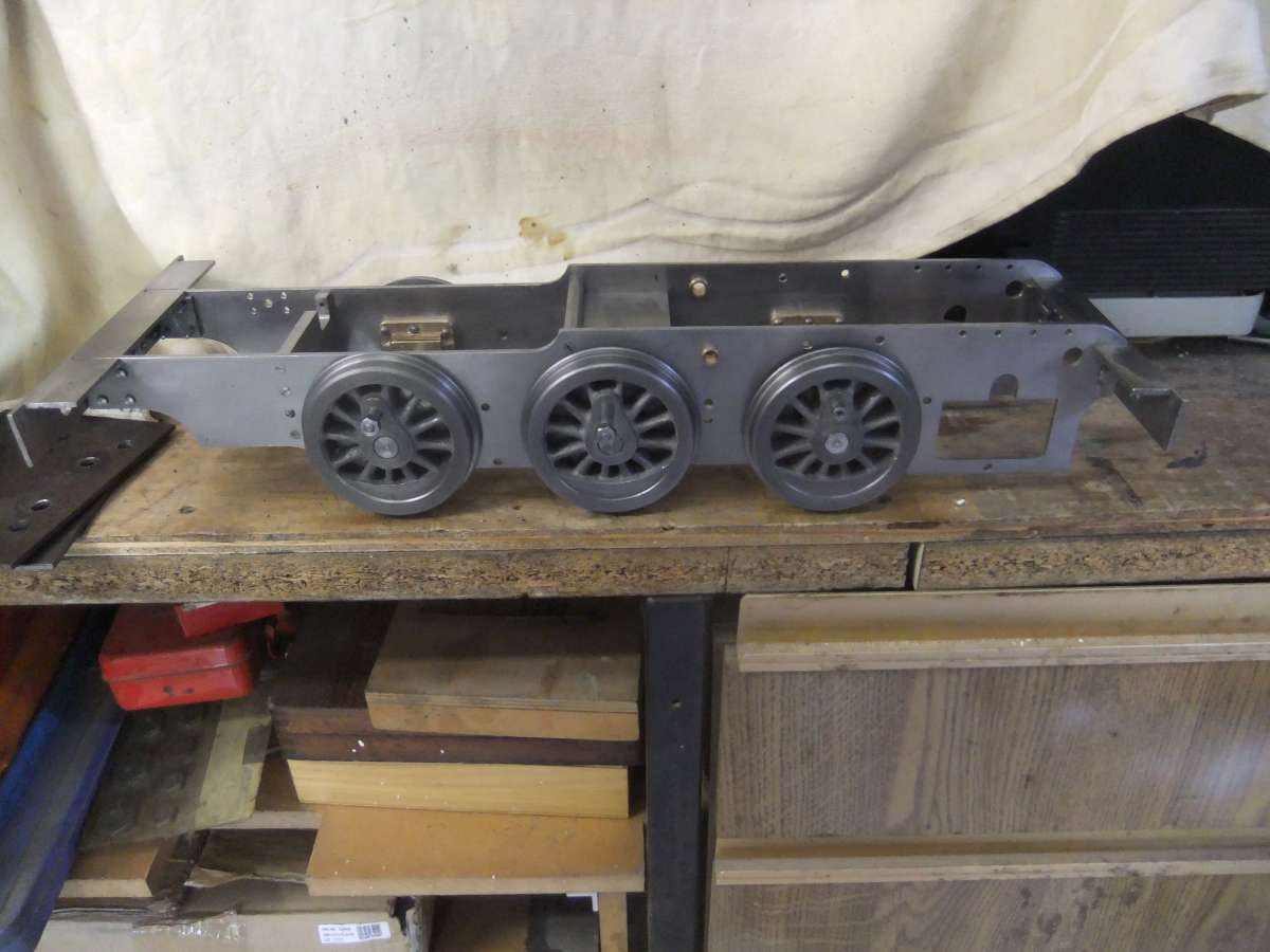

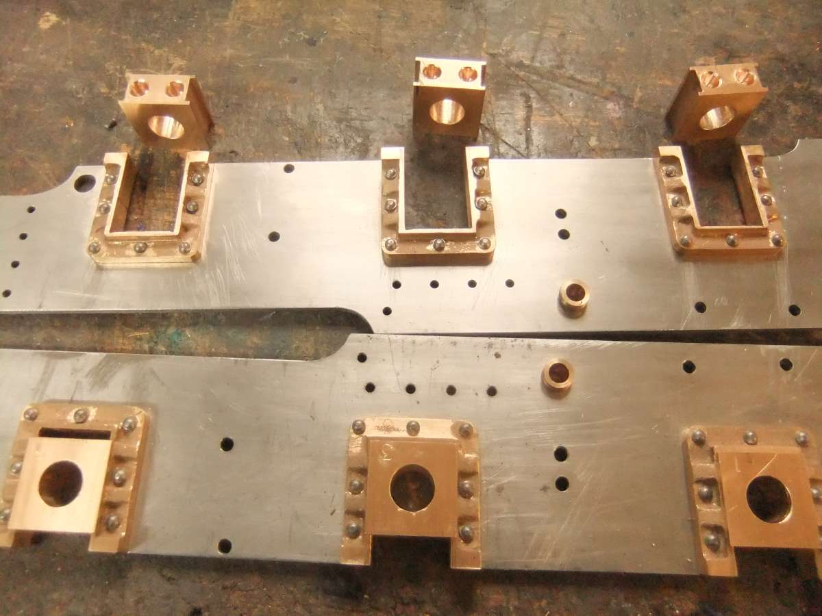

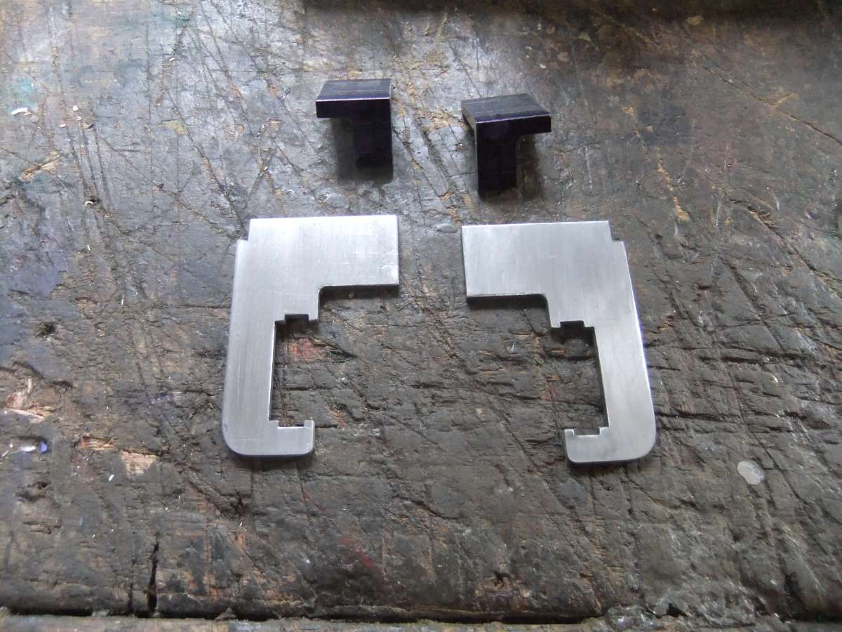

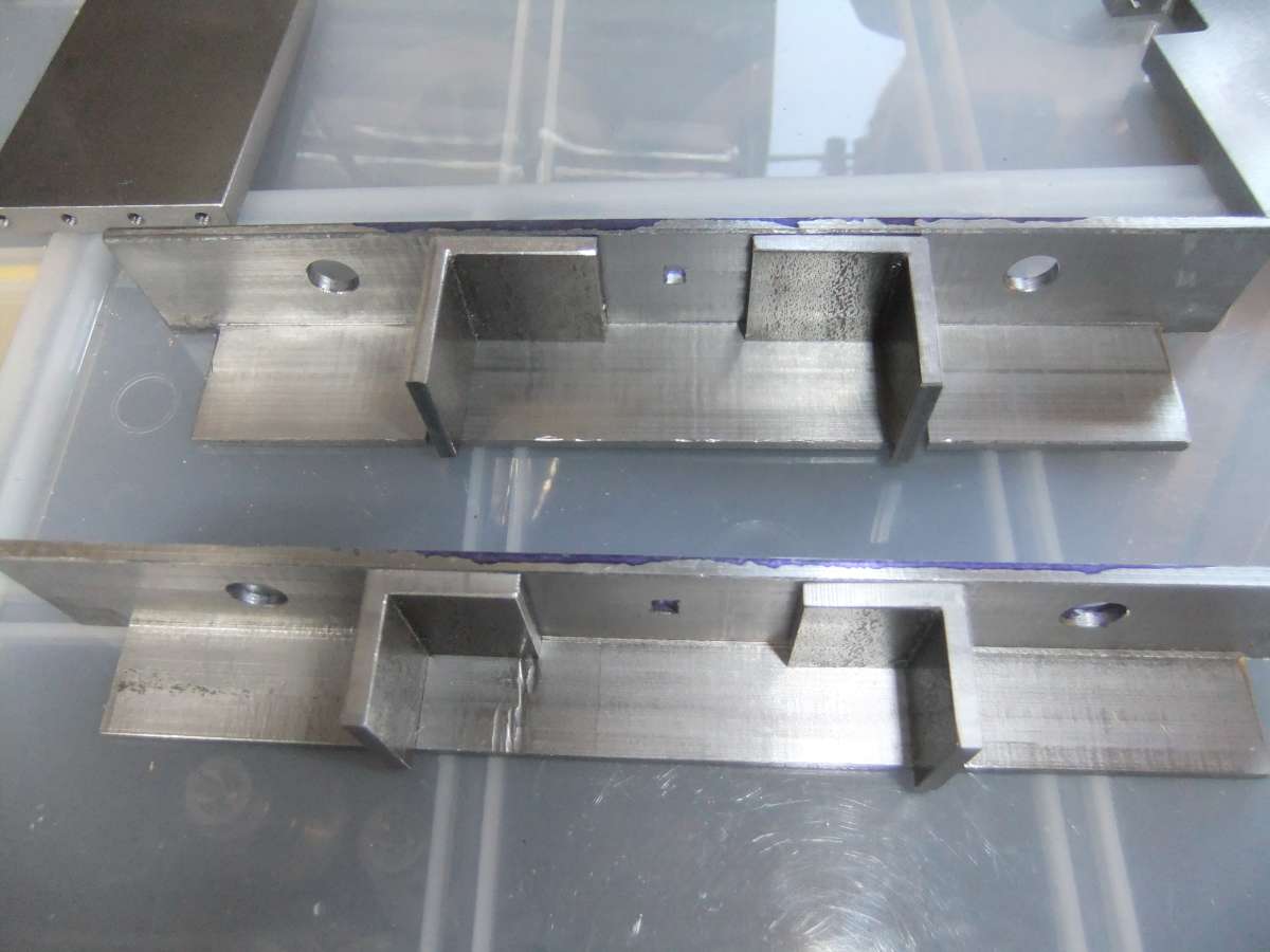

        Buffer beams and spacers as well as buffers
        DSCF2161DSCF2251DSCF2261DSCF2184DSCF2174DSCF2253DSCF2200 bufferDSCF2226DSCF2227DSCF2234

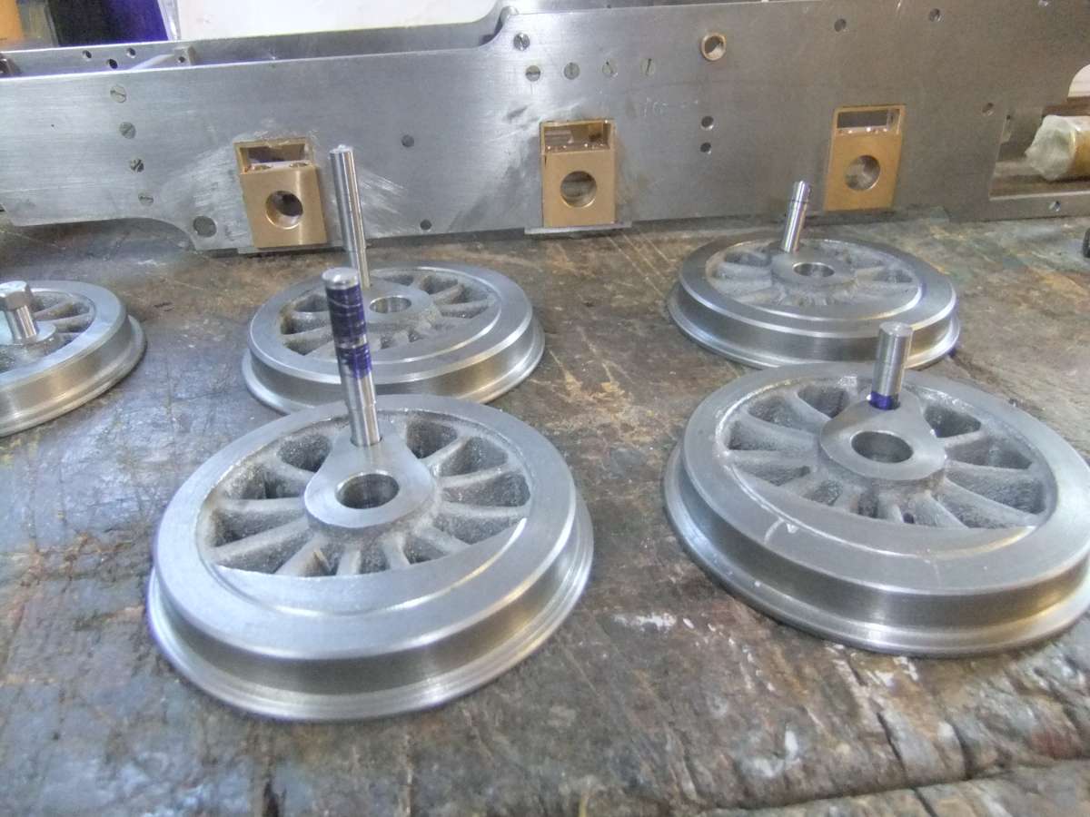

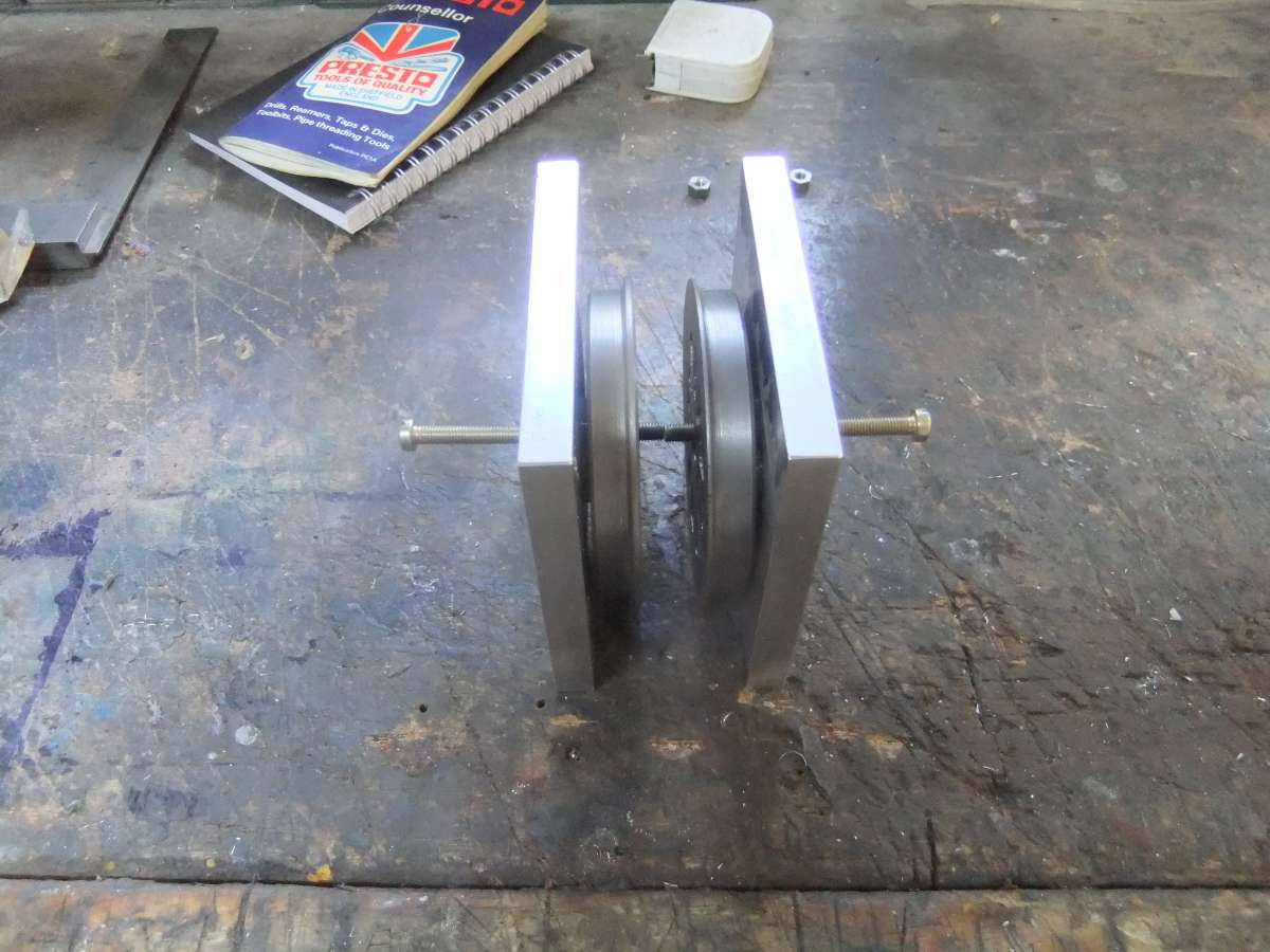

            Anyway carrying on from the last pictures.
            DSCF2186DSCF2272DSCF2282DSCF2283 (2)DSCF2284DSCF2294DSCF2291DSCF2303DSCF2307DSCF2316

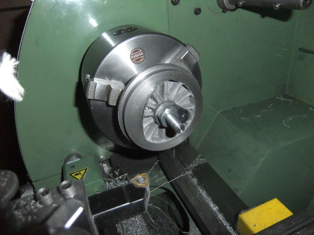

                  DSCF2584DSCF2549DSCF2582DSCF2624DSCF2689DSCF2692 (2)DSCF2714

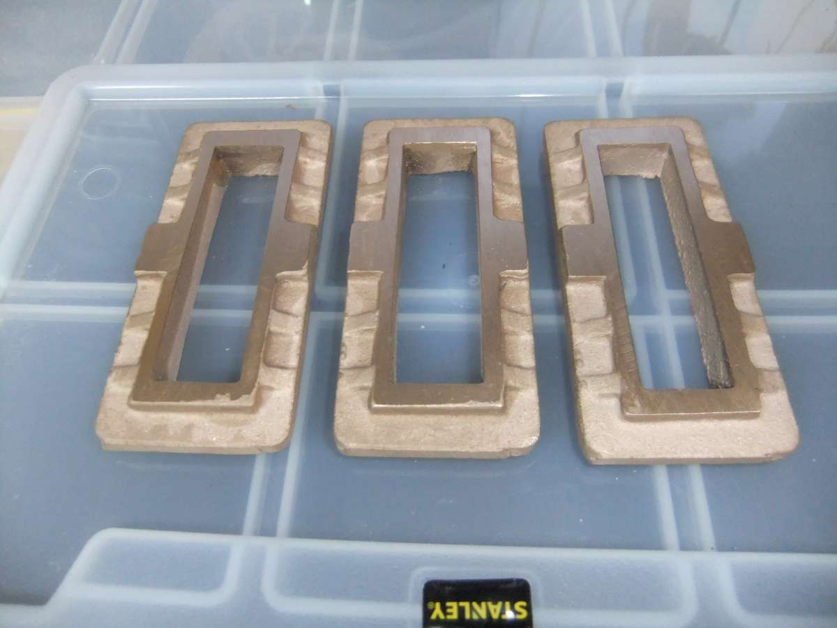

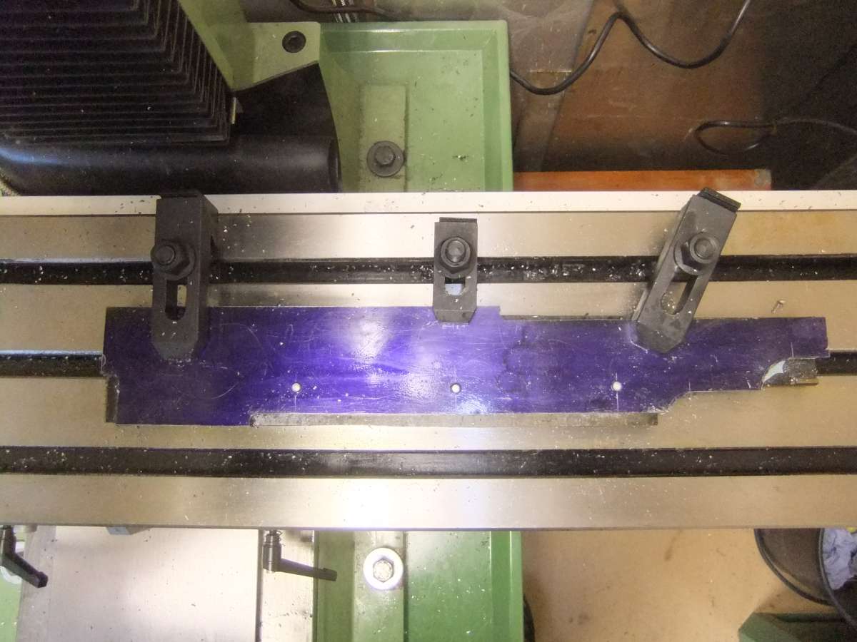

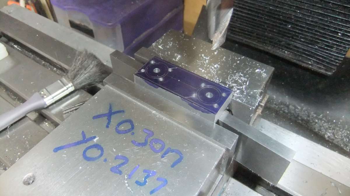

                    At this point I messed up the cylinders and had to reorder them
                    DSCF2719
                    Starting on the new cylinders machine some reference surfaces so I can bring them to the correct sizes.
                    cyinder machining second attempt (1)cyinder machining second attempt (5)DSCF2720DSCF2906

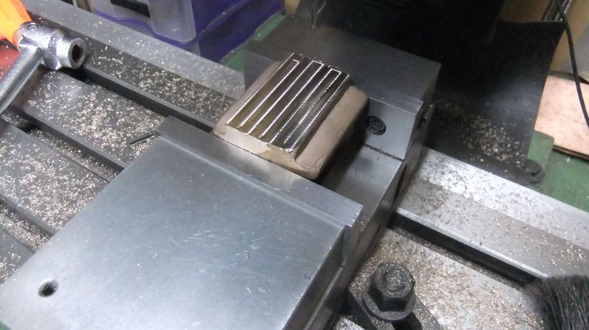

                    #828822
                    Dalboy
                      @dalboy
                      Getting close to where I am today. Tagging all of these as there are many that look the same but with small differences between them
                      Linkage started (10)Linkage started (11)Linkage started (14)

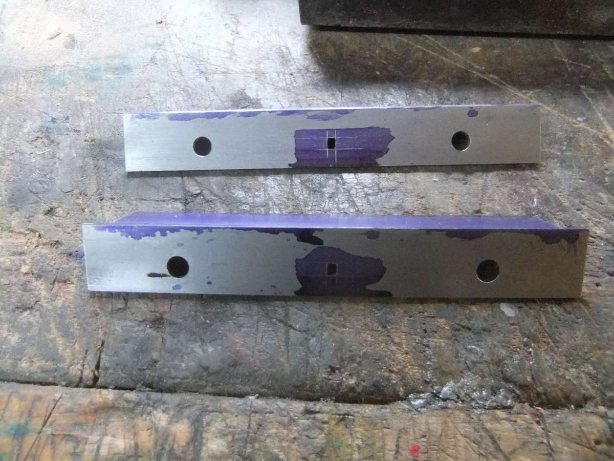

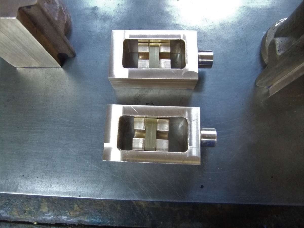

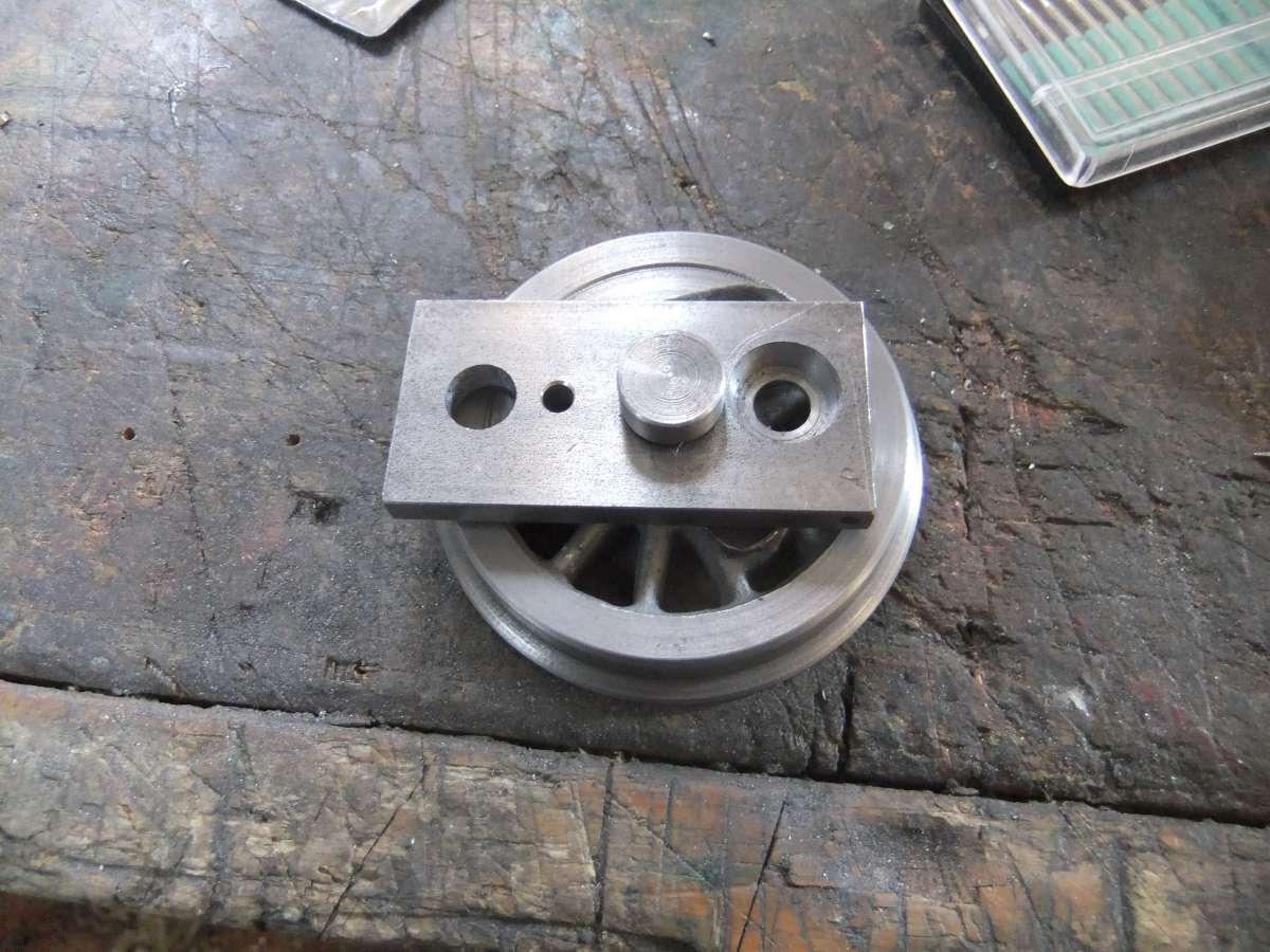

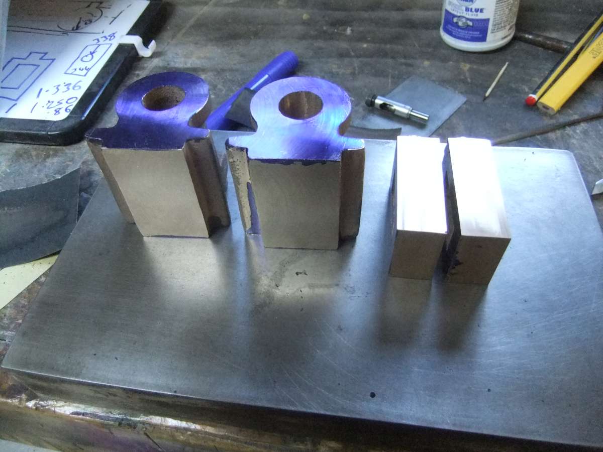

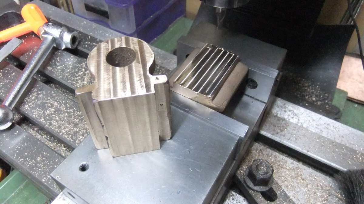

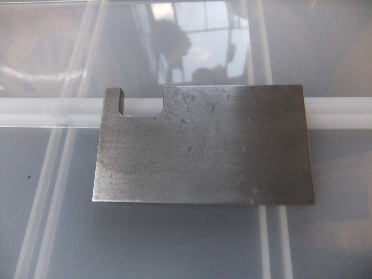

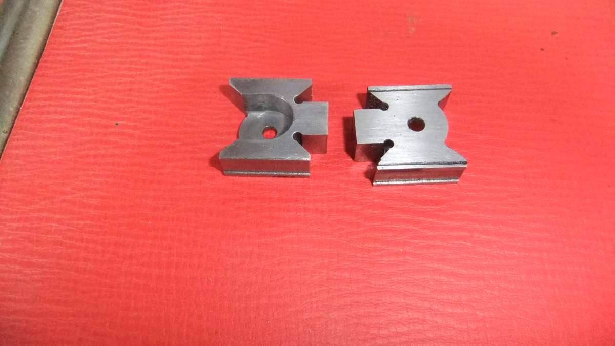

                      Well this is the part I am working on at the moment, the crossheads leaving them as one piece where everything is needed to be the same, and will separate when I need to work on the inner edges
                      Crosshead pt1 (3)crosshead pt2

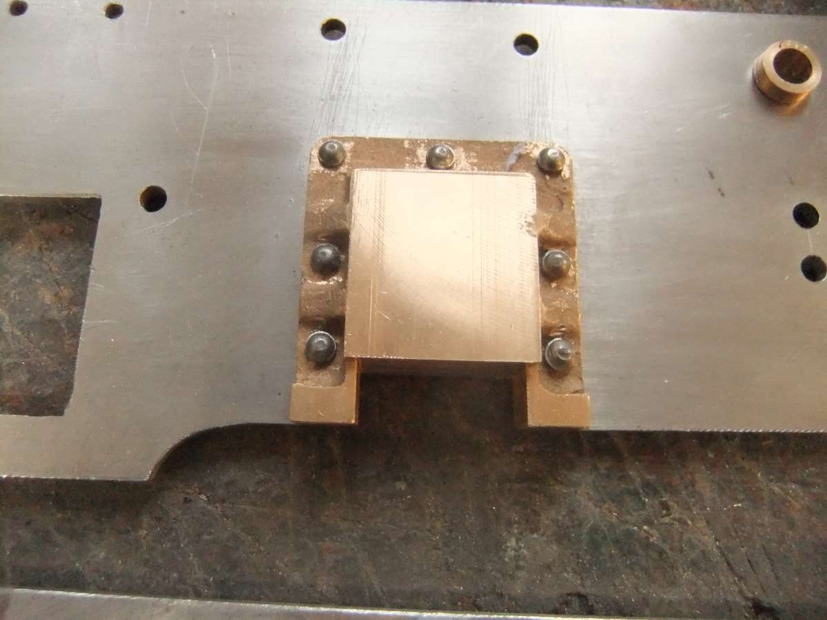

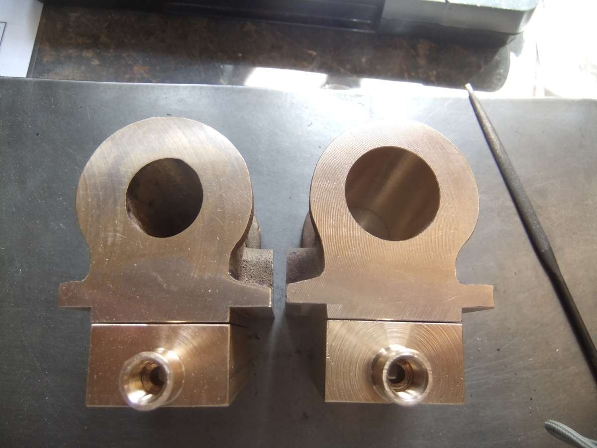

                      #829485
                      Dalboy
                        @dalboy

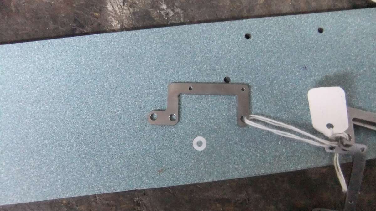

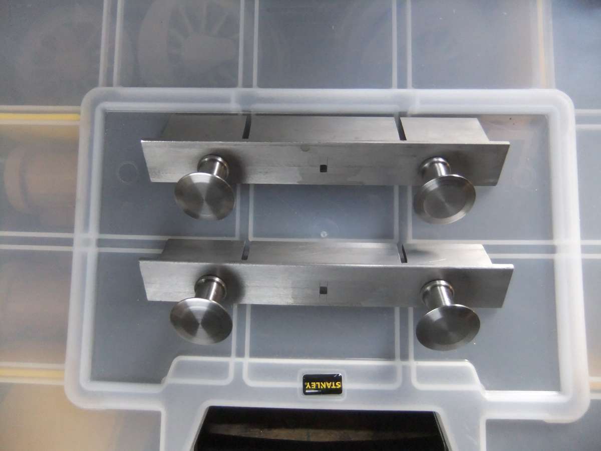

                        Cross head taking shape. Making them as a pair, that way I get one left and one right. Picture showing the connecting rod test fitted. I have made some punch marks so that they go back together with the same parts.
                        crosshead 2 (3)
                        Been machining some of the material from between the two ready for the angle cuts as the outside, Once done separate them and turn the bosses

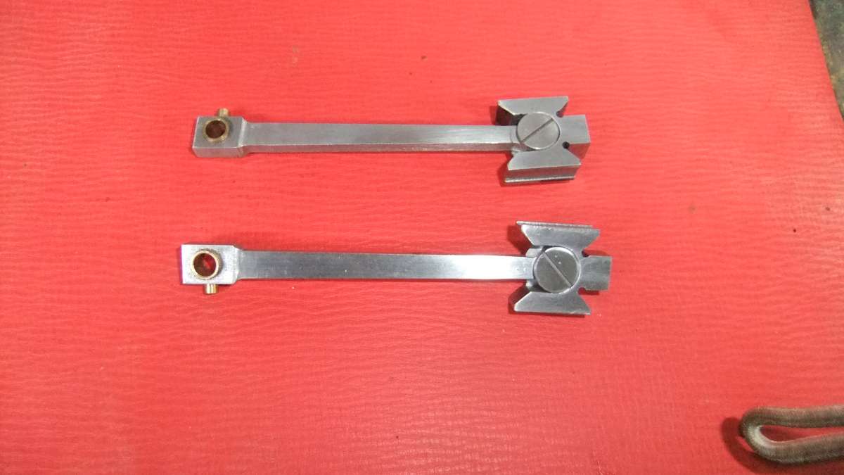

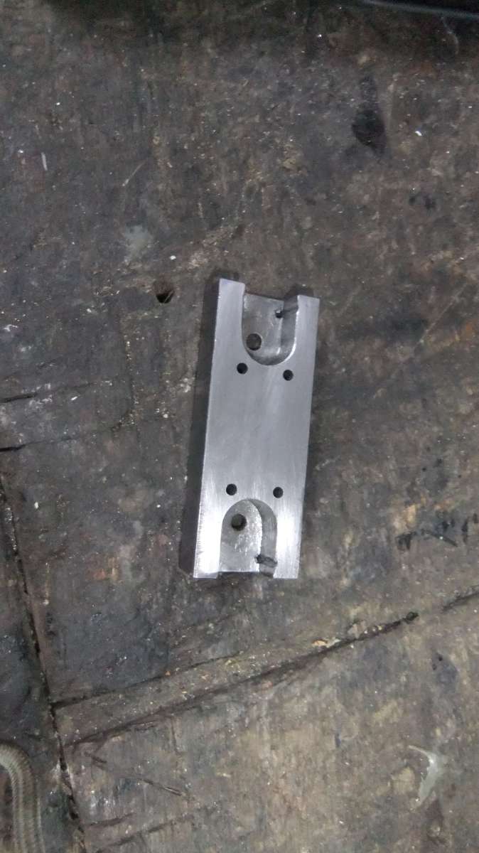

                              First piece for 2026. Well, not a new piece, more of a continued from where I left off on the crossheads.
                              Now split into two and the major shaping done, just need some filing work with a file before turning the square boss.
                              Crosshead pt 3 (7)Crosshead pt 3 (8)

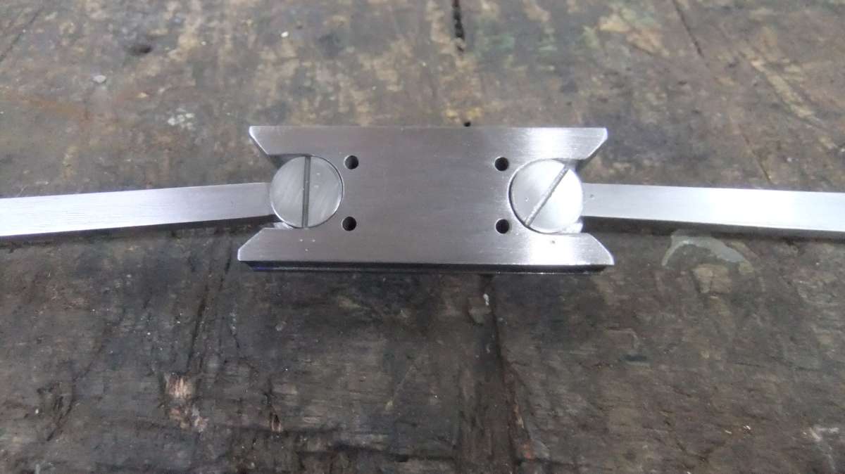

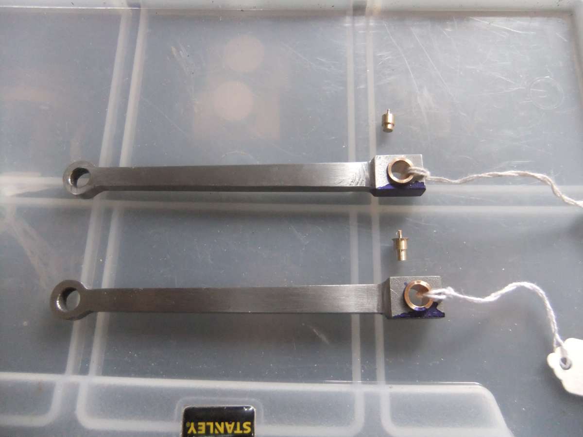

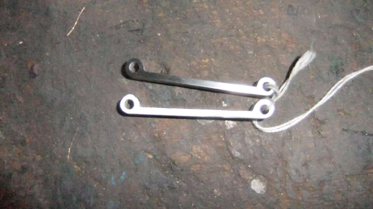

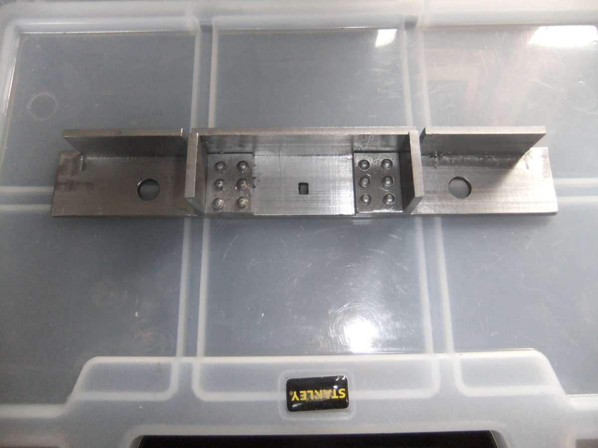

                              #833024

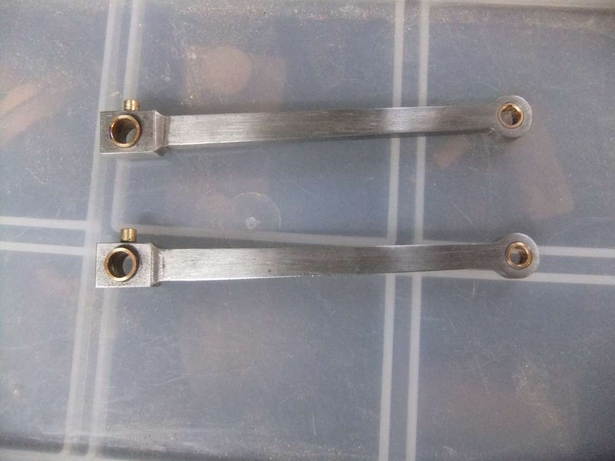

                              Dalboy
                                @dalboy

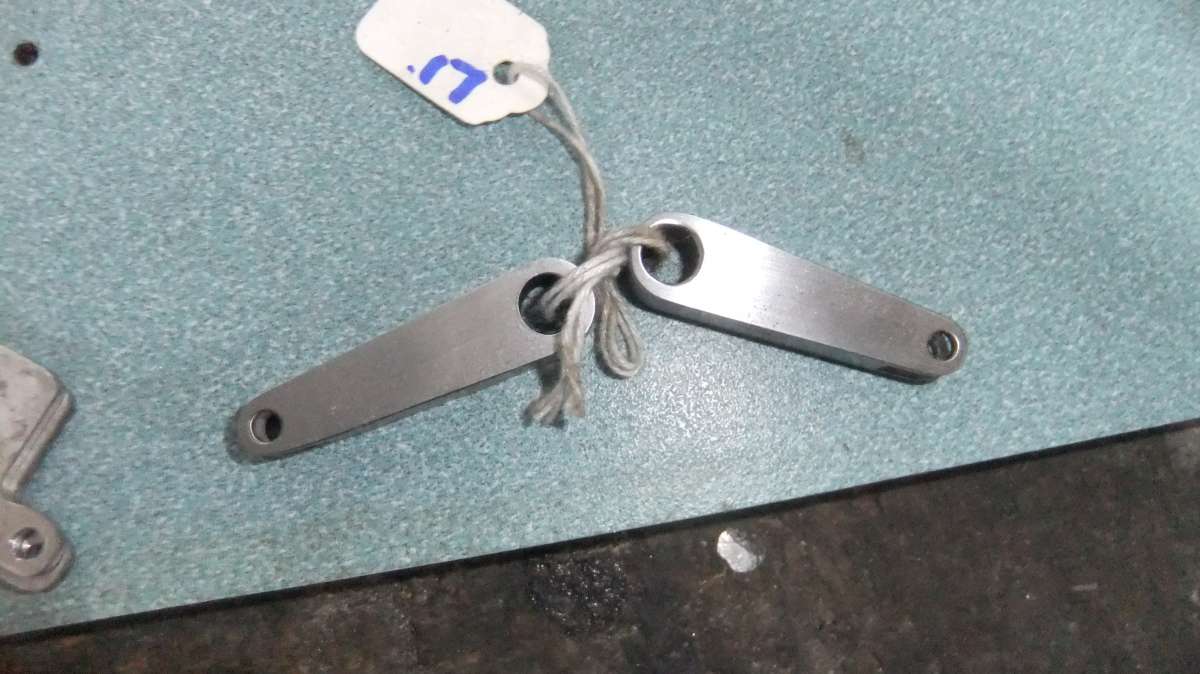

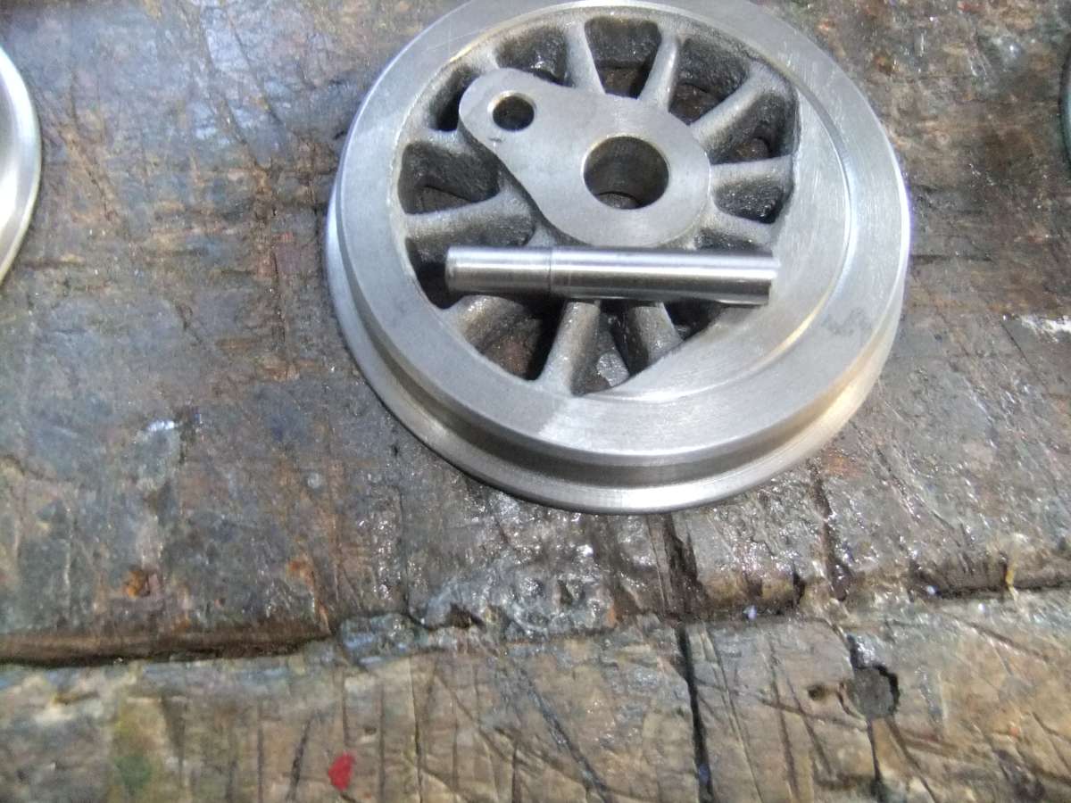

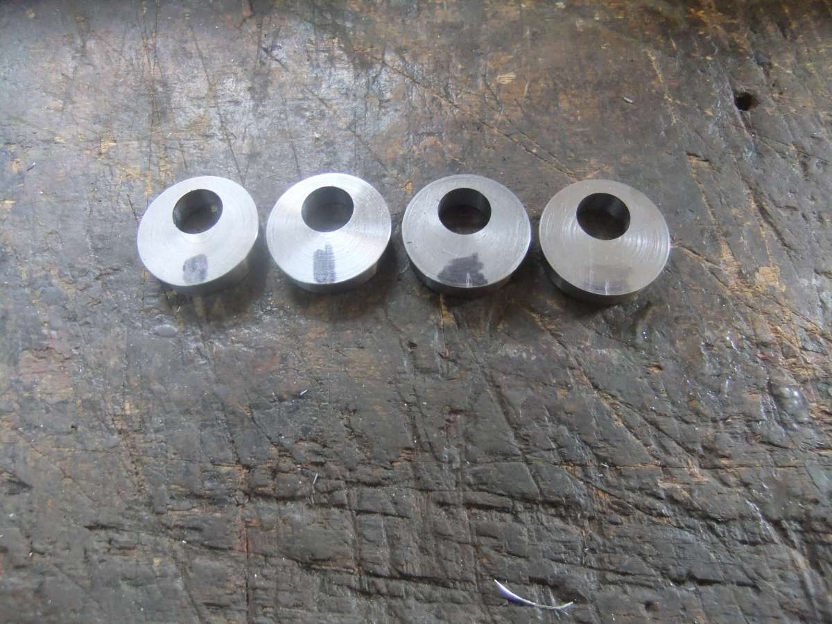

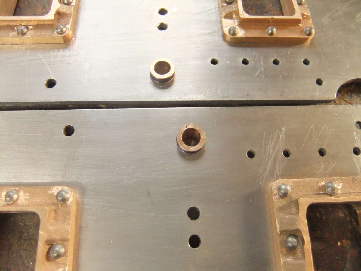

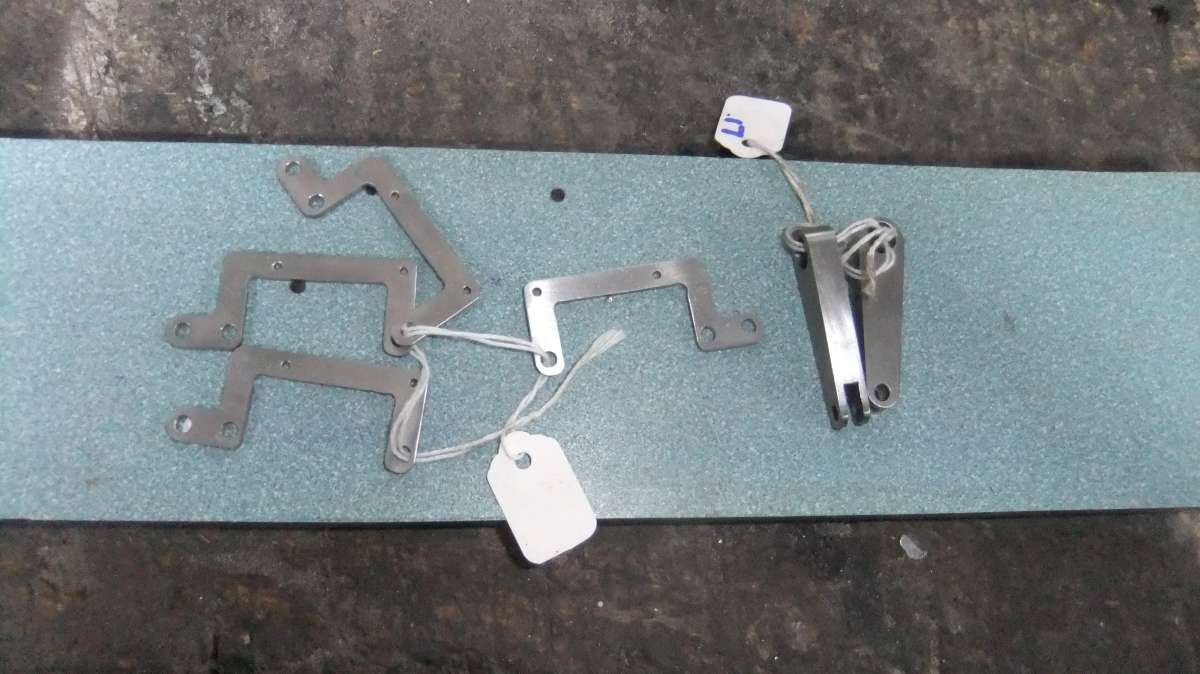

                                While waiting for some HSS tools to complete the cross head I thought I would finish the coupling rods which I started ages ago but stopped because I needed to sort out how I was going to proceed. Now that I have done more machining on other parts, I felt comfortable to get them finished.
                                How I left them
                                DSCF2530
                                DSCF2538
                                Where I am today but with a small bit more to do.
                                coupling rods (4)
                                Lower set complete and bushes installed.
                                coupling rods (7)

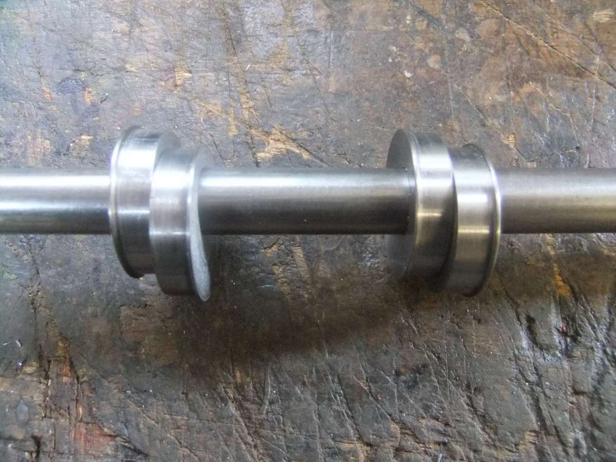

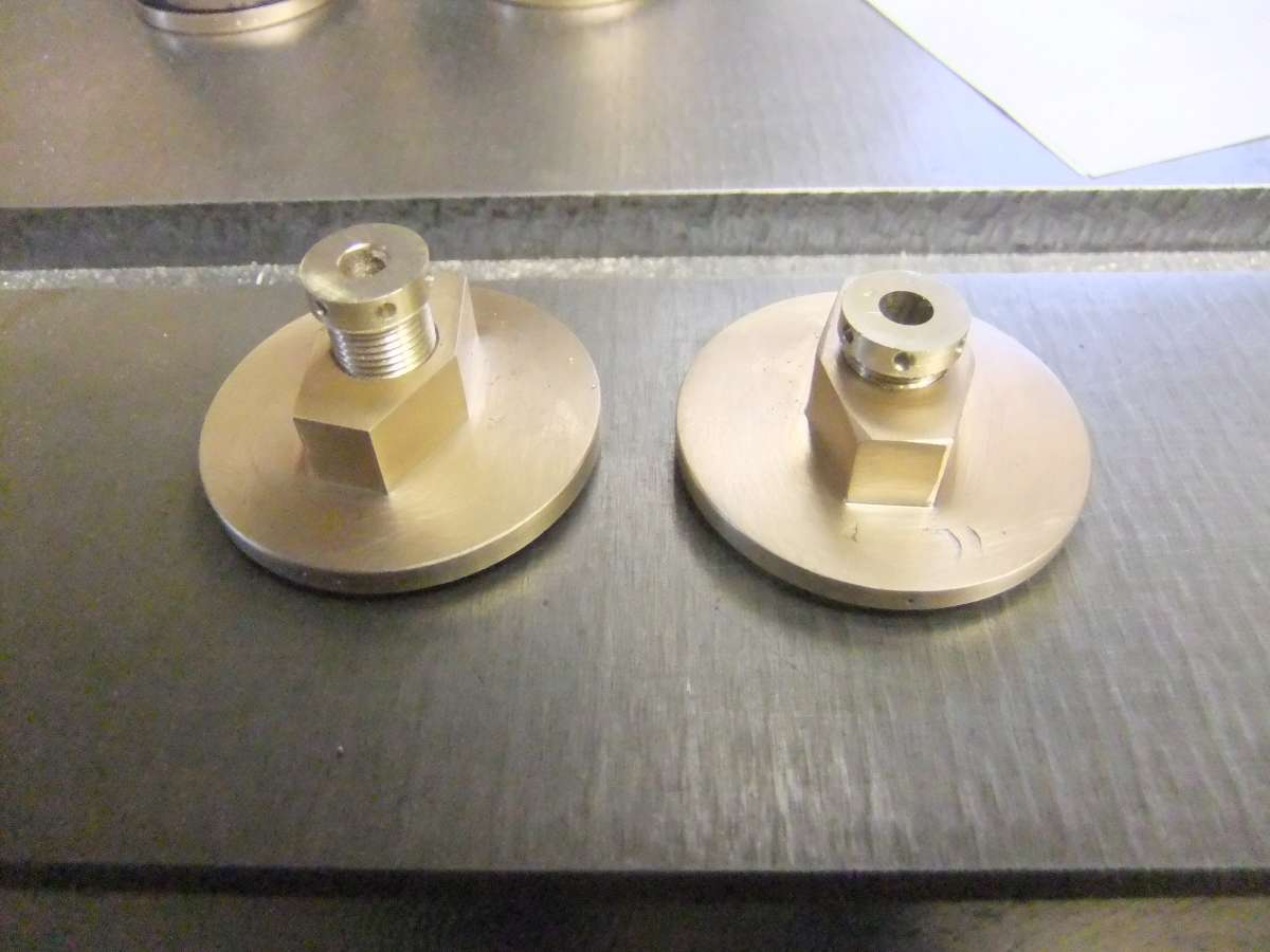

                                #853058
                                Dalboy
                                  @dalboy

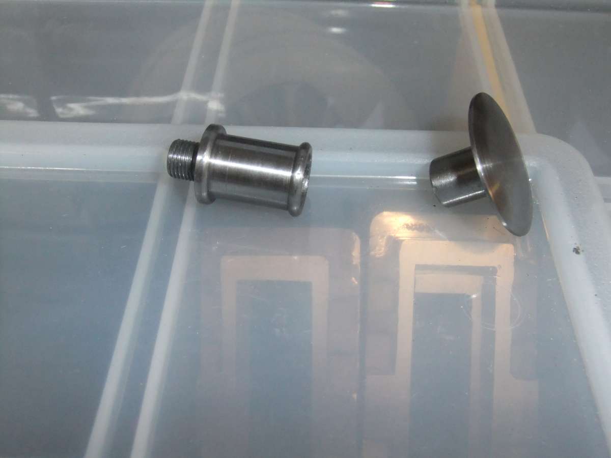

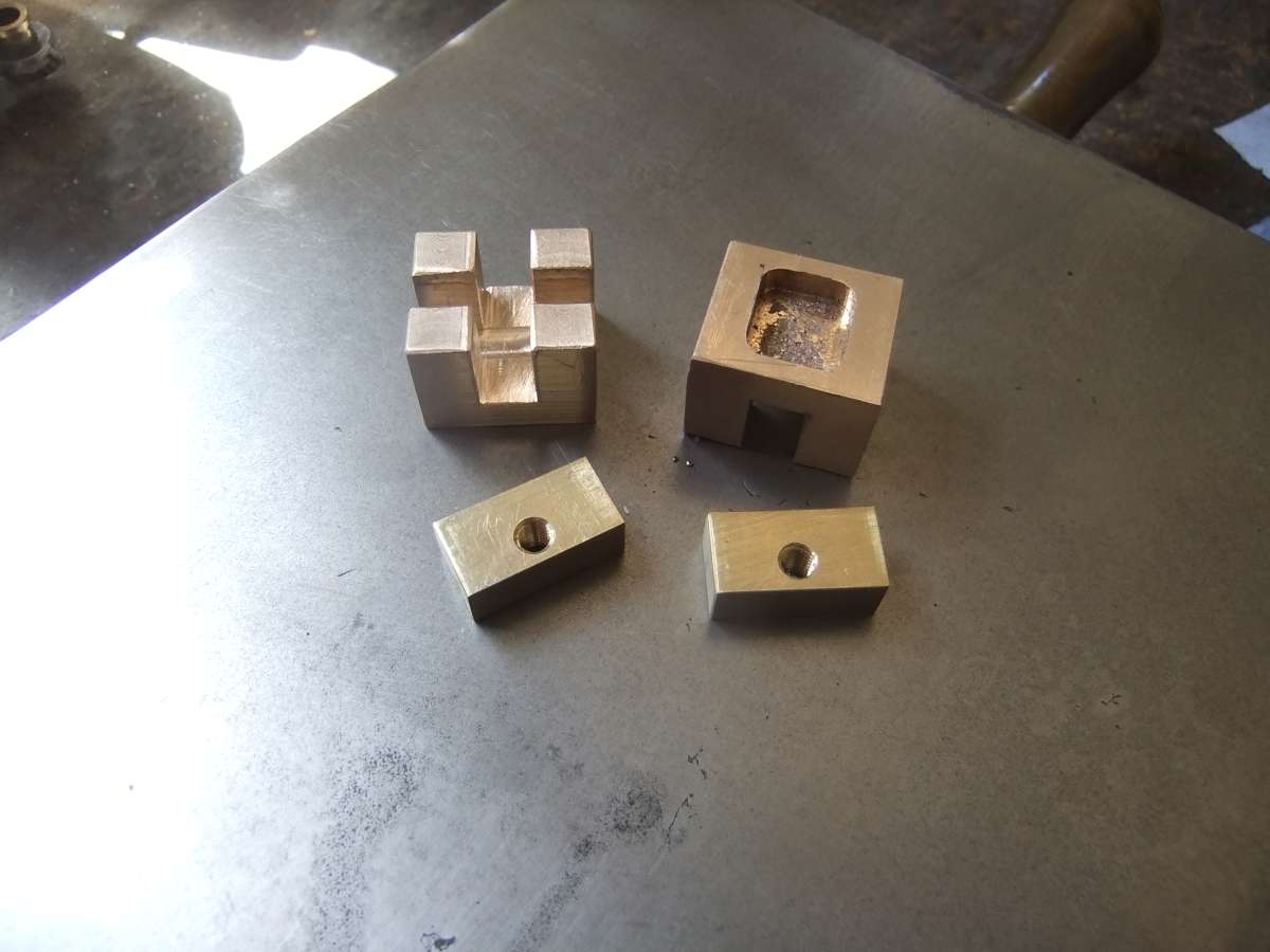

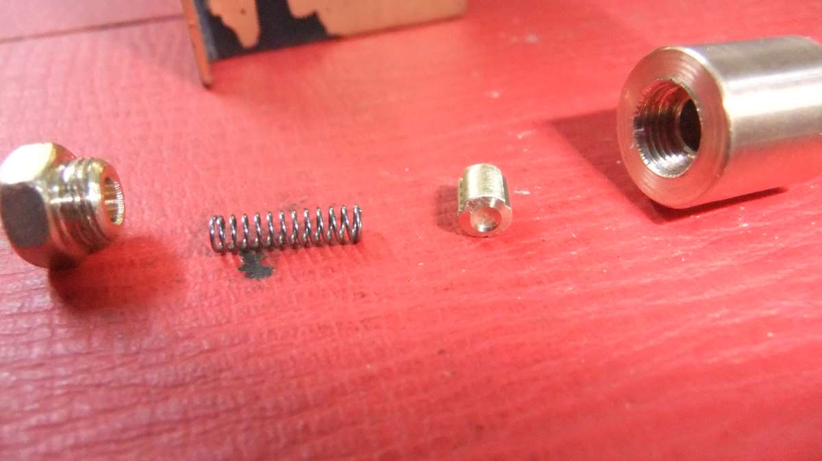

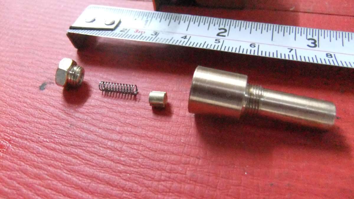

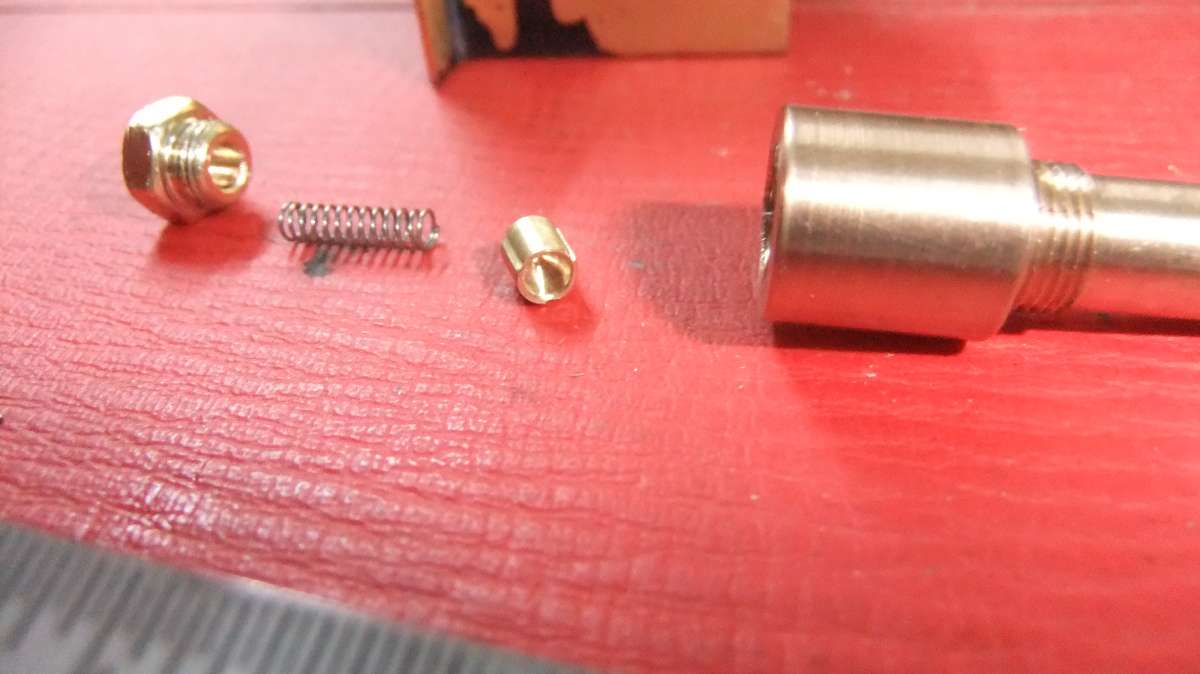

                                  Did not realise that I had not posted or done anything to The Rob Roy for a while. I did mention that I was going to have a go at making the lubricator.
                                  What with other minor bits I have done in the workshop one being the tailstock gauge and another being to get the ER32 collet chuck running true on the lathe. Then there was the time-out while not feeling too well.
                                  So far a few bit made with more yet still to be made. Ruler for scale
                                  DSCF4583
                                  DSCF4579DSCF4580

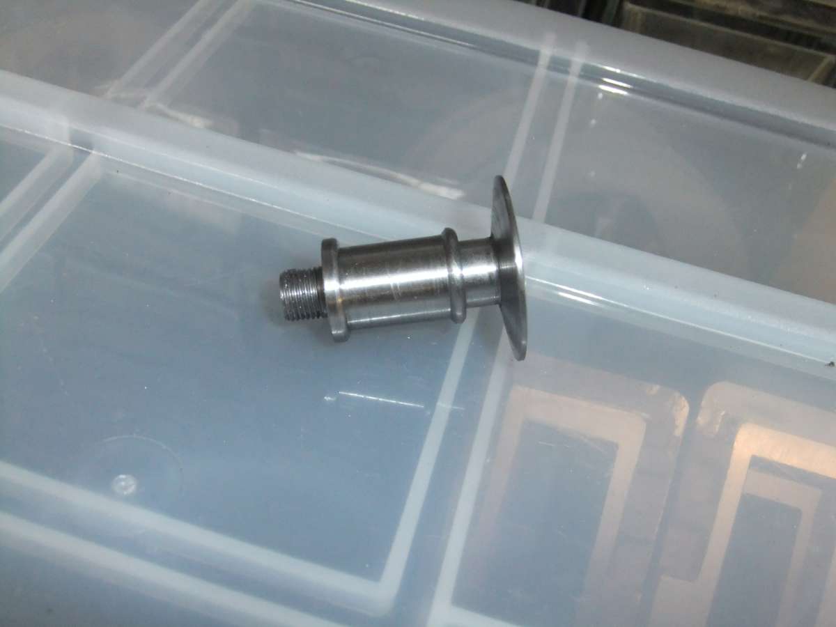

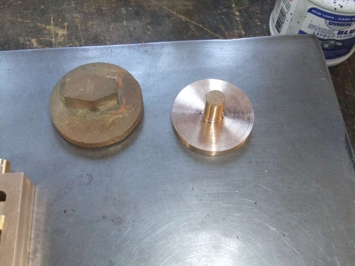

                                        #863524
                                        Dalboy
                                          @dalboy

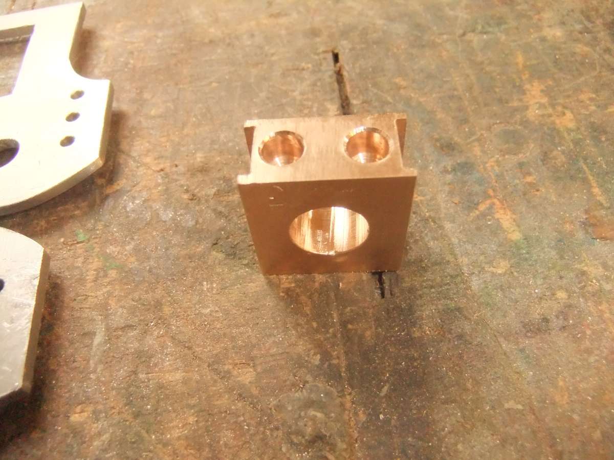

                                          Not done much for a while but have managed to make a few more bits for the lubricator, some I have had to remake as I was not happy with them and some remade because I did not match the drawings with the written word in the book like the hole in the bottom of the tank part in the book it says 3/8″ but after realising that the drawing in the same book requires 5/16″ (must pay more attention and double check everything).
                                          oiler
