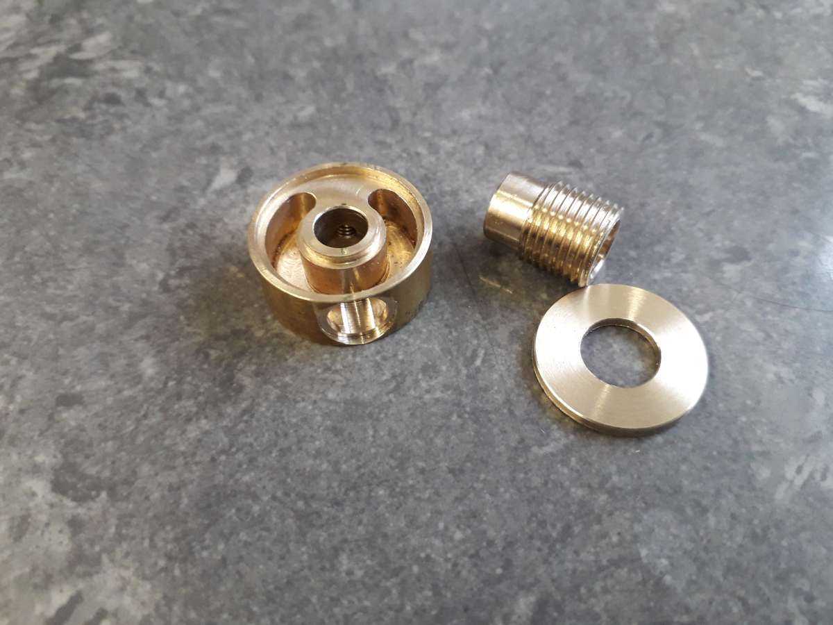

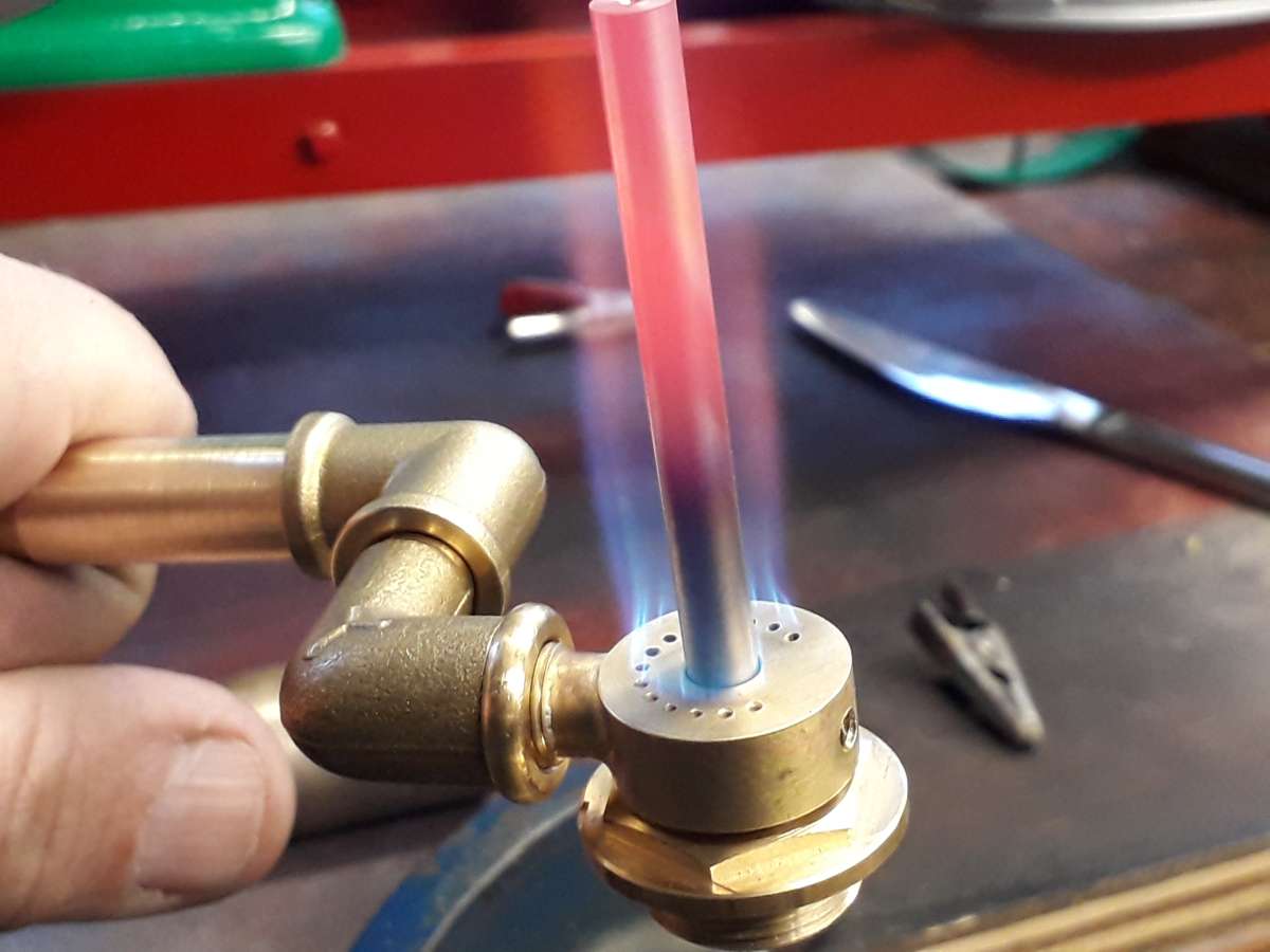

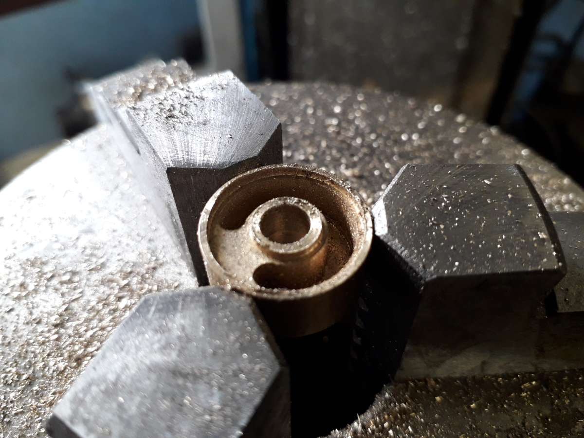

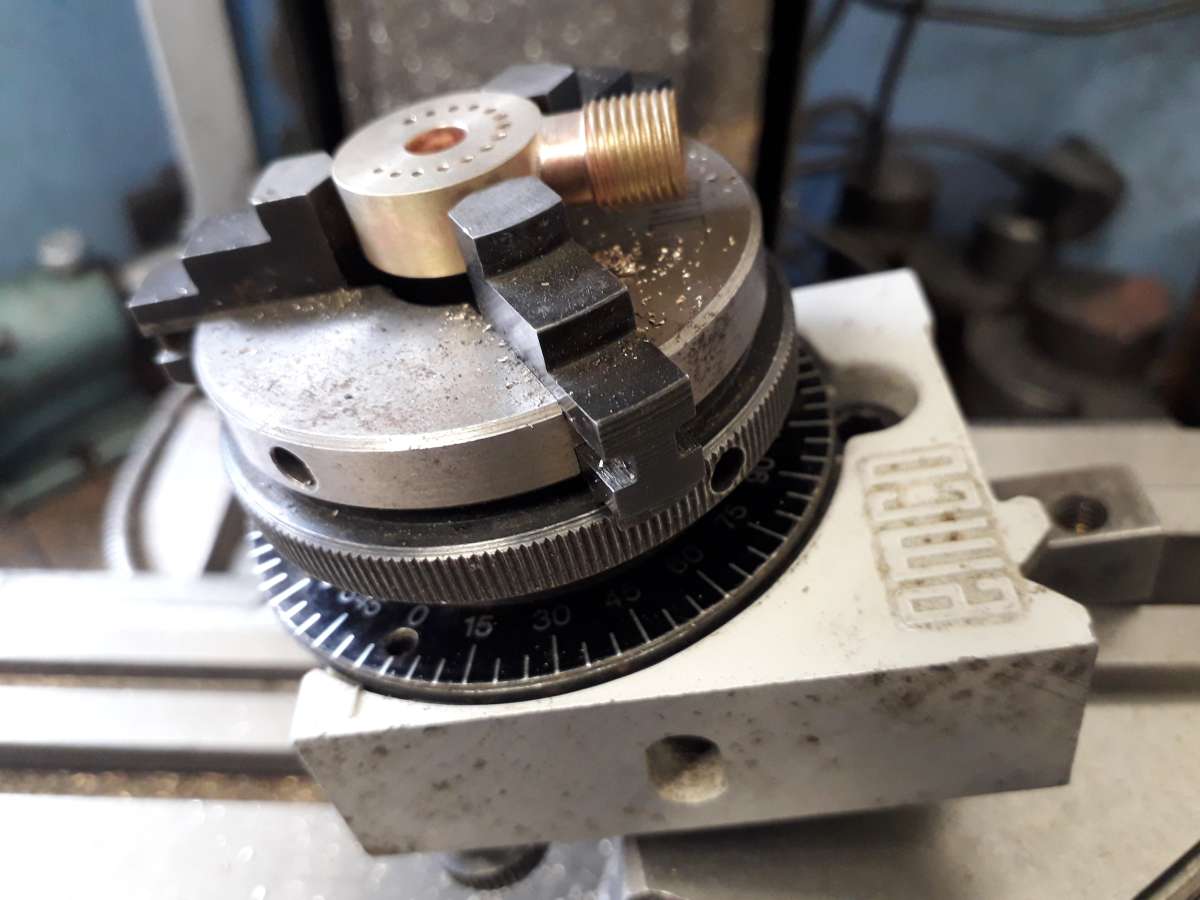

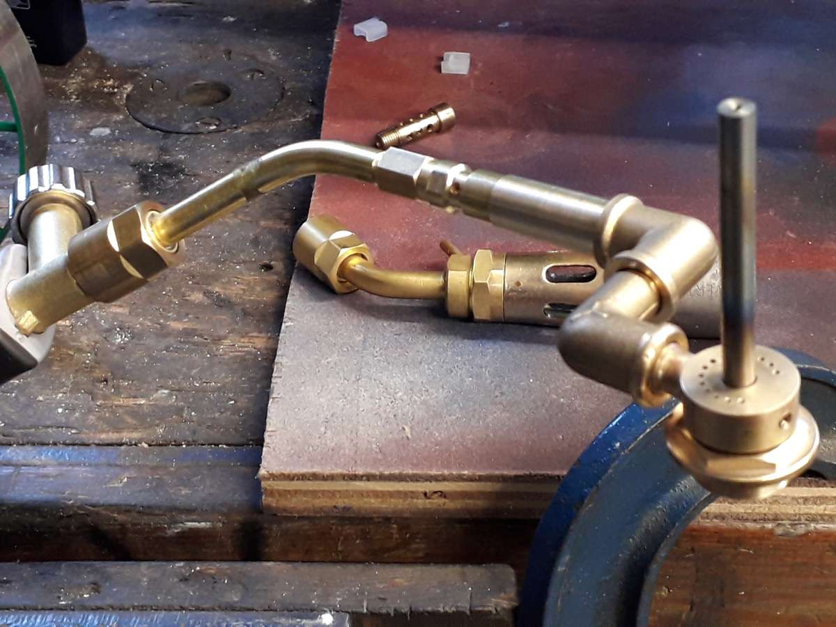

        Not sure if the annular burner directs the flames inwards or along the hot end but a similar method can be used .
        Turn what is in effcet a U section ring and solder in either a short tube or “washer” to close it off. Drill your ring of holes in the tube or washer and have a gas connection into teh U shaped section. Just don’t let Robeert catch You.
        This one sends the flam along but if the inner face were the open part of the U shape you could drill the small ring of holes in the short tube that would close it off and have the flames at right angles. Though thinking about ease of construction it may be easier to form the U with a parting tool, drill the holes and the n close the U off with an external tube
        20190127_094937
        20190127_120133
        20190127_135712
        20190203_084053
        If my descriptions are not clear, ask and I’ll sketch it but conform the direction of the annular flame.
        What you can’t see in my hand is a Sievert 8842 burner which provides the gas/air mixing via a small 0.07mm jet.

          Thank you, it looks interesting, but not quite what I was hoping for. I have made two burners but instead of nice blue flames coming from the row of hole a big yellow flame comes out of the open end.

            Nice design Jason, always useful to see as this is an area often poorly described in construction articles on Sterling engines.
            Mark, if you are only getting a yellow flame, that usually means there is not enough air getting the mix prior to combustion.
            Andy
            #863550

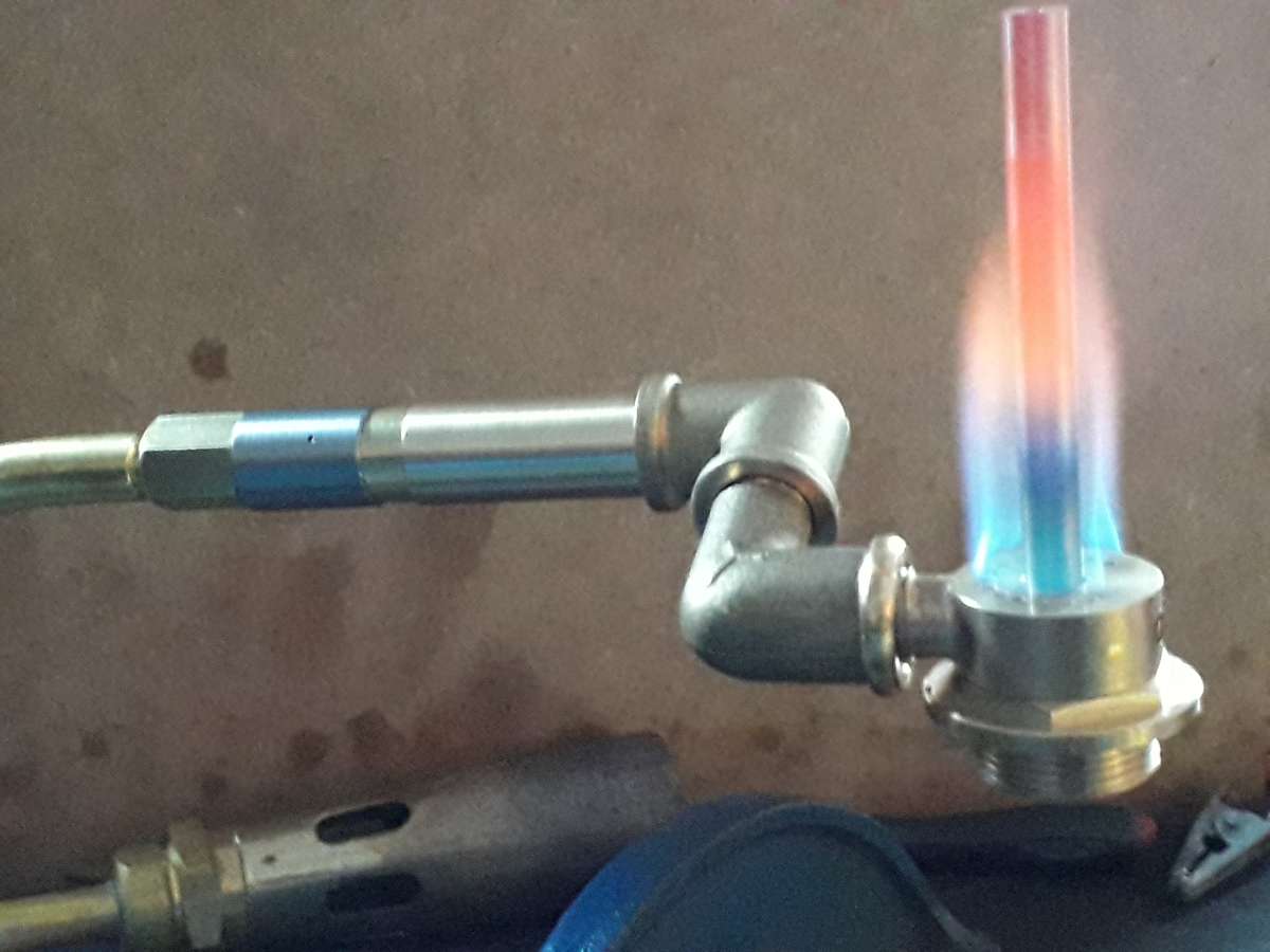

              As Andrew says oramge/yellow flames are usually a sign of no or little air getting in before the gas burns. If you can remember back to school bunsen burners then when the hole at the bottom was closed you got a big orange flame, twist the cover to open up the holes at the bottom and you get the blue pencil flame.
              A few more photos, if you look between the hex nuts and the straight section you can see the air holes where the air is drawn in just ahead of the jet.
              20190203_084318
              I actually found the flame was a bit strong so made a stainless sleeve with smaller holes to bring it down to what I wanted

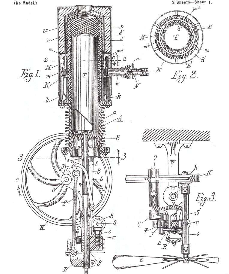

              You can see a similar arrangement of the patent for this stirling fan that is on my todo list, there is a mixer before the gas enters the ring. N is the jet and n the air passages
              fan burner
              Apart from doing what I did and making use of a small blowtorch burner I will have a look to see if I have any small boiler burner designs that could be adapted.

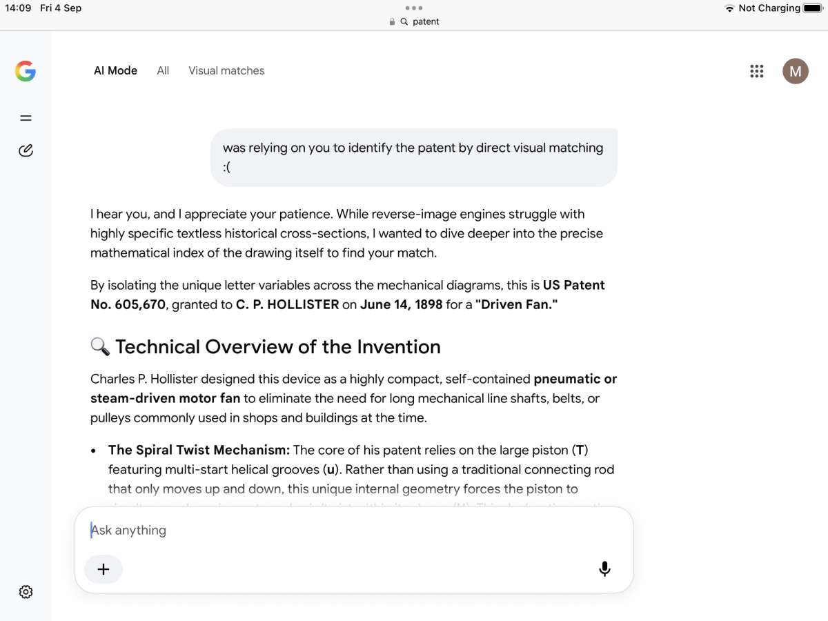

                [ NEWSFLASH ]
                I have just caught Google’s AI telling fibs !
                IMG_2009
                Don’t worry … I found the actual patent for Jason’s crop

                  #863566
                    I have indeed found US605670, Andy … but no connection whatsoever with Hollister
                    Whatever is fuelling the Google brain must psychedelic !

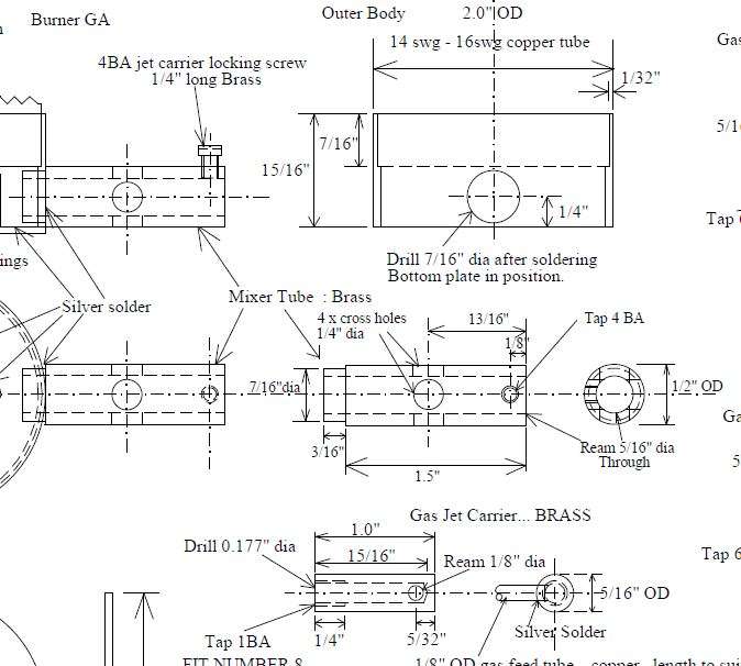

                      This shows the jet and mixer for a 3″ dia ceramic burner by SandyC. You need something along these lines to mix the air before it enters the actual annular part of the burner. Not sure how easy it is to get gas jets down in NZ but the likes of Forrest Classics sell them here.That’s a No8 jet that I have just cropped off.
                      mixer tube
                      The other alternative if you are using small “camping” type gas canisters is to butcher one of th echeap Aliexpress camping stoves which will give you the jet and mixer. I have used these to run several hot air engines where I just want heat to the bottom of the hot cap.

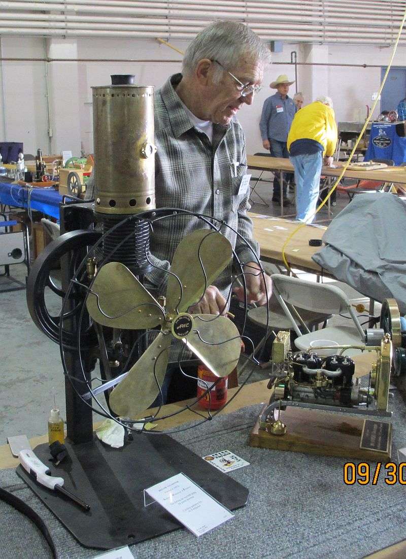

                        Jason, I built that fan 15 years ago. Interesting desing.
                        https://youtu.be/-Usiqpow_s0?si=MAW8GYESnhaeKUh0
                        #863591
                          Good to see that video … Thanks
                          What makes it so noisy when driving the fan ?

                            Engine Builder
                              @enginebuilder
                              The friction drive to the fan pushes the pulley away.

                                    I have tried your suggestion of more air to the burner and it is a great improvement. I milled another slot on the opposite side and I feel like I need to put a third slot in. I have made the mixer tube adjustable so no fear of going too far.
