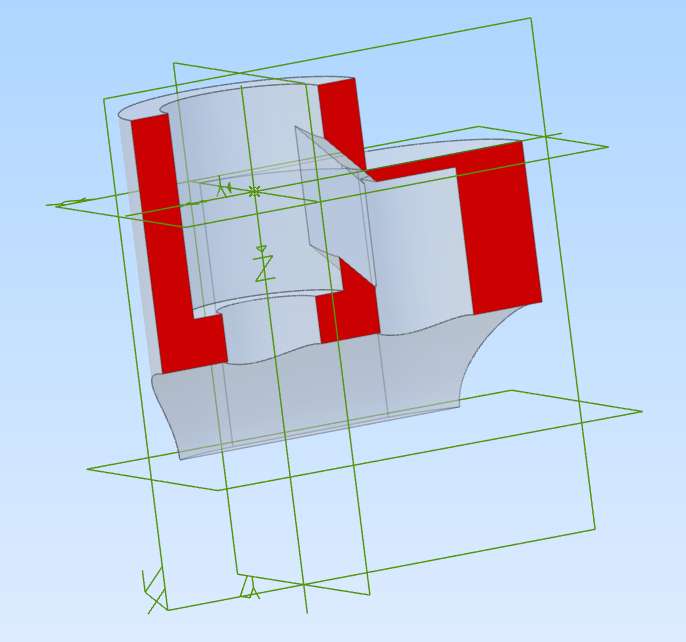

      The screen-shot is of a sectioned, non-return valve body, part of a tiny but complex assembly whose original design was more prettyness than practicality! I’m investigating an alternative way for more feasible making; but as the real thing needs extremely high-precision machining and fabricating to work at all, more as an Alibre exercise than reality.
      The arcuate horizontal section is a joint-face with a horizontal, hollow cylinder to which the component is soldered.  I I modelled the cylinder but found its internal parts too difficult to model, and the original drawings (reduced for printing in a book) are almost illegible, so I omitted them.
      The problem lies with that port sloping down into the left-hand cavity.
      My modification replaces an awkward slot with a circular hole placed to drill without damaging the upper rim of the chamber, or so low it prevents the valve working.  Such problems are normally solved by drilling horizontally through both walls, then plugging the outer wall.
      It took over an hour to plot this wretched port, and then only by cutting in from a rectangle.
      If however, I had to illustrate it as a round hole, with its axis sloping down the cut plane, and at a definite height in the cavity, how is that done, please?
      Injector Valve Ch (2)
      (Yes, the port does graze that external corner but I cannot modify the drawn outline to suit.)

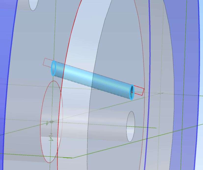

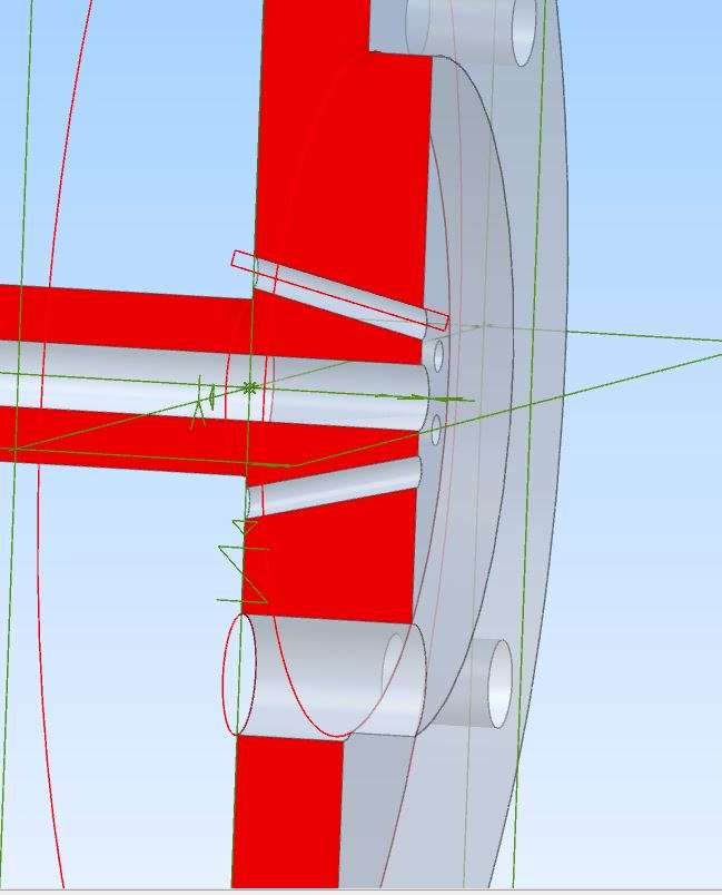

      #863377

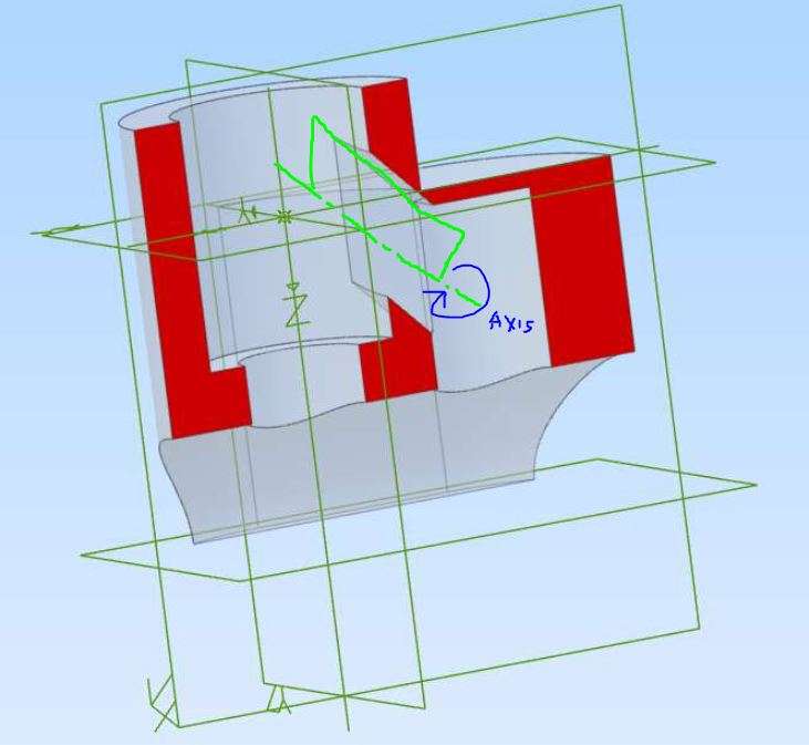

        The way to do it is to sketch “half the hole” as indicated below with one side running along the ctr line where you want to place the hole
        sketch
        You can then use the “cut rotate” by selecting the sketch as the item to rotate and the edge that is on the ctr line as the axis of rotation.
        axis

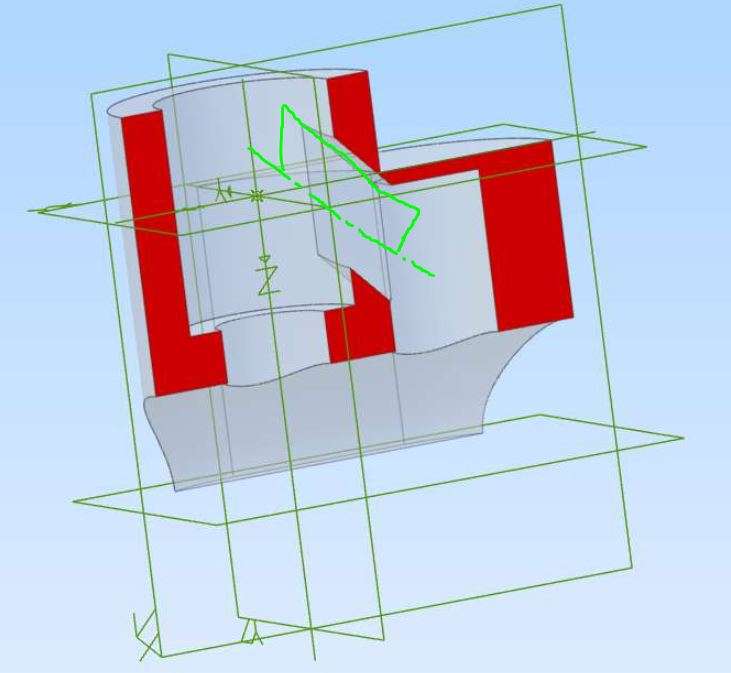

        Here is an example on one of my parts
        sketch 2
        axis 2
        axis 3
        axis 4

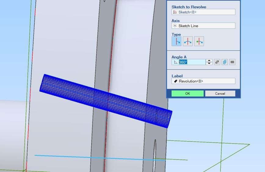

            #863497
              The box may be asking for an axis  but you can click any one of the lines that make up the polygon.
              I have the “new look” V29 but have been doing the same with older versions which would have had the same screen a syours. David has shown this method to you before and so have I so if he did it then Atom should be able to.
              The good thing with CAD is you can easily see of the angle of your hole will miss the top edge of the part and you can deduce the angle you need to drill at, maximum diameter, etc from the CAD. That part I used to illustrate the method needed the holes position and diameter altering several times a ssubsequent part swere added an the design altered to suit those. I was just working from a few engraving sfrom 1895 so no dimensions to guide me.

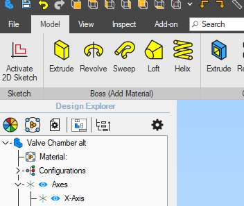

                      #863751
                      Nigel Graham 2
                        @nigelgraham2
                        Screenshot 2026-09-05 221755
                        This is the control I’ve always been using, below the word “File”, but without selecting any specific sketch from the list below it first. So is that where I’d been going wrong?
                        I have just experimented and found the Edit tool only works with Model selected.

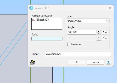

                                      #864008

                                        I also can not select the edge of a simple rectangle, sketched on (in my case) the XY plane, for the revolve axis.
                                        Opening the Revolve tool, causes the sketch to disappear from view and can only be shown again by clicking on it in the Design Explorer.
                                        I can attach an Axis to the edge and use this for the revolve, but this should not be required.

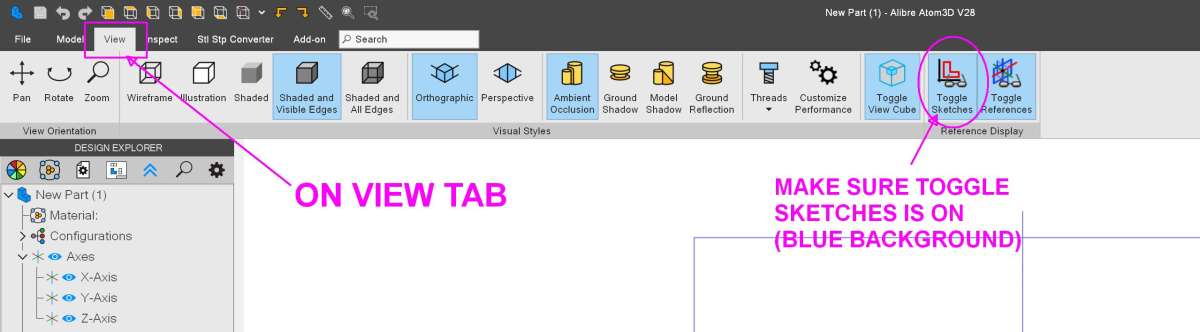

                                          Do you have sketch visibility toggled on in the View tab of the ribbon?

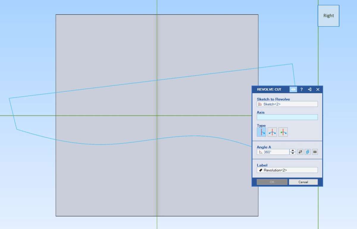

                                            As I said, I tried this morning with a far simpler example, just a rectangular block with a rectangle protruding into thin air to make it easier to select. That would not work either.
                                            Just tried yet again. This is what the tool shows:
                                            Screenshot 2026-09-07 173431
                                            The rectangle does stick out of the block, top and bottom, but cannot be selected for revolving. No way to select it. Revolve Cut wants an axis I cannot provide either.
                                            I drew a little rectangle lying along the X-axis. That will revolve to make a cylinder, but only around the X-axis. Nothing else.
                                            There must be very tight limits on what these tools can do, but I cannot work out what they are.

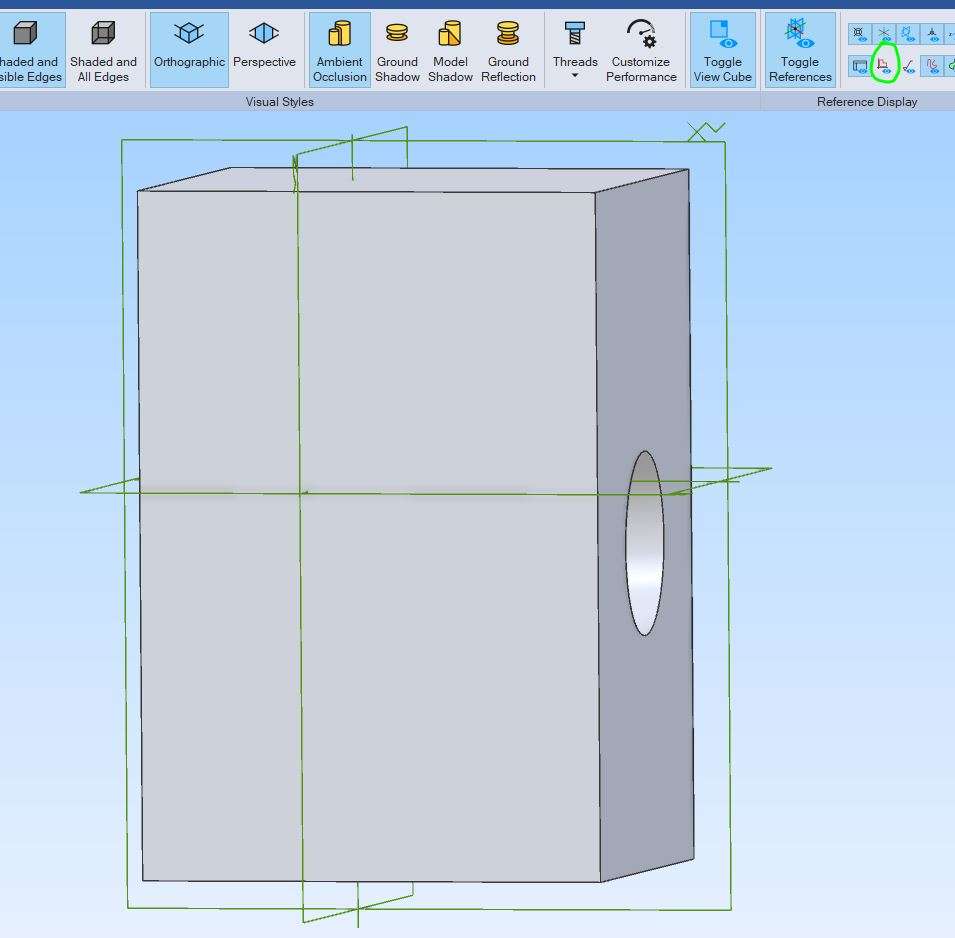

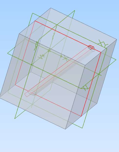

                                              Nick and I think Nigel too, before your sketch disappeears is it blue?
                                              As David says if you do not have sketches marked as vissible you wil not see an edge to click. It’s a feature I always have visible and expect David does too.
                                              This is with it visible an dyou can see the sketch in red along with the previous one used to sketch the box
                                              view sketch
                                              If I unclick the sketch visibility then that blue sketch (most recent item) will disappear if you click the revole (and other) tool. So you will not be able to click on a side or end of the sketch
                                              view sketch 2

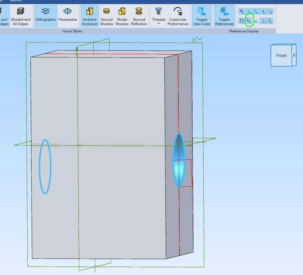

                                              #864019
                                                This replicates Nigel’s screen image. The sketch is in blue and the box has the sketch No in the “Sketch to revolve” box but you can’t click the blue sketch. Making sketches visible will turn that sketch red as the cursor hovers over a line that could be an axis and then you can easily click a part of it.

                                                  Here I try to select part of the sketch but can’t. Turn on visibility and then as soon as the cursor is over a line it turns red and can be clicked
                                                  #864028
                                                  David Jupp
                                                    @davidjupp51506
                                                    Nigel,
                                                    “Sketch Line” in the axis box indicates that Jason had selected a line in a sketch to act as the axis of revolution.  Form in my version is not substantially different from yours – I even set my system to run in Atom3D mode as a double check that I’m not misleading you with Pro/Expert options that you don’t have.
                                                    I could probably sort this out in a very short space of time with a screen share.
                                                    Toggel Sketches (Atom3D)
                                                    #864047
                                                    Nigel Graham 2
                                                      @nigelgraham2
                                                      Thankyou!
                                                      At Last!
                                                      It’s not the most obvious move.
