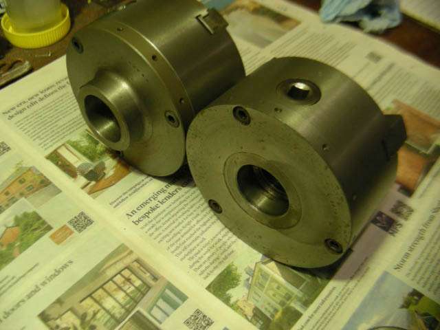

                              On JasonB Said:
                              <p class=”bsp-quote-title”>… A Myford one for example needs the boss out the back for the thread …</p>
                              Certainly, but some Myford backplates position the thread and part  of the register inside the body of the chuck thus giving less overhang and less depth behind the jaws. I think the near chuck in my photo was made by Burnerd specially for the Myford spindle nose. The other chuck is the more usual type and is getting  on for one pound heavier.

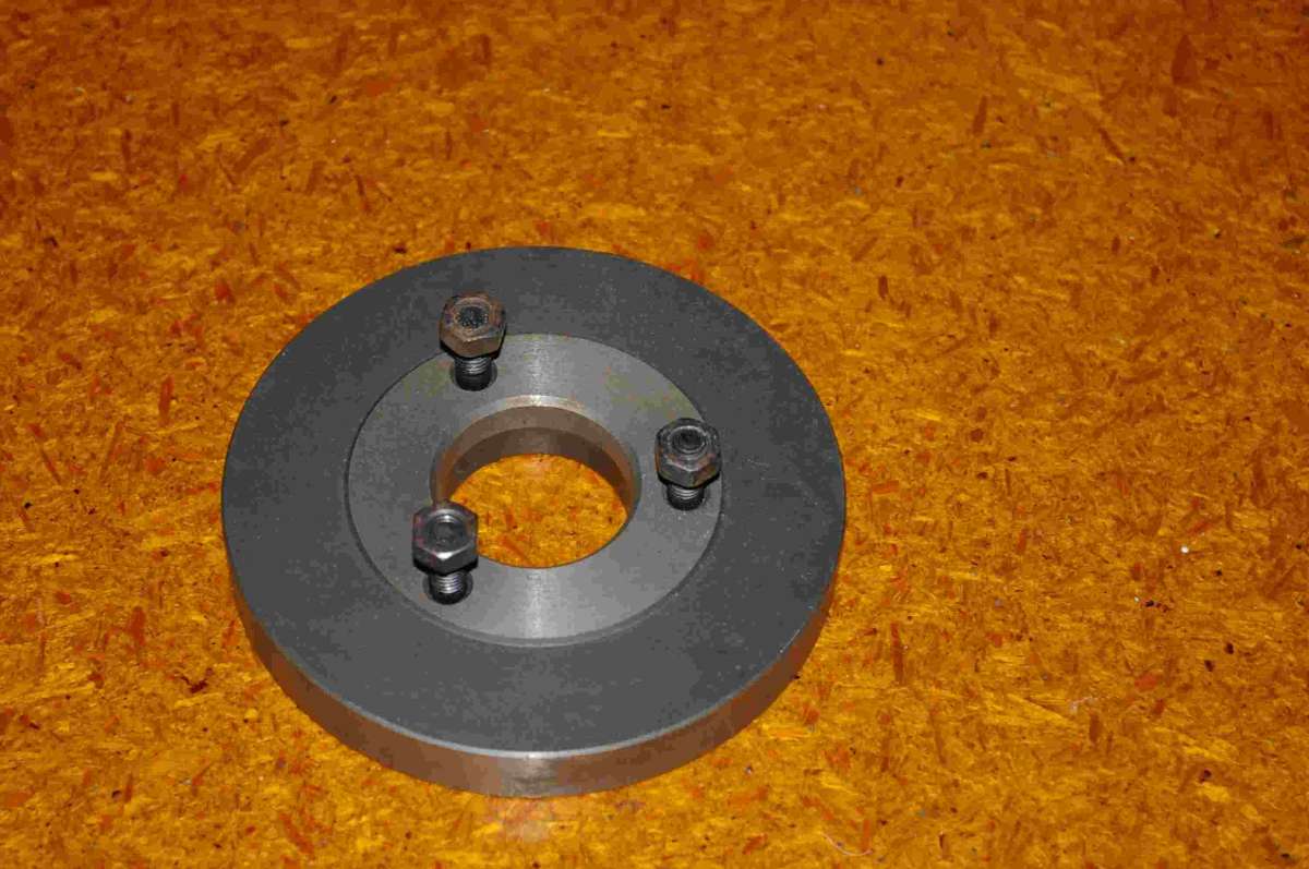

                                Hi,
                                I have a couple of chuck backplates for an Emco V10P lathe (see picture). I don’t have the lathe any more. The OD of the machined face is about 80mm and the ID of the hole is about 45mm. I’m not sure if they will fit a V13. If so let me know. I’m in Auckland.
                                Regards,
                                Alan C.EmcoBackPlate

                                Kiwi Bloke
                                  @kiwibloke62605
                                  Thanks everyone for your reassuring comments: it looks like I’m overthinking things, as usual… I guess it’ll be steel and anti-sieze goo – and crossed fingers.
                                  Alan   Thank you for the thought. Unfortunately, the spindle and chuck sizes for the V13 are quite a bit bigger than the V10P’s. Try your luck on Trade Me? However, things don’t seem to be moving, these days…
