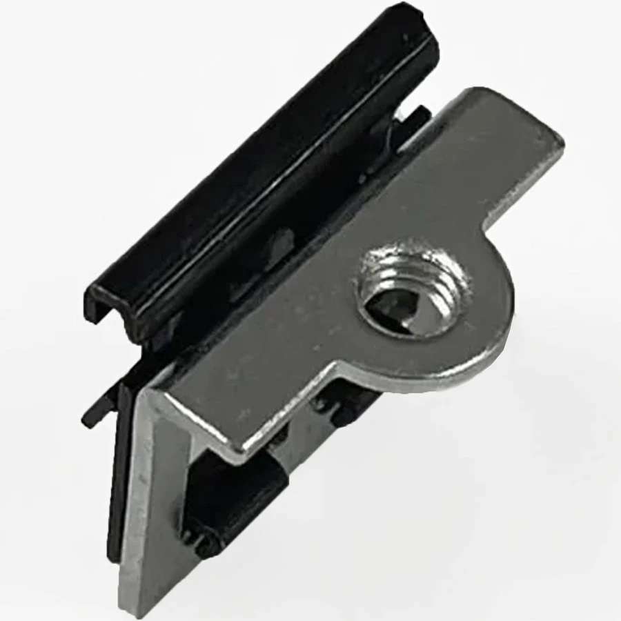

        What sort of female thread arrangement is inside the back box? Those thin bendy metal tabs or a brass insert inside the plastic moulding?
        Assuming it’s the first, and you’ve got a supply of replacement M3.5 screws of the right length, you can use what’s called a back box saver. It’s a T nut basically.
        For mangled examples of the second type, some trickery with JB Weld will be necessary, unless someone has got a better solution.

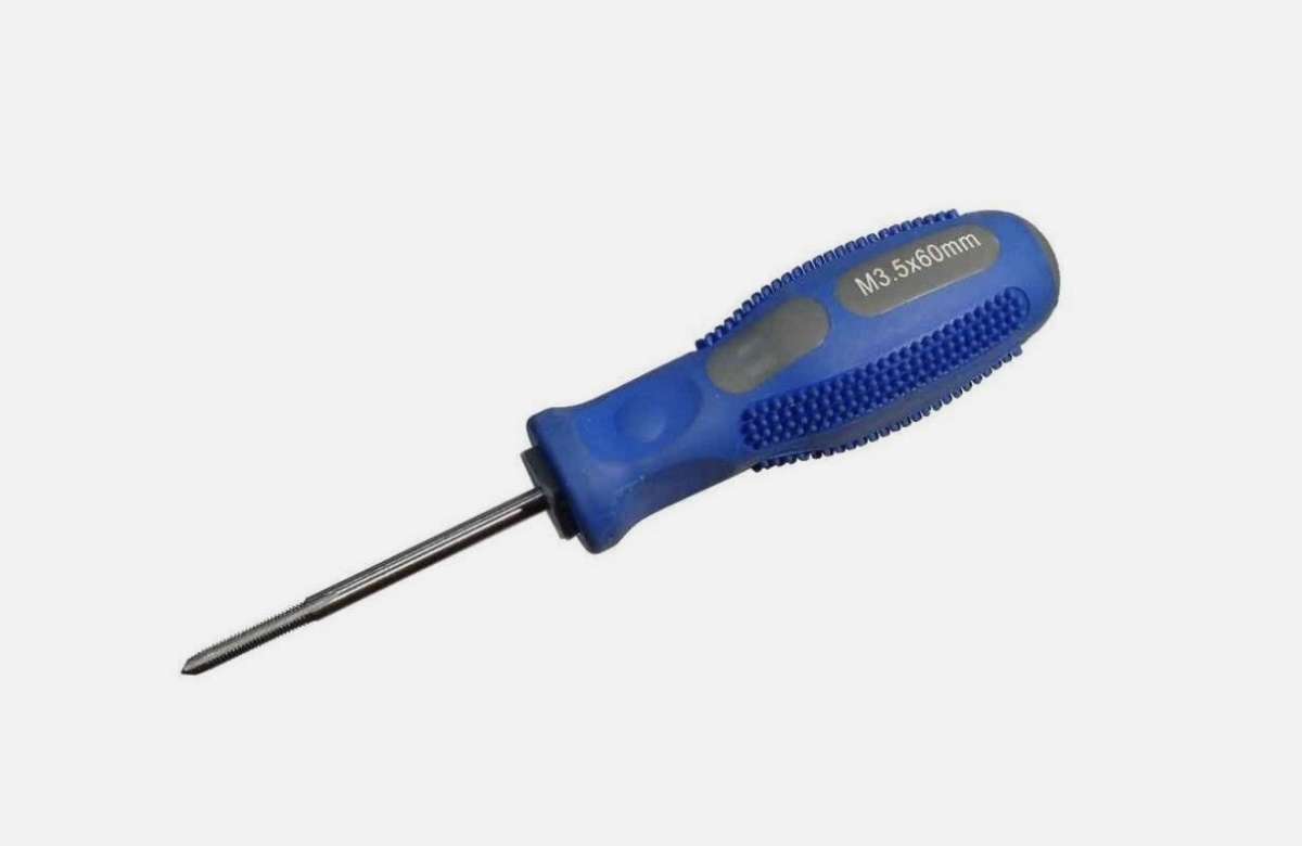

                        Mangled backbox threads are a daily occurrence for sparkies. If they’re undersize then it’s not hard to fix. One of these should sort you out:
                        https://www.screwfix.com/p/c-k-re-threading-tool-m3-5-x-0-6mm/59312

                                You can buy M3.5 taps with a screwdriver handle at Electrical Suppliers, I have one. Handy to have in my electrics box. I suspect most electricians have one?
                                IMG_3281
                                #863352

                                      There are various types of back box repair clips available. Use pliers to make the lug flush with the side and push the repair clip in place.
                                      Short video of repair
                                      clip
