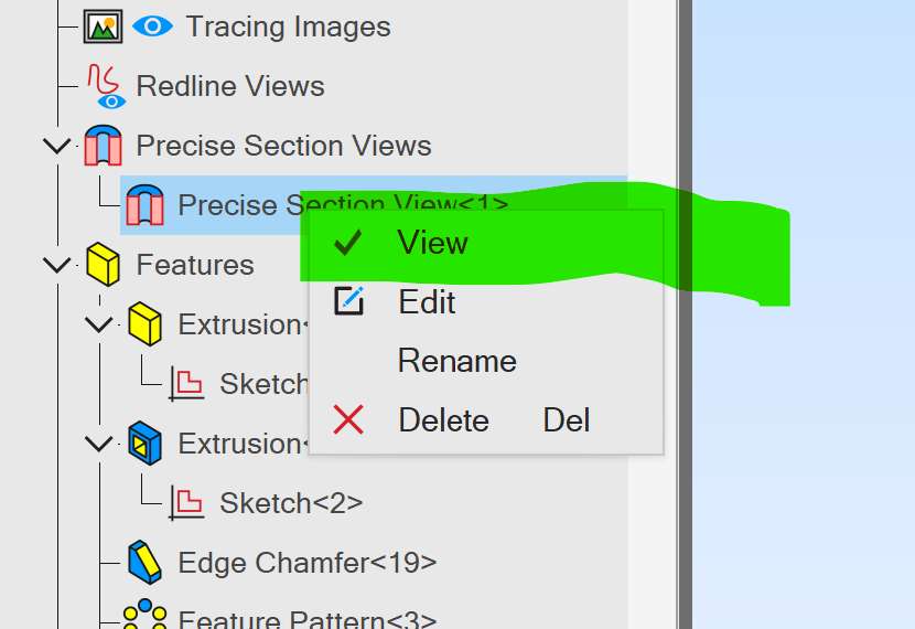

      I modelled a part then cut it using that “Precise Section” Tool.
      Only now, I want to bring it back to to full width. Not in the same session when the reverse arrow might work, but much later.
      I want to revert a copy to keep the sectioned view.
      Only….
      How, please?
      Is it even possible? Or has the sectioning deleted the material rather than simply made it transparent?
      I’ve searched the manual but that doesn’t seem to mention any such facility.

        Screenshot 2026-09-02 222340
        If I have understood your question correctly.  Right click on “Precise section View<1>” and left click on “View” to turn the section on/off as required.
        #863376
          As Paul says you just untick “View”
          It is possible to have several section sof a single part or an assembly and you can click between all of them and a solid part.

            Yes, you had understood what I asked. Found it and rebuilt the part. I’d been afraid sectioning the object actually deletes half of it.
