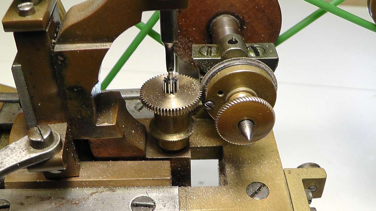

                  Rounding up tool, you can finish the already cut wheel to mesh correctly with the pinion it drives, still useful for restoration work. This size has cutters to around m=0.35mm, their must also be for larger size wheels but you see them very rarely. S3320001
