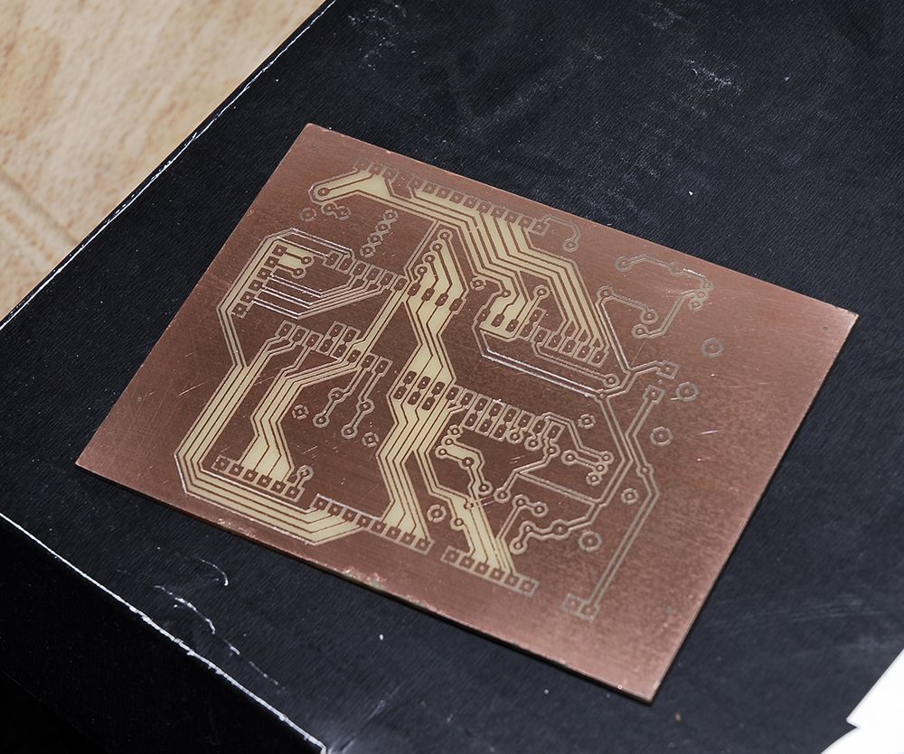

      Yesterday had a go at etching a PCB for a rotary encoder to attach to my Vertex rotary table.
      It didn't come out as I would have liked so I'll be making a second batch of one more. The board seems to have etched more in some places, severing a couple of traces and not enough etching elsewhere leaving a few copper remnants in between traces.

              Ed, do your pcb tracks really nee to be that narrow? If you over etch they will always get a bit narrower. I use a Mungolux photopolymer film resist and about three seconds exposure to the sun (no UV lightbox) with an inkjet printed master and get good results.
                You have to be meticulously careful with cleaning / degreasing the bare board. Looks more like contamination than overetching. Was the board good and clean / unmarked beforehand?

                  I use an aquarium pump to agitate my etching bath, I get more even etching that way.

                    I agree with making those thin tracks wider, even where they pass between pins. It looks crisp so I assume it's a photo-etch, if so you can go incredibly thin for tracks or gaps – but only do so where you need to.
                    Neil.
                    Edit – one other thing that can result in broken thin tracks – the positive film not being fully in contact. I always put a big weight on the back of the PCB during exposure (when I remember!)

                        I think on reflection the broken track problem was possibly due to not expelling all air between the photo resist film and the board plus a bit of over etching. Cleaning of the board was with Scotch-brite, airbrush cleaner, then 99% IPA. I'll need to get a laminator if I do any future pcb's I think. I will also be making the traces wider in CorelDraw for a second attempt.
                        The board was sandwiched in a picture frame with a glass front and exposed to a weak sun (kind of overcast) for about 30 seconds and I suppose not ideal as a controlled environment. I saw a video on YouTube where a guy in India exposes this type of film to the sun for 7 minutes!!

                        Ian SC, I think I have an old Whisper 500 fish tank pump hiding somewhere.

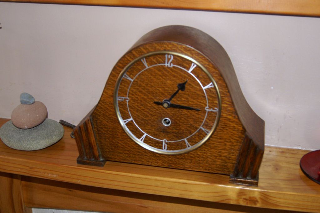

                                                  Yesterday I got an old 8 day mantle clock going. I've had it in the cupboard for 20 years or more and finally gotaroundtuit.
                                                  It needed a new pendulum suspension which I made from a 10 thou" feeler blade.
                                                  New brass hands are in the post (£1.89, can't be bad)

                                                      John Carruthers I personally would only use 4 thou on a mantle clock 8 thou on a long case I have just measured six different commercial suspensions they varied between 3 thou and 5 thou But if 10 thou works for you fair enough
                                                      Roy
