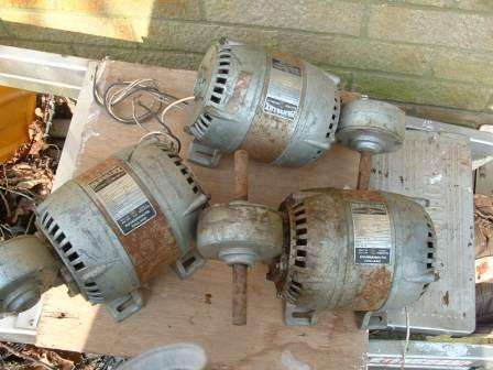

      How do I work out the size of VFD for a 0.12kw motor.

        A 1/4 Hp unit will work. Do I take it that the motor spec plate says the motor is .12 Kw ? Or is it 1.2Kw ?Noel.

          Yes . Definitely 0.12kw. I need to get the rpm down to about 12pm. I intend using a reduction gearbox in parallel . Single phase.

            120 W is nothing. As Noel says a 1/4 hp rated unit should be fine, probably the smallest you can get. I assume the motor is 3 phase?

                  The post at 09:58 on 7/8/26 seems to say that the motor is single phase. If this is so then it probably has a capacitor for starting. This means that  the  phase shift it (The capacitor) produces at a lower frequency will be diferent at the  lower frequency so the motor may not be able to start. Can you post some more details of the motor including it’s speed at normal mains frequency. What do you mean by ” I intend using a reduction gearbox in parallel ” ?

                    Oh yes! Single phase. Won’t work with standard VFD.

                      If you are happy with a continuos fixed 12rpm or similar perhaps look for FHP (fractional horsepower) motor with gearbox attached such as Parvalux, 230vAC Cap start/run reversible.
