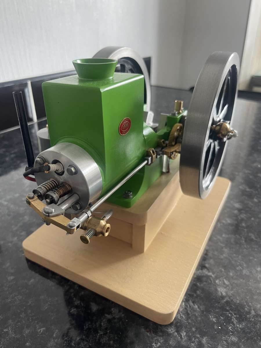

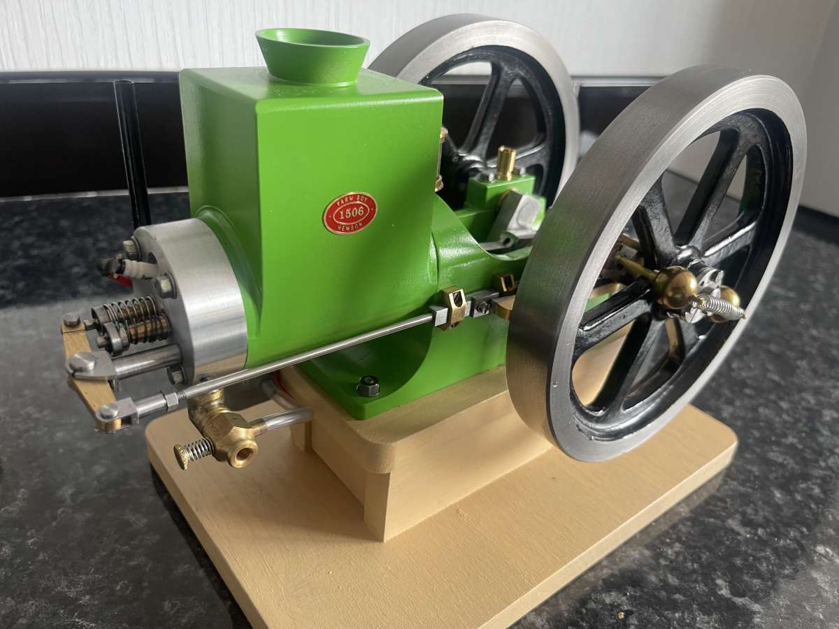

          Couple of pics of my finished Farm Boy.
          IMG_0625IMG_0628

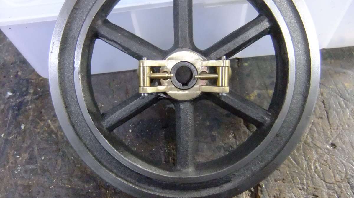

              Managed to get the Fly wheel locking collars completed and could not resist a part dry fit with they in place.
              Fly wheel part assembly (1)Fly wheel part assembly (3)

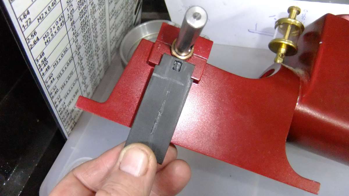

              I have been putting off cutting a test tube to complete the oiler for the engine. So I tried to use a glass tube cutter which failed, and it shattered, so a good clean up and vacuum got rid of the broken bits. Next I wrapped the tube in some masking tape (I have about ten tubes as that was the minimum I could get at the time) this was gently gripped in the lathe yet strong enough not to slip, a Dremel was used with a small diamond disk and a short section soon parted ways from the tube. This section was rubbed on some very fine wet and dry paper to get rid of any sharp edges (With the tablets I am on if a cut myself it takes forever to stop)
              As most of the parts were already made from brass, the only other part was the control needle, which is from silver steel (tool steel depends on where you are in the world). This needed a point on one end and then cut to length and fixed into the top adjustment piece.
              The complete oiler ready for the engine once completed as there are still bits that need making. Without measuring it I would say between 1 1/4″ to 1 1/2″ tall.
              complete oiler (5)
              complete oiler (4)
              A question about the oiler if you make your own what do you use to seal the glass tube to prevent oil leaks

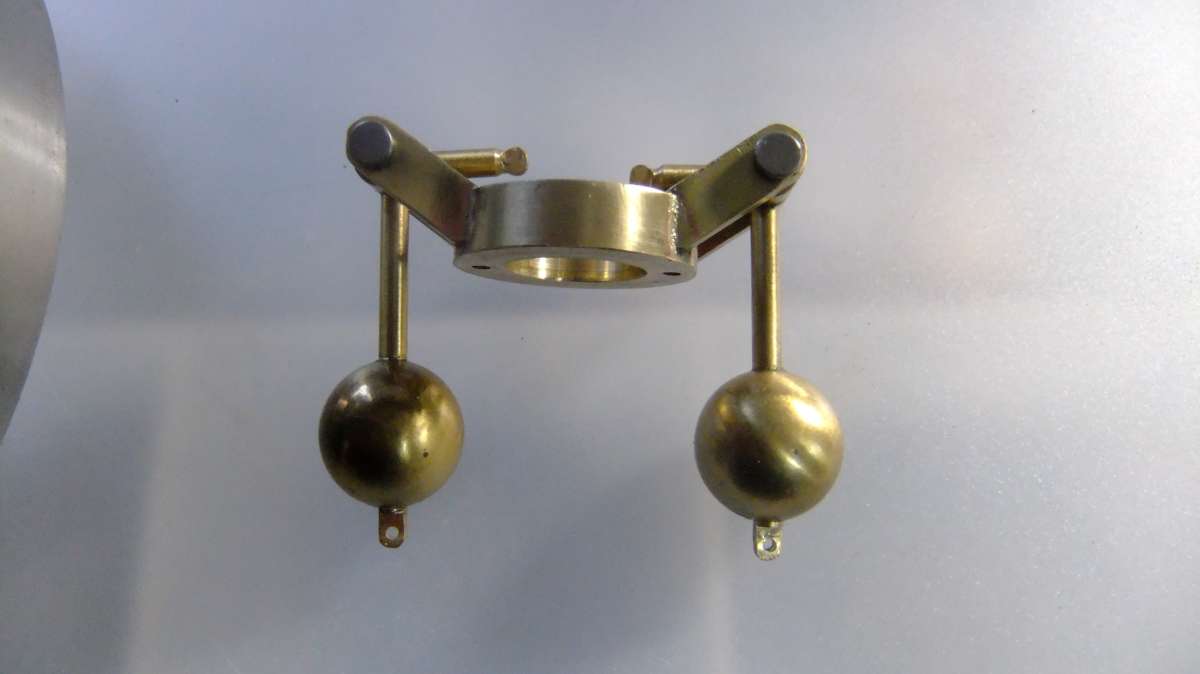

                      #758011
                      Dalboy
                        @dalboy

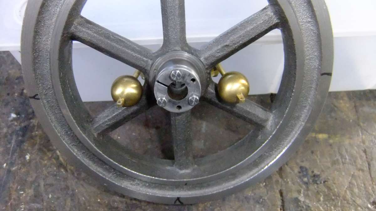

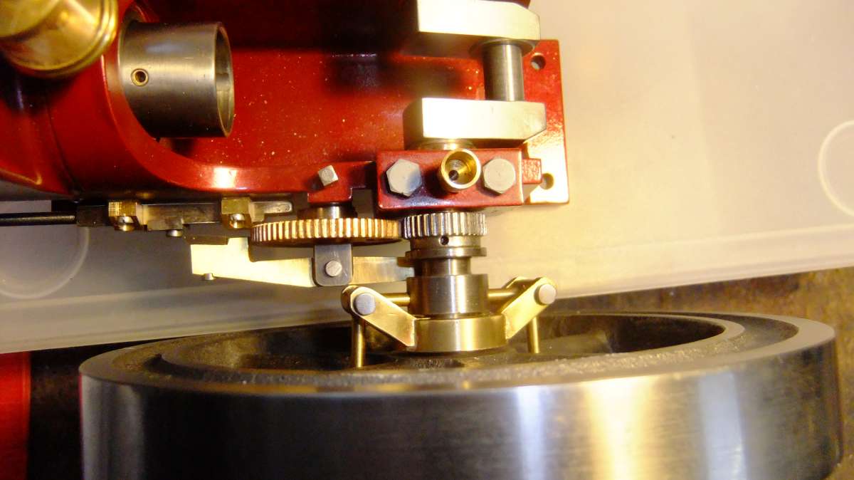

                        After two failed attempts at the governor assembly, I manage to silver solder the two arms on and now happy with the outcome.
                        Now onto some other small parts and a base for it to sit on so that I can attach the flywheels.
                        Gov assembly
                        Gov assembly. 3Gov assembly. 4Gov assembly. 5
                        #758528
                        Dalboy
                          @dalboy
                          After making some pins I am able to do a test fit of the governor assembly hopefully this makes a little sense where thing go
                          gov assembled (1)gov assembled (8)

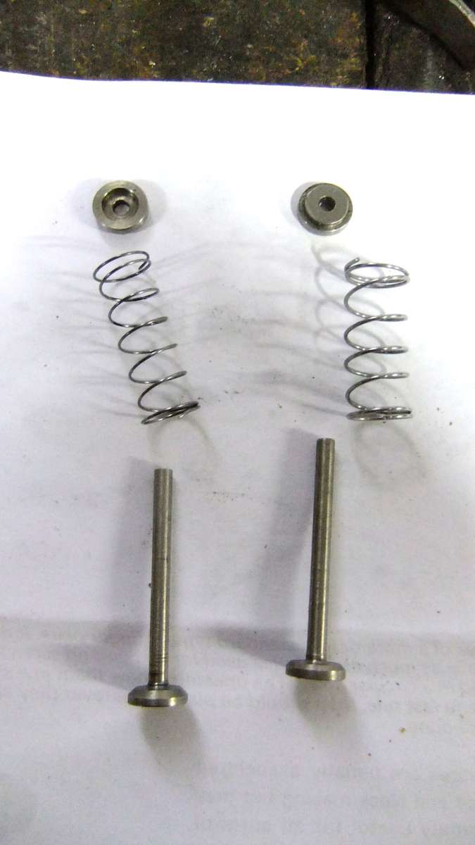

                                Now that I have the tool which I showed in another thread, I have managed to get into the workshop with orders from the wife just to give me a break from my other duties.

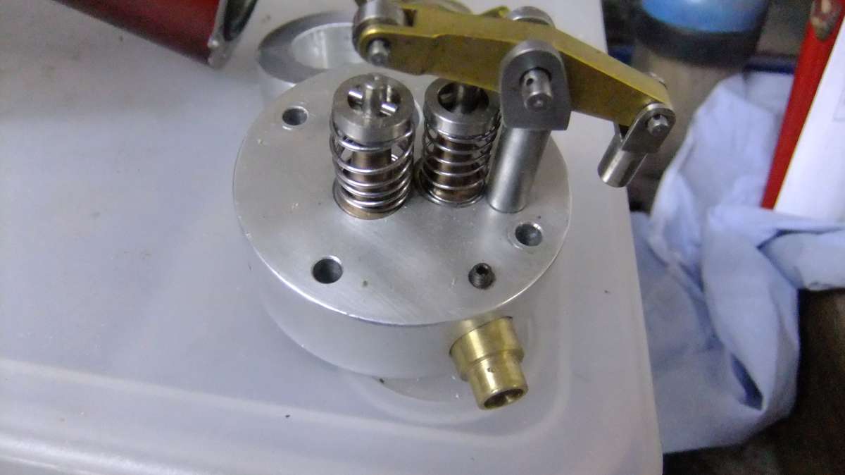

                                The tool I speak of is the spring winder I now have the valve springs made for the engine. I may remake the valves again as I am not happy with them.
                                Anyway, picture of the valves, springs and caps. This is the first attempt at making springs
                                Valves and springs

                                      Just a few photos and what I am halfway through on the engine.
                                      First a picture of the spring I made in position on the head.
                                      head complete with home made springs

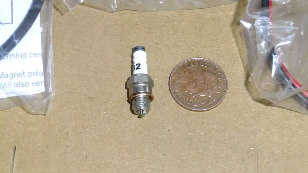

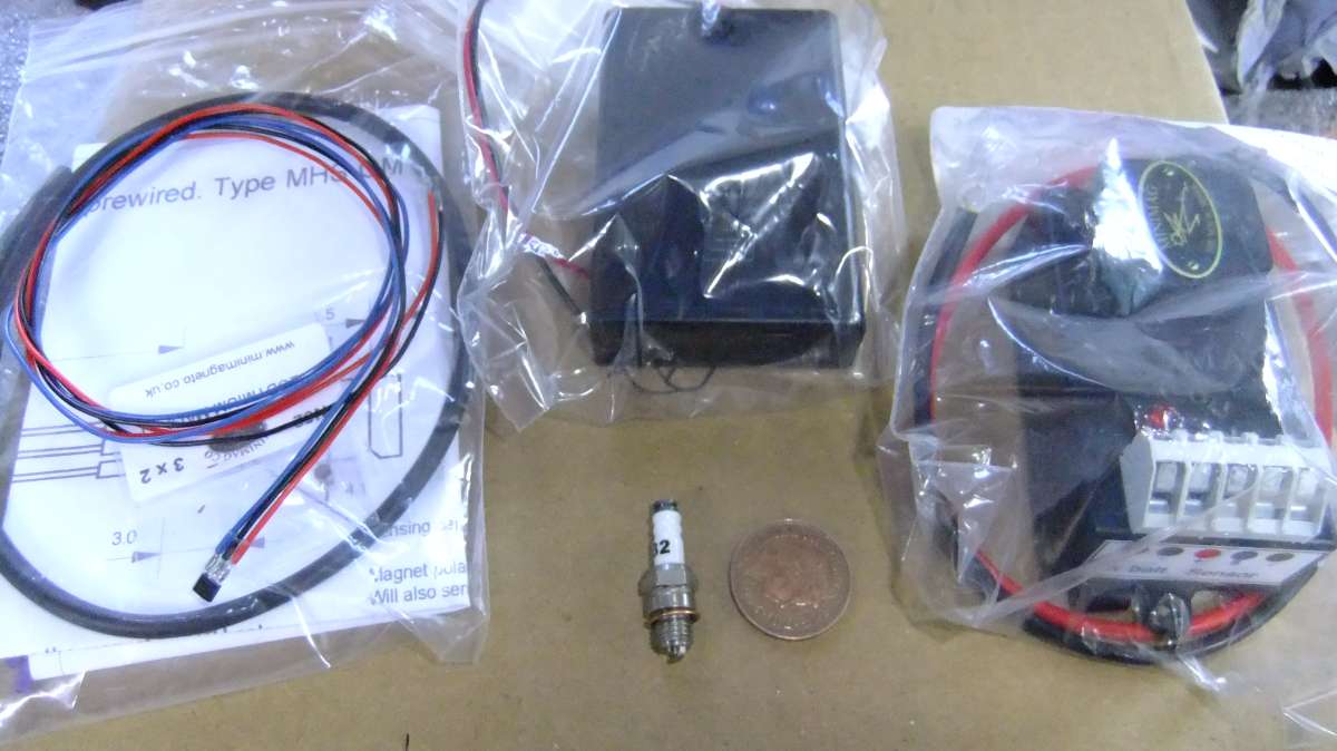

                                      And all the ignition bits and bobs as well as the spark plug, a 1p piece for scale.
                                      ignition wiring an spark plug (1)ignition wiring an spark plug (3)

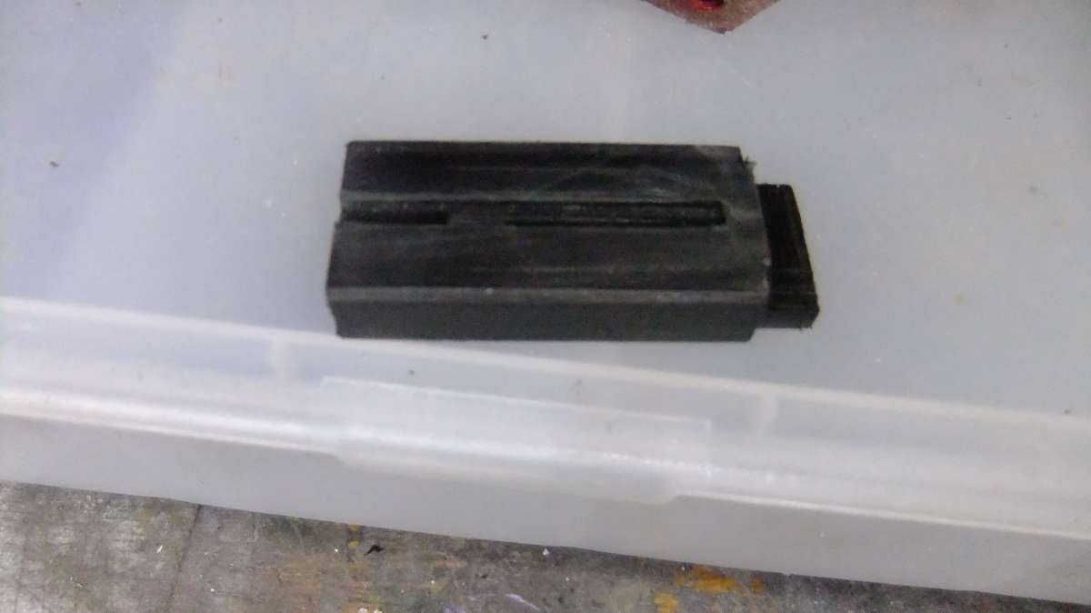

                                      And finally, a part machined plastic piece to hold the wiring and sensor. A magnet will be in a part attached to one of the flywheels, which I have yet to make.
                                      wiring harness instulation (2)
                                      wiring harness instulation (1)
                                      Still needs some machining, but this shows where it will fit

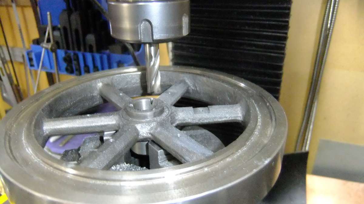

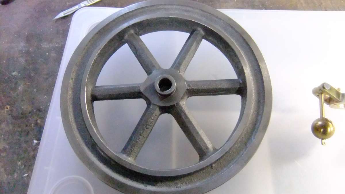

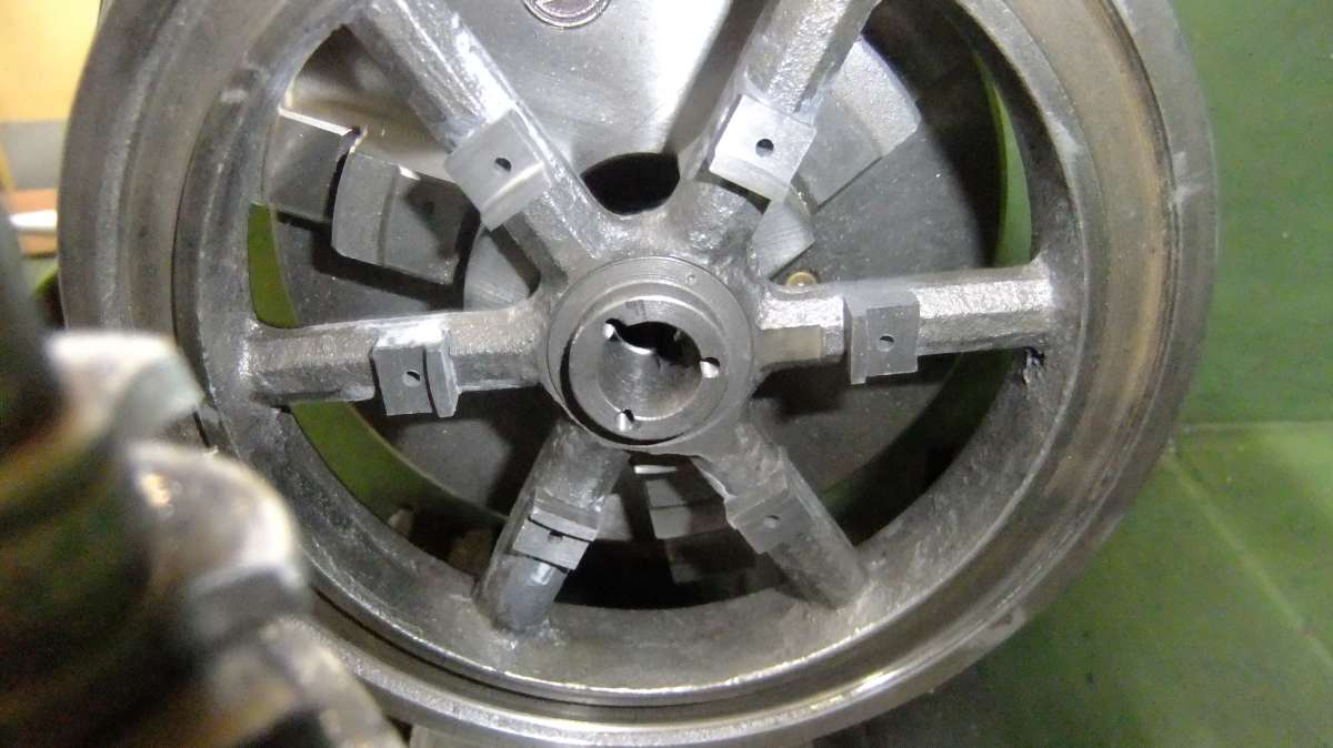

                                        Been machining the fly wheels today first was the governor flywheel drilling and tapping the holes for the governor weights and machining the groove on the inside.
                                        Onto the second flywheel again, milling a groove on this one also. This was followed by drilling a hole in each spoke to hold the pulley that fits on the side. While it was set up, I milled the seat for some small blocks which the pulley will eventually fit onto. These are attached with some JB weld now, waiting until tomorrow before drilling for a bolt to secure them so that I can turn a curve on them
                                        fly wheel machining for pulley (2)
                                        Machining the flats for the mounting blocks
                                        fly wheel machining for pulley (3)

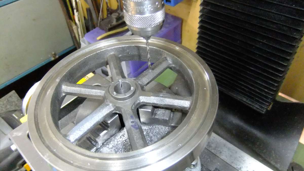

                                        #800120
                                        Dalboy
                                          @dalboy

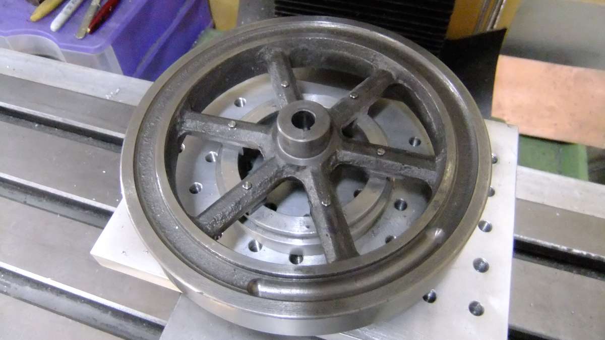

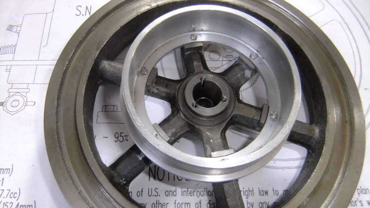

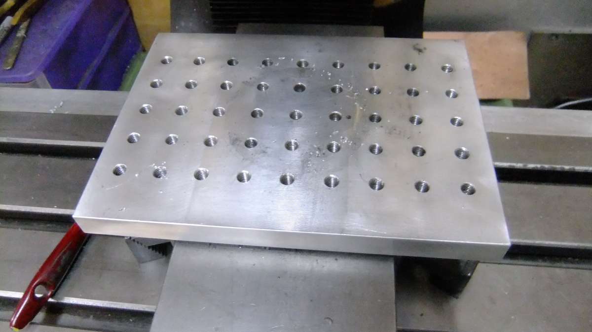

                                          Final work on the last flywheel before painting.
                                          After leaving for a good 24hrs for the JB Weld to set and securing with bolts from the back the step to align the pulley was machined. (I forgot to photograph, so this is just mocked up)
                                          flywheel pulley final drilling (4)
                                          Locked the flywheel down onto the pulley removed the original bolts and drilled a clearance hole right through and fitted the bolts to secure the pulley.
                                          flywheel pulley final drilling (2)
                                          Turned over with the bolts the right side still need to secure them as waiting for some nuts to arrive
                                          flywheel pulley final drilling (6)
                                          As can be seen this was made easier by the use of the platter I made, well worth the effort making it
                                          flywheel pulley final drilling (7)
                                          Next job they need painting

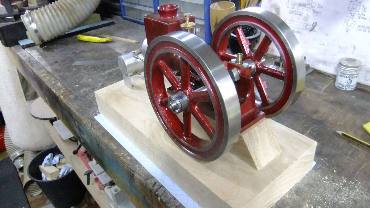

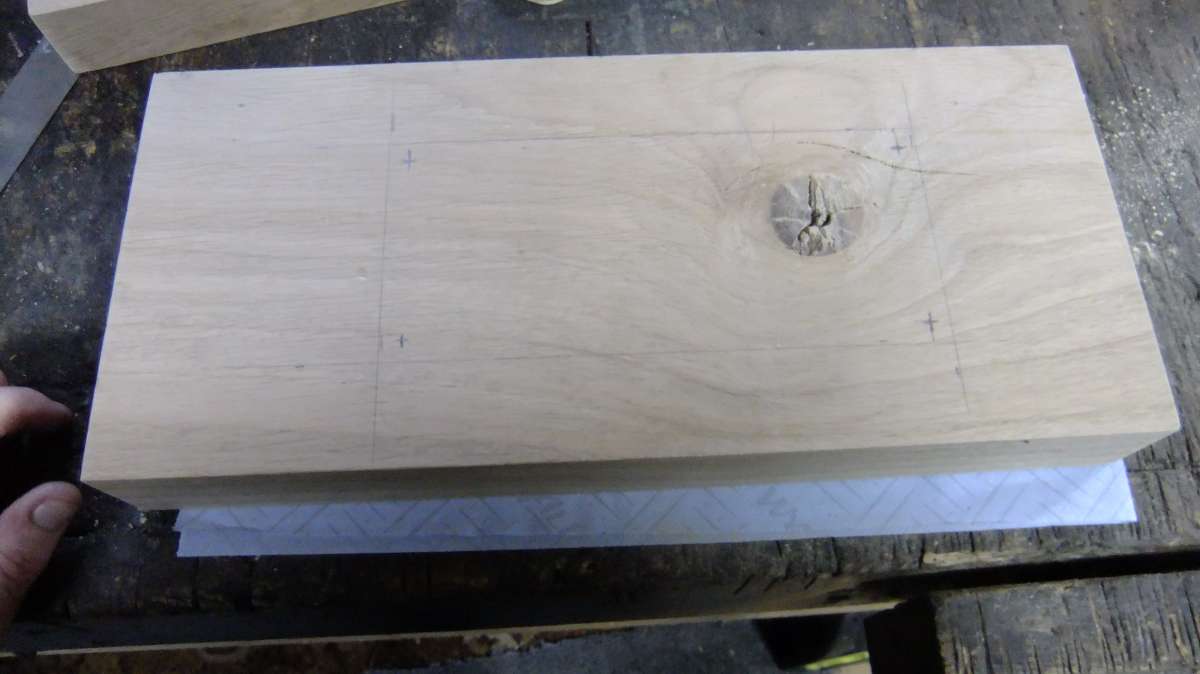

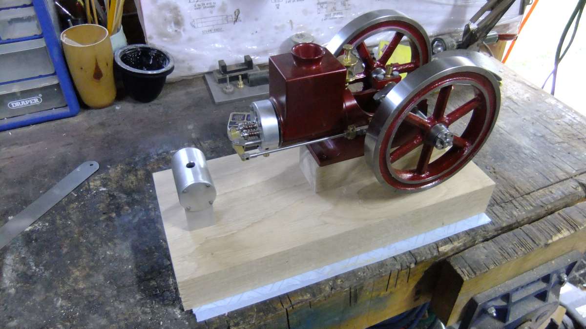

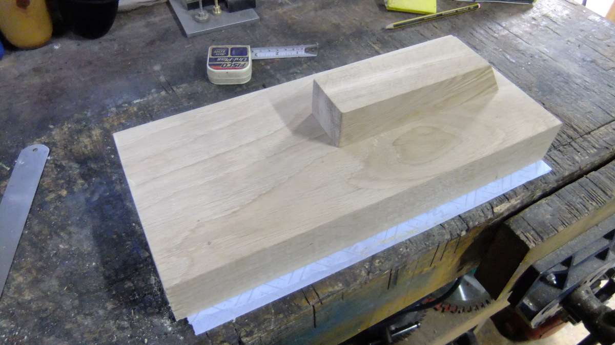

                                            Made a start on the base unit for the engine today, put both pieces through the thicknesser and the large base over the surface planer, bringing both to size and square.
                                            base started (4)
                                            Marked out the bottom for some hollowing out where the electronics will sit out of sight. Not worried about the knot as most of that will be removed from the bottom and the small amount that is on the top will be hidden under the other piece.
                                            base started (5)

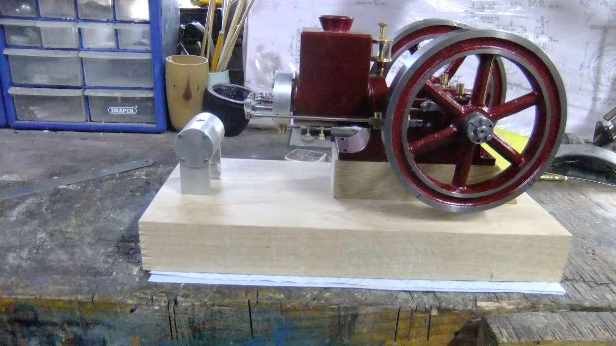

                                            Test with the engine in place to see how it will look, I will chamfer all the main base edges top and bottom to give the appearance of a thinner base.
                                            base started (3)
                                            base started (2)
                                            base started (1)

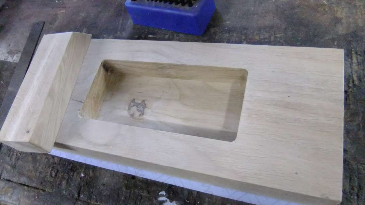

                                                  Today I hollowed the base for the electronics also took the engine apart so I could reach the securing holes which will be the next job.
                                                  base hollowed out for electronics
                                                  I took the bulk out with a forstner bit and wood router leaving a very small margin which I took out on the mill, this meant all the shavings stayed in the hollowed out portion as long as I stopped and vacuumed out regularly. I had to do it that way as I did not have a router bit which would reach the full depth but did have a 1/2″ milling cutter.
                                                  I still need to drill some holes for the wires to the sensor hopefully keeping them out of sight and one other for the spark plug lead.

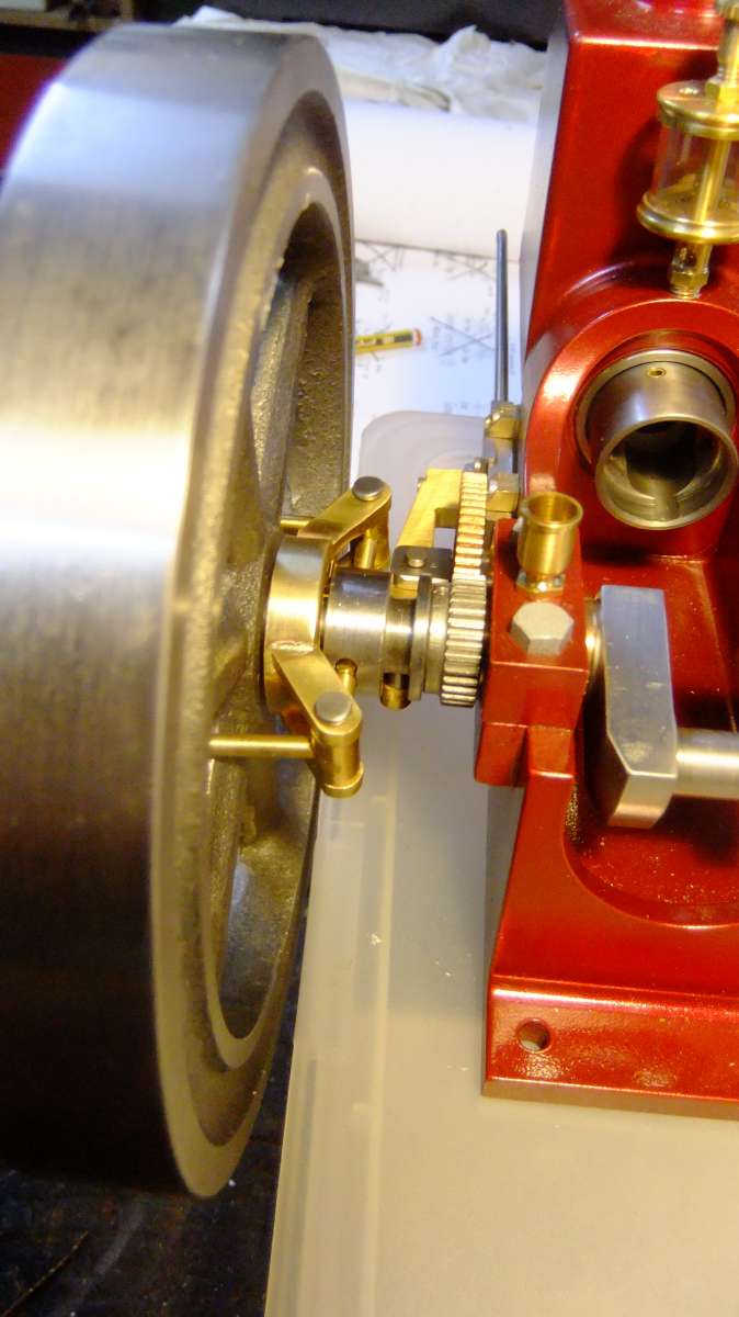

                                                      Not much done due to other commitments, but have now started to reassemble the engine only to find lack of compression. After much investigation, narrowed it down to the exhaust valve. Tried grinding the seat to no avail. On very close inspection found a score on the valve seat so made a complete new exhaust valve this has sorted the problem now have good compression.
                                                      This now has revealed the inlet not opening so need to make a new weaker spring, time will tell when I make this.
                                                      Al this is a learning curve.
                                                      Also need to set the gears and governor weights. Getting very close to completing this little engine, which is a very interesting and enjoyable little engine
