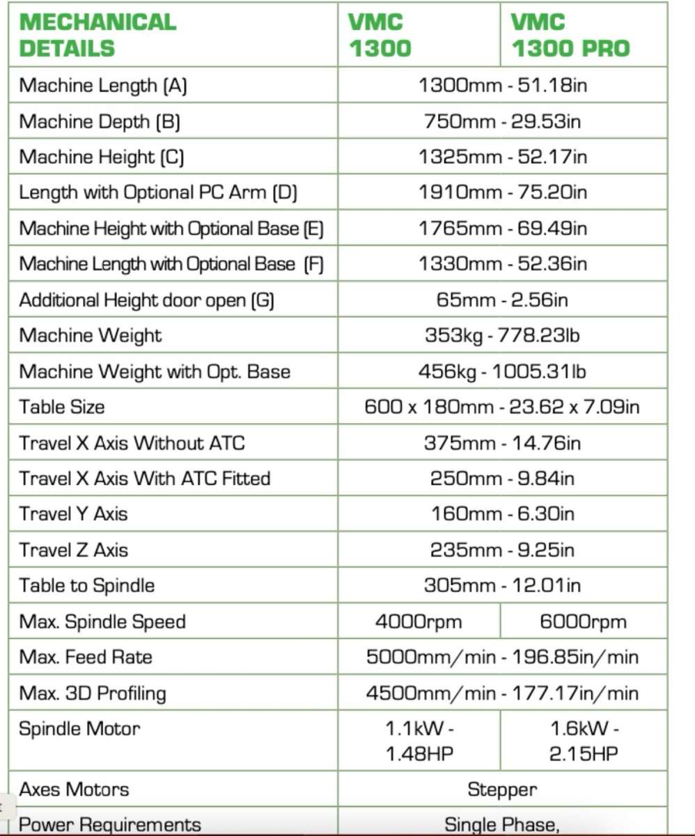

      I am interested in purchasing a second hand Denford VMC 1300 CNC milling machine and would like to hear from anyone who has one regarding the pros and cons of operating this type of machine. My intended use is to manufacture aluminium motorcycle parts for my own hobby (not commercial production) so I am particularly interested in the machine`s capacity and accuracy to machine 6082 or 7075 aluminium together with any potential problems with software issues and spare parts.

        Specs here for the machine. Emgee

          I think the Denford software and controller will be the limiting factor not the spec of the physical machine. Not seen these ones mentioned but others like the Novamill a lot of people convert to Mach3 or 4, linux etc
          A bit more spindle speed than the 4000rpm would be nice for aluminium and to be able to make use of those reasonably fast feed rates but depends if it is just a bit of hobby use or you want to knock out a lot of items as fast as possible.

                    For our intended use the Z axis of 375mm (without ATC) is the key factor and exactly why I am considering the 1300. As far as I can see nothing else come close.
                    #859865
                    John Haine
                      @johnhaine32865
                      Er – 305mm according to the table above?
                      Note that Denford spindles usually have a BT30 (or 40?) taper and normally one fits a chuck in this such as an ERxx adapter.  The Denford kits often supplied an adapter with quick change collet chucks. It’s amazing how much daylight these consume!  So do consider the length of the chuck. It’s even worse with the Novamill which has much less daylight to start with.  I managed to find a set of BT30 finger collets which I can use for jobs that are too high that effectively have zero stick-out. You may also find that it’s better to clamp work direct to the table rather than use a machine vice.
