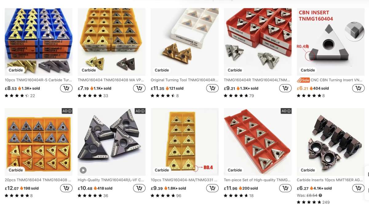

                            @vic
                            I use several types of inserts but I’m a big fan of TNMG’s because you get six cutting tips per insert. My lathe is 8 1/2” X 14” and I’ve not seen a tool holder small enough for my four way so I bought the smallest I could find which was 16mm. The holders are quite hard but using a carbide mill I’ve managed to trim 2mm off the bottom to fit. They work well on my lathe and I’ve even found TNMG’s fit my Little Hogger milling cutter as well. The inserts can be really quite cheap on Amazon, Temu and eBay. At some point I’ll probably get some that don’t work very well on my little lathe, but it hasn’t happened yet.
                            Example.
                            IMG_2809
