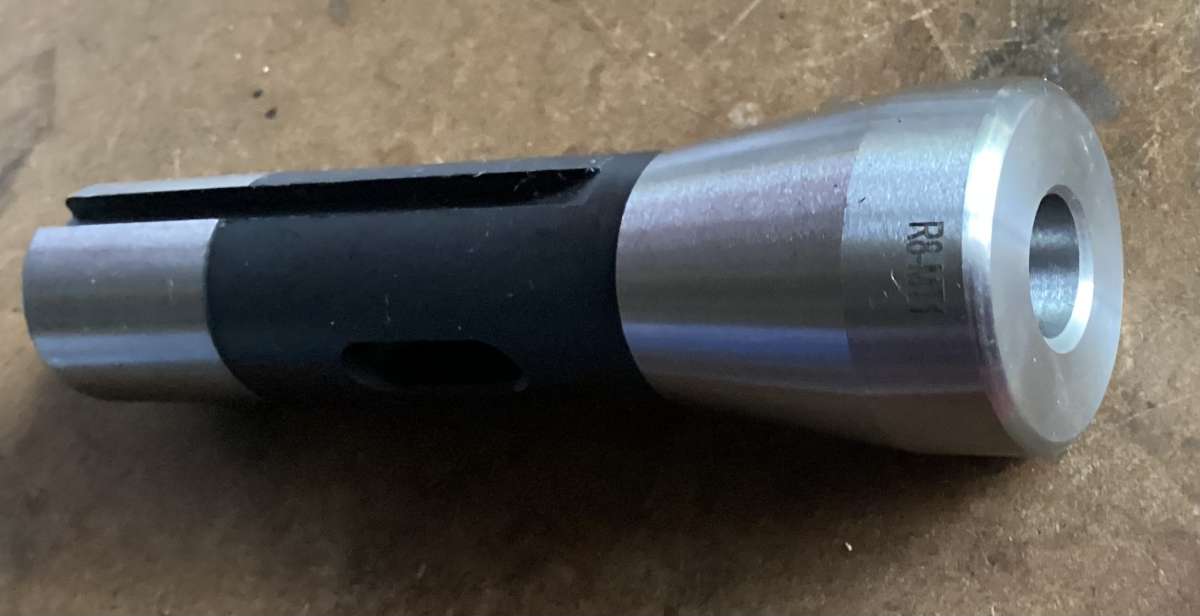

      I recently bought off Amazon an R8-MT1 adaptor to enable me to use my increasing stock of taper shank drills in my milling machine.
      Unfortunately, unlike an R8-MT2 adaptor I have that I bought from a UK-based supplier before they ceased trading, which had only a few microns of runout up the taper, this MT1 adaptor has about 0.1mm runout up the taper and is never going to let me do good drilling with it.
      Question is, how feasible is it to re-bore the internal MT1 taper in a way that improves concentricity? I can hold the top section of the adaptor in a 3- or 4-jaw chuck but what would I indicate off to keep the 7/16-20 threaded section held in the chuck jaws as perfectly in line as possible with the bore I want to create anew? The black central section of the adaptor isn’t straight-sided but has a very slight and uneven taper on it, and the male taper doesn’t look like a very good reference surface either, especially as it may be contributing to the overall eccentricity of drills placed in the adaptor, which typically show considerably more than the 0.1mm runout measured in the bore.
      As an alternative I could make it into a side-lock holder for end mills, but there isn’t really anywhere suitable to drill for a set screw as, unlike on dedicated end-mill holders, there is very little in the way of a straight-sided section down below the male taper.
      After receiving a partial refund, the adaptor cost me less than £5, so whatever I do with it it won’t be a great loss.

              Your reference is the external taper of the R8 shank.
              The options are either :-
              1) get that running true in the lathe and correct the MT taper by boring
              2) make some sort of MT1 shank accurately drilled for a centre in the end so it can be supported in the tailstock then trim the R8 taper so tit runs true to the internal bore. May need to add some clearance at the parallel end to ensure it fits in the spindle.
              Classic can be done but life is too short jobs.

                FWIW, I would set the adaptor in the 4 jaw and clock the 1MT taper until running true, and then skim the R8 taper, as little as possible to clesan it up. (With tapers, a little goes a long way!)
                Since the taper is likely to be hardened, you will need to use a carbide tipped tool.
                Boring or reaming the 1MT taper with the R8 taper clocked to run true is likely to be more difficult.

                      Is the Adaptor Hard? If so boring a 1MT will be near impossible, it would require grinding. Even then this could be fraught with problems. Especially if the MT is “drunk” with regards tot he R8 Taper.
                      It would be far easier to get the R8 Taper to run true to the 1MT, but if it is Hard then this might be a problem. While it would be easy to just clock the front of the 1MT hole and hope for the best. There would be no guarantee the MT was not running out at the small end, (drunk). This would really need a 1MT Test Bar to set-it up properly.
                      Trueing the R8 Taper is something that could be easily done with a Tool Post Grinder.
                      Lastly I do not see in the photograph a Slot to accept a Drift to remove the MT, is there one?

                        UntitledLooks like slot here.

                          Hi Gray, click on Bills photo, and you can just see it in the shadows where Oldiorn has arrowed.

                              Maybe re-purpose it by gluing in a MT stub to make an R8 stub for eg slitting saw.

                                It looks like the consensus is that fixing the problem may not be worth the candle, and that a salutary re-purposing as suggested by Michael or a stub mandrel as suggested by Bazyle may be the most useful thing I can make out of it.
                                In answer to Graham’s query, I don’t think the item is of the “hardened and ground all over” variety because filing off the heavy burr left by whatever had been used to tap the 7/16” thread was very easy and the metal decidedly chewy.
                                I’m still not sure that’s enough to persuade me, for the foreseeable future at any rate, to spend a chunk of  my limited workshop time trying to make a silk purse out of this particular sow’s ear.
                                In the meantime, before I buy a more decent replacement, I’ve discovered an unopened MT1-3/4” straight socket adaptor in a box. Since I also have a 3/4” direct R8 collet, these two should double up for now as a more viable alternative to the sow’s ear for holding MT1 drills in my mill.

                                  Any possibility of mounting it in the mill, inclining the head, and boring it in situ? Not an option if it is hardened of course unless you use a small grinding point. That would ensure concentricity. I have done something similar with a slitting saw arbor.

                                    As you already have a 2MT version, why not use a 2 to 1 reduction sleeve?
                                    These are a fraction of the R8 to MT1 adaptors.

                                      You could make a side lock holder, but for something that does not need the gripping power that a cutting tool would require. The parallel OD of the holder would accommodate a smaller screw.
                                      For example, an edge finder, a coaxial indicator, a spring loaded tapping guide.
                                      A soft plug loctited into the taper and then bored insitu could sidestep any issue with the holder being hardened.

                                          John, something vaguely similar occurred to me. I think it would have to wait until I need to incline the head for a more essential reason. I’m not averse to these sorts of jobs, though, because I think you can learn quite a lot from them.
                                          Graham, I know I have an MT2-1 reducer so I will do as you suggest and see which of the two options achieves the best runout.
                                          I’m fairly confident the thing isn’t hardened, or at least not significantly, mainly because of the price and provenance but also because I’ve machined three other R8 arbors, and none of them was particularly hard.
                                          Putting flats on a flatless ER25 collet chuck did seem tough going, though, with an HSS end mill and so I switched to carbide. In contrast, an MT2 ER32 collet chuck I bought a while ago was very easy to machine with HSS (its flats were 35.3mm from the factory, hence my machining them to 36mm).
                                          DC31K, all good suggestions, thanks, and the soft plug idea would allow re-machining of the bore to start from scratch, which may be my best chance as long as I use the right type of retaining compound.
