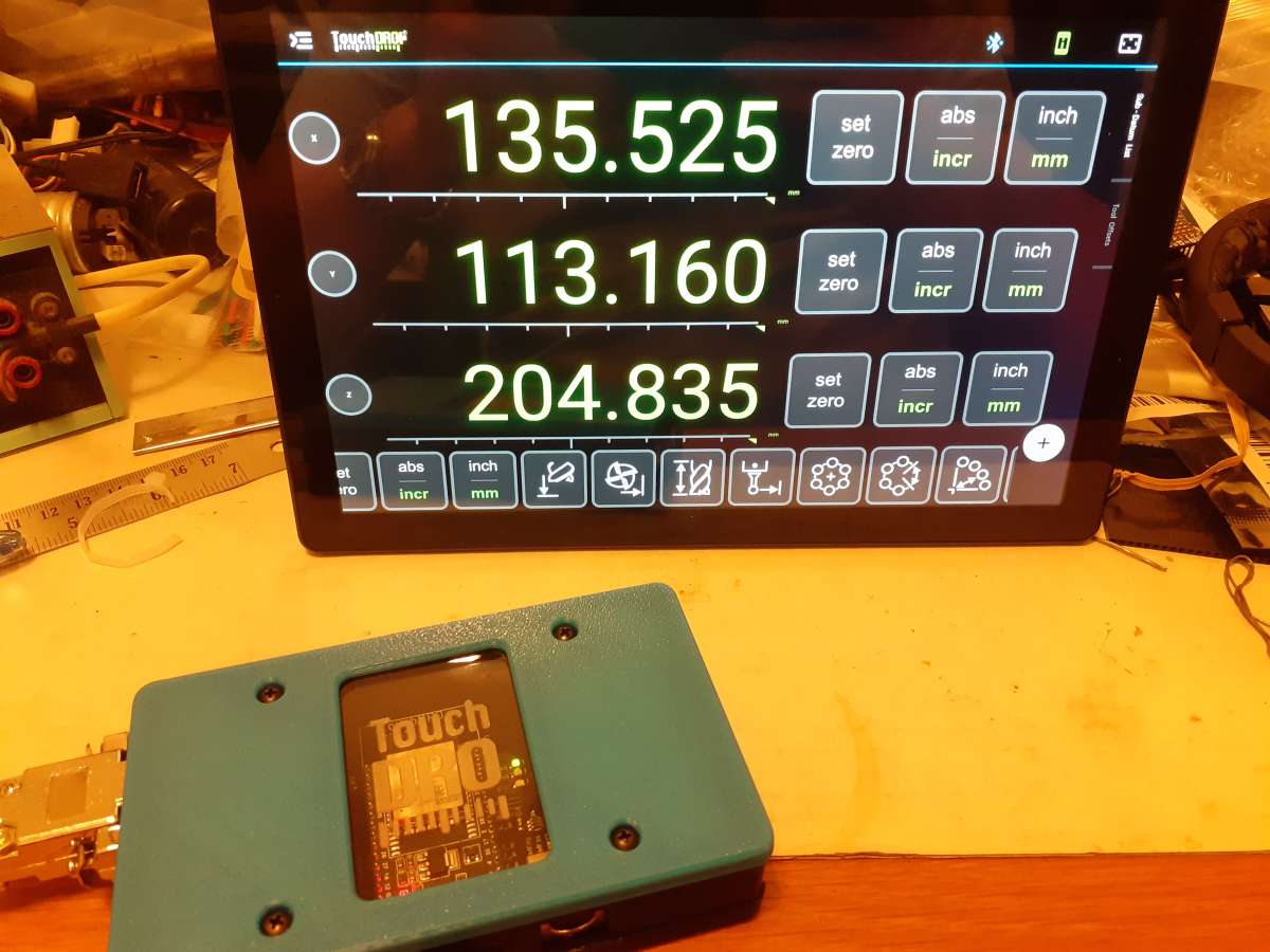

      Took some time off decorating and finished building my new Touch DRO kit this afternoon.
      Very happy with it thus far. As far as I can tell, the “kit” version has most of the features of the pre-built version (although there’s no probes, limit switches or reference track support) but is quite a bit cheaper (and under the UK’s £135 duty-free threshold). It’s a fairly simple build provided you have basic soldering skills and not too time consuming. The finished unit seems robust and everything worked as expected.
      As a simple test this evening, I hooked up one of my new optical scales to each axis in turn and just made sure everything looked OK. I still have to install the scales on the Seig and test/calibrate everything. I will only be using the X/Y axis to begin with but the TouchDRO kit has four inputs and can ‘sum’ the Z & W ones I believe. So my basic DRO requirement is met but I have options for the future if I decide I need them.
      I had an Android tablet but if you do not (and funds are tight) I did download the Touch DRO ‘app’ onto my phone (just to see) and the readout is quite ledgible, although the phone’s touch screen will be more fiddly (at least for my fingers). The whole set-up (TouchDRO + Scales) has cost a bit less then I was originally expecting for a ‘packaged’ DRO and I’ve been able to put the difference towards another item I’ve been wanting for while – a VFD/Motor set for my old Myford S7. The box arrived last week but I’m trying to be good (for a change) and get the DRO fitted first.  My manager is also wanting her decorating finished of course…  🙁

          I’ve found Yuriy’s websites a very useful source of information over the years SC, especially with respect to the various ‘protocols’ used by different scale types and their manufacturers. His TouchDRO site also gives a lot of excellent info on choosing scales and documents the TouchDRO ‘app’ very well too. The ‘kit’ provides everything (I think) I’m going to need from a DRO on my SX3.5 and I also quite liked the idea of the screen/user interface being on a tablet – which can be upgraded and/or replaced if required.
          I ordered two (X & Y) 5 micron optical scales from Aikron (another Chinese manufacturer mentioned by Yuriy) and as there was no cost difference, specified the RS422 outputs. Yuriy mentions that these are only really required for longer cable lengths but also does say that they can be useful when large brushless motors are being used. There was no difference in price for this option. They cost £141 (inc delivery). There was an issue with a ‘wrong’ part being delivered that was dealt with (replaced at no cost) very promptly by Aikron (within 10 minutes of my emailing them) and I’d have no hesitation in recommending them.
          So the total cost of this 2-axis DRO set-up has been in the order of £270 (inc shipping) and I’m thus far very happy with my choices. Just have to figure out now the best way to mount the scales and my happiness will be complete!
          If you don’t already have a ‘generic’ Android tablet, that will add to the cost but mine was about £80 (I think) and they still seem to be around that price at the moment. You don’t need a high spec one to run the TD app and the tablet can also have other workshop uses of course.
