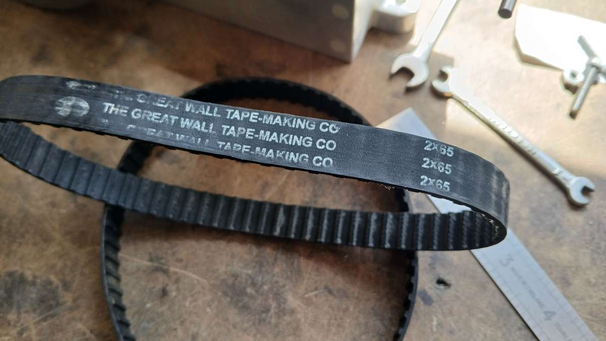

      I would appreciate it if anyone can tell me the belt no. and a supplier of a decent quality belt for a Sieg X3 Mill.
      A friends mill is eating belts at frightening rate. There is a just discernable no. on one of the existing belts which is 2×65. The 65 is the no. of teeth – fine! The 2 doesn’t seem to equate to anything.
      As far as I can tell from a rather chewed up belt it’s 65 teeth x 1/4″ pitch x 9/16″ wide. But no supplier i have contacted have one listed, even Google failed to find any thing like it.

        The 2 indicates the pitch as a multiple of pi so 2 x 3.142 = 6.284mm pitch
        Mine tend to last 5-6 years so I would be looking for what is shreding the belts including expecting the machine to take too heavy a cut.
        Plenty on the likes of Aliexpress just serch for something like “2×65 toothed belt X3 Mill” Great Wall in the link are the same brand ARC and SIEG used to supply

            No it is listed wrongly, these are spares I got from ARC while they still had them, pitch is definately 6.28mm which a lot of people mistake for 1/4″

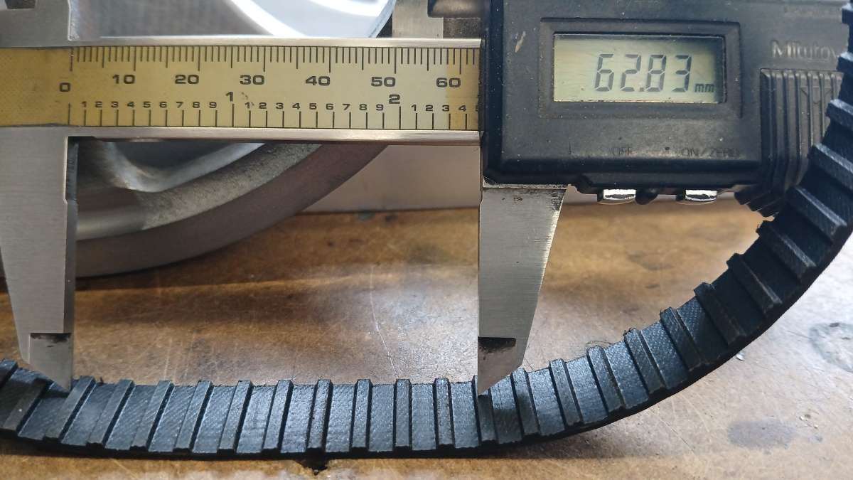

              From an old post of mine, after 6 years use
              #859512
                10 teeth at 62.84 shows no stretch

                  I don’t think toothed belts stretch, they give up by losing teeth or fraying
