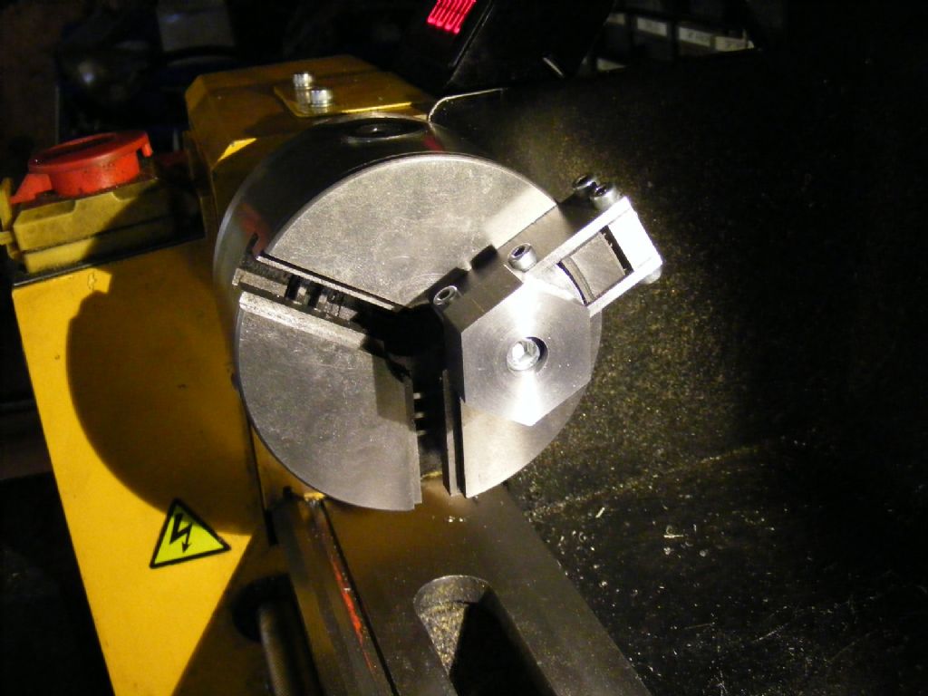

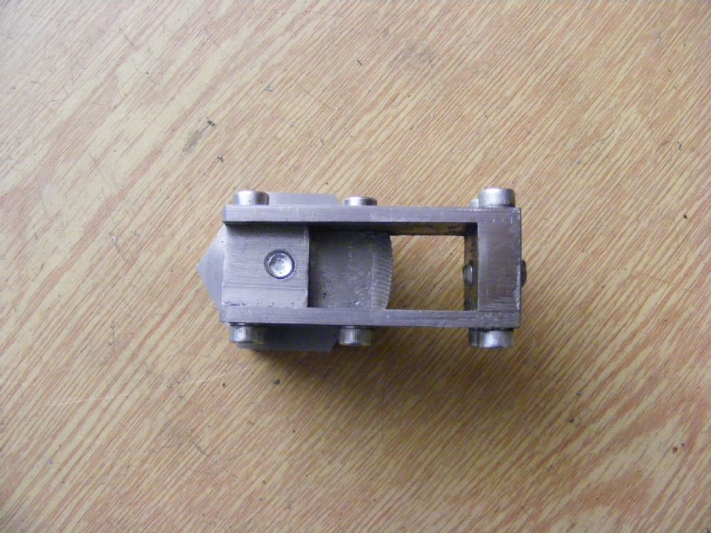

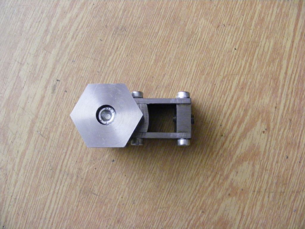

                          I have read Harold Hall's articles on his website about soft jaws and their uses. They seem to be very useful for some types of work holding. My mini-lathe only has a cheap 100 mm imported chuck and there are no soft jaws available for it..
                          I have an idea that enables soft jaws to be clamped onto the outside jaws of the chuck.soft jaw attached to the chuck.jpg
                          The photo shows the soft jaw on the chuck.
                          This shows the soft jaw removed from the chuck. Note the M6 grubscrew on the right hand side. This is used to clamp the jaw onto the outside jaw.
                          The soft jaw clamps onto the outside jaw as shown above.
                          soft jaw underside.jpgThis shows the underside. The milled step clamps against the first step of the outside jaw.
                          So far I have only made one prototype jaw to test the concept and it seems to hold well. I have ordered material to make a full set of 3 jaws.
                          Is this a new idea? Does anyone have any comments? Can anyone see any pitfalls?
                          Mike
                          #197673
                          David Clark 13
                            @davidclark13
                            As the hexagon is above the jaw leverage might be a problem. Probably ok on light cuts.

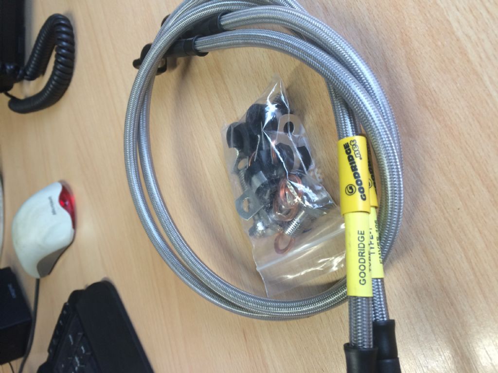

                                  I will be fitting these to my motorbike later.
                                  When working on brakes is it just me that somehow ALWAYS gets the taste of brake fluid into their mouth no matter how careful they are. laugh
                                  Nick

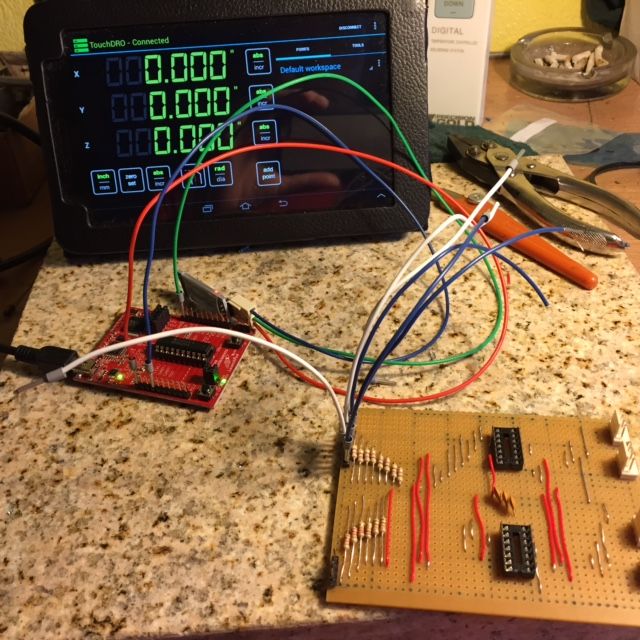

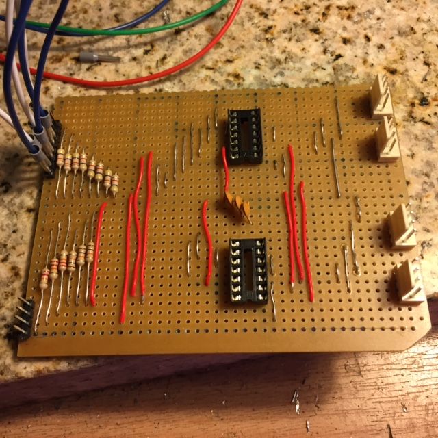

                                    On a wet n windy Friday what could be better than a visit to the local High St Electronics retailer….
                                    It's great when does not match what the website says…..
                                    Anyway. TI Launchpad and Bluetooth modules bought online.
                                    The rest I got this morning. Not bad for a days work.
                                    Credit to **LINK** for the build plans.

                                        Alex,
                                        That looks good. I recently built the quadrature one to use with magnetic read heads on my Cowells mill. It works very well. It was my first time building anything electronic in 54 years. I had fun working out positions for the various resisters. Being red/green colour blind does not help, digital multimeter helped no end. Still very nervous when powered it all up.
                                        It all fitted in a Maplins box with three 9 pin sockets on the front. I managed to use some plastic lightpipes to bring the LEDS from the TI Launchpad board to the top cover of the box so I can see when it is powered up and comms is active. You can see my circuit board attempt above.p1010038resize.jpg
                                        Best of luck with yours, having DRO's is great.
