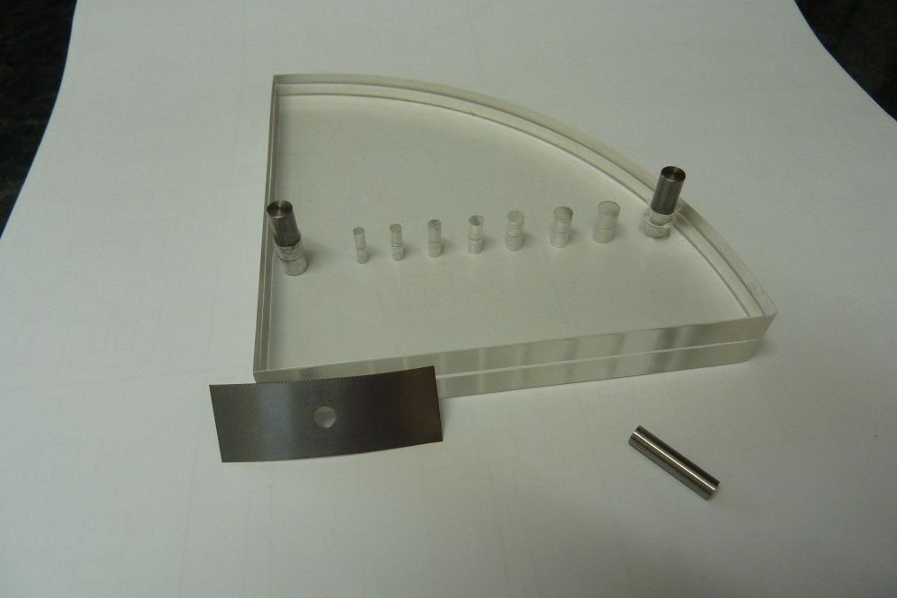

      Needed to punch holes in some shim stock so I thought I'd have a go at making a punch. I based it loosely on commercial designs and used a piece of semi-circular acrylic I had lying around (which accounts for the odd shape). First time I've machined acrylic so it could probably be better. It was already flat and parallel so I only cut it in half and cut the holes. Only made one of the punches so far but it seemed to work. The holes are 7BA to 1 BA clearance.

        That seems to work very well, Gary
        I wouldn't have thought to use acrylic
        … It will be interesting to see how long it lasts before the die loses its edge.
        Definitely worth remembering !

          Thanks, Michael. As I said, it is based on commercial designs so I can't take any credit for using acrylic. The advantage is that you can see the item you're trying to punch a hole through. A steel base might be better long term. It was just easier to cut the piece in half and try it. The punch is untreated silver steel. Probably should be hardened and tempered.

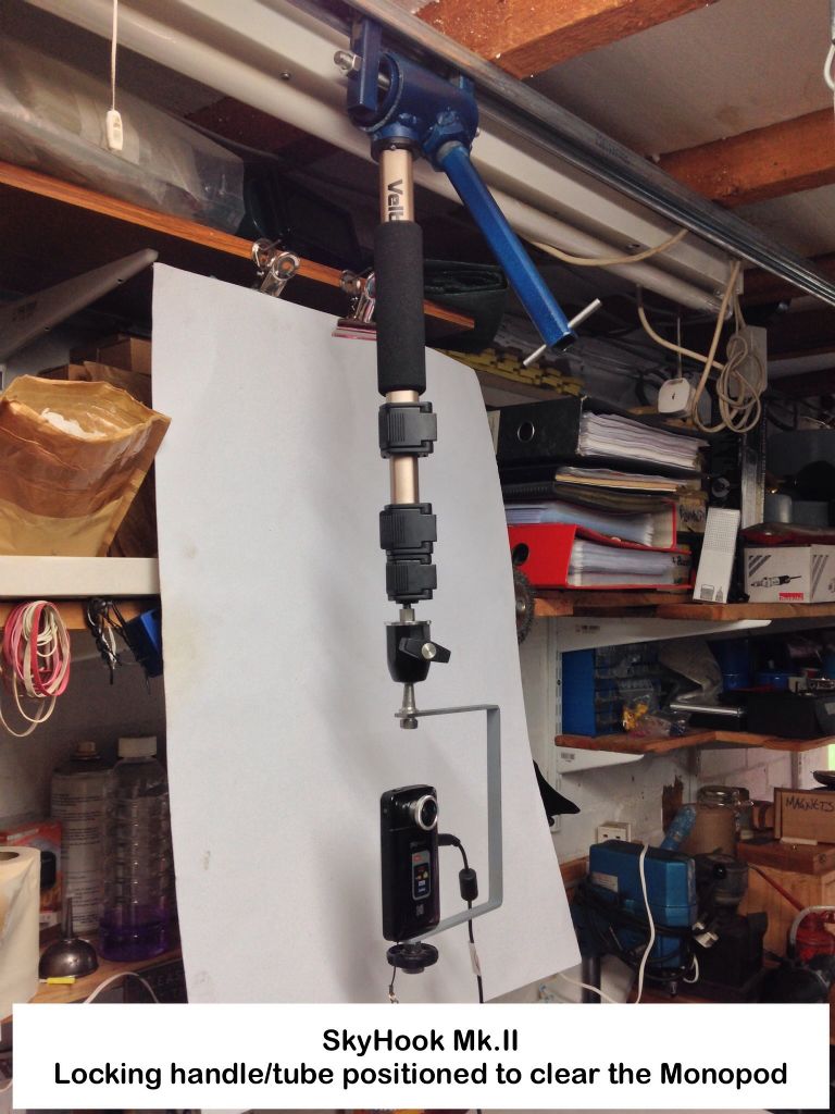

                                            Finished SkyHook Mk.II yesterday.
                                            As can be seen this iteration has the LockingTube angled to clear the Monopod.
                                            The first one I made had the tube //le with the Monopod and that turned out not too convenient in use.
                                            The angle (of the dangle) is greater than I planned, due to welding screw-up.
                                            Now busy with the swivelling TV/LCD wall bracket to hold the MacBook/iPad.
                                            Geoff – One day my stick welding MAY possibly improve.
                                            SkyHook Mk.II

                                              Ouballie what is it for ?

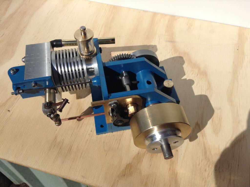

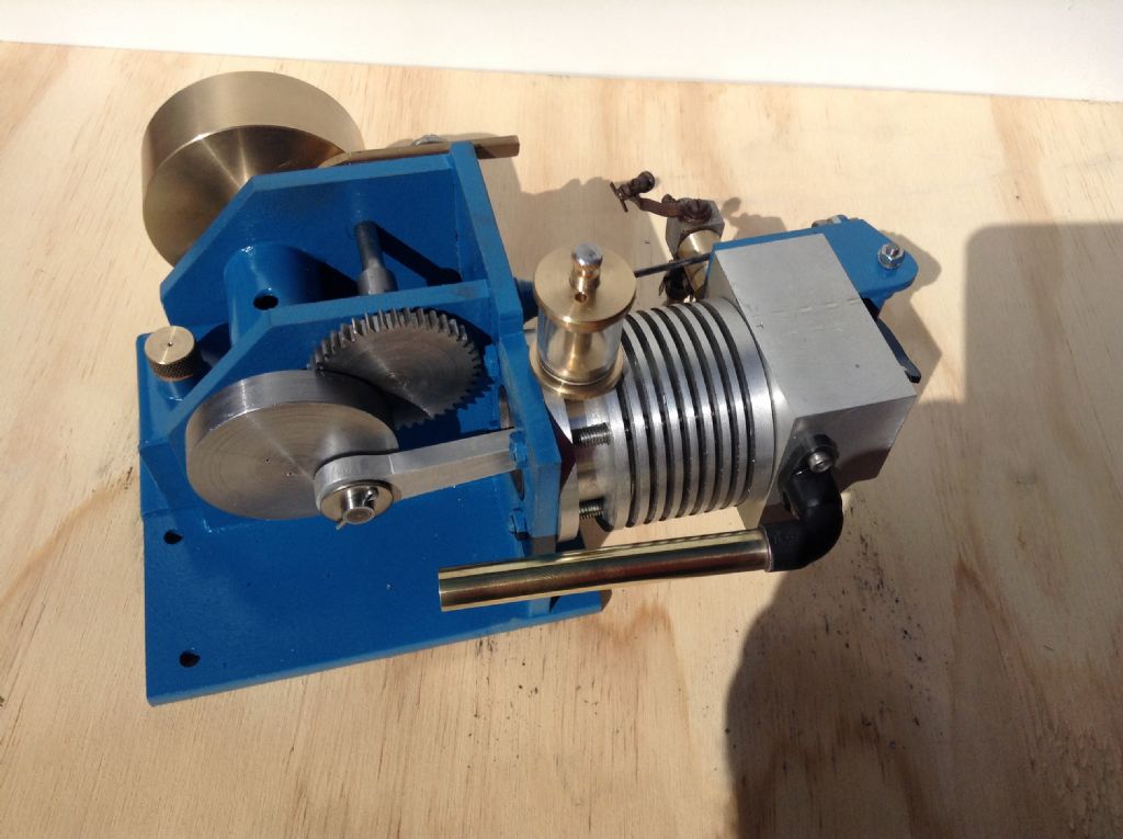

                                                      What have I been doing ,not so much today but over the last couple of weeks while waiting for the flywheel of the Saunderson and Mills tractor to be cast in iron. The photo shows the results of my efforts ( if it's not on here look at the album). It is a 15cc OHV air cooled engine designed for the beginner or school student. It does not use any castings and all the materials can obtained from local suppliers . A commercial carby is being used for tests but will later be replaced. The tube which acts as a sump for the crankshaft is also used to keep both vertical plates in the correct position when being assembled. The gears are module 1 and are 20/40 teeth. The ignition is by coil and points (ex lawn mower) and the engine has a single cam that operates in exhaust valve ,the inlet being automatic. Tomorrow I will finalise the drawings and fire it up for the first time.
