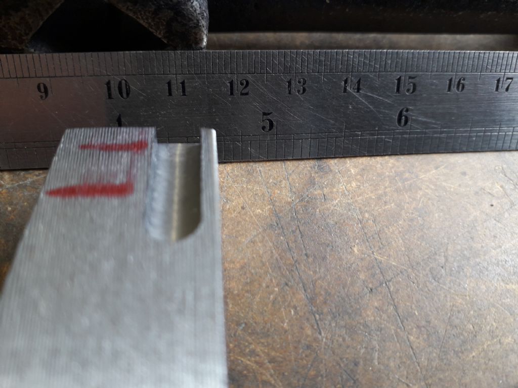

      Hi . Would welcome advice on this vexing problem please.
      I have a WM18 mill which was purchased last October at the Midlands exhibition so is still just about in warranty. I am awaiting a reply from Warco but would like to know if others have experienced anything similar. I have been using the mill until now for simple surface machining and occasional drilling operations which the machine quill was used . All these operations involved milling with the main column locked. I have also machined a few through slots which were started with a suitable drill. All these operations were successful and I have been very pleased with the machine up until the start of last week. When for the first time I attempted to create a enclosed blind slot which by necessity needed to be started by plunge milling into the work piece with a 5/16" slot drill.. ( Both table axis's and quill locked , column unlocked and used to feed .) Horror of horrors .When the cut started the milling head quite visibly moved causing the machine spindle to appear to ir move in a circle around it's true axis.. The hole produced being visibly larger than the cutter by approximately a millimeter! The work piece is now wrecked but I thought it wise to continue to form the intended slot.. The column was then raised and locked to allow a suitable depth of cut and the X axis unlocked and machining commenced . This latter operation progressed with no issues. However overall the slot is somewhat keyhole shaped , no way as intended. Since the cutter was brand new and I was a suspicious of it's end gashing I order other cutters from different sources and repeated the exercise on scrap material. All progressed with similar disaster. Observing that the milling head body was shaking by about a millimeter when applying the plunge into the work , I decided to progressively apply the column locks bit by bit . Eventually the head movement subsided to a acceptable level. However at these settings considerable amount force is needed on the column hand wheel to apply any cut. Surely this cannot be right. By my consideration the machine has had insufficient use to have worn an appreciable amount.
      I made a phone call to Warco regarding the gib strip adjustment and proceeded with gib adjustment. On adjustment of the gib so as to limit the head shake to a total of 3 thou of an inch ( where column movement is quite stiff) I find that further up the column this slackens of but at the very top it is impossibly stiff one needs the biceps of 4 African elephant thighs to move it. Mmmm I proceeded then to make some measurements of the dovetails on the column and find alarmingly that there is approaching differences between top and bottom of about 5 thou ! …..not good. Whats more on close examination of the top of the column reveals a serious machining defect, the surface grinding of the right hand dovetail seems not to have reached that far and the initial machining is seen to be very uneven , the ground surfaces seem to be unworn elsewhere.. No wonder I cannot adjust the gibs correctly and very much doubt whether they were in the first place.
      What I would like to know is am i asking too much of a low cost machine in expecting it to be able to slot drill a blind enclosed slot and what sort of level of run out at the spindle should I reasonably expect.. Also what should the dovetail angle be it looks non standard to me. From my industrial training days many years ago was a bread and butter job for a vertical mill. Having read of model engineers converting this model of machine to full CNC my mind struggles to see how if their machines were like mine to start with.. Am I doing something wrong , have I overlooked something?
      When I purchased this machine it was with the view to follow their footsteps but not now , I feel very dejected.
      Any thoughts or advice would be appreciated.

          Obvious question why not use quill fine feed to put on the cut?
          Edited By JasonB on 08/10/2019 15:33:19

            #432419
              You can also help the machine buy drilling say a 6mm blind hole so the slot drill can plunge more easily as there is no slow rotating "dead spot" in the middle or ramp down into the slot rather than plunge.
              What make were the cutters you tried? What was the material being cut?
              Edited By JasonB on 08/10/2019 17:03:44

                  Plunge milling is very aggressive it'll find any lash in the Z.
                  Is the column moving and adding to the problem?

                      Maybe a silly question; is the locking nut under the head working loose?
                      'Hence I always lock the headstock and use the quill feed'
                      I do the same then do any depth adjustment with the fine feed.

                        Jason B's suggestion is best, leave less material for the slot drill to plunge into. A solid carbide four flute end cutting mill will plunge much better than a two flute slot drill, which is preferred for the actual slotting.

                          A starter hole is the best way to go but if I'm in a hurry or cannot be bothered to change the cutter from say a standard endmill or a non centre cutting slot drill, I just move the job from side to side a short distance whilst feeding the cutter down with the quill. I rarely use the cutter the same diameter as the finished slot so then clean up the slot to width once the bulk of material is removed.
                          Plunging any flat bottomed-ish cutter into a flat surface is always going to be challenging unless the machine is ultra rigid.

                            Whenever I have had violent shaking plunging on a 2 flute cutter it has always been cutting one of those weird Reuleaux triangles rather than a round hole. I have no idea why or how to prevent it, we have already plumbed the full depth of my knowlege with this simple observation smiley

                              There's probably no getting around the sloppiness of cheap and cheerful, or old and worn, machine tools.
                              I'd try as suggested, drilling the hole to start with by a conventional 120-degree-point drill bit, a bit undersized and then take the final skim plunge cut with a slot drill and proceed on milling the slot.. Using the quill feed to set depth etc.
                              Next time it gets to dancing around like that, take a look at and put a finger on the join line between the column and the base. Sometimes if those two mating surfaces are not very accurately machined and matched, the column can be a bit unstable in operation. I've seen one that looked like it was machined with an angle grinder wielded by Blind Freddy at 3.58pm Friday afternoon. .

                                Did you use ground bars to measure over to obtain the dovetail widths ?
                                Design concept is good with dovetailed column with tapered gib but if you have .005" difference on width top to bottom then the gib adjustment will only be correct at the point it is adjusted at.
                                Like others have said I also would have put the cut on with fine feed with the column locked, especially on that machine as the head down handle is placed at the very top of the machine.
                                Finding ways around any machine defect doesn't help very much with any warranty claim but does highlight the fact that when receiving a new machine it should be checked thoroughly to find any such problems that can be reported immediately to the supplier.
                                If you are a newcomer to machining the above may not be possible so seek help from an experienced person.

                                  I think the last post has almost hit the nail on the head. Except in my instance Blind Freddy was recovering from a Friday lunchtime binge and day dreaming about a weekend binge with his mates! It appears to me that these tapered gib thingies can't hold the head securely on their own with out some support from the locking screws. My guess at the moment is that since the gib thrust is applied from the ends of the gib strip a degree of buckling of the gib may be allowed to take place that allows the head to move about on the dovetails. Looks like Blind Freddy was given the freedom to fashion the dovetails on the column and possibly the milling head as well. My impressions at the moment is that the angled part of the dovetail looks somewhat convex rather than flat , even where the possibility of wear if any is unlikely to have taken place. But I really need to investigate this aspect further.
                                  I had considered using the quill to apply feed in the first instance but I am re aqauintting myself with the art of milling and also I am exploring the envelope of performance / abilities of this machine. ( My only exposure to mechanical engineering was a year spent in basic training at the onset of my career some 50 + years ago. You couldn't call basic these days as we covered every aspect from foundry work through to metal spinning , sadly though we didn't get time to do any gear cutting or hand scraping. So I'm a bit rusty.) Thinking that the quill would add additional length to the cutter and there by add another variable to the exercise.. it's certainly discovered a major limitation. The same goes for first drilling under sized holes/ slot to start in the first instance.
                                  To answer a few questions , the material was BMS. As for the cutters , the first two I used were from one of those boxed sets I think I possibly bought from a reputable trade stand at an exhibition but one of the others was from a cutter purchase from Arceurotrade and two would you believe were industrial throw outs long since past their supposed life with tip cutting edges freehand sharpened by myself on the bench grinder! The last were done in a fit of frustration and an element of try and see approach. Surprising they cut very very freely compared with the purchased items . I expected head shake and hence the first plunge to form the slot to be far worse …… not the case there was no difference. So it's down to the mill.

                                      The basic problem probably is the mill. But using poor cutters (not the one from Arc) certainly won't help matters. Small machine tools need all the help they can get, including quality cutters properly ground.
                                      If the gibs are proper tapered ones, they don't have locking screws, just adjustment screws at each end. Presumably the gibs are parallelograms rather than proper tapered gibs?

                                        I can't speak for Warco but ARC certainly advise putting on a cut with the quill fine feed not the head height handle, why else would the built in digital readout be fitted to measure the fine feed, the head only gives a coarse reading.
                                        Also not good from a safety point of view to be reaching up over a rotating cutter to make adjustments.
                                        Was it one of ARC's premium cutters or the basic Gold Tin coated ones? if the gold then I'm not too keen on those.
                                        I just popped a 6mm 2-flute standard length premium HSS cutter from ARC into the SX2.7 as that is the nearest I have to your cutter, did two plunge cuts one with fine feed and the other with head feed and no real difference in the holes produced, head feed did feel a bit more like things were moving about but that could just as easily have been the lack of control of the feed. I then cut between and beyond the two 2mm deep plunged cuts and in both cases no sign of the plunge cuts being oversize. Red marks are where I plunged

                                          I remember plunging a 1/4" slot drill about 1/4" deep and getting a hole 0.015" oversize. Changing the cutter resulted in a hole only 0.001" oversize, yet there didn't seem to be much difference in the sharpness.
                                          The trouble with plunging two flute slot drills is that viewed end on they are asymmetric, so they drill like a badly sharpened twist drill. For cutting the actual slot, two and three fluted mills are much preferable to four fluted as the 90 degree separation of the cutting in the four flute interferes with the cutting.
                                          Recently, I wanted to cut a quick flattish bottomed hole in a piece of 23mm square aluminium. The hole was 3/4" diameter, and 1/2" deep. The aluminium went in the lathe four jaw and a new Osborn slot drill went in the tailstock chuck. The tailstock was shaking at least 1/16" when I made the hole.
