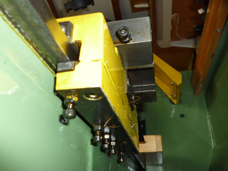

      Jason are you sure your WM280 has these gib adjusting screws, that diagram you show is for the mini lathes which does have these. I didn't think the WM240, WM250 & WM280 lathes had these gibs & adjusting screws under the saddle. They certainly didn't have any adjusters on these lathes the last time i was in Warco's showroom a few months ago, they also don't show these gibs & adjusters in the Warco parts manual for these machines ?

              #415692
              Former Member
                @formermember32069
                #415704

                    I spoke to Warco this morning about whether there were adjustment gibs & screws on the saddles on there current WM180, 240 & 250 lathes, they confirmed there is none on these lathes. If you have a Warco lathe with this facility on the saddle it was probably made either by a different factory that supplied Warco in the past or the generic design of these lathes which all seem to be the same machines supplied by different sellers around the world was changed to not have the saddle gib & adjustering screws. Its obviously cheaper to produce a machine without this extra facility.
