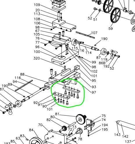

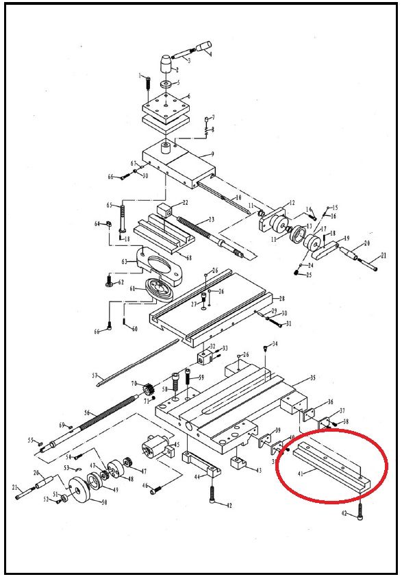

Whilst shimming the rear of the saddle will stiffen it up usefully, I'm not convinced the saddle is the main problem. My chief suspect is the front tool-post. On many lathes they are clamped to the saddle with a single bolt, but far, far worse, is that they tower high above the bed, and are relatively lightly made. The whole assembly is bendy! Then the tool-post is fitted with a long sticky-out parting tool to take an unusually heavy cut in a swarf filled slot. The leverage applied when the tool digs in is substantial. Nasty. A mini-lathe needs all the help it can get, lubrication, swarf clearance, sharp tool carefully set, and above all a steady hand.

I'm a little suspicious of rear shimming as a solution. The saddle's accuracy is determined by running along the precision 'V'. There's a risk shimming might mis-steer the saddle relative to the ordinary rear of the bed instead. But people do shim successfully; perhaps the trick is shims loose enough to flex slightly under normal operation, but tight enough to restrict the saddle whilst parting?
