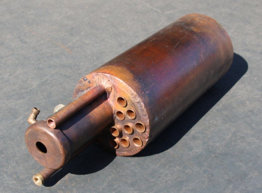

        I bought this small partially completed boiler from the "for sale" section on here very cheaply. The seller told me he has no knowledge of engineering and could only say that he acquired it together with a 5" chassis of an Aspinall 0-6-0 although he did not know if this boiler was supposed to go with the chassis. Personally, without a conventional firebox I cannot see it being built for aforementioned loco but I may be wrong.
        So can I ask – does anyone have any idea about it?

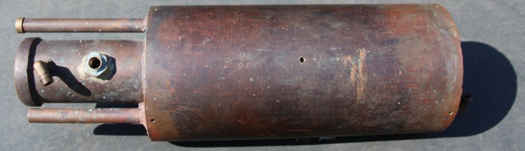

        The main body of the boiler is seamless thick walled copper tube 260mm long x 120mm diameter. The end plates are also thick copper and have been copper "welded" into position. Excuse my terminology but I have never built a boiler before or for that matter silver soldered anything.

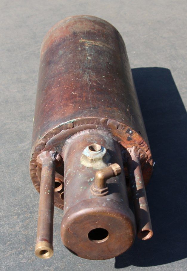

        The smaller piece of tubing at one end is 105mm long x 55mm diameter. It to has been copper welded to the end plate and is fitted with a similarly welded end cap which has been drilled .640" diameter. Also, this smaller tube has had an hexagonal threaded bush silver soldered to it (the only bit of silver soldering on the boiler) also a small elbow is fitted and secured on the inside by a nut but not yet soldered. The void in this smaller piece of tube is part of the void in the main boiler barrel.

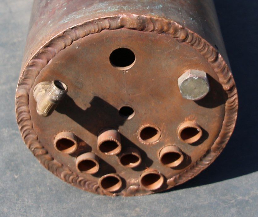

        Either side of this smaller piece of tube are two bits of .5" diameter tube which are extensions of tube which continue through the main boiler body to the other end, one terminating at an elbow loosely fixed to the end plate and the other one terminating at an hexagonal bolt head (I am assuming it's a bolt but I have not yet undone it to look).
        The nine fire tubes are loosely positioned and yet to be soldered.
        I would very much like to build something around this – what is for me a mystery – so would appreciate any comments / advice.
        One final thing, If I can get this project of the ground I would need to pay someone to complete this boiler so advice as to who might do it would be handy.
        Rik

          It's sort of like a Briggs boiler with a round upper part over the firebox, instead of half-round. My guess is it's an experiment that would require an odd-shaped insulated firebox.

                If it meets the inspector's safety requirements you could cut off the 'odd' end and fit a belpaire firebox. Perhaps.

                  It couldnt possibly meet with the current safety requirements (some of which defy any logic whatsoever I hasten to add!). You would need material certs for the copper and be coded/have tests for the welds. Chop both ends off and start again is the best advice I can offer.
