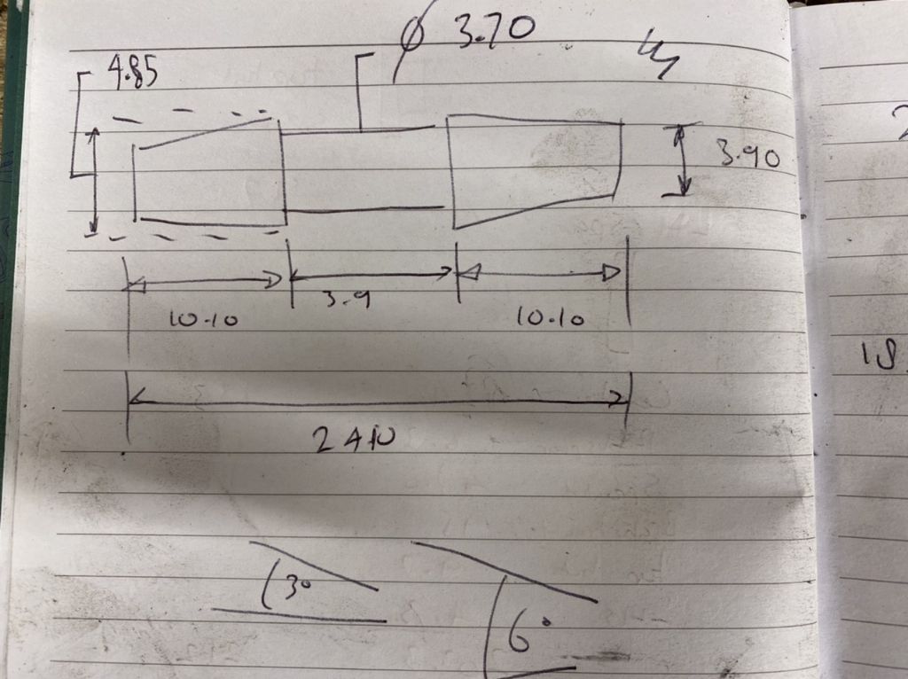

      Keith Matheson
        @keithmatheson47708
        Hi, I would like to make a stainless part (it’s a location pin for a motorcycle brembo brake calliper if your interested) but it has a taper which I’ve not done for any5hing dimensionally semi serious before. I have enclosed a photo with the dimensions taken from the rusty old original. I’m not really sure what feature to turn first. The more I think about it the more I go around in circles. I guess I could just start cutting and learn how NOT to do it but would prefer some wise words to gently point me in the right direction. (Just for the record Before anyone starts posting it’s not massively critical as it just lines up a spring clip into a central position. ) e2ce04d3-69d1-46a4-bfb7-e2de001a3e24.jpegAs always I appreciate all your wise contributions. Best regards keith MM

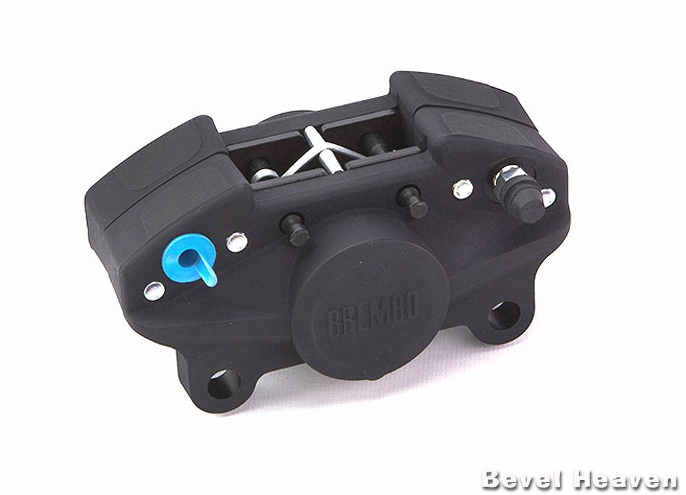

        Hopper
          @hopper
          Looks like something off my 1981 BMW R100RS, anti rattle spring retaining clip? So as you say, the taper is not critical, is just there to hold the pin centralised, roughly between the two pads.
          I would start one end and work to the other, sliding the material out of the chuck a little for each step to minimise overhang. Turn the first section to the 4.85 diamter first so you have a reference for when your taper is right size. Do the end taper with topslide set to correct angle, with just that part sticking out of the chuck. Then slide rod out a bit more and use turning tool moved back and forth to machine the groove to diameter. Then finish off the square shoulders on the groove with turning tool turned to 90 degrees from the job to make a nice square shoulder. Then slide it out a bit more and do the final taper with topslide set around to the opposite angle. Then cut the job off from the blank with a parting tool.

              I would go along with hopper, but the groove in the middle I would use a parting cutter. Noel.
              #535345
                Same as Hopper.
                The hard part is making sure the opposite tapers are identical. I'd probably use an angle template, making one if necessary, to ensure the tool runs along rhe edge correctly. Or set the angle up with a DTI to a measured tangent or cosine.

                  Hopper
                    @hopper
                    The angle is not critical. It does not fit in a hole. It just rests on a half-round notch in the brake pad and stops it rattling by benefit of a small leaf spring that presses on the recessed diamter in the middle. .

                      Ady1
                        @ady1
                        The taper itself can be created by angling your topslide with a DTI
                        Then move your topslide over distance 10.10 until your DTI on the topslide moves (4.85-3.9) 0.95 for the correct cut angle
                        I use that for MT1 stuff, then scribed a line onto my saddle for future use, total doddle
                        Between centres with an extra bit in the chuck as above
                        GL
                        EDIT the awkward bit will be the furthest from the chuck taper, do a 100% practice cut first, to ensure your topslide does not foul with the tailstock, the job pushes right in towards the tailstock gubbins as you cut the taper
                        The further you go from the chuck the more fiddly the job gets, don't forget the tapers will be opposites so you need to do two separate setups
                        I use Calipers to keep an eye on the min/max diameters of the tapers as the job progresses

                        Hopper
                          @hopper
                          This is not a critical taper like a morse taper. No need to use a DTI to set the topslide. The two tapers could be several degrees different and still work ok so setting by the graduations on the topslide will suffice. And no need to use a tail stock if the job is done in three stages and the bar moved out of the chuck for each stage.
                          #535375
                          Hopper
                            @hopper
                            Just to clarify. The pin is in the centre at the top of the caliper shown. It is held in place by the leaf spring that can be seen running over the top of it and back down under and around the pad retaining pin at each end. And the two tapers sit in roughly pressed notches in the brake pads. They dont fit into a tapered hole or anything requiring precision. The pin can't move anywhere as it is captive between the two caliper halves and the spring. The tapers simply encourage the pads to move outwards slightly under vibration so they don't rattle around loose. So getting the angle exact on the tapers is not a critical issue.

                              If you start with something like 10mm dia bar and then do it in stages from the end there is no real need to use tailstock support or slide the work out for each stage of the work

                                Hopper
                                  @hopper
                                  I would assume Brembo put a taper on there for a reason, most likely to move the pads outwards so they dont drag. Not that hard to replicate the original. Plus if you know the Bevelhead Ducatisti, no end of "experts" would be pointing out to the owner that his anti rattle pins were not original because they are supposed to be tapered. I kid you not. My brother has 1977 900SS that he restored and those guys are freakin nuts.

                                      Howard Lewis
                                        @howardlewis46836
                                        If you want to see about turning tapers between centres look at my post of 18/03/2021, 10:40:34 on the Kerry A G lathe thread, and my album which has an illustration on to match my Apprentice notes.
                                        For double ended short tapers, if you centre drill both ends, having offset the Top Slide, turn the taper at one end, and then reverse end for end, and turn the other taper.

                                          Hopper
                                            @hopper
                                            Posted by Nicholas Wheeler 1 on 22/03/2021 13:16:13:
                                            Posted by Michael Gilligan on 22/03/2021 09:42:04:
                                            Posted by Hopper on 22/03/2021 08:13:35:
                                            Just to clarify. […]
                                            Nicholas, for info ^^^
                                            As most callipers use a pretty stiff spring between the pins and and pads to stop the pads rattling, I suspect that is one of those ideas that isn't really necessary. The disc on a push bike will knock the pads back enough for the brakes not to bind, which you really notice.
                                            Not these calipers. The leaf type spring as seen in the pic is held by the pad retaining pins each end and the middle of the spring bears on the tapered pin which in turn transfers the spring pressure to the pads themselves. This stops the pads from rattling  but does not make the pistons retract  — the piston seals plus any small runout on the disc do that.
                                            Your suggestion earlier of reducing the ends of the pins to fit in the recesses in the pads is dangerous. As the pads wear they need to move inwards. A shoulder where the pin has been reduced instead of a taper would hold them apart and stop them bearing on the disc when brakes are applied.
                                            Stick with Brembo's original design. They just might know more about their brakes calipers than we do.
