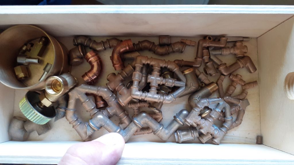

                                  The threaded PMR ones are supposed to work with ME threads, maybe you got the tapered ones and that is why you had to tap them out. See details here
                                  I've always bought the unmachined trees and zig-zag of street elbows and mostly tap them 40tpi ME though do also use metric fine if it's a metric model.
                                  Brian, the 3/16" ones have an OD of 1/4" so you may just get away with 7/32×40 threads, next up the 1/4" ones have and OD of 0.315"
