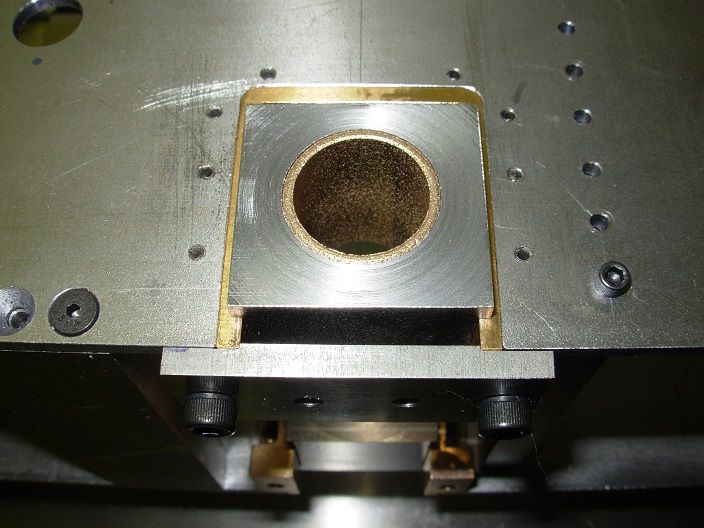

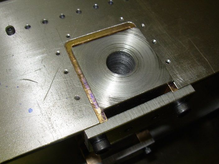

        Hi David I would really like your advise on machining the axel hornes for the Super Simplex. I am trying to figure out the best way of machining these. I see that 1/8 " sits flush with the out side of the frame, would it be better to mill the webbing side of the horn down to 3/32" after marking out the 1/8" . Or do you machine the hornes almost near to the correct measurement, I know that this is probably not making much sence, but how did you go about maching them. Your help in the past has been very valuable. Kind regards John Kinnane
        #317929
        David Wasson
          @davidwasson11489
          Hi John,
          The be sure, the web side of the horn block is machined to 5/32", not 3/32". The web side of the horn block is un-machined, so, it is your reference. It has been a while, but, I think I machined the back side (out side) of the horn block until the 5/32" dimension was achieved, Then, the part that fits into the frame, is machined to the 1/8".
          In addition, I simplified the machine work on the horn stays. Hopefully the photo will explain (a little!).

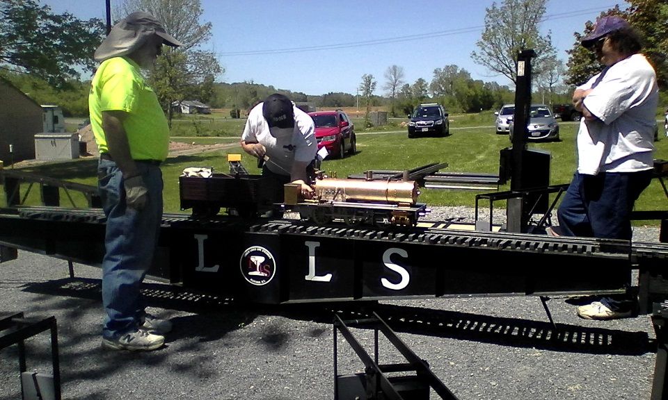

            One other thing, I got my boiler certified in May of this year!! The locomotive is far from finished, but, it can run under it's own steam and easily takes me for a ride. Not bad for 23 months work. Here's a photo taken on certification day!
            David

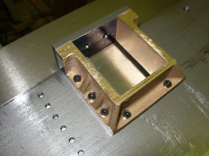

                    Well, I must confess, I did not rivet my horn blocks. I used machine screws to attach my horn blocks. I had a feeling, there might be further occasion to have the frames completely flat to do additional machine work on them, As, it turns out, I was correct, several times! The locations for the screws need to be spot faced so the screw sits on a flat surface.
                    Wish I could be of more assistance for rivets! I favored screws because I knew I would have to take the frames apart and flat for further work. I do know that sometimes rivets need to be cut to a specific length to fit properly into a specific thickness of parts.

                      A few other things, the screws I used are hexagon socket head screws. They can be installed quite tight. Also, the fit of the hornblock to the frame must be very close so none of these parts can move.
                      Here's a photo of the other side. The axle blocks have not yet been opened up to the axle size.

                            If you decide to use screws, the hornblocks and the frames are match drilled together with the tap drill. The parts are then separated. The frames are tapped, and the blocks opened up to a close fit for the body of the screw. Don't forget to "spot face" the horn block where the head of the screw will be positioned. It needs to be flat, not against the rough casting.
