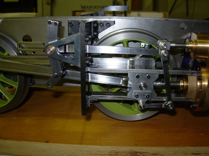

      For folks building a Super Simplex, I just wanted to give you a heads up if you are going to use the motion plate from Model Engineers Laser. The "window" in the motion plate that the cross head guide bars fit into, is positioned 1/16" too high. Also, the dimension from the top of the plate to the center of the window is not correct as shown in the ME article. It should be 2-5/8" as shown on a current version of the drawing. The plate can be used, if positioned 1/16" below the top edge of the frame.
      Super Simplex Motion Plate - 01
      Of course, the plate will no longer support the running board but, a 1/16" spacer can be put under the running board in this area.
      Also, there is a radius that was added to the edge of the window that is not shown in any version of the motion plate drawings. This radius will foul the connecting rod when the leading wheels move all the way to the left or right.
      Super Simplex Motion Plate - 02
      The wheels in the photo have been moved all the way to the left. The circled area shows the radius on the motion plate touching the con rod.
      This can be put right by machining the inside of the window straight down, as shown on the drawings.
      Hope this helps out a few folks attempting this build. In general, the laser cut parts are a real time saver and I would recommend them for anyone building a locomotive. Just make sure the parts match the drawing, and that the drawing is correct!
      David

        #212448
          Have you let Malcolm know about this error?
          I am sure he will correct it promptly.
          #212464
          David Wasson
            @davidwasson11489
            Hi Neil,
            Yes, I have let Malcolm know about this several weeks ago. In fact I asked for corrected or replacement parts. He asked for the correct drawings, which I gladly supplied him with. His response was "not sure it was a long time ago".
            So, I guess he acknowledges the errors and will hopefully make corrections. It is not clear what he is going to do for future parts, he would not say. I know this is a hobby business for him and may not have much time to make corrections. He saw that I moved on with the incorrect parts that I have and am able to make them work in spite of the errors. Perhaps that is why he did not offer to correct or replace the incorrect parts even though I asked in my first email to him.
            As I have moved on in my build, replacement or corrected parts are really no longer important.
            I encouraged him to pass on my "fix" to future customers if he is going to continue selling the same uncorrected parts.
            David
