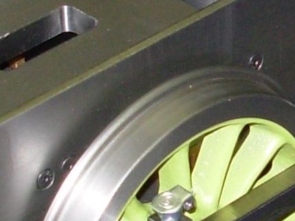

          I used 4-40 flat head screws with a recessed hex drive. The first screws I used on my Super Simplex had heads. Although they mostly were not in the way of the wheels, the countersunk flat screw made for a much neater installation. I would go with flat heads for sure. You can just see a row of them behind the wheel.
          David

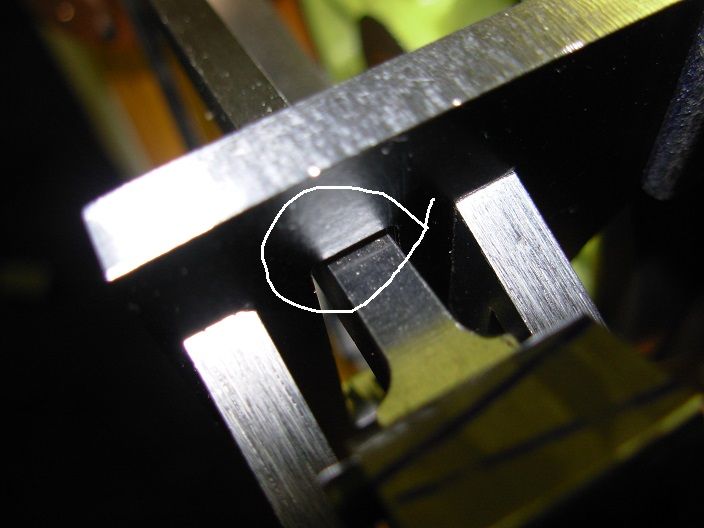

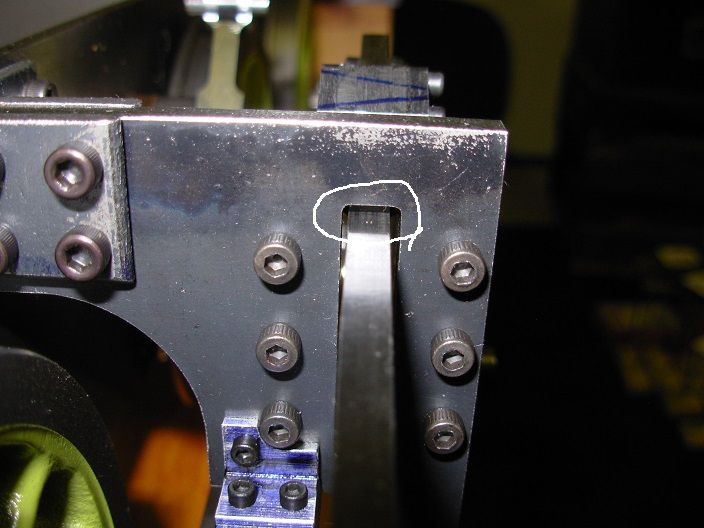

                                          As mentioned at the very beginning of this thread, a "fix" for the incorrectly placed window for the connecting rod, is to simply mount the motion plate 1/16" below the top of the main frame. A result of this, is that the window for the radius rod is now 1/16" low. I was unable to discover this until the reversing gear and reach rod were complete. The radius rod will collide with the top of the window when in the full reverse position. I opened up the top of the window by .100". The two photos show the window machined .100" to clear the radius rod in the circled area. The radius rod is in the full reverse position.
                                          I did the machining with a small end mill cutter (5/64&quot in order to keep the radius in the corners very small.
                                          The bottom of the window may also need to be opened a little bit. A file should be sufficient to do this.
                                          With clearance for the radius rods, and a bit of filing here and there, I spent all day finally getting the full valve travel to 9/16" as specified by the drawings. Yes!!
                                          David
                                          Edited By David Wasson on 25/01/2016 00:14:13
                                          Edited By David Wasson on 25/01/2016 00:15:29
