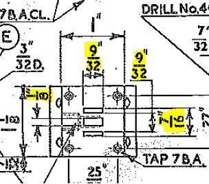

            From my Stuart 10V drawings, assuming the ports are centrally displaced;
            the outer edges of the ports are 7/16" apart, the inner port edges are 9/32" apart. The central port is 1/8" wide centrally displaced. I make the outer port width to be 5/64".
            all ports 9/32" high
            HTH..

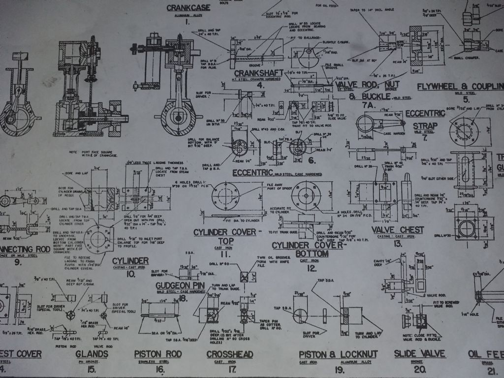

                            Thanks Old School, I cant work this out. The A A Rayman drawing calls for the Stuart cylinder which in the past post the measurements are given for this so if the casting was used these ports are cast in the casting. I have made the cylinder from bar stock to the measurements required from the post from Jason so the same as the Stuart cylinder. The drawing from A A Rayman calls for a 1/8 th eccentric, so a 1/4 inch total, but if its the same cylinder then it should be 3/32 and not 1/8th, so if the 1/8th was used how can it work? the total length on A A Raymans drawing for the valve is 5/8 th.

                              You may have less lap on your alternative design of valve making it shorter and that would not require a smuch valve movement. Can you scan or post a photo of the valve on AAR's drawing.

                                        Bob any chance of a close up of the port and valve sizes, they are a bit fuzzy when blown up then I'll draw it out in CAD

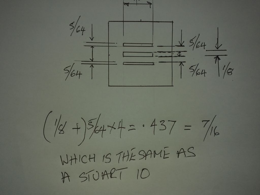

                                            Sorry for the delay Jason, My drawing shows that its the same as the Stuart cylinder drawing that you sent me the other day. My drawing is blurred but its 5/64 ths from edge of ports. Why a 1/8th eccentric on the drawing when it should be 3/32. Book states that the ports are cast in the cylinder.

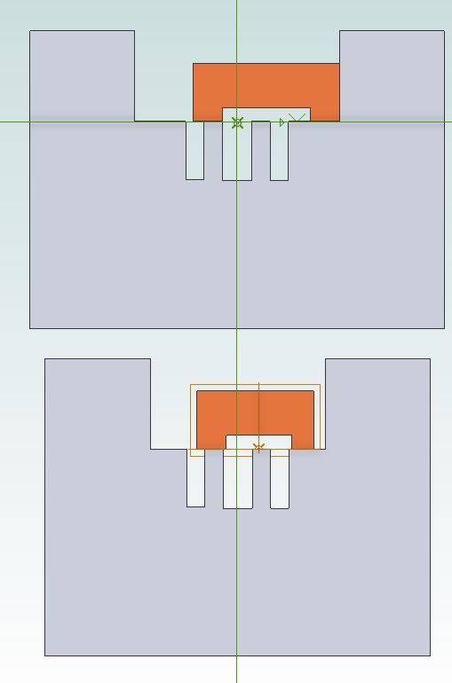

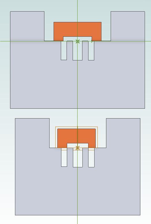

                                                These sketched show the Rayman valve at the top and the Stuart at the bottom.
                                                Firstly at full eccentric throw of 1/8" for the Rayman and 3/32" for the Stuart, Valve does come close to the cavity ends on the Rayman no wonder it says 7/8" FULL, actual port uncovered is very similar.
                                                This shows the valve in the mid position, a lot less lap on the Stuart, quite a lot of exhaust clearance on the Rayman.
                                                Edited By JasonB on 01/11/2020 17:33:18

                                                  Thanks every so much for the cad drawings Jason. I am a bit lost by the port not fully uncovering when on the full stroke and bottom stroke,obviously if this is the case then this is what I am seeking on the valve set up now.
